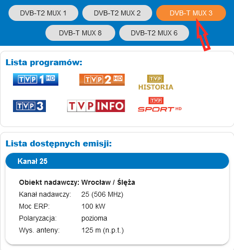

    I have recently bought a TV with dvbt2 and have an aerial receiving dvbt2 signal but when searching for channels it only shows all tvp and possibly Doba tv but does not search for any Polsat or TVN channels. The signal is received from Sleza Wrocław (Lower Silesia). It is about terrestrial television, of course, what can be done to get access to these channels.

    Maybe instead of Sleza you catch Zurawina (506MHz, k25 ) and then you have only : TVP1 HD, TVP2 HD, TVP3, TVP Info, TVP Historia, TVP Sport HD. and if they work correctly - then DVB-T2 also works correctly

    I have about 10km to Sleza, Gogolow. When I give manual search I have 506 KHz. I do not have antennas on the roof. Yes, TVP Historia and Sport are there which means from your words that DVB-T2 is there. The antenna amplifier is connected. I guess I'll have to buy a more powerful antenna, although this one should also catch, because theoretically it had a range of probably up to 15 km

    506 MHz is mux-3, which is DVB-T , not any dvb-t2. What signal parameters do you have on this channel? Have you tried changing the Region/Country?
    If you receive mux-3 from Sleza, then theoretically you should be able to receive the other muxes in dvb-t2. Unless, however, you have not unlocked this standard in your TV or you have a crap installation.

    Room antennas with amplifier clog up (TV head overdrive) with such a strong signal, especially with DVB T2 :lol:
    Stick a piece of wire about 30cm into an aerial socket and see what the TV catches.
    Here's a list of what you should be able to pick up at your place
    http://www.sat-charts.eu/nadajniki.php?id=MWlrN2cmNHI0MjU=
    Clicking on a particular transmitter in the table will show you all the reception parameters and what programmes are available

    Reinston EAN002 antenna, I entered the code 6425 changed to dvbt2 on, gave chechy a turn off the TV and scanned, still the same

    I wouldn't call this an antenna. It is rather an expensive antenna-like gadget. To tell the truth, I have never yet managed to get stable reception on all muxes on such an invention.
    In your location it should theoretically be possible to receive on an external antenna with low gain and dimensions, e.g. M-Log 6-69 or similar.

Which frequencies and multiplexes from Ślęża and Żórawina should be available in Gogolów, and how do I verify I am tuning the right transmitter?
In Gogolów, manual tuning at 506 MHz may catch Żórawina rather than Ślęża, and that can explain why you see only TVP services. One reply explicitly says that if you catch Żórawina on 506 MHz, channel 25, you may receive only TVP1 HD, TVP2 HD, TVP3, TVP Info, TVP Historia, and TVP Sport HD. [#20782932]
