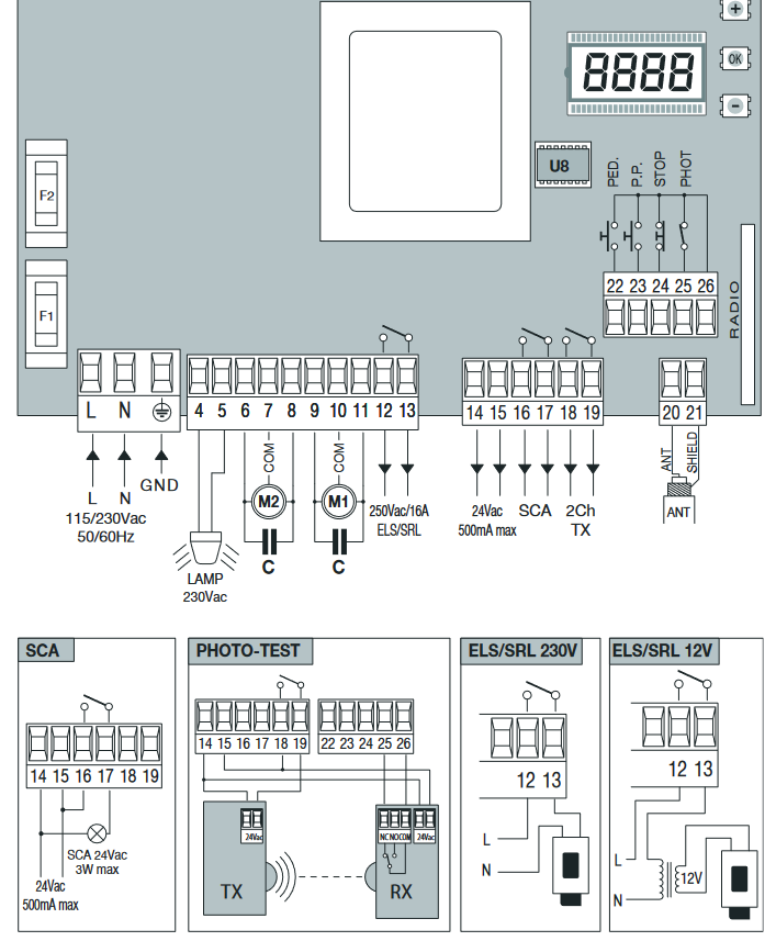

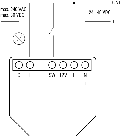

    I have a central Beninca Heady and I would like to use a Shelly Plus 1 to control it remotely.
    Assuming 24VDC, this is the wiring diagram
    Wiring diagram for a device powered by 24-48 VDC.
    And this is the Beninca Heady diagram
    Connection diagram of Beninca Heady control unit with labeled terminals.
    From my research, it seems that I need to connect the following but I'm not sure and this is where I need your help
    ShellyBeninca
    0Com?
    IPP
    SW16?
    L14?
    N15?
    Thank you!

    It's OK.
    But - input SW in Shelly - this is NOT gate status input - you don't connect it to the any SCA (16) input in Beninca Controller.
    Thi is input for an external switch. (Shelly is a controller designed, among other things, to operate lighting - and then you connect the local lighting switch to the SW input)
    PS. COM in you table - it is input 26 in Beninca?
