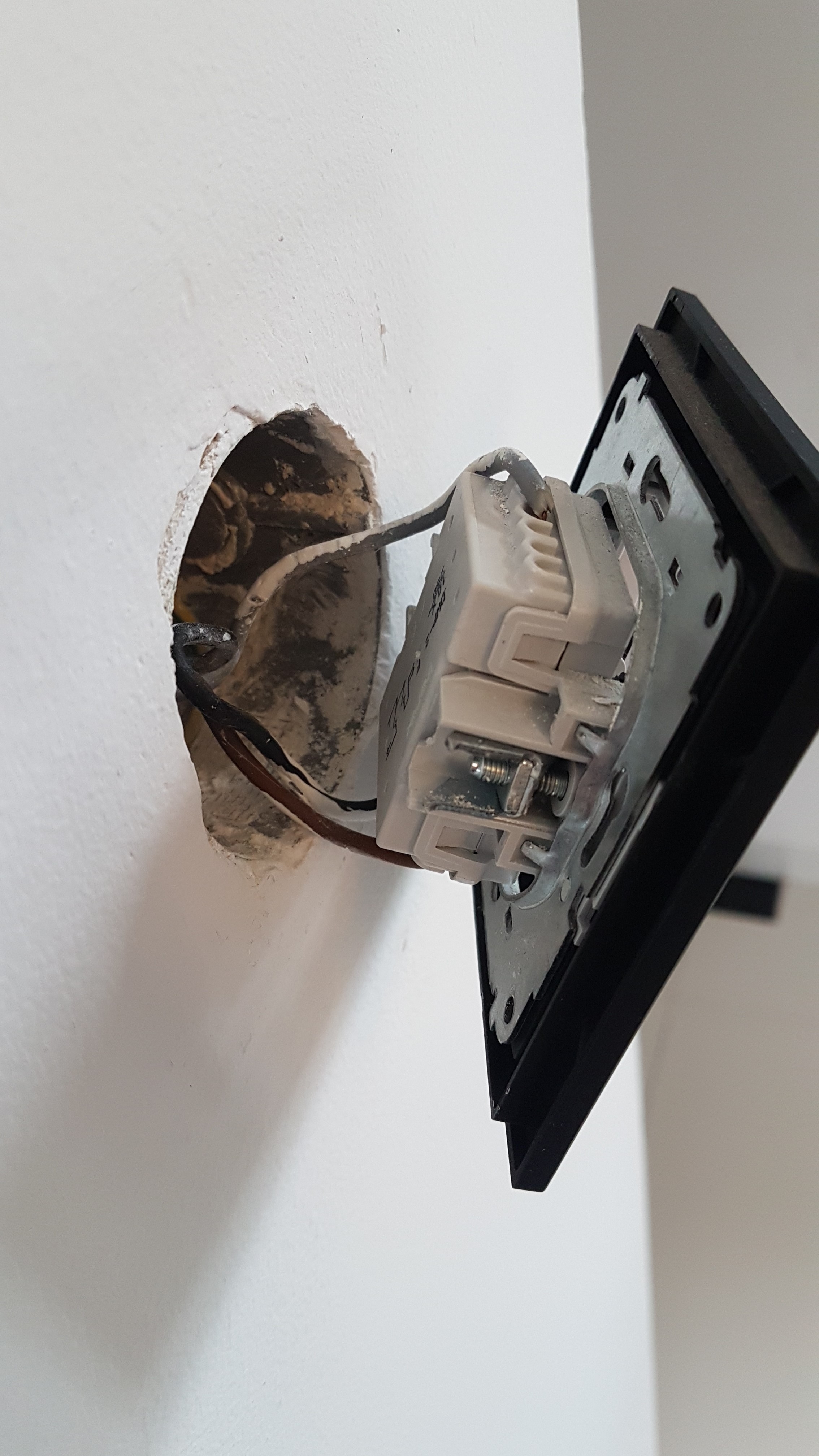

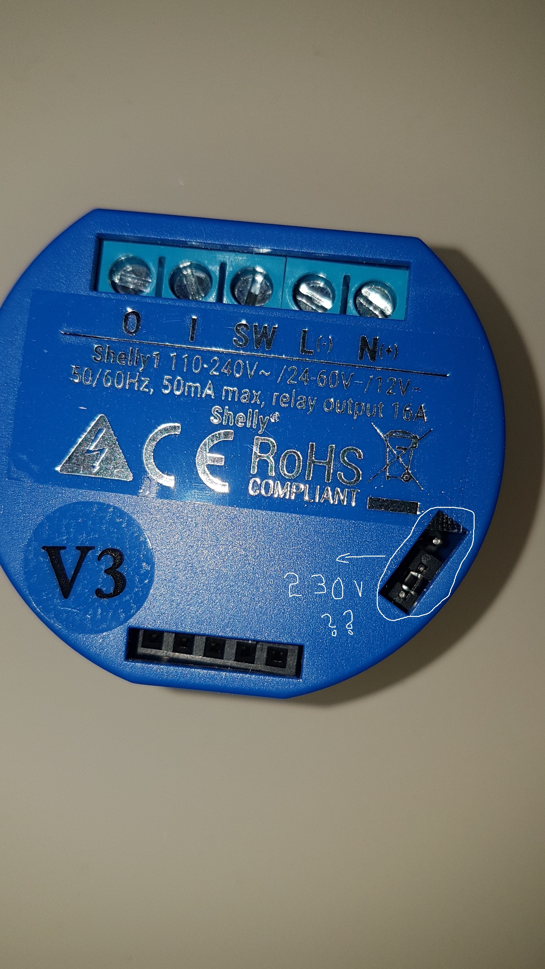

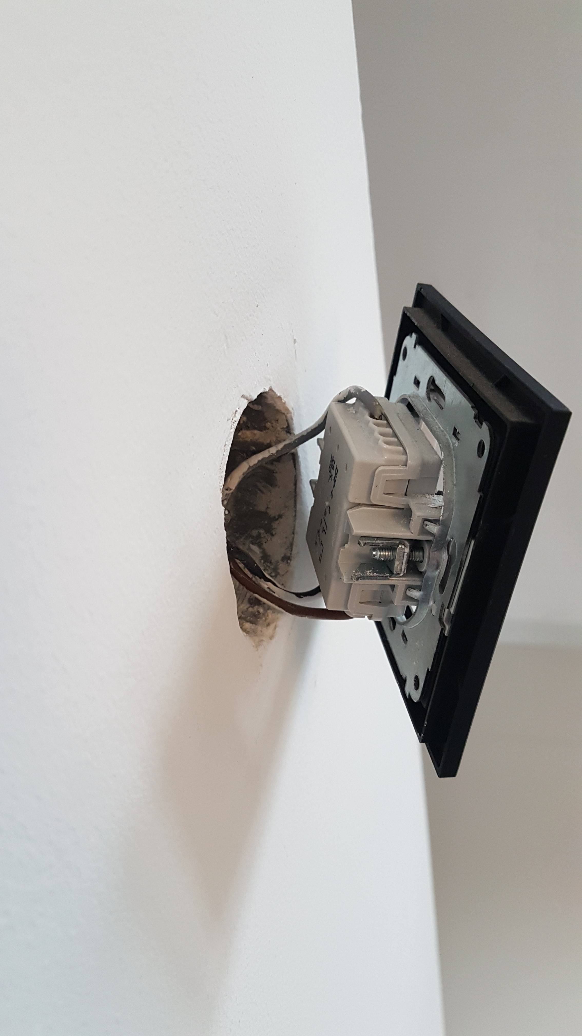

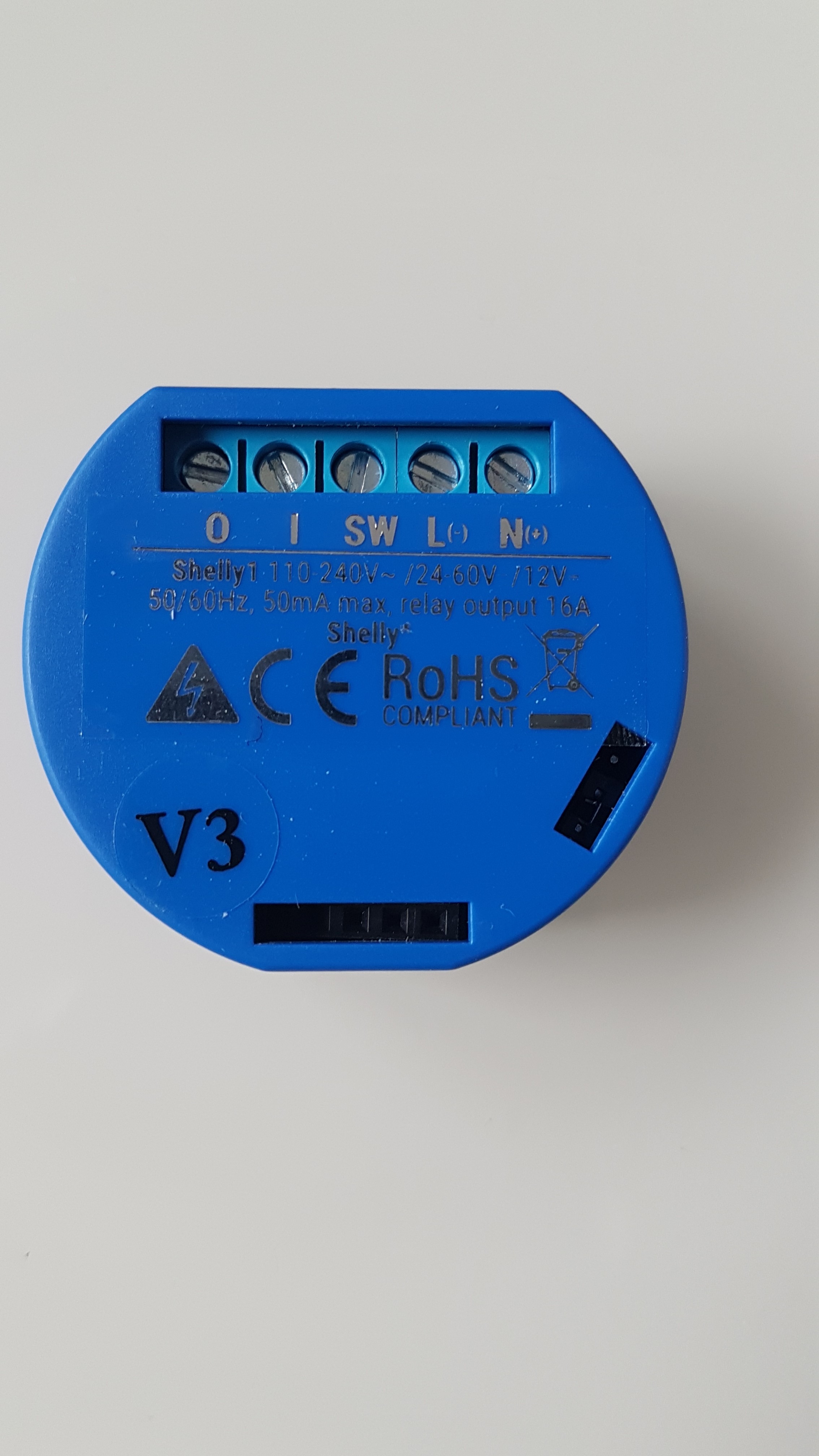

    Good morning,
    I am asking for help in connecting the relay "Shelly 1" in such a way that it is possible to switch on/off the lighting using the key and the telephone (the point is that one should not exclude the other. I would also ask you to check that the jumper in the relay is set to 230 v (as the relay also works on 24-60 and 12 v. If possible I will ask for instructions for the pictures attached. At the moment there is a two button switch but it is only used to switch on one circuit.
    In summary I would ask for help on how I should wire the relay in the simplest way possible and if the jumper set in Shelly 1 is well set for 230 v

    For something like this to work is the basic question, do you have full L and N at the site or just a break in the circuit?
    If option 2ga then it won't work. You will close the circuit but there will be a reset when you switch.

    Generally, just searching in G takes about 2-3s -> https://shelly.cloud/shelly1-open-source/

    Thank you for the link to check the jumper and at the same time I apologise for my laziness. I was indeed able to search on my own for this information :) .
    My question, however, is whether I am able to verify on my own "do you have full L and N in place or just a break in the circuit? " e.g. with a multimeter ? if so how and what do I need to check ?

    Pull all the wires out of the box, are there connectors/more wires than just to the switch?

    If the installation is, as you write, 4 years old, then according to the standards it should be done with L and N to the switch and from it go on to the lamp. You didn't write if this is new construction. If it is, then there is no stick it has to be like that, unless it is old construction and only the installation has been "improved" to save money.
    Generally, no offence but if you are having trouble identifying the correctness of the installation or how it is done then maybe it is better not to correct anything, it is a waste of life.

    Simple, get your hands on the simplest multimeter, pull the switch out of the box and now do the following: the wires connected to the switch are 99% phase to one of them (the one on which the test tube/neon tube is lit), connect one of the wires of the multimeter and the other to the other wires in the box and look until you have 230VAC on the meter. If you find this configuration it means you have full power in the box. Just note that one of the wires between which the 230 will be may be a protective conductor.

    Plastered boxes are technically pathology in the name of a smooth wall. From the photo it appears that you have a double or stair switch so you don't have the N necessary to power Shelly 1. Without ripping up the wall you can fit Shelly in a light fitting as long as there is space, the photo shows a candlestick switch not a stair switch and you are prepared to give up sectioning the fitting - light the whole thing.
