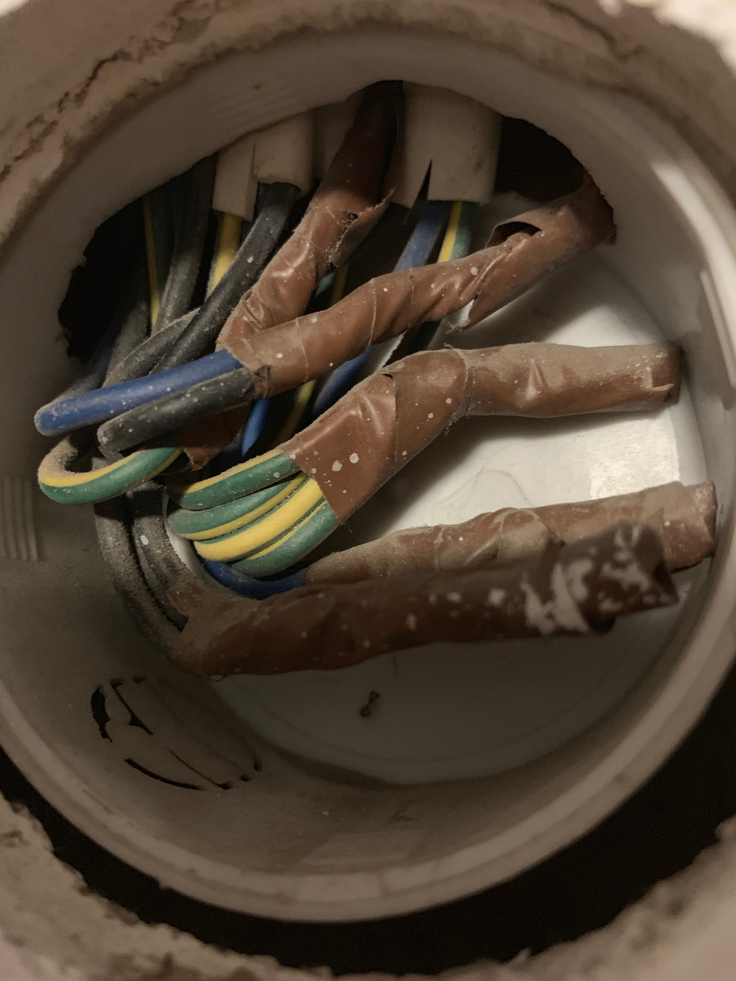

    Complementing yesterday's question still. I looked in one of those boxes above the switch and found such a tangle there:
    Shelly 1 - can it be installed in "old installation"
    There are 2 light sources in this room, and one double switch (to which three wires are connected - L,N and PE)
    Do I understand correctly the assumptions of such an installation that:
    - one cable goes to this double switch
    - two cables to the two light points
    - one cable further into the installation
    If so, I can easily plug in with Shelly in this place and get the intended effect.
    I also assume that similar "technology" is used for all the switches in the house.

    The fundamental issue is access to the neutral. If it is in the can then you are home. From the photo it's hard to tell if it is. There should be a group of blue wires connected together and you can't see one. I don't know what's under the yellow-green ones back there. You can only see a piece of blue wire.

    If I remember correctly the blue ones connected there are the rearmost ones, but I will check it later today.

    It worked.
    Just as I thought, there was an N-wire harness at the back of this tangle.
    All fixed, old tape changed to quick disconnects, shelly hooked up and it works fine.

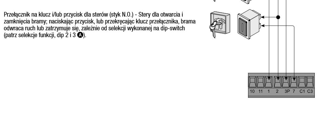

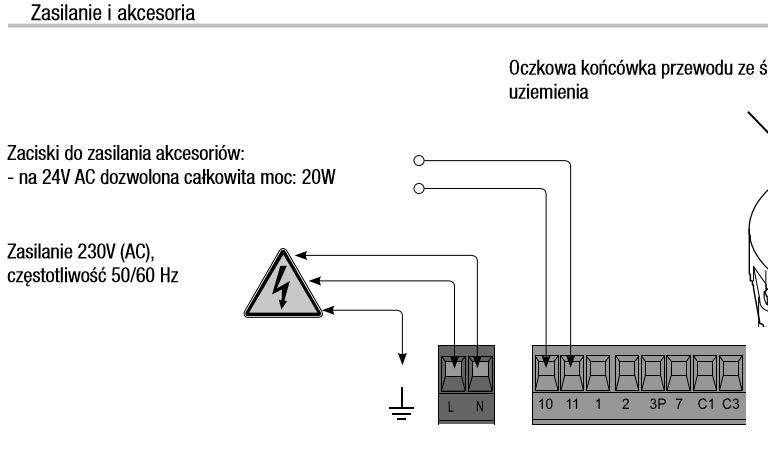

    2) Entrance gate
    I have a Came BX operator fitted, which I see in the instructions would also be possible to automate.
    Question: what about the power supply? I see that the drive has an output for powering accessories [connectors 10 and 11], but AC
    Shelly 1 - can it be installed in "old installation" .
    In shelly I can change the jumper to a lower voltage of 24-60V but DC.
    Should the power supply then be left at 220V AC in the shelly and connected directly from L and N?
    Then just I/O shelly with connectors 2 and 7 of the drive and it should work?

    Answering myself to point 2):
    It doesn't matter the power source shely if it only supports short-circuit functions (I/O outputs), because these circuits are separated from each other.
    Thus, I already have a gateway controlled from anywhere in the world with an app on my phone and integrated with Home Asssiatant.
