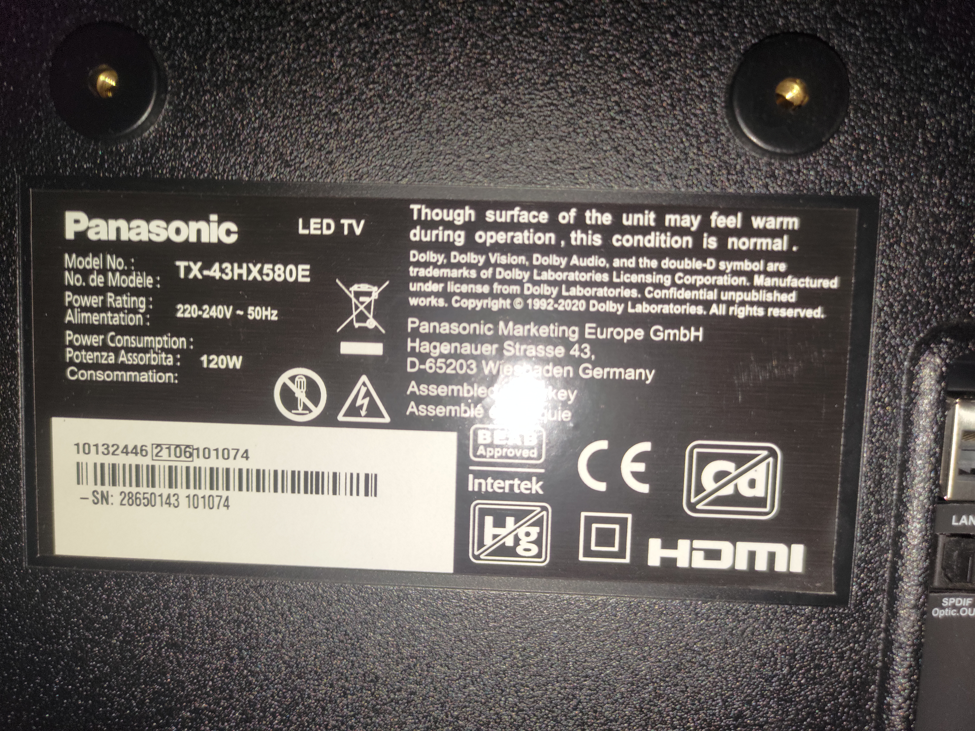

    Hello, I have a Panasonic TX-43HX580E-Vestel 17mb230​, I tried to enable 48-bit color, HDR10+, and ALLM by importing modified SPI files (edid.vga and edid.edid), but I got stuck at the Panasonic boot loop screen.
    Original SPI files:
    https://www.udrop.com/L3xC/edid.vga
    https://www.udrop.com/L3xB/edid.edid
    Modified SPI files
    https://www.udrop.com/L45B/edid.vga
    https://www.udrop.com/L45A/edid.edid
    Service menu screen of a Panasonic TV showing technical information. Nameplate of Panasonic TX-43HX580E TV with description and HDMI symbol.
    Is there any solution to fix ths problem?I cannot use my remote control to enter service menu and import back original edid.edid and edid.vga files
