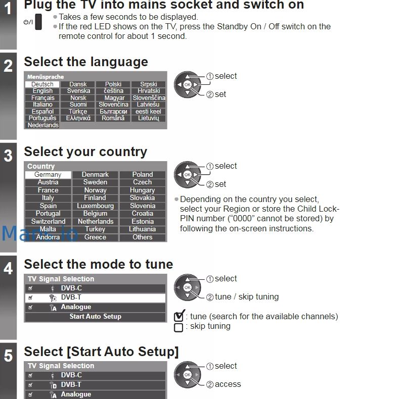

    Hello boys! I have exchanged the mainboard TNPH0993 in my TV Panasonic TX-L42ET5E (E like Europe) for the same board which comes from TV TX-L42ET5B (B like Britain). The TV works properly, but in the menu is missing the possibility to set the language and the region of use. I tried to set it in the service menu, but there it isn't possible either. In the end I upgraded firmware on the newest version for Europe models and expected it to help, but it didn't. The two items in the menu are still missing. So my question is: " How can I set this board from Britain TV model to the Europe model?" I think it must be possible, the boards are exactly the same, only the settings (softwares) are different. Just the menu on the picture is missing.
    Fragment of Panasonic TV manual regarding language, region, and tuning mode settings.

    Swap the memories

    I have already swapped the memories. The Czech menu is present, but there doesn't work CI slot and Netflix now.

    Nand to?

    No. Only EEPROM 24C64 (IC8902).
