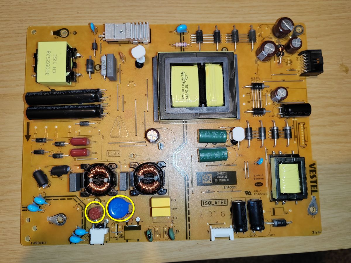

    gamingret
    I am looking to see if someone can give me some help in the right direction with my TV repair. I tinker with electronics, but this one is new to me and looking to find where to start. I have a Vestel 17IPS72 powerboard from my TV, the TV had no power and no standby light, so I stripped the board out the TV and wondered how I would start looking for the problem. I can solder and I have a multimeter. [img-0]
    Vestel 17IPS72 Powerboard Diagnostic: No Standby Light, TV Won't Turn On
    Added after 7 [hours] 43 [minutes]:
    I would like to throw an update in case anyone comes across this in the future. I found this by following a YouTube video.
    The fuse was blown (I was testing the wrong fuses) which in turn blew the varistor (which is a power surge protector). So I must have had a power surge somehow although my extension cord is rated against such things. It's a very common problem with these boards.
    As you'll see from the components circled, you have to check the brown fuse from the bottom.

    gamingret
    Fuse blown, followed YouTube video and discovered fuse and varistor needed to be replaced.
