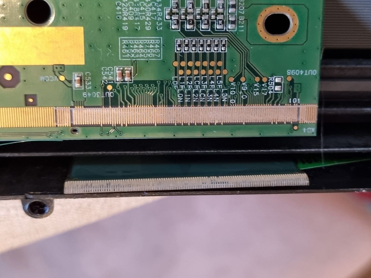

    So I replaced the backlight strips but unfortunately in reassembling the TV a FFC from the screen became detached from the driver board. There's no FFC socket, it looks to me that the FFC was bonded directly to the driver board in some way. Can these connections be restored or should I scrap the TV?
    This is the disconnected FFC.

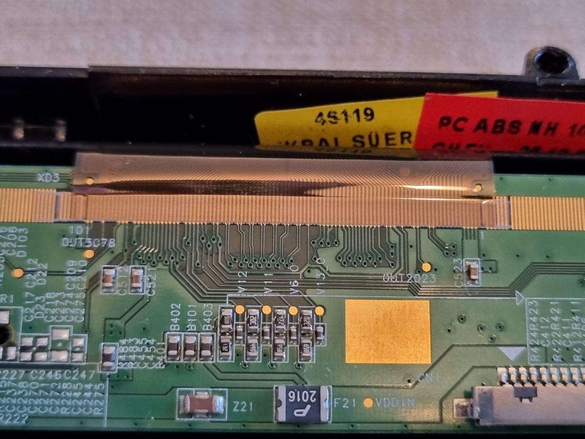

    and this is one of the others that is still connected.

    #7 21334636
    Telo
    Service technician RTV
    Posts: 13116
    Help: 1522
    Rate: 2366
    It is doable, just needs to be kept clean and preferably with a microscope.

    Thanks @ivtv1 and @Telo. I wasn't sure that the disconnected FFC was the only problem, because the symptom I was getting after replacing the backlight wasn't the dark vertical band on the screen that I expected from that broken connection, it was more than that - it looked like a loss of sync. Anyway, I followed that video, using acetone to remove the residue of ACF, then no-clean flux and solder to tin the fingers on the FFC and PCB, removed all the solder bridges between the fingers, then more no-clean flux and the soldering iron (without solder) to solder them together. I reckon I did a reasonable job.
    However, after reassembling the TV the screen still shows loss of sync. I guess I must have damaged something else. I tried reseating the FFC that runs between the main PCB and the driver PCB at both ends (which have proper FFC connectors) to no avail. So I shall scrap the TV. It's quite old and the smart apps were so excruciatingly slow as to be unusable anyway, so it's not a big loss.
