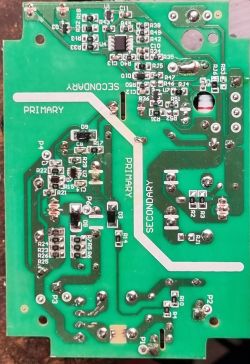

Falke Battery Charger Short: Replace Diodes or Other Issues After Water Damage?

    peterhambergph
    View of a circuit board from an older Falke charger with visible electronic components, including burnt diodes. Shorted circuit board for older Falke battery chargers for power drill. Three diodes burned. Is it just to replace them or could there be other causes of a short circuit? Water got into the charger... What kind of diode is it?

    Show accurate macro photos of both sides of this board. The markings on the components must be clear, otherwise it will be difficult to help anything. More damage may have occurred after flooding with water.

    This charger has some kind of transformer. Water may have remained in its windings. You need to determine whether it caused damage to the insulation.
