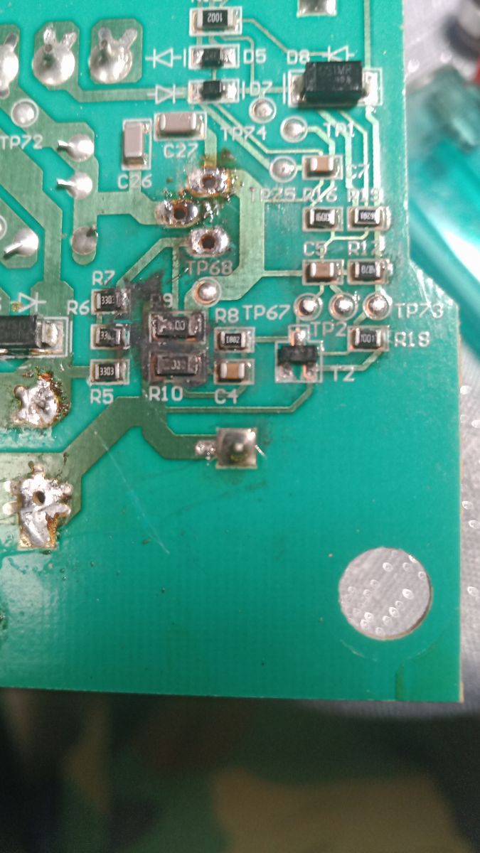

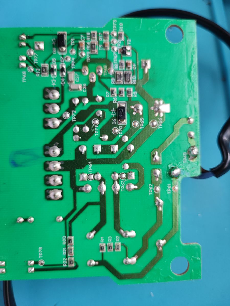

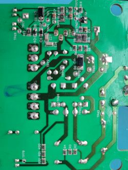

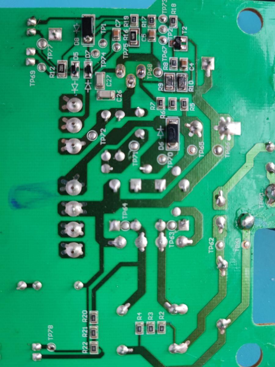

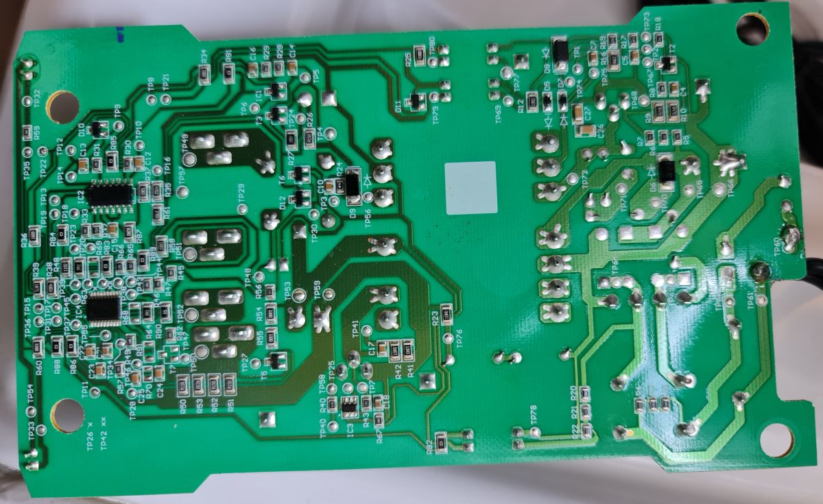

    hello,
    I have a charger as in the subject.
    The charger, according to the user's description, "breathed fire" during normal operation and has not turned on since.
    After opening the housing, I located the place of damage, actually blackened both the PCB and the housing from the inside.
    Bosch 18V-40 Charger - Identifying Damaged PCB Components, Transistor W1A, Resistor Values Bosch 18V-40 Charger - Identifying Damaged PCB Components, Transistor W1A, Resistor Values
    And now a question for you - does anyone know the values of the resistors and what kind of transistor it will be?
    From another thread about 1880 I only learned that the transistor may be W1A, but I am not sure.
    will you help?

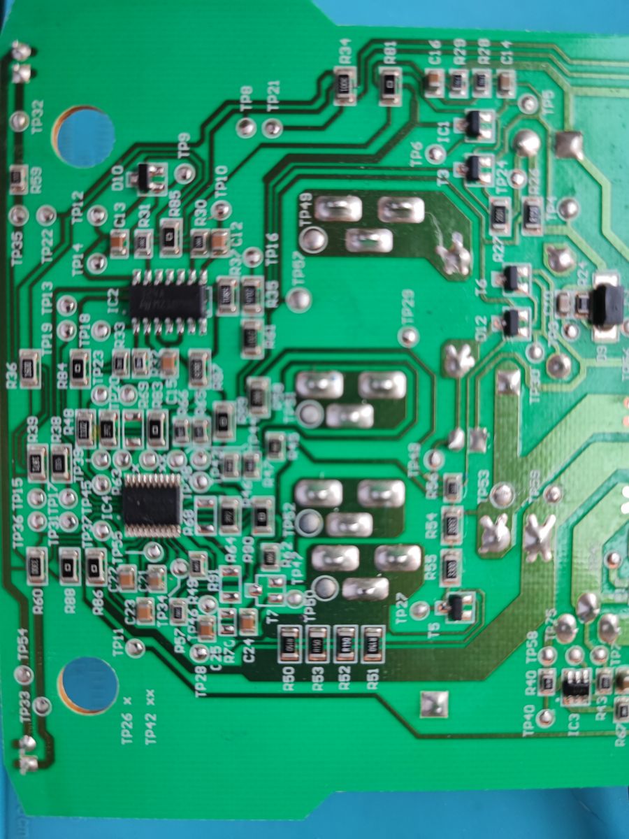

    1. There is no full information, photo of the rating plate/label...... I understand that this is a Bosch GAL 18V-40 charger?
    2. Take more macro photos so that you can see what, for example, the driver is. Also check the key (power transistor) and if it is burned, or rather it just happened, desolder it and also take a clear photo of it.
    3. Also check if there are fuse, rectifier, starting thermistor, electrolytic capacitors.
    4. Make the first start-up after repair by powering the charger in series through a 25-40W tungsten bulb. If the bulb remains bright without the battery, the repair has failed.
  • #3 19488790
    carl0s
    Board Language: polish
    1. Yes, it is GAL18v-40.
    2. Photos - I can take a microscopic photo of each fragment, however, I looked at the whole thing from both sides and the visible damage is only those from the first post and the 2.5a fuse, which I did not mention because I considered it too obvious.
    Bosch 18V-40 Charger - Identifying Damaged PCB Components, Transistor W1A, Resistor Values Bosch 18V-40 Charger - Identifying Damaged PCB Components, Transistor W1A, Resistor Values Bosch 18V-40 Charger - Identifying Damaged PCB Components, Transistor W1A, Resistor Values Bosch 18V-40 Charger - Identifying Damaged PCB Components, Transistor W1A, Resistor Values Bosch 18V-40 Charger - Identifying Damaged PCB Components, Transistor W1A, Resistor Values Bosch 18V-40 Charger - Identifying Damaged PCB Components, Transistor W1A, Resistor Values Bosch 18V-40 Charger - Identifying Damaged PCB Components, Transistor W1A, Resistor Values Bosch 18V-40 Charger - Identifying Damaged PCB Components, Transistor W1A, Resistor Values
    Unfortunately, none of my friends have this charger model to check the markings of damaged elements.
    I would replace the power transistor right away, but Google does not provide any replacement.

    Well, you see, and there was no plate to know what power this charger consumes.....
    But I found nothing that it is 95W, which at 230VAC mains voltage should give slightly less than 500mA effective current.
    And now, assuming that it is a flyback power supply, i.e. the most likely type, it concludes a bit on the nose that the parallel connection of R9 and R10 should be about 100mR, i.e. R9 = R10 + 200mR. But I don't know and it could be different.
    You would have to experiment with different resistors, e.g. from 1R and then down and measure the drain currents and the charging current. Check if the transformer is not saturating (oscilloscope) and accordingly correct down the transistor current by increasing the resistors in its source (R9+R10).
    Unfortunately, I do not see what the charger controller is, but it is probably a programmed uC, so you have to follow the above.
    Selection of the transistor ... and here I am wondering about the drain current, because why 8A with a power of about 100W? Maybe 2A would be enough here?
    The breakdown voltage is worse, because perhaps 600V is not enough here.
    Well, maybe "on the cheap" STP3NK90ZFP. 5x higher resistance, i.e. 0.9R vs 4.8R at an average current of 500mA, will not cause significant power losses here.
    Check out T2 again. I don't like his face

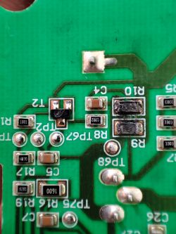

    I have a similar problem.
    And here is my question regarding the burnt T2, R9 and R10 elements. Is it possible to select and start the charger? If so, please provide them.

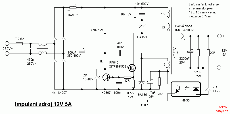

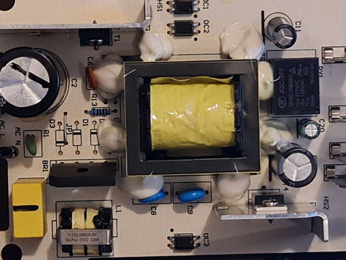

    It seems that there are only 2 transistors on the primary side, in which case you can use e.g. BC848 or faster MMBT3904 instead of T2. But first check if the PIN'out matches because I have the impression that in this transistor the base is in the middle.
    Most likely, on the primary side, the power supply will resemble this arrangement:
    I do not know what value the resistors R9 and R10 have, but you can risk, for example, 1R. The simulator gave me a parallel connection resistance of about 400mR, i.e. R9=R10=800mR.

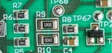

    Generally, R9 and R10 are two of the same 1R00 1/4W resistor (size 1206). As for the T2 transistor, I'm not 100% sure, but it's 90% 2n3904
    I am struggling with the repair of this charger myself, after replacing the transistor T1, T2, T4, diodes from the bridge, resistors R9 and R10, the bulb still does not go out.
    The charger does not have a classic Schottky diode at the transformer output, but is based on the AT10700P MOSFET (T4) transistor. I did not find any other burns or low circuit resistance on the board. Because of the 40W bulb, I also did not find places that would cause heating (unfortunately, the test was done with IPA, because there is no thermovision). This pi ... varnish does not make it easier to diagnose either.
    On the positive side, applying power to C11 caused the green diode D13 to light up, so there is a shadow of hope that the ICs survived.

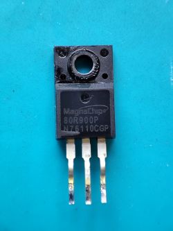

    Hello, I have just repaired my charger, just like yours
    80R900P
    T2 =W1A, = PMBT3904
    R9 and R10 = 1ohm,
    gretz bridge
    8S150L thermistor
    F1, 2.5A
    but on the secondary side it failed
    electrolyte,
    2 pcs R55 and R54 330 Ohm
    IATPN = MP6907GJ-Z which had a short circuit.
    After replacing the above elements, the charger came back to life
    As a preventive measure, I added a larger heat sink to the mosfet

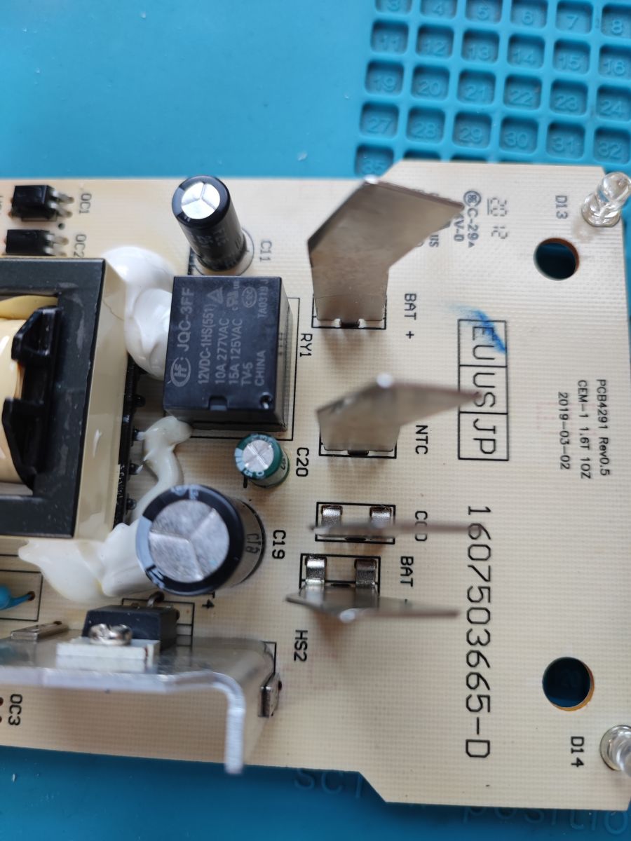

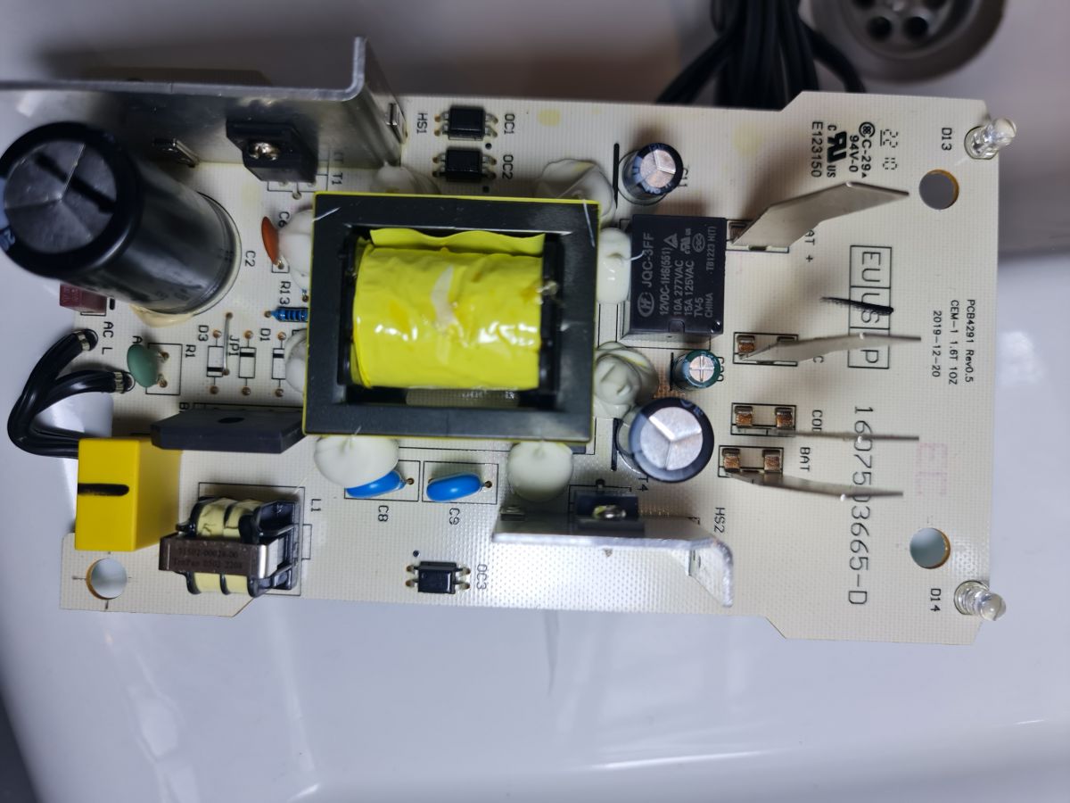

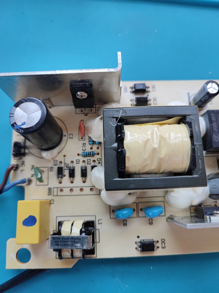

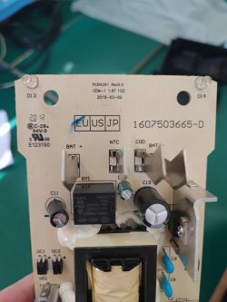

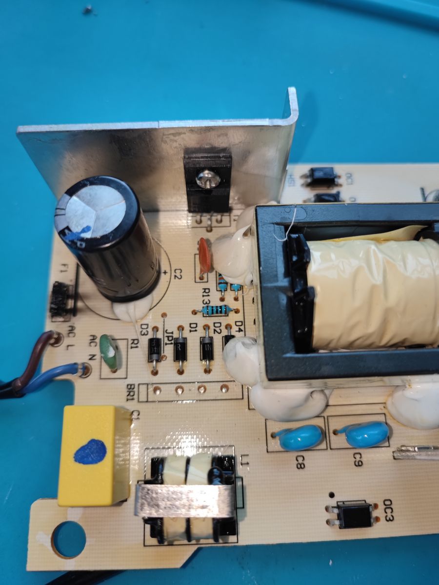

    Can anyone advise on a way to convert this tool to use 240VAC? I have a US version (120V) similar to the original poster's with some slight differences.
    1. It has a GBU808 on BR1 instead of the diodes, D1-D4.
    2. JP1 is installed on mine, as opposed to what was originally posted
    Circuit board with electronic components, including a transformer, capacitors, and a GBU808 bridge rectifier.
    There are similar guides on the Internet for other brands of chargers but not for this particular one. Usually the JP1 would be reduced and a bigger varistor installed.
    Hopefully the additional pictures help in understanding
    Close-up view of a circuit board interior with various electronic components.
    Charger circuit with electronic components on a printed circuit board.

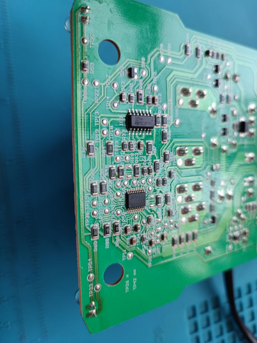

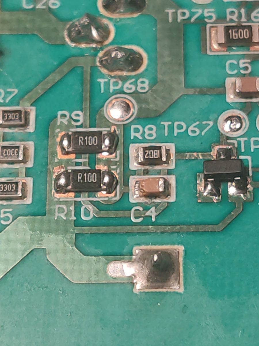

    I have a faulty 18V-40 charger, I have replaced the faulty components and after connecting through the bulb, the bulb flashed slightly , upon inspection you can see a eaten C4 capacitor.
    What should be its value? Close-up of a damaged circuit board with the capacitor C4 visible. .

    This capacitor is 1uF and I also replaced it at my place
  • #18 21211919
    yaro77
    Posts: 192
    Rate: 33
    1uF just for how many volts ????
  • #19 21211928
    gracus7
    Level 26  
    Posts: 1236
    Help: 37
    Rate: 200
    This capacitor is not an electrolyte. Pull a similar one from some demob board.
  • #20 21211941
    yaro77
    Posts: 192
    Rate: 33
    Super only these SMD capacitors were for 25V and 100V , the ones for higher voltages rather have larger dimensions.
    I know they are not electrolytes.
  • #21 21211946
    gracus7
    Level 26  
    Posts: 1236
    Help: 37
    Rate: 200
    So you have answered yourself. Take the same dimensionally and it will be ok.

  2. Power up with no battery attached.
  3. If the bulb dims after one second, the primary is healthy; if it stays bright, disconnect and re-check parts [Elektroda, jaeger, post #19488406]
6. What thermistor replaces the cracked 8S150L inrush limiter?
A 15 Ω cold-resistance NTC 15D-15 fits electrically and mechanically; several users installed it successfully [Elektroda, jaeger, #21507091; kakaowiec1, #21506947].
7. What is the value and voltage rating of capacitor C4?
C4 is a 1 µF multilayer ceramic capacitor. Size and dielectric give it at least 50 V DC rating; any same-size 1 µF X7R part works [Elektroda, gracus7, post #21211886]
8. Can I lower the charging current to reduce stress?
Yes. Desoldering one of the four 0.05 Ω current-sense resistors (e.g., R51) drops output current from 4 A to roughly 3 A without error codes [Elektroda, pacraf, post #21460370]
9. How do I convert a 120 V US model to 240 V mains?
You must:
  1. Open JP1 (voltage selector link).
  2. Fit a 470 V MOV in place of the original varistor.
  3. Confirm bulk capacitor is 400 V rated. Skipping any step can destroy the MOSFET on first power-up [Elektroda, matanda, post #21042988]
10. Why do I measure AC on the battery terminals?
A shorted primary-to-secondary transformer winding or failed MP6907GJ-Z synchronous rectifier lets high-frequency AC leak to the output. Replace the controller and inspect the transformer for carbon tracking [Elektroda, holymakrels, #21263861; gracus7, #21319915].
11. What does the IATPN / AITPP code signify?
It’s the factory laser code for MP6907GJ-Z, a synchronous rectifier controller used instead of a Schottky diode to raise efficiency [Elektroda, gracus7, post #21319915]
12. The unit powers but shows no secondary voltage—where to look?
Verify R54 and R55 (330 Ω), the bulk electrolytic near MP6907GJ-Z, and the optocoupler OC1 that drives T1. Failed 330 Ω resistors stop feedback, so T1 never switches [Elektroda, gracus7, post #21356135]
13. What rare edge-case causes repeated MOSFET blow-ups?
If the flyback transformer primary is shorted to the core, it can spike over 800 V, instantly puncturing replacement MOSFETs even when all other parts are new [Elektroda, yaro77, post #21356879]
14. Three-step quick fix for the classic burn-out fault
  1. Replace T1 (80R900P), T2 (PMBT3904), and both 1 Ω shunts.
  2. Inspect and re-solder the MOSFET heatsink pad.
  3. Power-up through a 40 W bulb; if the bulb dims, reassemble and bench-charge a 2 Ah pack. Success rate exceeds 90 % in forum reports [Elektroda, pacraf, post #21460370]
