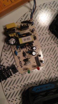

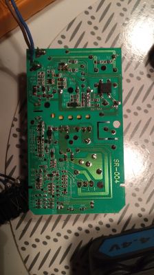

    My MacAllister screwdriver battery charger broke recently. I have no experience in repairing this type of equipment, but I opened it, checked if there was voltage at the end (on the contacts where the "pins" of the battery go) and it is not. The diodes are off, the battery is not charging or heating up. The charger did not come into contact with moisture, it was not kept outside.
    Below are photos of the disassembled charger. I wanted to ask you, are you able to assess what could have broken in this charger and if I can repair it with your help? Thank you in advance for your help.

    No, you are not able to fix it yourself with home appliances :(

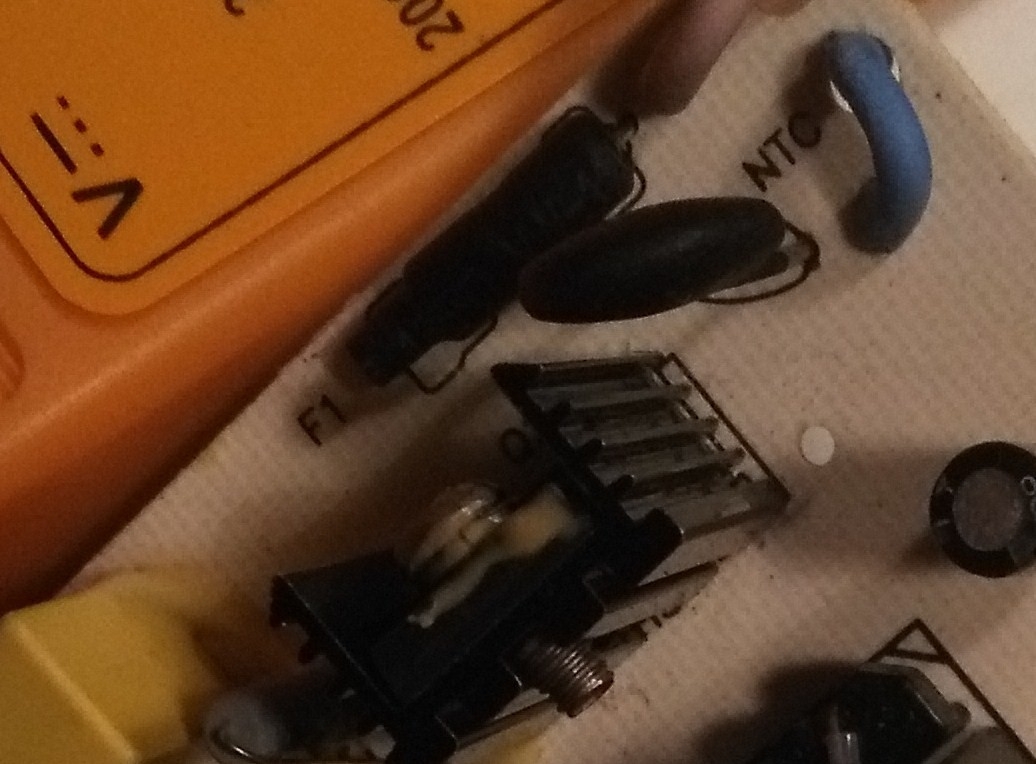

    Hello - please check with a multimeter this element marked on the PCB as F1
    (it is a fuse).
    Added after 52 [seconds]:
    Assessing and Repairing a Defective MacAllister Screwdriver Battery Charger

    @jtek 9007 I checked the fuse and the voltage is approx. 10 V weaker than at the input (203-4V, at the input 213-214V).
    @automobilklub There is a voltage of 14.75V at the battery contacts, so probably approx.

    You are not even able to properly check the fuse. You know what kind of animal this is, that fuse or not?

    The fuse should be checked with a multimeter (diode, buzzer).
    If the fuse is good, please measure the voltage on the electrolyte
    maybe (320 V) - I noted in the photo.
    Added after 51 [seconds]:

    @jtek 9007 Ok thanks for your patience. I checked the fuse, it shows 1, it is not approaching 0 and there is no voltage on the electrolyte.

    Because the converter does not start, did you check the power supply of the chip?

    So what is the conclusion of this? Is this fuse good or not good?

    Forgive me for not answering for so long, but I waited for the fuses I ordered. So I replaced the defective fuse, the charger still doesn't start. I checked the voltage on the electrolyte and it is still gone.
    @bearq - could you explain how to check the power supply of the chip or this converter? As for whether the current goes to the plate then yes.

    You check what the scalak is, look for its documentation on the internet from which you can find out which outputs are responsible for what. You check the power supply of the chip and if you do not have it, you are looking for a power problem by deduction. If the power supply is only an oscilloscope and measurements ...

    Unfortunately, I could not find the scaler diagram, and on Castorama's website I got information that the charger can be purchased separately, so I close the topic. I would like to thank everyone who tried to help and devoted their time. For those who came to the forum "Beginners Repair" to mock and write that someone is "green in the subject", I suggest finding another hobby. I hear masturbation is a nice thing :D
