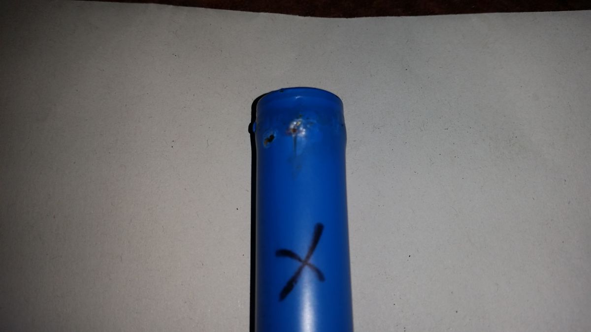

    Close-up of a circuit board with a battery. Mine is D4 and marked M7
    Check the batteries
    Blue battery with markings and a cross on the casing.
    tension on them.
