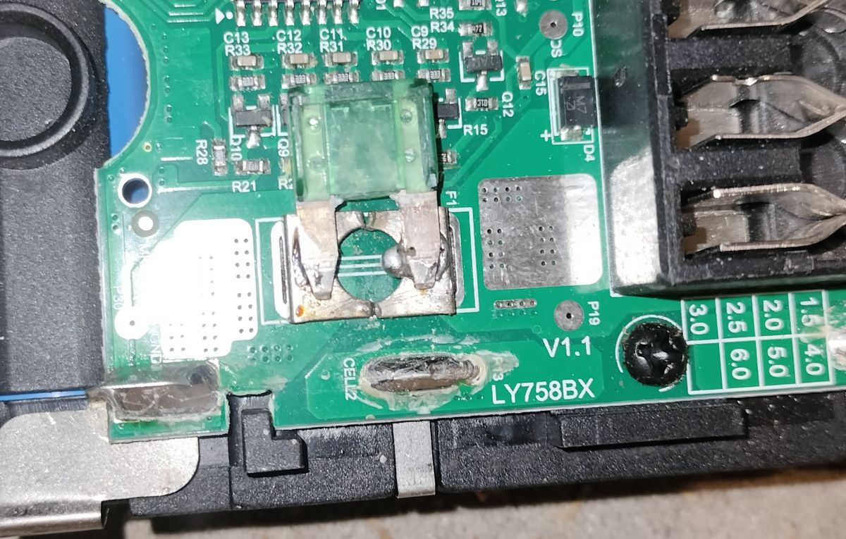

    Hello, a new Parkside battery, once used, connected to the charger, no reaction, burned plate after opening, how to fix it? Parkside Battery - New Parkside Battery once used and no surge charge Parkside Battery - New Parkside Battery once used and no surge charge

    @rdmagic The machine got pretty good over the ears :cry: , since the shunt current measuring resistor, that is this "plate", has burned out. Try to clean the broken ends and solder them together with the applied several millimeter sections of the wire. The charging characteristic will of course change (change of the shunt resistance), but maybe it will work for some time.

    @rdmagic Yes, but where are you going to get it, besides, it already had time to change parameters due to overheating. He has two tasks - measuring the current and as a fuse. First, solder these ends and see if the battery is charging. Burned in the tool or charger? And I would like the model of this drill, I will calculate what fuse to put in there instead.

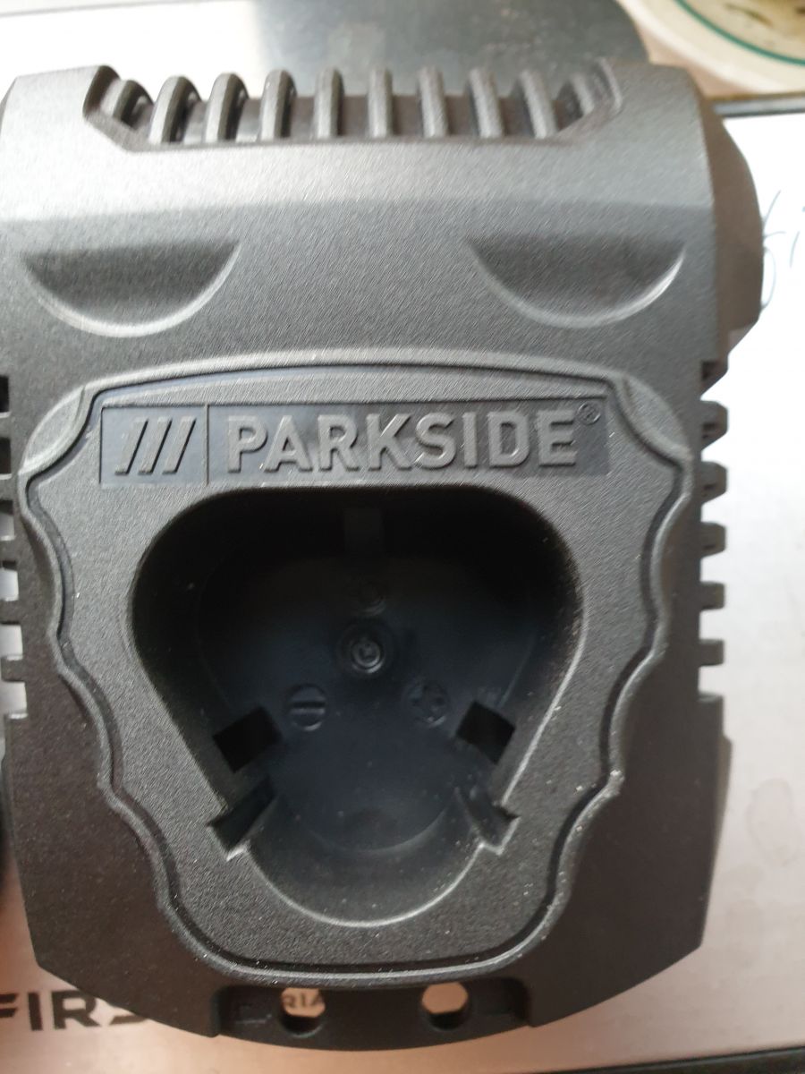

  • Battery ID contact required for charging communication
    #12 19421988
    g107r
    Posts: 5293
    Help: 811
    Rate: 996
    ID's probably an identification or something.
    So that another battery does not move in the screwdriver or charger, until this contact connects the battery electronics with the electronics of the screwdriver / charger.
    Two of the same chips (one in the battery and the other in the charger) must communicate with each other, because at least for me, without this communication, the ID is not charged.
    Yes, if I have, laptops with power supplies with such an additional contact have the same, a wrongly identified power supply, "not original", may lower our clocks or not charge the battery.

  • #13 19429988
    El Diablo
    Level 20  
    Posts: 627
    Rate: 50
    I bought a charger and there is no chip inside, interestingly there is not even a minus :D
    I only noticed when I got it going.

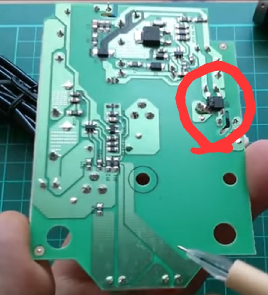

  • #14 19853196
    kvenihakis
    Rate: 8
    Could you please tell me the type of the Q1 MOSFET?
    Thanks in advance.

  • #16 19854335
    kvenihakis
    Rate: 8
    Thanks for the quick answer but I still can read all the letters. CM5N...

    Ambor12
    Hello, I had a similar problem. I soldered a 30A car fuse and after the topic. It works, the charger charges to full. Parkside Battery - New Parkside Battery once used and no surge charge
