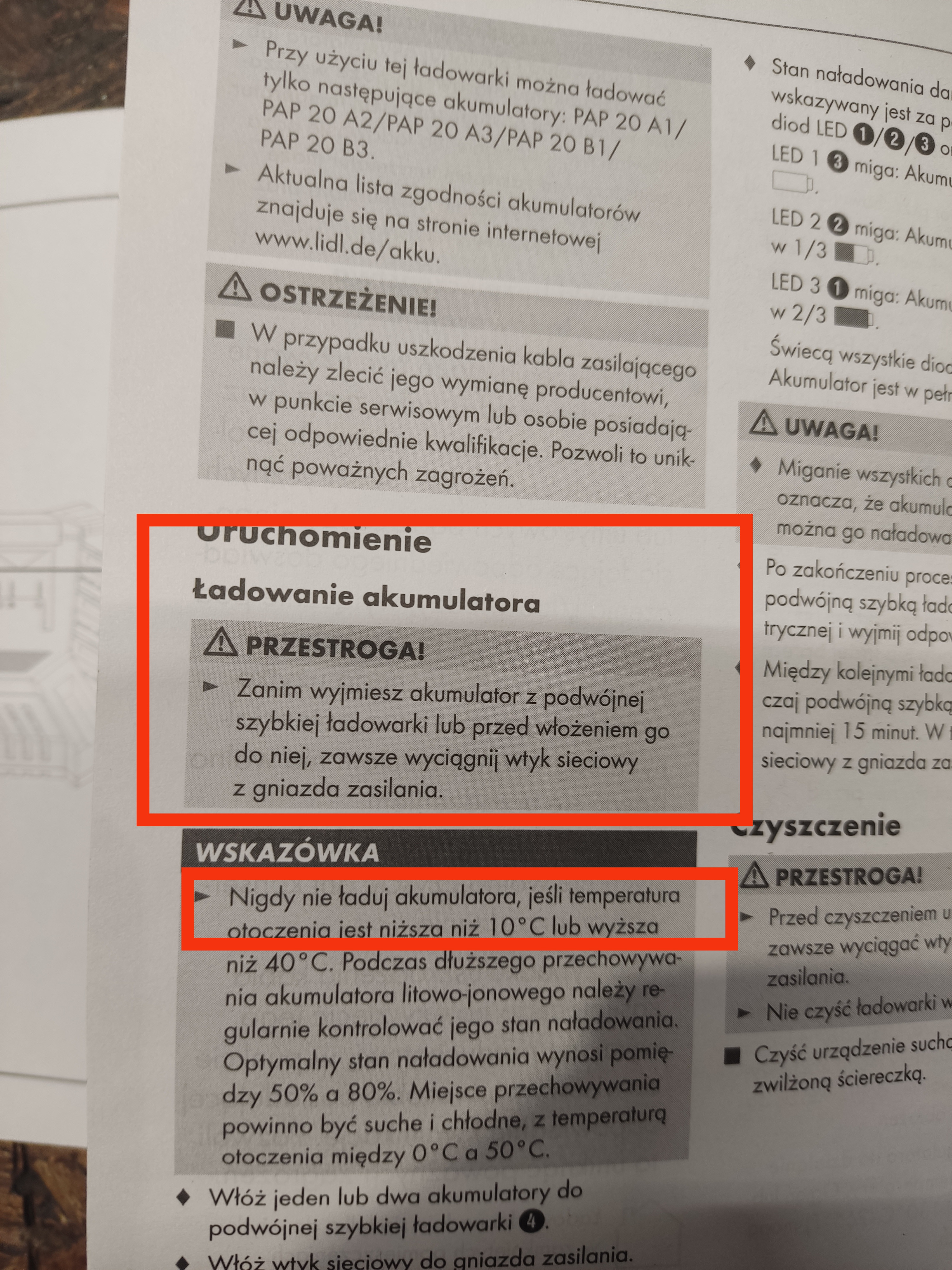

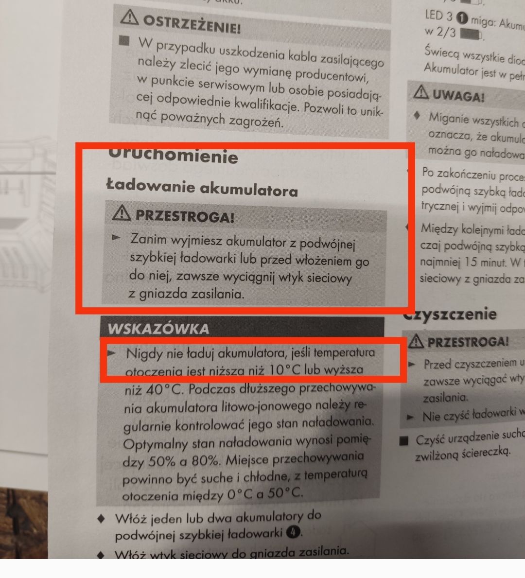

    I confirm that these Parside chargers from Lidl are in great demand, probably 4 of them have gone up in smoke in the company for 1.5 years. I heard that the topic is known, some triac is falling apart and I can`t find it anywhere.
    It is quite possible that the charger is being used inappropriately, and when reading the manual I see the following sentences:
    Section of a user manual regarding battery charging.
    My question is that I have Parkside 2A and 4A batteries and chargers that say 2.4A and 4.5A. Will inserting a 4A battery into a 2.4A charger damage it?
