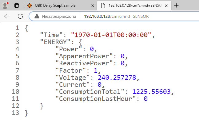

    Is it possible to pull the current BL0937 readings from the socket on BL602 with BL0937 via http request e.g. GET?
    I know that openBL is compatible with requests from Tasmota, but I can't find anywhere how to get a JSON response from the voltage measurement module
  • Tasmota-style SENSOR HTTP GET on BK7231
    #2 20944792
    Posts: 14797
    Rate: 12954

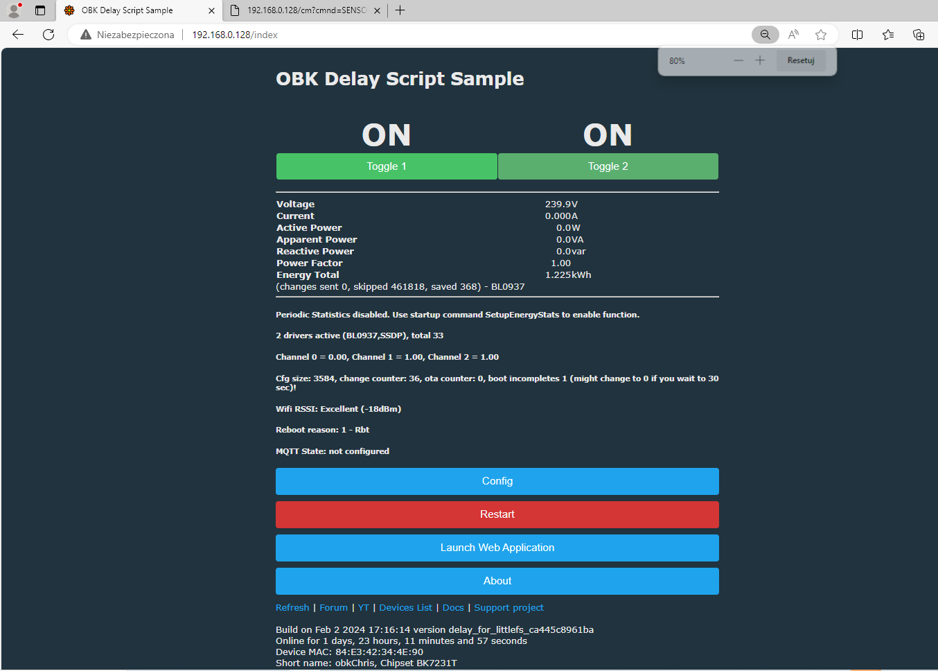

    You should be able to give as in Tasmota. See how it looks on me on BK7231:
    Screenshot of the OBK Delay Script interface with data on voltage, current, and other parameters. Screenshot showing JSON data with energy readings, including voltage 240.257278 and time 1970-01-01T00:00:00.
    I used URL:
    http://192.168.0.128/cm?cmnd=SENSOR
    Time shows 1970 because NTP I did not run. Check if it works on BL602 and let me know, I actually never had the BL602 + BL0937 combination and I have opened hundreds of devices.

    Mad_Maxs
    Posts: 81
    That's exactly what I was looking for :) on BL602 with BL0937 it looks identical :) and there's a date cap on me too, because the iot network has no output to the world, nor even to the local ntp :) Thanks again for your help :) .
