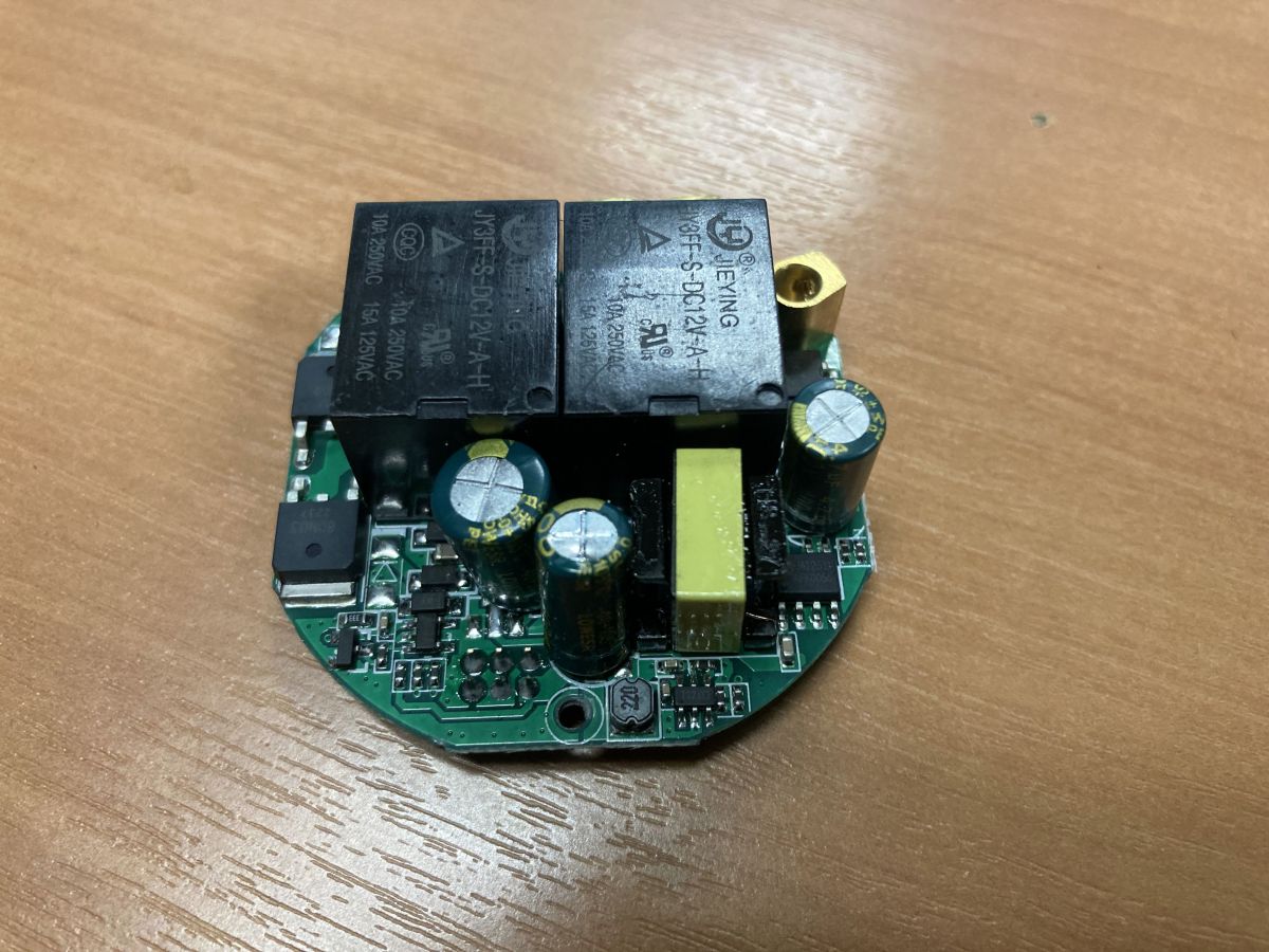

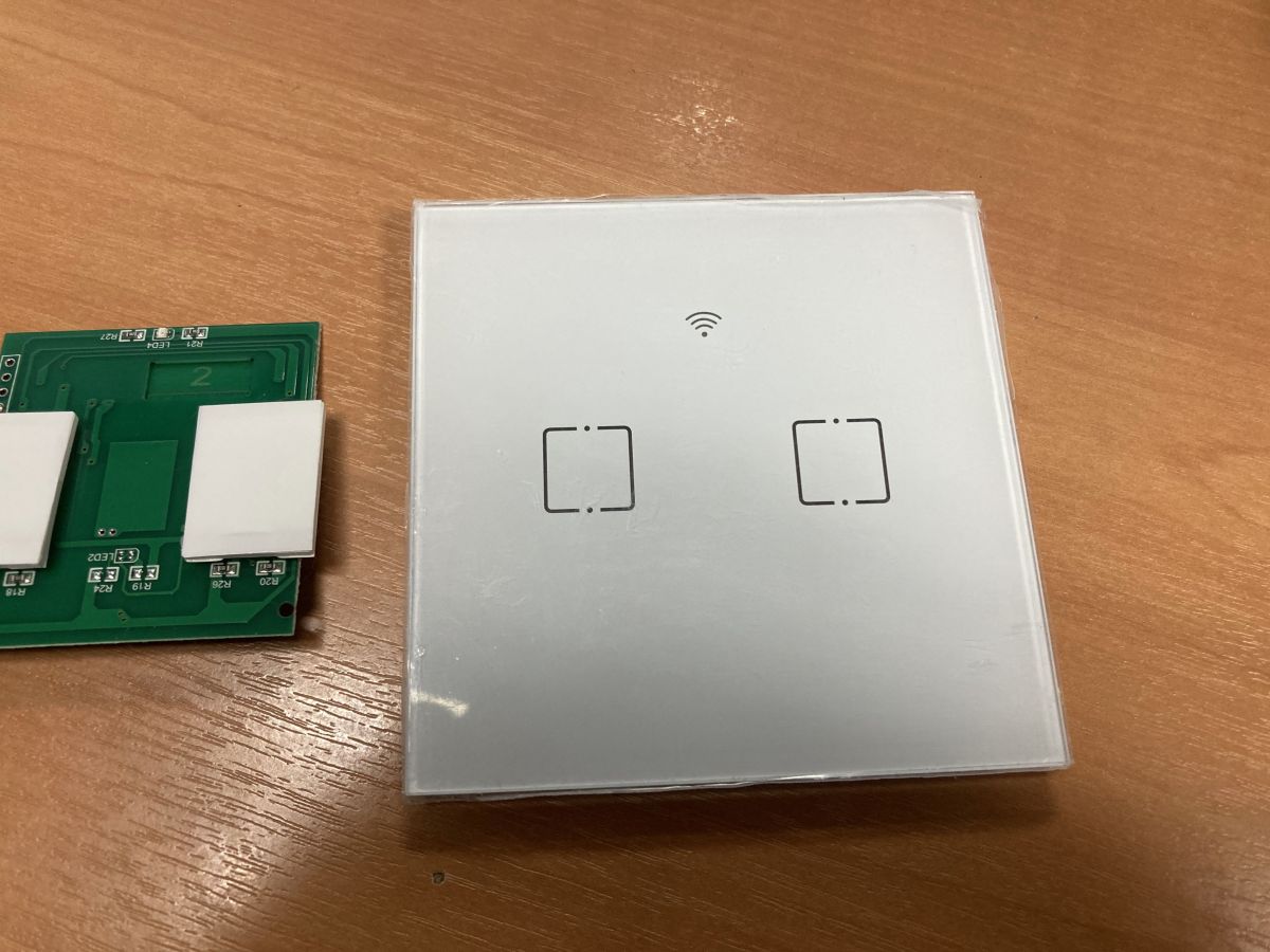

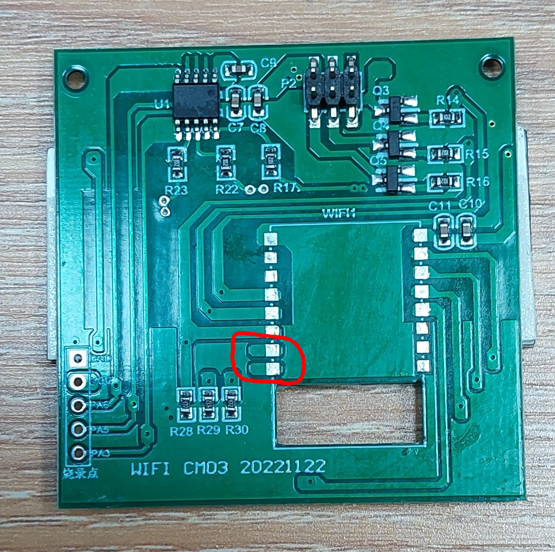

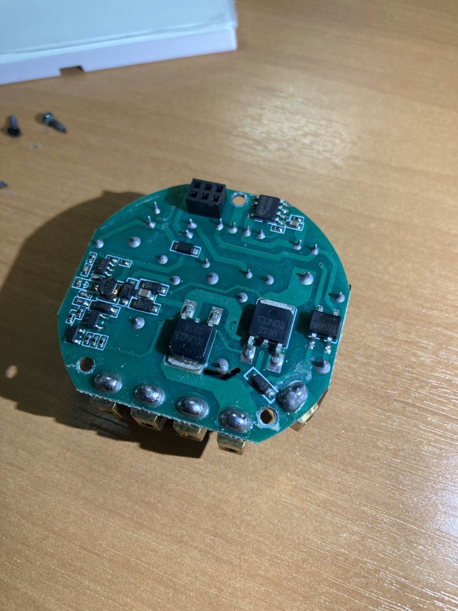

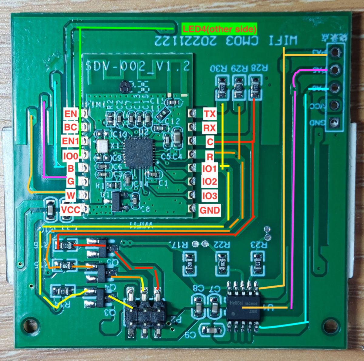

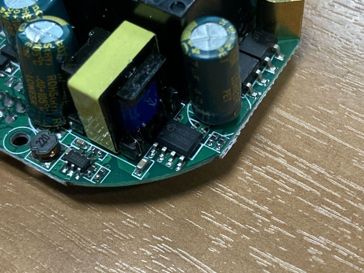

    I bought a 3-gang switch from Aliexpress.
    https://www.aliexpress.com/item/1005005118608300.html
    The switch contains a module with BL602 chip.
    Info on BL602 Module SDV-002_V1.2 from Aliexpress 3-Gang Switch, Pin Compatibility & GPIOs

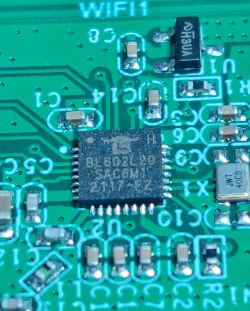

    As shown in the first photo, the module is SDV-002_V1.2.
    I could not find any information on this module. The closest one I found was BL-62B module with the same number of pins and partially pin compatible with ESP-07.
    In the second photo, three transistors in the upper right corner are connected to the pin header, and I am guessing that they drive the relays, hence connected to GPIOs on the left side of the module.
    I am also guessing that GPIOs on the right side of the module are connected to a 10-pin touch chip at the upper center of the board for driving the three touch switches.
    The via at the bottom (right under the marking "20221122") is connected to the WIFI LED on the other side of the board.
    However, there are my guesses. I could not find any info on this module...
    Any help on the pinouts of this module would be appreciated.

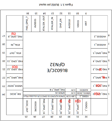

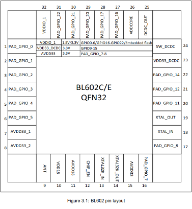

    I don't know this particular module but we know BL602 pinout:
    You can easily map the pins that way, especially if you have physical access to the board and the multimeter with a continuity test mode.
    I've started the job for you, can you finish the mapping? You need to probe remaining pins with multimeter to check where they are going;
    Added after 3 [minutes]:
    Btw I noticed one more thing.
    it looks like TYWE3S form.
    The VDD/GND locations are matching, and it seems CEN/RST are connected.
    Maybe TXD0 and RXD0 are in the same place as well?
    See:

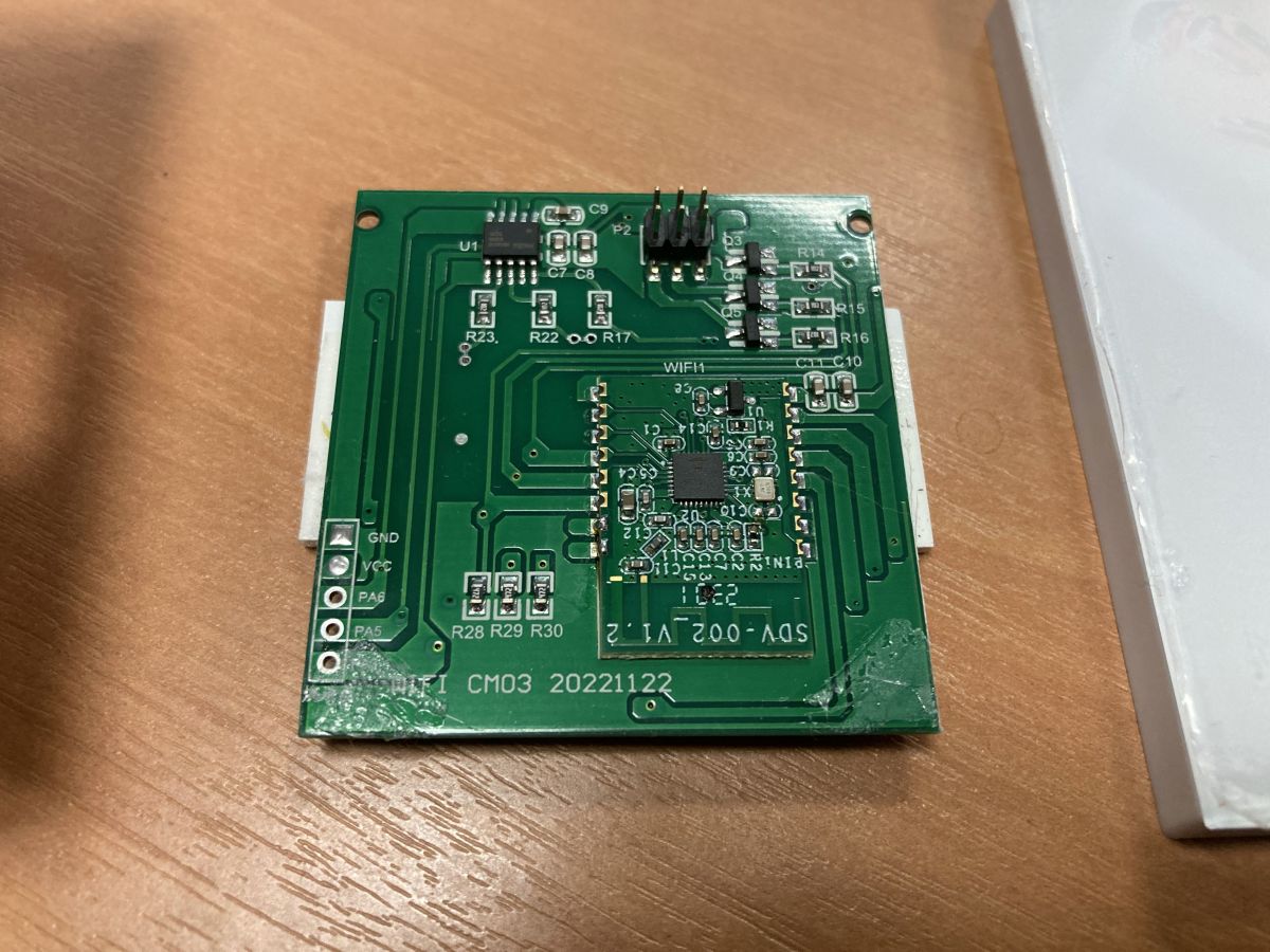

  • #3 20531763
    patentjyp
    Posts: 20

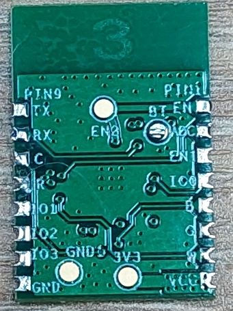

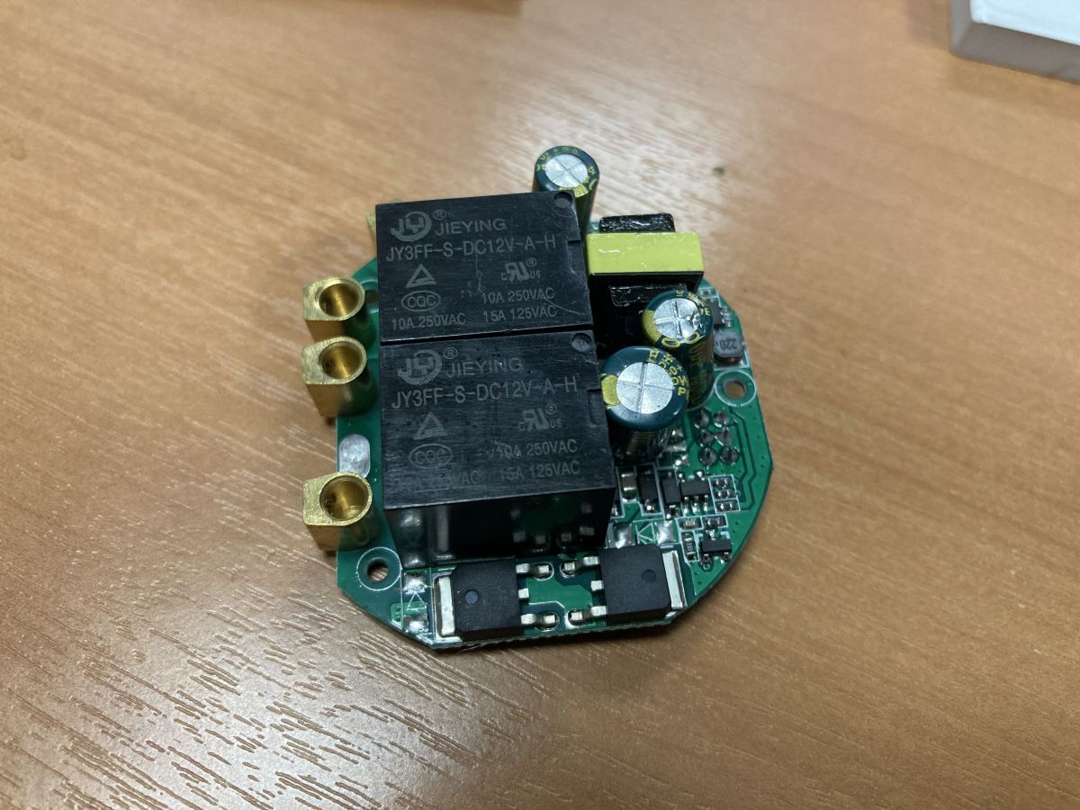

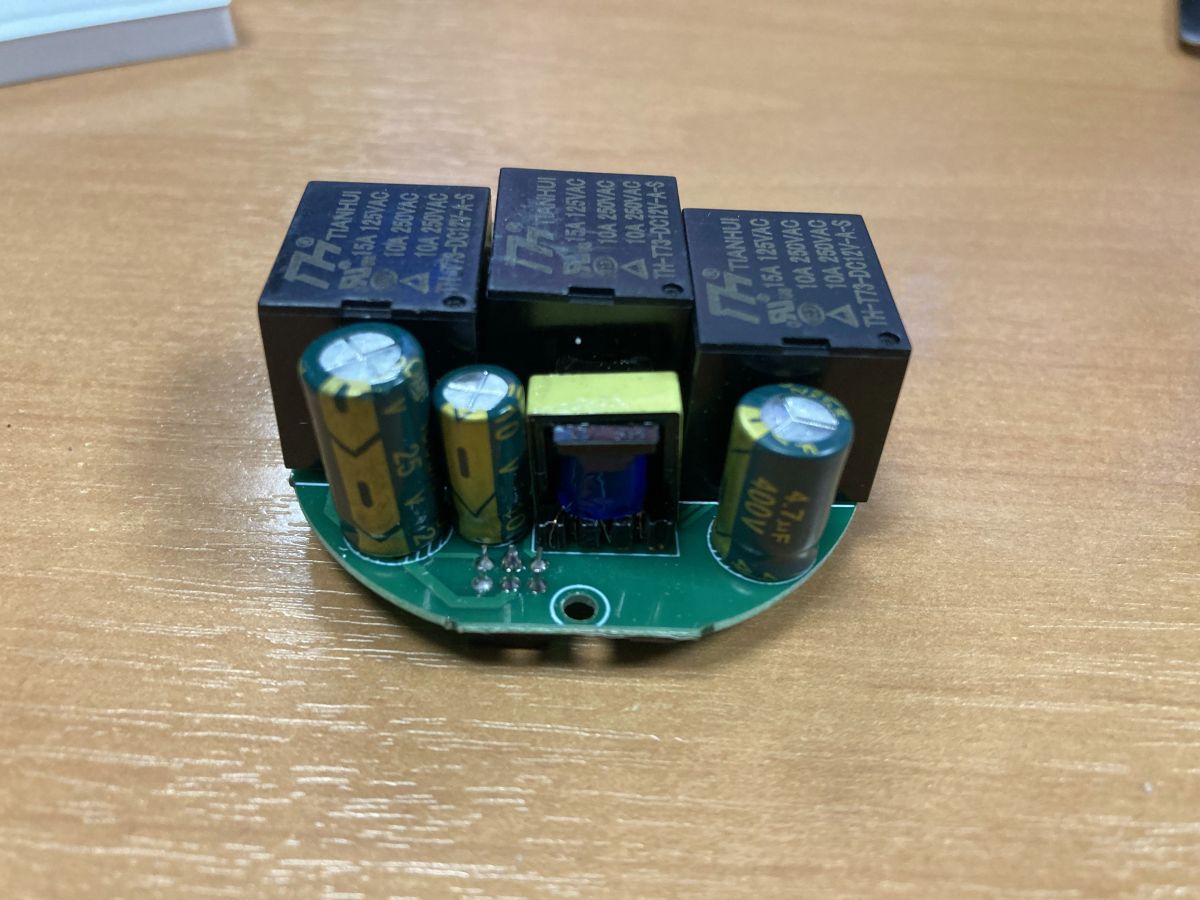

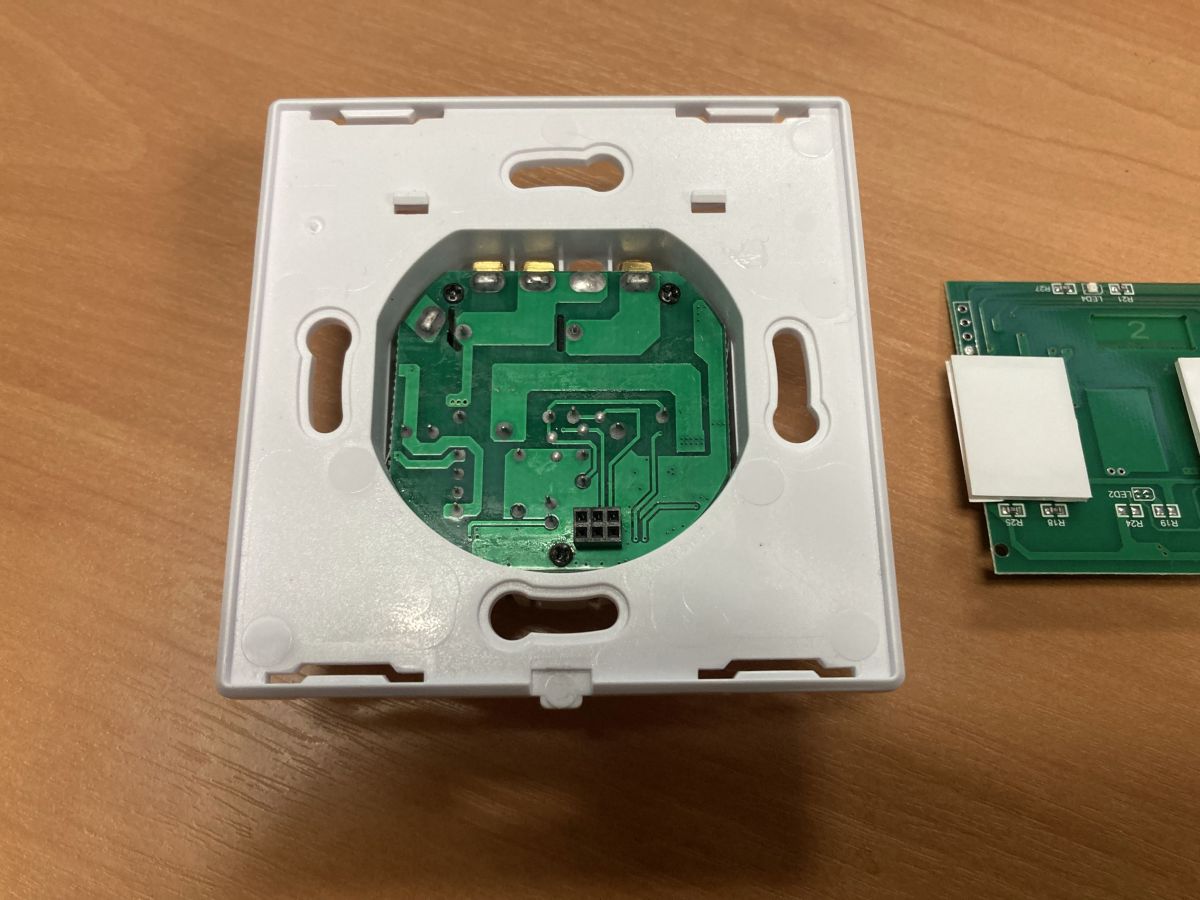

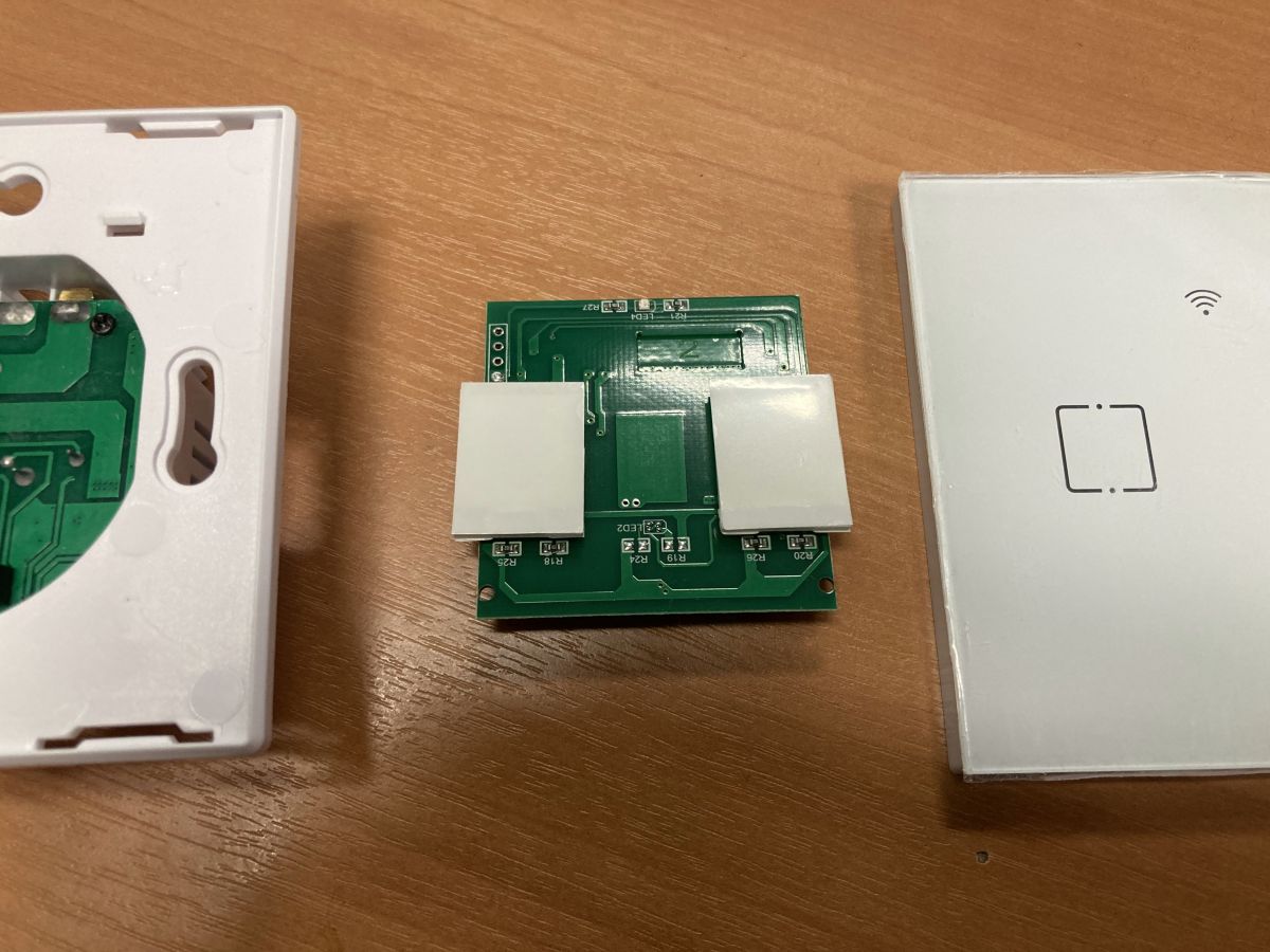

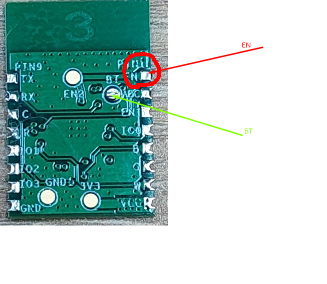

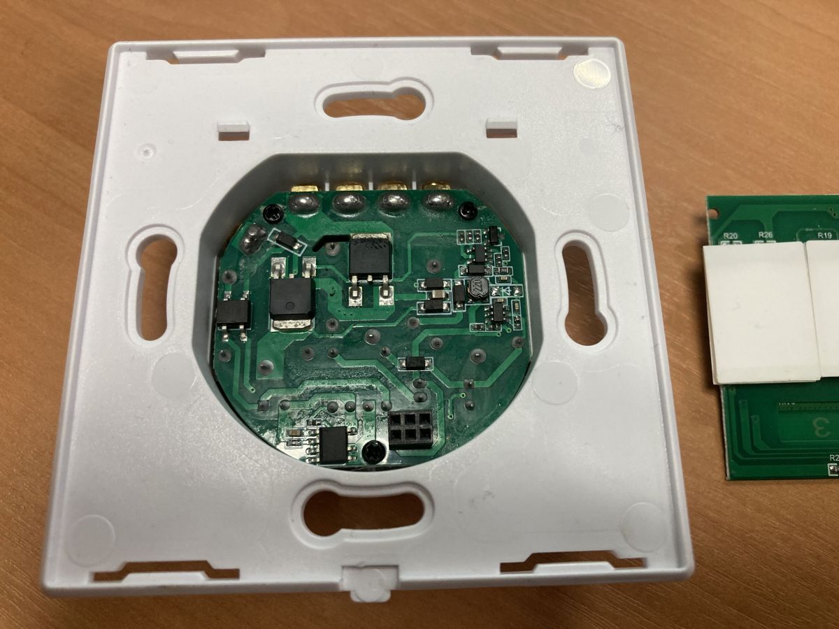

    I will remove the module and take a photo of the bottom surface of the module.
    Added after 19 [minutes]:

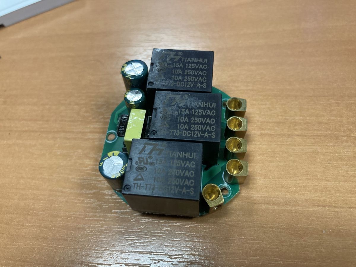

    Here are the photos of the module and the PCB without the module.
    Info on BL602 Module SDV-002_V1.2 from Aliexpress 3-Gang Switch, Pin Compatibility & GPIOs Info on BL602 Module SDV-002_V1.2 from Aliexpress 3-Gang Switch, Pin Compatibility & GPIOs
    There are some pins that I am not familiar with: B, G, W pins and C, R pins...
    These pins are used to drive relays and touch switches..
    BTW, the pads on the PCB for TX, RX and EN pins are not connected to anything (No PCB traces on the back side).

    Why do you think that RX is not connected? It looks like connected:
  • #5 20531946

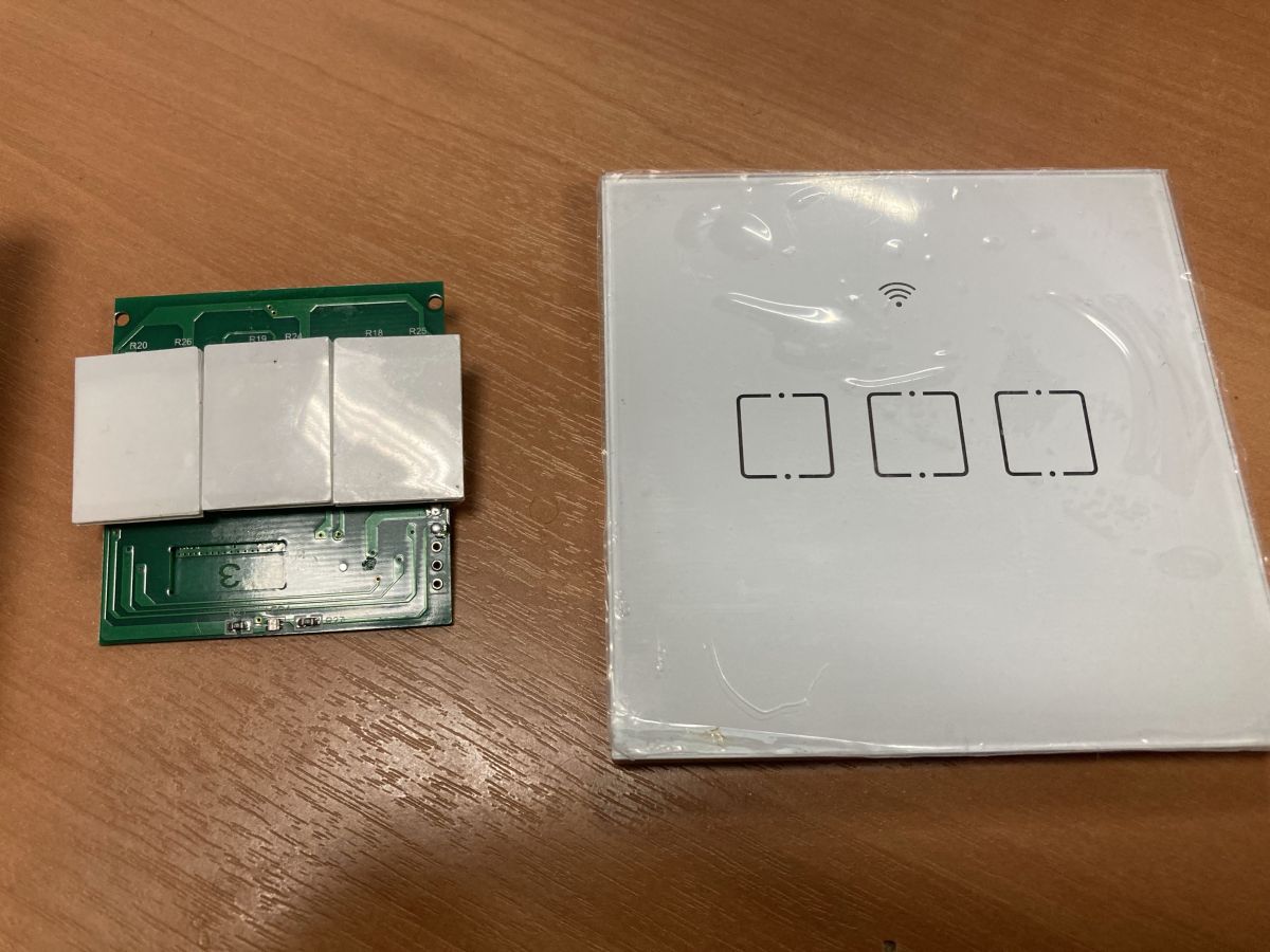

    patentjyp
    Posts: 20
    In the module, RX is connected, but if you look at the PCB, it's just a pad without any connection.

    It doesn't matter much. For BL602, for flashing, you need RX, TX and boot, please see:
    https://www.youtube.com/watch?v=bs0ylC6xRs0
    https://www.youtube.com/watch?v=L6d42IMGhHw
    Btw, where are those pads connected?

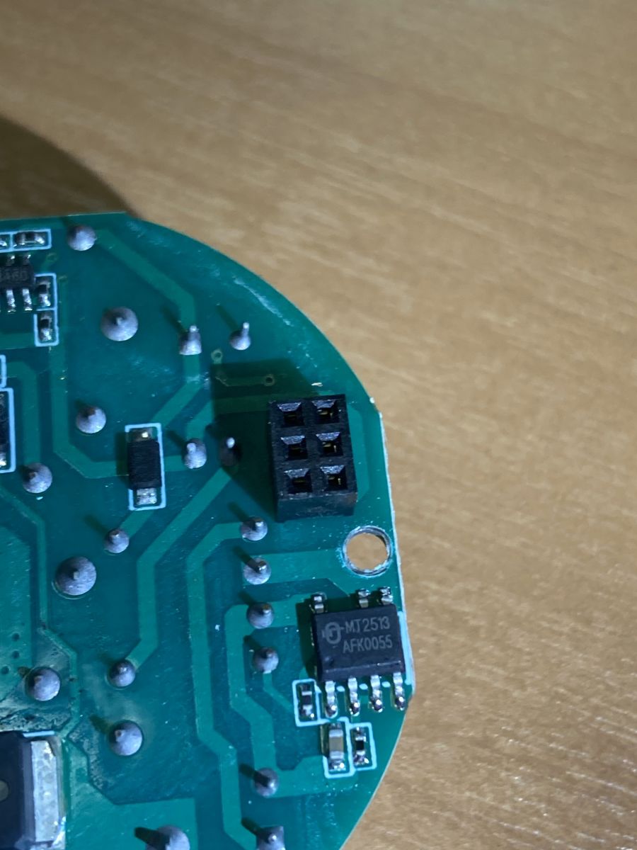

  • #7 20532117
    patentjyp
    Posts: 20
    They are connected to GPIOs which are connected to the touch chip.
    See the photo below.
  • #8 20532121
    Posts: 14666
    Help: 656
    Rate: 12680
    It's strange, I'd rather expect that this pin header slot is for programming.
    So, do you know where boot signal is?

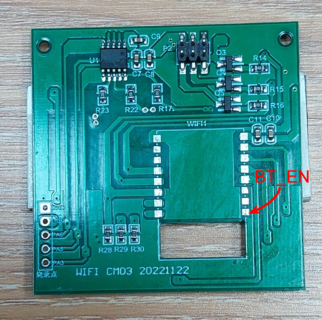

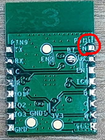

    patentjyp
    Posts: 20
    BT_EN pad is not connected to anything. There are no copper traces on neither side of the PCB.
    Here, BT_EN is connected to pin 14 (CHIP_EN) of BL602 (tested with multimeter). Therefore, this BT_EN pin is indeed BOOT.
    I will try flashing later today.

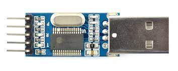

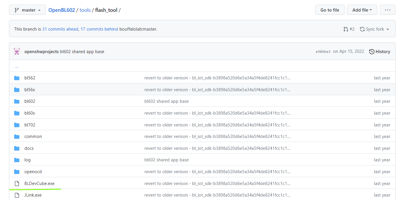

    Can anyone point me to a link where I can download BL602 flashing tools for Windows?
    But I can see two pads here: one EN, second BT. Are you saying they are connected together?
    I also think that correct BT pin is GPIO8. EN is something else.
    Here is SDK with BlDevCube.exe (older version):
    https://github.com/openshwprojects/OpenBL602
    #12 20533595

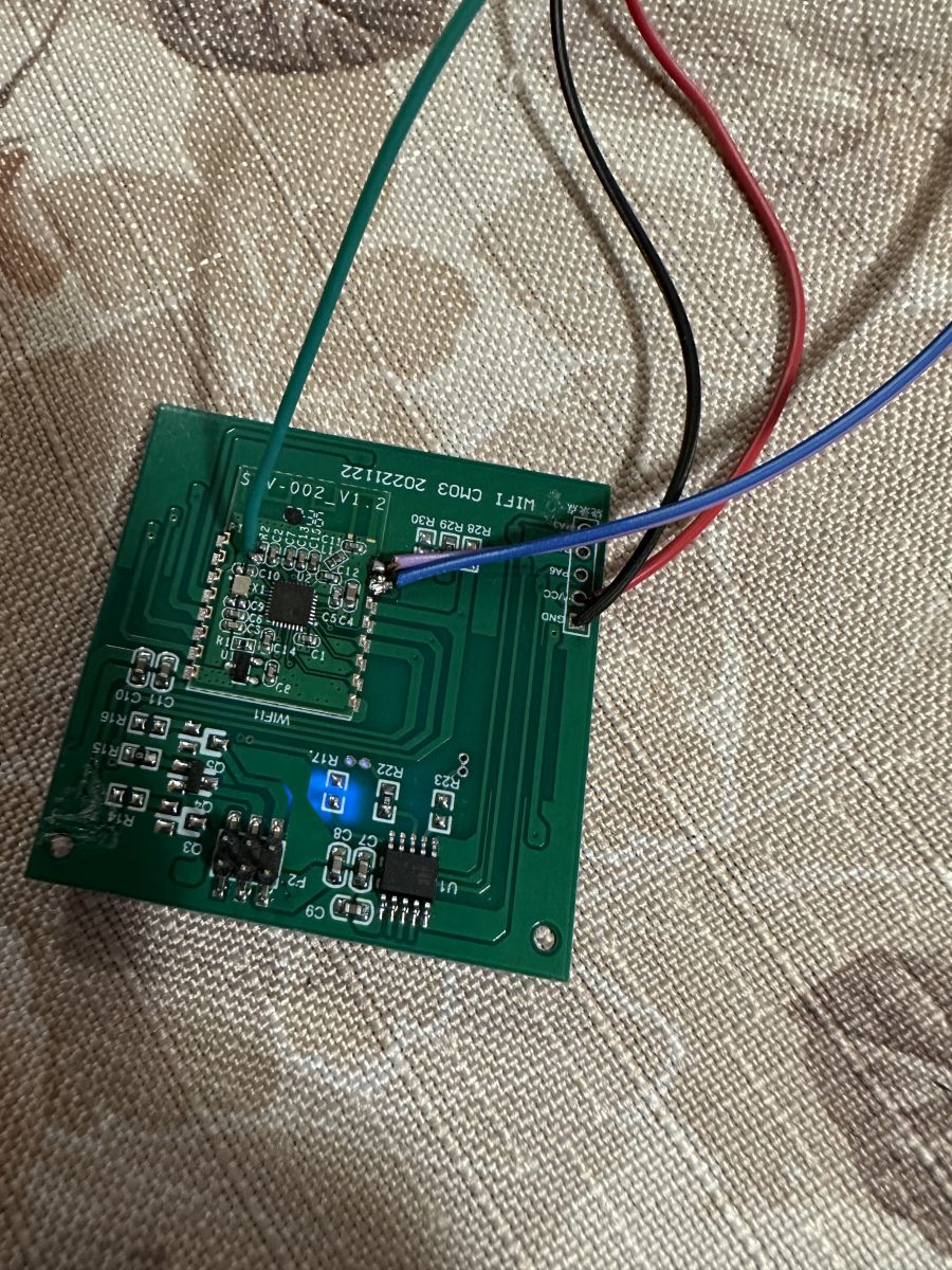

    gyenchev
    Posts: 12
    So I can confirm that soldering a wire to R2 and connecting it to VCC during power on is enough to put the module in BOOT mode. TX and RX pins are as described. I put VCC and GND on the pads that are on the main board. Now I have to figure out how to configure the module so that it works as it should.
    Here is a pic of the setup I made. Don’t judge the bad soldering as I do not have the necessary equipment :|

    But I think we still need to check the meaning of the following pins:
    I started doing sketch in paint few posts above but we need complete pin mapping for this module.
  • #14 20533692
    gyenchev
    Posts: 12

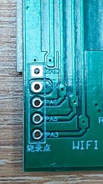

    This is what I traced so far (I don't have my multimeter with me):
    EN, BC and EN1 seem to not be connected to anything.
    IO1 is connected to the WIFI LED on the other side of the board.
    B, G, W are connected to PA6, PA5, PA3 respectively, which in turn are connected to the HELIOS IC( Not sure what it does) which in turn is connected to the buttons on the other side of the board through R23, R22, R17 so I believe that B,G,W are either input from the buttons, or output to the button LEDs.
    On the right side of the module(as shown in picture) TX and RX are just pads and not connected to anything (Soldering a wire is possible)
    C, R and IO1, are pulled to ground, but control Q5, Q4, Q3 which in turn control the relays.
    IO2 and IO3 seem to not be connected anywhere.
    If I followed the traces correctly the pins should map as follows:
    EN --> ??
    BC --> ??
    EN1 --> ??
    IO0 --> GPIO_12(WIFI LED)
    B --> GPIO_20(Button not sure if left or right)
    G --> GPIO_14(Middle button) Found by trial and error
    W --> GPIO_2(Button not sure if left or right)
    C --> GPIO_21(Relay)
    R --> GPIO_3 (Relay for 1 gang)
    IO1 --> GPIO_1(Relay)
    IO2 --> GPIO_0
    IO3 --> GPIO_22
    It's getting late so I am not sure what else we need to figure out. Some of the pins we might need to find by trial and error, because I do not have the module desoldered and I am looking through the pictures uploaded in this thread.
    Someone with 3 gang switch should flash and test which GPIO is for left/right button and which GPIO is for which relay.
    P.S.: I have one 2-gang switch the same model. I think it uses the other two buttons and leaves the middle empty. I will see if I have time these days to flash it also and then I will be able to
    map all of the signals. Maybe even write a post on flashing/etc.

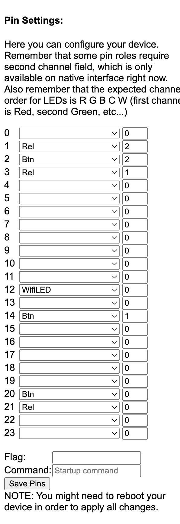

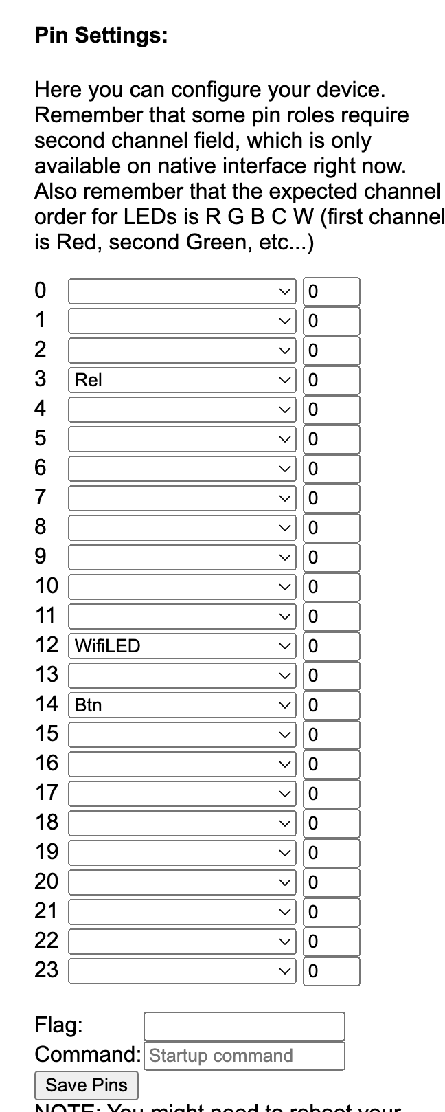

    Ok... So I managed to flash my 2 gang wall switch and here are the pin configurations I came up with:
    1-Gang:
    PIN_3 -> Rel
    PIN_12 -> WifiLED
    PIN_14 -> Btn

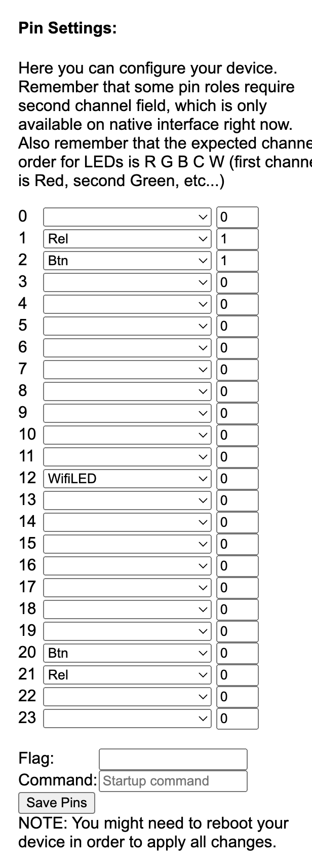

    2-Gang
    PIN_1 -> Rel (CH1)
    PIN_2 -> Btn (CH1)
    PIN_12 -> WifiLED
    PIN_20 -> Btn(CH0)
    PIN_21 -> Rel(CH0)

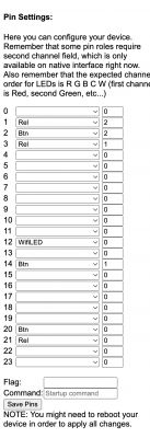

    3-Gang
    PIN_1 -> Rel (CH2)
    PIN_2 -> Btn (CH2)
    PIN_3 -> Rel (CH1)
    PIN_12 -> WifiLED
    PIN_14 -> Btn (CH1)
    PIN_20 -> Btn(CH0)
    PIN_21 -> Rel(CH0)
    If you mess up the channels different buttons control different relays e.g. you press the left button but the relay for the right clicks and the right LED changes state.
    Currently I want to find a way to invert the button LED so that the buttons are illuminated blue when the relay is on and red when the relay is off, but I believe that the schematic is designed that way and there is nothing that we can do using software. I found that if I set Wifi_LED_n to PIN_12 it inverts the LED state, but doing so for the relays just inverts their initial state.
    P.S: p.kaczmarek2 is there anything else that we need to reverse engineer for these wall switches?

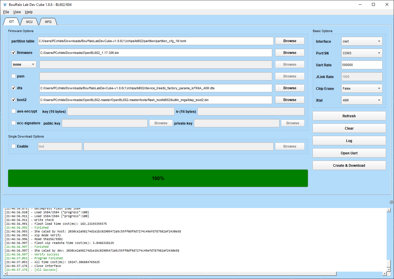

    Well done! One could also try doing a binary backup with BLDevCube.exe. It is possible when you enter advanced mode of the flasher.
  • #17 20535290
    gyenchev
    Posts: 12
    I do not have a Windows machine at the moment. I used https://github.com/spacemeowx2/blflash on MacOS to write the firmware to the devices. Also, I have overwritten all of the devices that I have with OpenBK, so no original dump can be made. I believe these are Sonoff knockoffs that have some kind of modified software written to them, as if you hold the button for 5 seconds on the original firmware while in pairing mode it goes into DIY mode and creates an AP with the name ITEAD_......

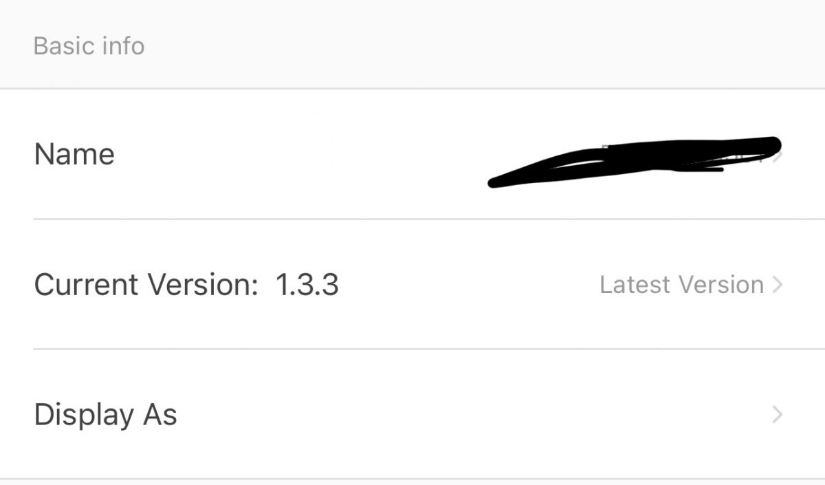

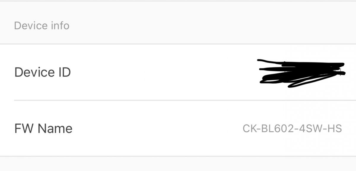

    ETA: I managed to find some leftover info in the eWeLink app from when I paired the 1-Gang switch to the app.
    It seems that it is using the firmware of some kind of relay found on Amazon… https://www.amazon.com/QIACHIP-Ewelink-Wireless-Self-Locking-Latching/dp/B0BCVDS3VM?th=1

    @gyenchev , can you provide those configs by copying JSON template from "Launch Web Application"?
    It takes some time to type them manually from screenshots.
    So the device was bought here (link in the first post)? Price is very low.
  • #19 20535955
    gyenchev
    Posts: 12
    Mine were bougth from different seller under a different brand name, but are virtually the same.
    BGN 14.15 62% Off | EWelink Smart Life Light Switch WiFi Bluetooth RF433 Touch Light Switch Alexa Alice Google Voice Control Neutral Wire Install
    https://a.aliexpress.com/_mMd943w
    Added after 8 [hours] 52 [minutes]:
    1-Gang
      "vendor": "Axus",
      "bDetailed": "0",
      "name": "Axus EWelink Smart Life Light Switch WiFi Bluetooth RF433",
      "model": "1-Gang",
      "chip": "BL602",
      "board": "SDV-002_V1.2",
      "flags": "536871936",
      "keywords": [
        "Axus",
        "1-Gang"
        "pins": {
        "3": "Rel;1",
        "12": "WifiLED;0",
        "14": "Btn;1"
      "command": "",
      "image": "https://obrazki.elektroda.pl/3576912100_1681149522.jpg",
      "wiki": "https://www.elektroda.com/rtvforum/topic3970659.html"
    2-Gang
      "vendor": "Axus",
      "bDetailed": "0",
      "model": "2-Gang",
      "chip": "BL602",
      "keywords": [
        "Axus",
        "2-Gang"
      "pins": {
        "1": "Rel;1",
        "2": "Btn;1",
        "12": "WifiLED;0",
        "20": "Btn;0",
        "21": "Rel;0"
      "command": "",
    3-Gang
      "vendor": "Axus",
      "bDetailed": "0",
      "model": "3-Gang",
      "chip": "BL602",
      "keywords": [
        "Axus",
        "3-Gang"
        "pins": {
        "1": "Rel;2",
        "2": "Btn;2",
        "3": "Rel;1",
        "12": "WifiLED;0",
        "14": "Btn;1",
        "20": "Btn;0",
        "21": "Rel;0"
      "command": "",
    NOTE: The configuration for 3-Gang is not tested on a real device as I do not have one at my disposal. @patentjyp have you managed to flash your devices and can you test?
    Added after 24 [minutes]:
    Still looking for a way to dim the brightness of the button LEDs, but I believe that they are hardwired. Any ideas are appreciated.
    What I found so far is that if the relay pin is set to PWM and I change the PWM value the color of the button switches between blue through purple up until the relay clicks and the button becomes red.
    Strange thing is that if I set the pin for the relay as a button the button becomes dim to my liking.

    Hello, I have same module, but have problem. I wrote binary succesfuly, but after reset can't connect. The module isn't visible in wifi. I tried first with 2M partition. I tried with 2,000,000 baud rate option aswell. Boot pin pull-up is removed avfer flash.
    Can't find what is wrong. @p.kaczmarek2 help me :)
    The interface of the Bouffalo Lab Dev Cube application with flash settings loaded for BL602.
    Logs
    [21:55:06.102] - ========= Interface is Uart =========
    [21:55:06.107] - eflash loader bin is eflash_loader_40m.bin
    [21:55:06.109] - ========= chip flash id: ef4015 =========
    [21:55:06.114] - create partition.bin, pt_new is True
    [21:55:06.126] - fw_boot_head_gen xtal: 40M
    [21:55:06.129] - Create bootheader using chips\bl602\img_create_iot\efuse_bootheader_cfg.ini
    [21:55:06.130] - Updating data according to
    [21:55:06.131] - Created file len:176
    [21:55:06.134] - Create efuse using chips\bl602\img_create_iot\efuse_bootheader_cfg.ini
    [21:55:06.135] - Updating data according to
    [21:55:06.137] - Created file len:128
    [21:55:06.143] - ========= sp image create =========
    [21:55:06.144] - Image hash is b'c5e2ce515a5783ac80efdd4910238a466572f882b53b3284e63c763e1da9847f'
    [21:55:06.144] - Hash ignored
    [21:55:06.145] - Header crc ignored
    [21:55:06.145] - Write flash img
    [21:55:06.147] - Encrypt efuse data
    [21:55:06.155] - fw_boot_head_gen xtal: 40M
    [21:55:06.160] - Create bootheader using chips\bl602\img_create_iot\efuse_bootheader_cfg.ini
    [21:55:06.161] - Updating data according to
    [21:55:06.163] - Created file len:176
    [21:55:06.165] - Create efuse using chips\bl602\img_create_iot\efuse_bootheader_cfg.ini
    [21:55:06.167] - Updating data according to
    [21:55:06.169] - Created file len:128
    [21:55:06.175] - ========= sp image create =========
    [21:55:06.183] - Image hash is b'cc5359a93ec6856a986e7f8ab5d32227da205ddbc502198c3d4511ba31a321d8'
    [21:55:06.183] - Header crc: b'82f202ab'
    [21:55:06.184] - Write flash img
    [21:55:06.189] - Encrypt efuse data
    [21:55:06.191] - FW Header is 176, 3920 still needed
    [21:55:06.193] - FW OTA bin header is Done. Len is 4096
    [21:55:06.265] - BL60X_OTA_Ver1.0
    [21:55:06.348] - FW OTA bin is Done. Len is 759904
    [21:55:06.778] - OTA XZ file len = 404528
    [21:55:06.779] - Partiton len = 557056
    [21:55:06.780] - BL60X_OTA_Ver1.0
    [21:55:06.828] - FW OTA xz is Done
    [21:55:06.829] - ========= eflash loader config =========
    [21:55:06.831] - Image offset = 8192
    [21:55:06.878] - =========C:/Users/PCchleb/Downloads/BouffaloLabDevCube-v1.8.6(1)/chips/bl602/device_tree/bl_factory_params_IoTKitA_40M.dts ——> C:\Users\PCchleb\Downloads\BouffaloLabDevCube-v1.8.6(1)\chips\bl602/device_tree/ro_params.dtb=========
    [21:55:07.035] - Version: eflash_loader_v2.4.7
    [21:55:07.035] - Program Start
    [21:55:07.035] - ========= eflash loader cmd arguments =========
    [21:55:07.036] - Config file: C:\Users\PCchleb\Downloads\BouffaloLabDevCube-v1.8.6(1)\chips\bl602\eflash_loader/eflash_loader_cfg.ini
    [21:55:07.038] - serial port is COM3
    [21:55:07.039] - cpu_reset=False
    [21:55:07.039] - chiptype: bl602
    [21:55:07.039] - ========= Interface is uart =========
    [21:55:07.039] - com speed: 500000
    [21:55:07.041] - Eflash load helper file: C:\Users\PCchleb\Downloads\BouffaloLabDevCube-v1.8.6(1)\chips\bl602\eflash_loader/eflash_loader_40m.bin
    [21:55:07.041] - ========= load eflash_loader.bin =========
    [21:55:07.042] - Load eflash_loader.bin via uart
    [21:55:07.042] - ========= image load =========
    [21:55:07.345] - FLc0c0 unknown
    [21:55:07.346] - Not ack OK
    [21:55:07.346] - FLc0c0 unknown
    [21:55:07.346] - result: FLc0c0 unknown
    [21:55:07.683] - tx rx and power off, press the machine!
    [21:55:07.684] - cutoff time is 0.1
    [21:55:07.791] - power on tx and rx
    [21:55:08.603] - reset cnt: 0, reset hold: 0.005, shake hand delay: 0.1
    [21:55:08.604] - clean buf
    [21:55:08.726] - send sync
    [21:55:08.941] - ack is c0c0c0c0c0c0c0c0c0c0c0c0c0c0c0c0c0c0c0c0c0c0c0c0c0c0c0c0c0c0c0c04f4b
    [21:55:09.048] - shake hand success
    [21:55:09.063] - get_boot_info
    [21:55:09.065] - data read is b'01000000000000000300000075cb9a4cb97c1500'
    [21:55:09.065] - ========= chipid: 7cb94c9acb75 =========
    [21:55:09.065] - last boot info: None
    [21:55:09.065] - sign is 0 encrypt is 0
    [21:55:09.065] - segcnt is 1
    [21:55:09.071] - segdata_len is 38464
    [21:55:09.164] - 4080/38464
    [21:55:09.256] - 8160/38464
    [21:55:09.348] - 12240/38464
    [21:55:09.441] - 16320/38464
    [21:55:09.533] - 20400/38464
    [21:55:09.625] - 24480/38464
    [21:55:09.718] - 28560/38464
    [21:55:09.810] - 32640/38464
    [21:55:09.902] - 36720/38464
    [21:55:09.942] - 38464/38464
    [21:55:09.943] - Run img
    [21:55:10.047] - Load helper bin time cost(ms): 3005.0126953125
    [21:55:10.154] - Flash load shake hand
    [21:55:10.282] - default set DTR high
    [21:55:10.385] - clean buf
    [21:55:10.508] - send sync
    [21:55:10.723] - ack is 4f4b
    [21:55:10.814] - Read mac addr
    [21:55:10.815] - macaddr: 75cb9a4cb97c
    [21:55:10.815] - flash set para
    [21:55:10.816] - ========= flash read jedec ID =========
    [21:55:10.817] - Read flash jedec ID
    [21:55:10.817] - flash jedec id: ef401580
    [21:55:10.817] - Finished
    [21:55:10.821] - get flash size: 0x00200000
    [21:55:10.821] - Program operation
    [21:55:10.822] - Dealing Index 0
    [21:55:10.822] - ========= programming chips\bl602\img_create_iot\whole_img_boot2.bin to 0x00000000
    [21:55:10.826] - ========= flash load =========
    [21:55:10.827] - ========= flash erase =========
    [21:55:10.827] - Erase flash from 0x0 to 0xb98f
    [21:55:10.896] - erase pending
    [21:55:11.046] - erase pending
    [21:55:11.079] - erase pending
    [21:55:11.111] - erase pending
    [21:55:11.142] - erase pending
    [21:55:11.259] - Erase time cost(ms): 432.0087890625
    [21:55:11.320] - decompress write rx timeout: 24.576
    [21:55:11.396] - decompress flash load 22128
    [21:55:11.444] - Load 2048/22128 {"progress":9}
    [21:55:11.492] - Load 4096/22128 {"progress":18}
    [21:55:11.540] - Load 6144/22128 {"progress":27}
    [21:55:11.587] - Load 8192/22128 {"progress":37}
    [21:55:11.635] - Load 10240/22128 {"progress":46}
    [21:55:11.682] - Load 12288/22128 {"progress":55}
    [21:55:11.729] - Load 14336/22128 {"progress":64}
    [21:55:11.777] - Load 16384/22128 {"progress":74}
    [21:55:11.824] - Load 18432/22128 {"progress":83}
    [21:55:11.871] - Load 20480/22128 {"progress":92}
    [21:55:11.909] - Load 22128/22128 {"progress":100}
    [21:55:11.910] - Load 22128/22128 {"progress":100}
    [21:55:11.911] - Write check
    [21:55:11.995] - Flash load time cost(ms): 674.236572265625
    [21:55:11.995] - Finished
    [21:55:11.997] - Sha caled by host: cf7321b7a337021dd92984959adb2b62dacb95ed7d9c991de87365af835249d0
    [21:55:11.997] - xip mode Verify
    [21:55:12.011] - Read Sha256/47504
    [21:55:12.012] - Flash xip readsha time cost(ms): 14.829345703125
    [21:55:12.012] - Finished
    [21:55:12.013] - Sha caled by dev: cf7321b7a337021dd92984959adb2b62dacb95ed7d9c991de87365af835249d0
    [21:55:12.013] - Verify success
    [21:55:12.072] - Dealing Index 1
    [21:55:12.072] - ========= programming chips\bl602\partition\partition.bin to 0x0000E000
    [21:55:12.076] - ========= flash load =========
    [21:55:12.077] - ========= flash erase =========
    [21:55:12.077] - Erase flash from 0xe000 to 0xe10f
    [21:55:12.133] - erase pending
    [21:55:12.254] - Erase time cost(ms): 177.3583984375
    [21:55:12.323] - Load 272/272 {"progress":100}
    [21:55:12.323] - Write check
    [21:55:12.377] - Flash load time cost(ms): 61.345703125
    [21:55:12.378] - Finished
    [21:55:12.379] - Sha caled by host: fd6af18fc4aaf2807277cac767ca19d12af7b55f5ecbb8902ef28bc2430524aa
    [21:55:12.379] - xip mode Verify
    [21:55:12.383] - Read Sha256/272
    [21:55:12.383] - Flash xip readsha time cost(ms): 2.97509765625
    [21:55:12.383] - Finished
    [21:55:12.384] - Sha caled by dev: fd6af18fc4aaf2807277cac767ca19d12af7b55f5ecbb8902ef28bc2430524aa
    [21:55:12.384] - Verify success
    [21:55:12.439] - Dealing Index 2
    [21:55:12.439] - ========= programming chips\bl602\partition\partition.bin to 0x0000F000
    [21:55:12.443] - ========= flash load =========
    [21:55:12.443] - ========= flash erase =========
    [21:55:12.443] - Erase flash from 0xf000 to 0xf10f
    [21:55:12.501] - erase pending
    [21:55:12.623] - Erase time cost(ms): 179.181640625
    [21:55:12.691] - Load 272/272 {"progress":100}
    [21:55:12.692] - Load 272/272 {"progress":100}
    [21:55:12.692] - Write check
    [21:55:12.745] - Flash load time cost(ms): 61.34765625
    [21:55:12.746] - Finished
    [21:55:12.746] - Sha caled by host: fd6af18fc4aaf2807277cac767ca19d12af7b55f5ecbb8902ef28bc2430524aa
    [21:55:12.747] - xip mode Verify
    [21:55:12.749] - Read Sha256/272
    [21:55:12.749] - Flash xip readsha time cost(ms): 1.98583984375
    [21:55:12.749] - Finished
    [21:55:12.750] - Sha caled by dev: fd6af18fc4aaf2807277cac767ca19d12af7b55f5ecbb8902ef28bc2430524aa
    [21:55:12.750] - Verify success
    [21:55:12.807] - Dealing Index 3
    [21:55:12.808] - ========= programming chips\bl602\img_create_iot\whole_img.bin to 0x00010000
    [21:55:12.812] - ========= flash load =========
    [21:55:12.814] - ========= flash erase =========
    [21:55:12.814] - Erase flash from 0x10000 to 0xc985f
    [21:55:12.873] - erase pending
    [21:55:13.104] - erase pending
    [21:55:13.309] - erase pending
    [21:55:13.530] - erase pending
    [21:55:13.742] - erase pending
    [21:55:13.946] - erase pending
    [21:55:14.176] - erase pending
    [21:55:14.400] - erase pending
    [21:55:14.620] - erase pending
    [21:55:14.839] - erase pending
    [21:55:15.061] - erase pending
    [21:55:15.281] - erase pending
    [21:55:15.428] - erase pending
    [21:55:15.458] - erase pending
    [21:55:15.582] - Erase time cost(ms): 2768.010986328125
    [21:55:15.644] - decompress write rx timeout: 24.576
    [21:55:16.014] - decompress flash load 404528
    [21:55:16.061] - Load 2048/404528 {"progress":0}
    [21:55:16.108] - Load 4096/404528 {"progress":1}
    [21:55:25.342] - Load 403456/404528 {"progress":99}
    [21:55:25.368] - Load 404528/404528 {"progress":100}
    [21:55:25.370] - Load 404528/404528 {"progress":100}
    [21:55:25.371] - Write check
    [21:55:25.450] - Flash load time cost(ms): 9805.93017578125
    [21:55:25.450] - Finished
    [21:55:25.455] - Sha caled by host: 24599529e7209425bfd2749bdc115ee209bf537a40bd65641be1312ac65a3b85
    [21:55:25.455] - xip mode Verify
    [21:55:25.663] - Read Sha256/759904
    [21:55:25.663] - Flash xip readsha time cost(ms): 207.3798828125
    [21:55:25.663] - Finished
    [21:55:25.665] - Sha caled by dev: 24599529e7209425bfd2749bdc115ee209bf537a40bd65641be1312ac65a3b85
    [21:55:25.665] - Verify success
    [21:55:25.727] - Dealing Index 4
    [21:55:25.727] - ========= programming chips\bl602\device_tree\ro_params.dtb to 0x001F8000
    [21:55:25.731] - ========= flash load =========
    [21:55:25.731] - ========= flash erase =========
    [21:55:25.732] - Erase flash from 0x1f8000 to 0x1f975d
    [21:55:25.788] - erase pending
    [21:55:25.817] - erase pending
    [21:55:25.940] - Erase time cost(ms): 208.176025390625
    [21:55:26.002] - decompress write rx timeout: 24.576
    [21:55:26.066] - decompress flash load 1584
    [21:55:26.103] - Load 1584/1584 {"progress":100}
    [21:55:26.104] - Load 1584/1584 {"progress":100}
    [21:55:26.104] - Write check
    [21:55:26.185] - Flash load time cost(ms): 183.519287109375
    [21:55:26.186] - Finished
    [21:55:26.187] - Sha caled by host: 2030ce2a98174d1e1bc02905472a5c55ff0df9d7274c49efd787982af2430e58
    [21:55:26.187] - xip mode Verify
    [21:55:26.192] - Read Sha256/5982
    [21:55:26.192] - Flash xip readsha time cost(ms): 3.63134765625
    [21:55:26.192] - Finished
    [21:55:26.193] - Sha caled by dev: 2030ce2a98174d1e1bc02905472a5c55ff0df9d7274c49efd787982af2430e58
    [21:55:26.193] - Verify success
    [21:55:26.248] - Program Finished
    [21:55:26.248] - All time cost(ms): 19213.0625
    [21:55:26.371] - close interface
    [21:55:26.372] - [All Success]

  • #25 20815709
    Posts: 14666
    Help: 656
    Rate: 12680
    I am happy to hear it's resolved. How did you power that device? USB port should be able to provide at least 500mA so I am suprised... maybe used LDO is the culprit?
  • #26 20815848
    chlebok
    Posts: 128
    Rate: 56
    Exactly! The problem was with the "D-Sun PL2303" (pl2303HXA) budget USB to UART adapter I had for years. Now I've just discovered there is only an internal 3V3 LDO on this board with 4mA current! (DS for pl2303HXD)
    USB to UART adapter D-Sun PL2303.
  • #27 20815897
    Posts: 14666
    Help: 656
    Rate: 12680
    Well, I would say that this has no chance of working. I am always using an external LDO, AMS1117-3.3V or TC1264-3.3V, which can provide enough of current, you can see that on our guides:

    Hello and thank you all for the comprehensive information. I have successfully flashed my devices (2 and 3 gang). Before flashing, I make original firmware dump. If anyone is interested, I am attaching it below. Also, I attach detailed photos of these products.
    Spoiler:
    A white box on a wooden table with the words SWITCH and Show Future Technology and Embrace Smart Life. Smart light switch packaging with product information and a barcode. Product packaging with a list of technological and color options. A green box with the text WALL SWITCH on a desk.
    Printed circuit board in a plastic casing on a wooden surface. Detailed photo of a disassembled device with visible electronic components on a circuit board. View of a disassembled two-gang touch switch and its casing on a desk. Close-up of a green printed circuit board with integrated circuits and electronic components. Circuit board with electronic components on a wooden surface. Image of a round printed circuit board with electronic components, including JIEYING relays. Close-up of a printed circuit board with electronic components such as capacitors and coils. Interior of a white electronic panel with a visible green printed circuit board and electronic components. Two components of a device: a circuit board with three buttons and a touch panel with three fields on a wooden surface. Circuit board with electronic components and a WiFi module on a wooden surface. Close-up view of a PCB with three relays and connectors. Circuit board with electronic components, including relays and capacitors. Close-up of a circuit board with electronic components on a wooden table. Close-up of a printed circuit board with visible traces, mounting holes, and electronic components.
    Spoiler:
    full2ga...zip (581.07 kB)You must be logged in to download this attachment.
    full3ga...zip (581.07 kB)You must be logged in to download this attachment.
