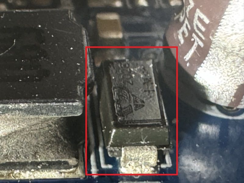

    Hi,
    I have found a diode that is shorted but only markings on the diode is a big triangle and 2028 1 M.
    So kind of hard to find replacement :o)
    I have attached a picture of the board and of the diode hoping that somebody perhaps has some schematics or know what diode to use
    A circuit board with visible traces and soldered connections. A barcode label is visible at the bottom of the board. Electronic circuit with a marked diode labeled with a triangle and the text 2028 1 M. Close-up of a circuit board with a damaged diode marked with a triangle and number 2028 1 M.

    #4 21064162
    yogi009
    Posts: 14697
    Help: 848
    Rate: 2655
    It can be any super fast 1A 1000V diode in an SMA housing.
    #5 21073379
    VPSA132
    Level 26  
    Posts: 727
    Help: 74
    Rate: 185
    SS26 or SS36 will do, there is no need to give a diode for 1000V. More important is the current, 2A or 3A.
  • #6 21074085
    bbhe
    I replaced the diode with the one suggested.
    Thanks
