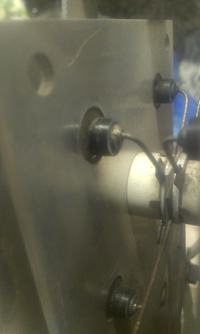

    I am looking for a T25-4-J6 diode, I searched the internet and nowhere can I find information or pages where it could be purchased, can these diodes be replaced with others :?: I did not find any information on the Polish-language websites.
    I know that I could buy a new bridge, but replacing the diodes themselves should be much cheaper.
    This is what it looks like in full:
    Thor RL2 450 - Diode for the rectifier with the symbol T25-4-J6

    Show what this diode looks like, because I can see that you have it pressed out. It is very possible that the alternator diodes will match.

    No, there was no diode in this place, what alternative to use :?: apart from this marking I have no data.
    This is what it looks like:
    On one of the auction portals I found similar 60A LEDs, the diameter of the base only matches whether other values match :?:

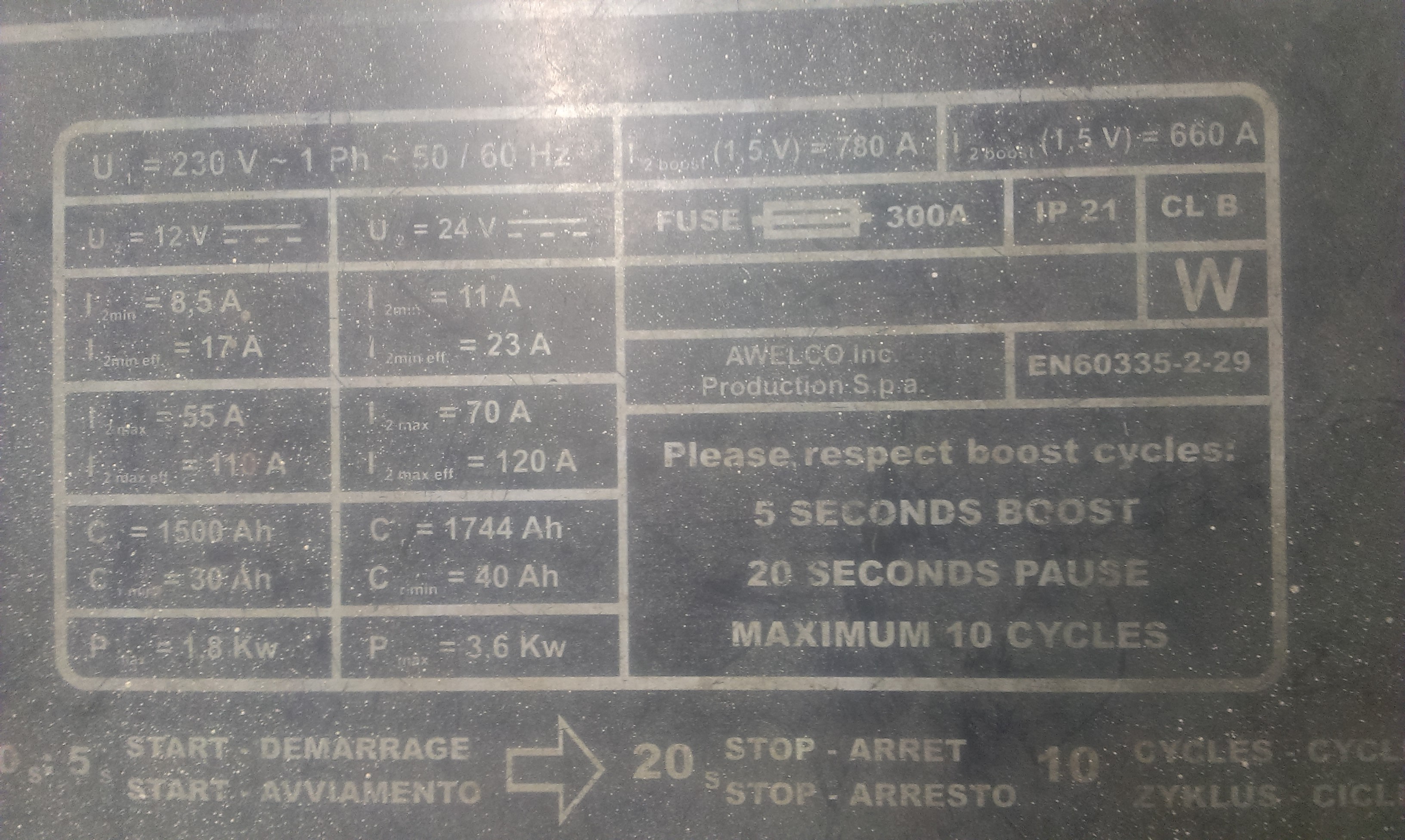

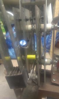

    The rectifier is powered by 230V, charging voltage is 12 and 24V + starting.
    Here is the arrangement in question
    And here is the device plate

    I made a diagram of this bridge and there are six diodes:
    From the ones marked in red, only the base and the wire remain ...

    You have 2 options: either replace the 4 damaged ones with the same ones, or replace them all with the 60A that you found on Alle ... If you only replace the burned ones with a different type, it may happen that they will have a lower forward voltage drop, and then they will take over most of the current at start-up and will be damaged.
