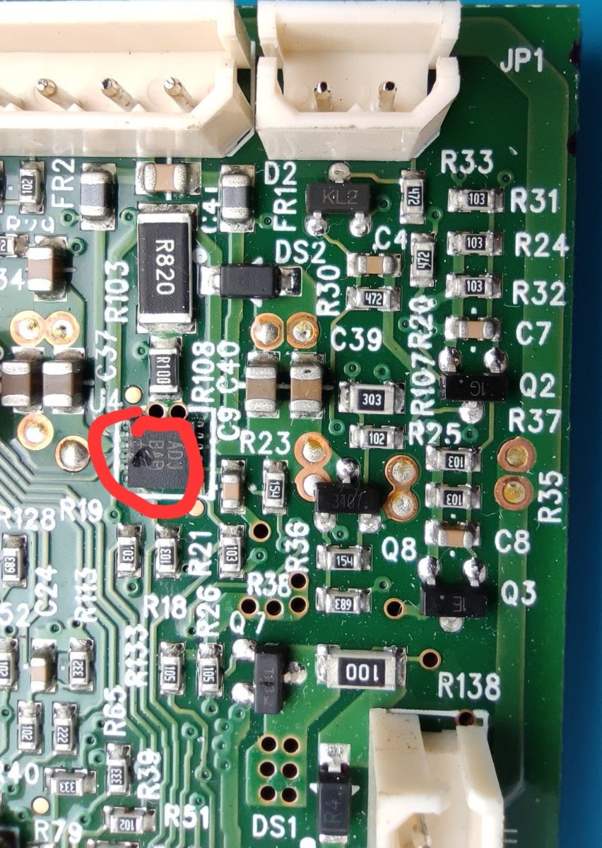

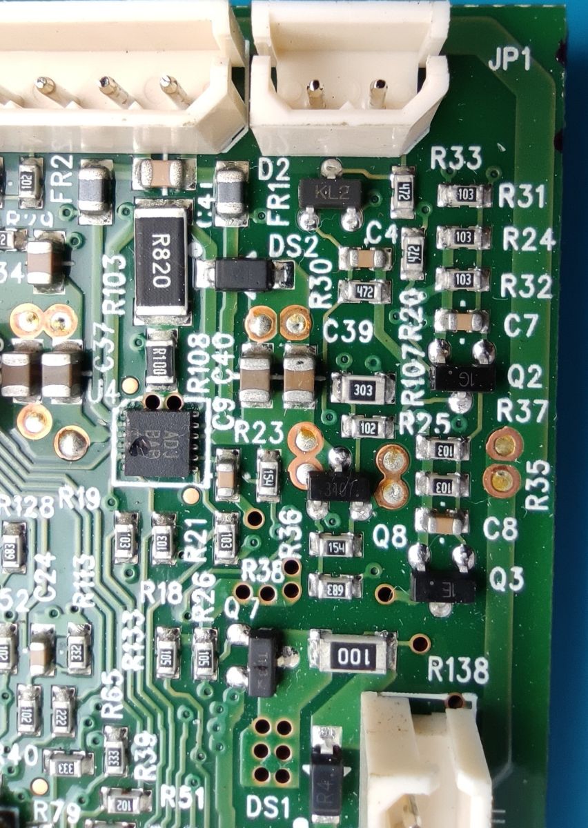

    More information: My machine turns on but it doesn't take any commands. I suspect a diode (DS2), but I don't know the model of it.
    A schematic would be awesome.
    Close-up of a PCB with labeled components including diode DS2 and SMD circuitry

    Is it dirt or has this circuit fired?
    Close-up of PCB with marked chip showing dark residue or burn marks
    DS2 is a Schottky diode MBR0540

    Only dirt.

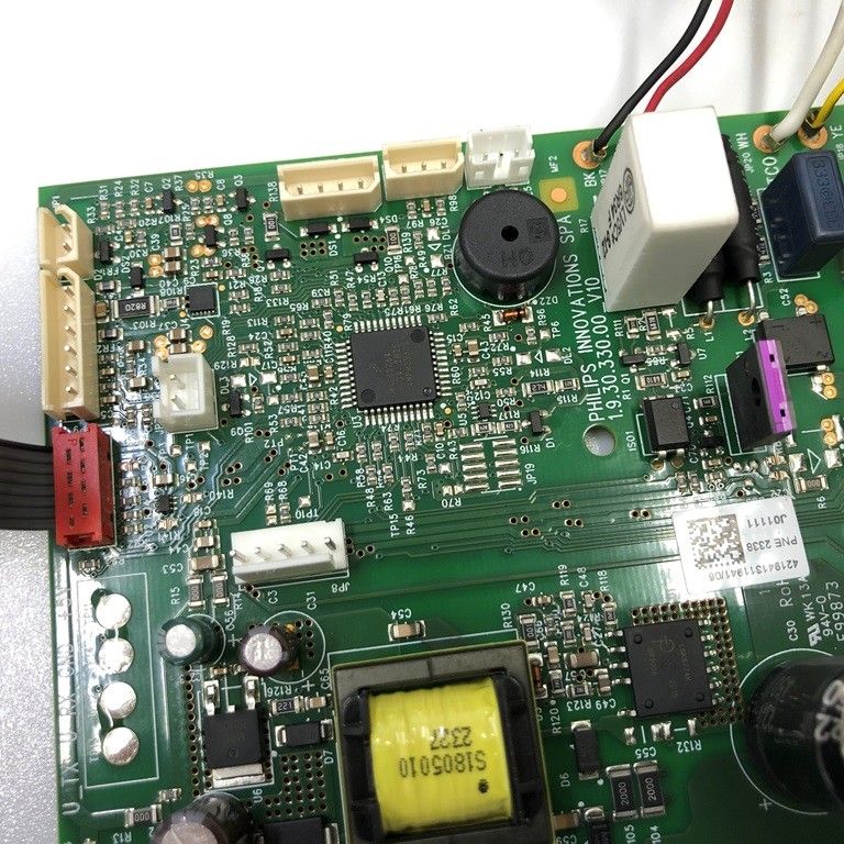

    Only serve Philips for this coffe-machine.
    See, read Link
    Main problems
    the reason for this is the coffee grinder's motor. ... The control driver and other elements burned out.
    - or FW fron uctrl (MKE02Z64VLD4)
    - on mobo is connector for connecting a programmer ( (+5В, RX, TX, RES))
    Coffee machine PCB with connectors, microcontroller and burnt control components
    This modul on Link

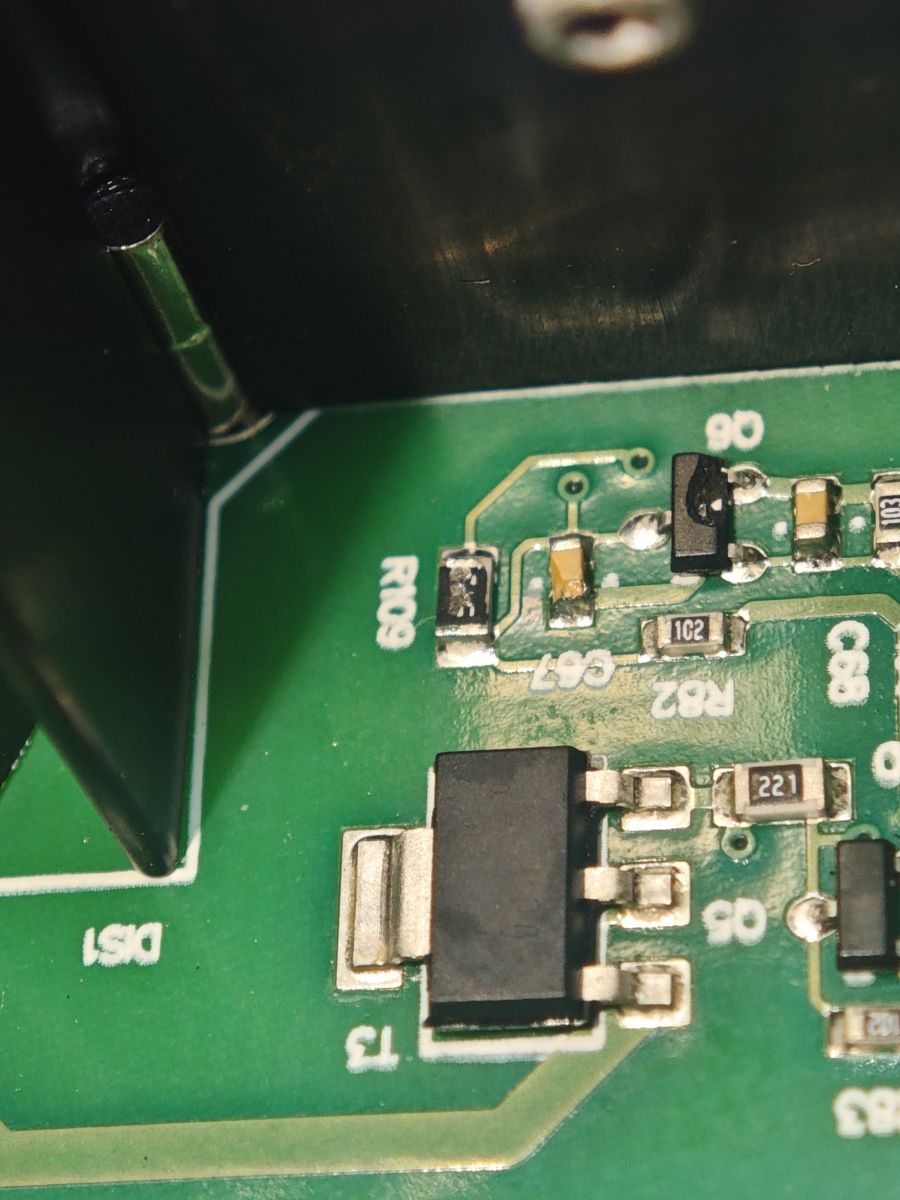

    Hi what is R109?
