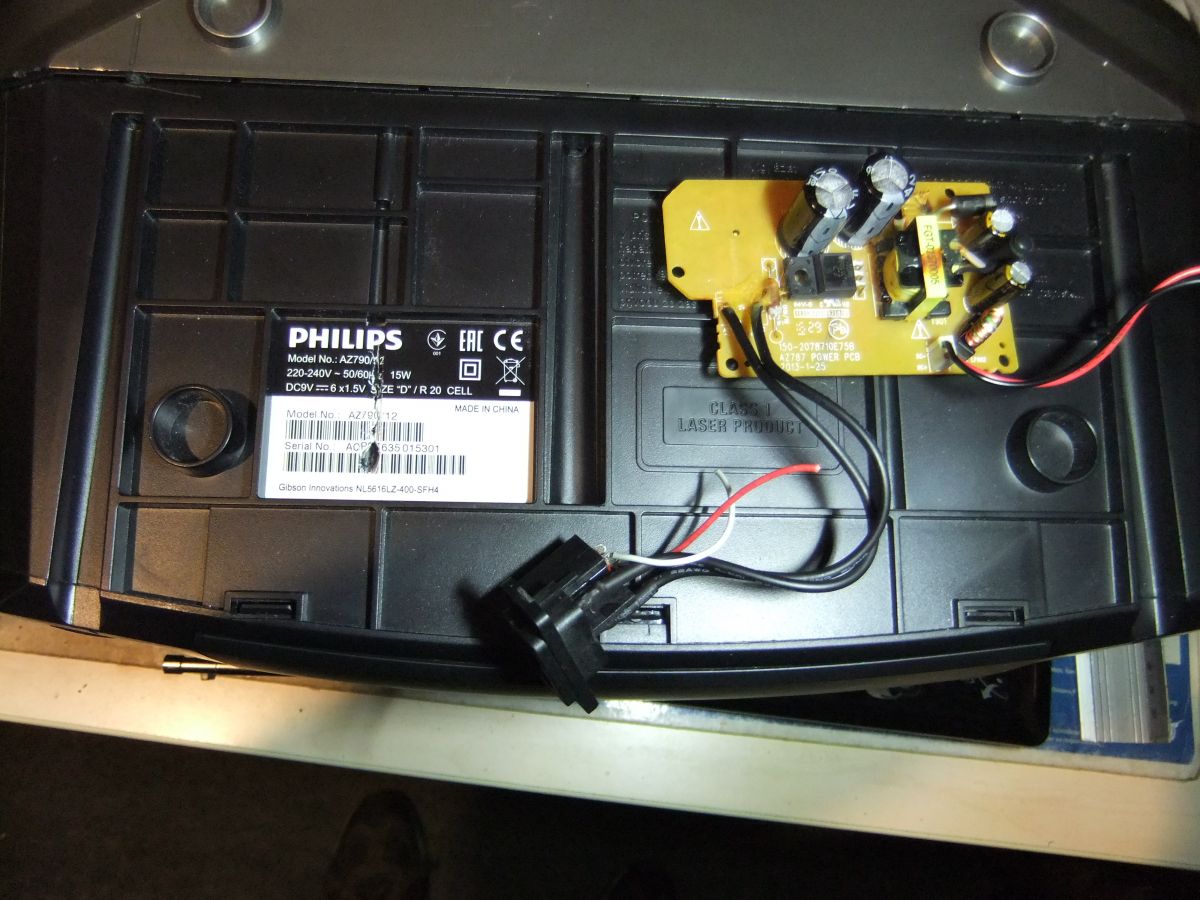

    Philips Boombox AZ790/12
    The power supply AZ 787 has 0V DC out. What can I do?
    Quelqu'un sait-il si je peux simplement remplacer cette platine par une alimentation 220v AC/12V DC 2A du commerce?
    Does qualified somebody know if I could replace that PCB by a conventional power supply ? What is the out DC voltage & Amperes from the PCB ? Nowhere written
    Does Somebody can help to repair or replace that PCB ?
    Thank you very much to you. Close-up of the interior of a Philips AZ790/12 boombox with a visible power board.

    Fit a typical power supply with the same voltage as the voltage on the batteries and the current should not be enough.
  • #3 21080966
    josefouchard
    Voltage of batteries is 9V 6 units.
    What is "current"? voltage or Amperage? Enough or not enough? Pls be more specific. Would it be risky to fitting a power supply of 12V?

    What size batteries are used there?

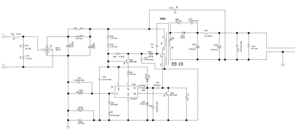

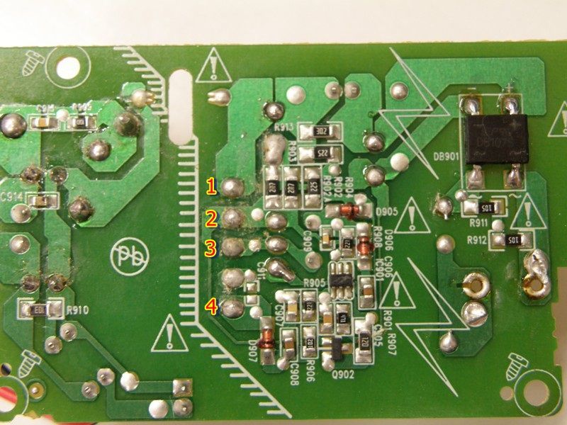

    The battery type is indicated in the photo. The original power supply is for sale. https://ndsalesvs.pics/ product_details/89903488.html Pictured is a diagram of the original power supply. The image shows a close-up of a circuit board with numbers 1, 2, 3, and 4 marked on circuit components. Electrical schematic of the original power supply. Avoid experimenting with increasing the power supply voltage as this can lead to problems.

    Why are you giving a damaging recommendation? The power drawn from the mains supply is 15W and the 9V 1A is only 9W. Do you want the subject author to be looking for a new power supply in a day or two? You need a 9V 2A power supply.

    What's written and what's in action is different, let the subject author test the equipment on a workshop power supply how much current it actually draws at maximum volume.

    Before writing any nonsense, you should, at the very least, read the technical specifications of the product - The Philips AZ790/12 has a total output power of 12 W RMS.
  • #10 21143054
    josefouchard
    I installed one power supply 9V 5A. The box started. The display works, the radio works, I suppose the cassette works, but the CD player does not work anymore. The menu works but the reading does not start. The reading stays at 00. The disk turns OK, I can change the number of the music recorded but the mobile laser light does not move at all of its resting place. I think it is blocked. Does someone know anything in the repair of CD disk player?
