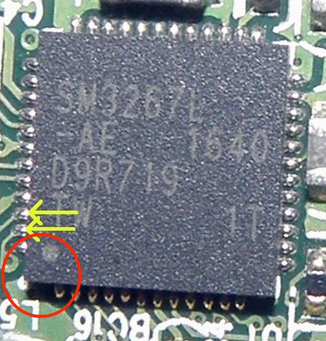

    If there are no signs of "life", it remains to be finally checked. " testmod "-> leg 10 of 11 shorted on this SM3267 controller for approx. 5s (you plug this pendrive into the USB port with the legs on the controller shorted and after approx. 5s you pull back the shorting element).

    it remains Testmod -> leg 10 from 11 shorted on this SM3267 controller for about 5s
    I am asking theoretically which is exactly the 10-11 leg, from which side to look and count. I just have this drawing:
    ADATA USB Flash Drive Constantly Requires Formatting: Regain Control, ChipGenius_v4_00 Results
    I just haven't checked if it "agrees with reality", because the number seems to be the same, but the "letters" are different. Is it as I indicated? With the USB port and other things, nothing will happen when I shorten these feet?
    When, after these 5 seconds, I remove this jumper from these legs, the pen must still remain connected to the USB socket? What should I do next?
    I marked in the photo, will they be these feet?
  • #21 16747556
    pidar
    Posts: 11363
    Help: 1569
    Rate: 3590
    Wrong , you count your legs from the dot on the controller housing (one).
    You make 10-11 or 11-12, photo below (see from left 10.11 and last 12):
    If you follow the recommendations, nothing will happen and when you open these legs on the controller, you will hear the sound of the hardware being detected by the system.

    pidar wrote:
    You make 10-11 or 11-12, photo below (see from left 10.11 and ost12):
    I marked the above with yellow arrows, you can recognize a little more clearly in relation to the inscriptions on the layout than in your picture. I looked according to this drawing from the datashet and according to the numbers in this drawing. Marked well? Are these the feet?
    Added after 15 [hours] 27 [minutes]:
    pidar , thanks for the tips, the pen "came to life" at the moment, after "defibrillator therapy" (pins short-circuited), "My computer" sees it normally:
    In "Devices and Printers, you can see it like this:
    The only thing is that he "fell" into "amnesia" (he must be in a coma! :D ), in properties 0 (zero) capacity, 0 (zero) space, :cry: (lost his memory?). Which software should I use now to regain memory? This "factory" - SM3259_67 High Level Recover tool Q0509_ADATA or this sm32Xtest Repack P0414v1 ?
    For now, I am not unplugging it so that it does not "go away" again. :cry:
    If in fact the solder is not like that, I have no possibility of improving it and checking "if it connects well", not the skills and dimensions of the elements and the lack of equipment for it, and there is no friend who could do it.
    ChipGenius sees it this way:

    And which pins were shorted :?:
    I wonder who is right here, "Chinese" or me :wink: :?:
    Colleague tagievara could he get these pictures from them?
    I found something like this:
    ADATA USB Flash Drive Constantly Requires Formatting: Regain Control, ChipGenius_v4_00 Results ADATA USB Flash Drive Constantly Requires Formatting: Regain Control, ChipGenius_v4_00 Results
    And if this "dot" is actually added to this drawing, I doubt it. :|
    Do you see (is) a "cut" corner on your controller (mark it in the photo) :?:
    I don't really see the cut corner here (don't pay attention to the arrows). The photo is "real", taken in person a few days ago. Maybe a bit out of focus, because it's an enlarged fragment, but you can't see the "cut corner" there.
    Well, unless here, after enlarging and looking closely, you can see a slightly cut corner (red circle):

  • #28 16749847
    wojtek1234321
    Level 36  
    Posts: 3554
    Help: 306
    Rate: 1133
    pidar wrote:
    Write specifically (for those looking for help in such cases with SM3267) what was shortened and whether the first attempt was "resuscitation" of this flash drive
    I do not know if this information is enough, these two pins are shorted (red arrows in the photo):
    pidar wrote:
    what was short-circuited and whether the flash drive was "reanimated" at the first attempt
    As for this "resuscitation" by shorting the pins - this YES , excitation and start of the pendrive took place after the first short-circuit of the pins with a thicker pin that did not fit into the gap between them and short-circuited them, the short circuit may not even last 5 seconds, immediately after releasing the pin there was the sound of connecting the pen to the socket and the window that looks for drivers. It found the drivers in seconds and showed up in the system but as I wrote "out of memory". The "factory" program used SM3259_67 High Level Recover tool Q0509_ADATA it returned a memory error (I didn't note what it was), then the program sm32Xtest Repack P0414v1 also in red FAIL (even a few tries), I accidentally got downloaded sm32Xtest_V51-5 and after a few moments the effect is:

  • ChipGenius identifies SM3267 controller and Hynix TLC flash
    #29 16751791
    pidar
    Posts: 11363
    Help: 1569
    Rate: 3590

    Yes.
    I do not know if "300 mA" should not be displayed :?:
    At the earliest opportunity, check it after connecting to the port USB3.0 . :idea:
