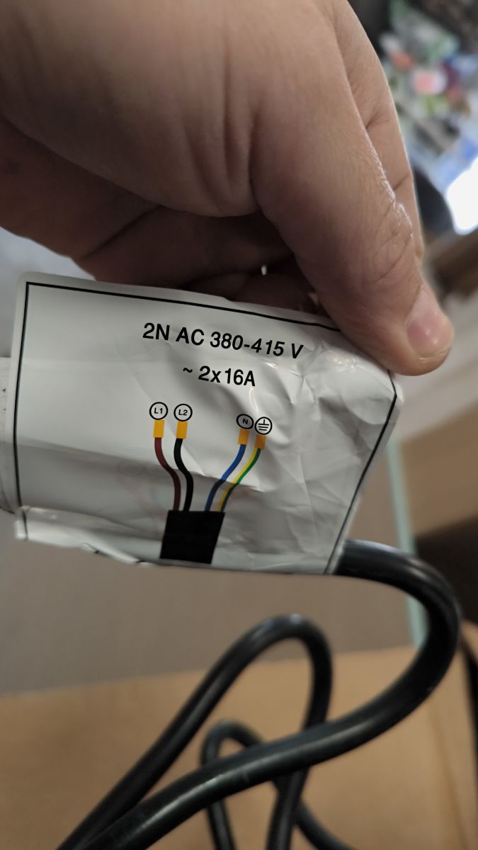

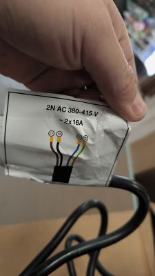

    Hello, I would like to ask for help !!!
    I bought a Beko Induction specimen Induction cooktop cable with markings for two-phase connection. it seems that the cable requires for connection to two phases. And unfortunately, where I live, there is only one phase. At the back of the induction box, where the cable comes out, there are plates attached to connect it to one phase, but the instructions say otherwise.
    Can I still connect it to one and the question is what will happen.

    Fellow felczak06 , it is written in the manual (and warranty) that the above induction should be connected by an electrician with the appropriate qualification certificate authorising such operation.
    You presumably have no such "qualification".
    So ... you can, but you should look at your installation, see the cross-sections of the wires, the type and size of the fuses, the power installed to the dwelling and decide.
    Only then will the electrician take responsibility for the connection and sign the induction document.
