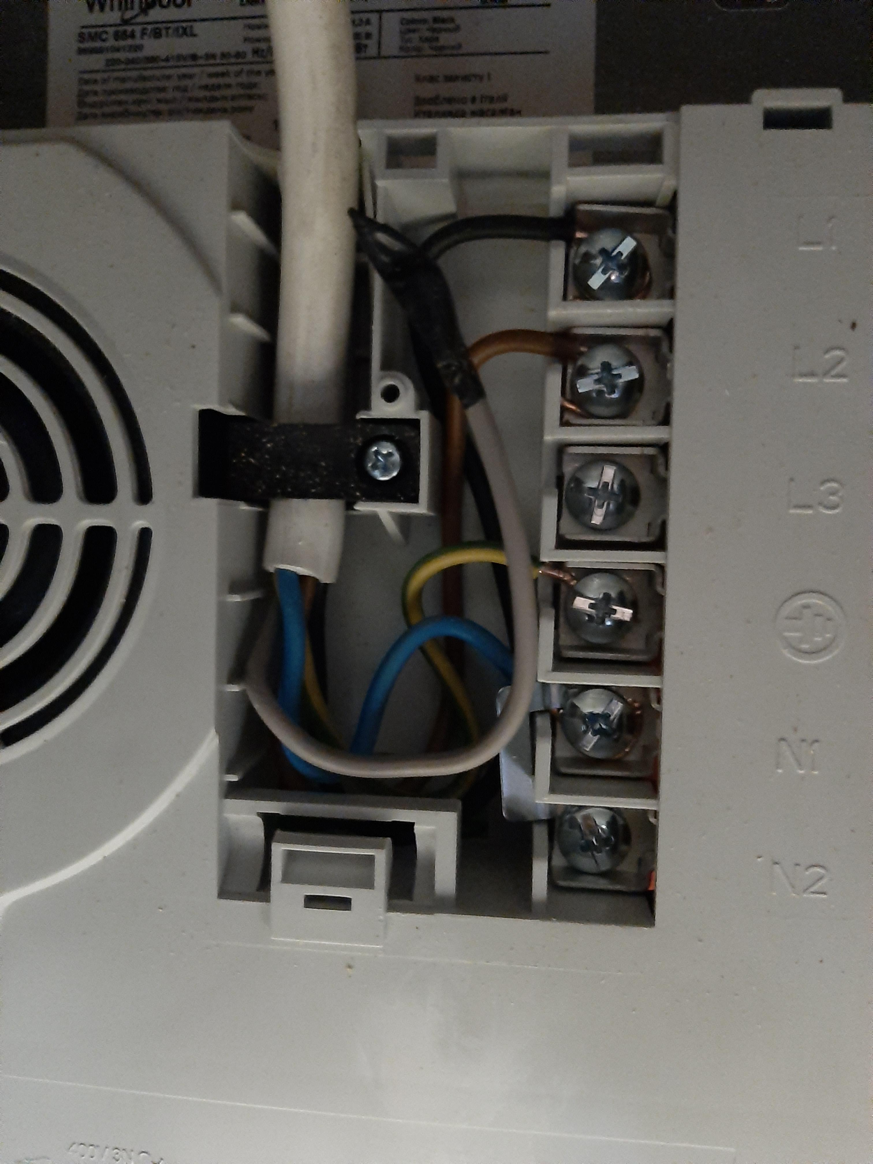

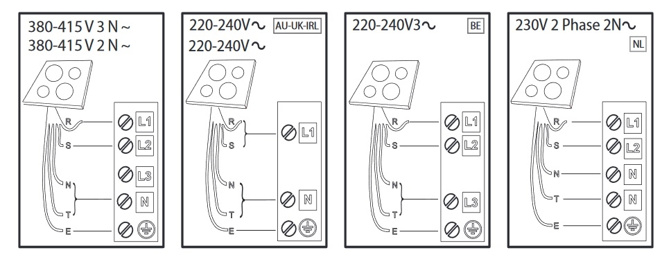

    I would like to know how to properly connect the Whirlpool SMC 654 F / BT / IXL induction hob to a three-phase installation. Photo of the terminal box on the board

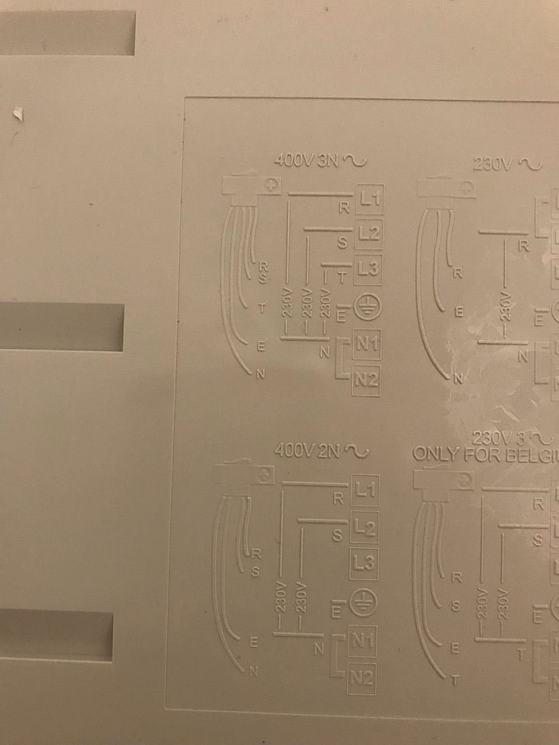

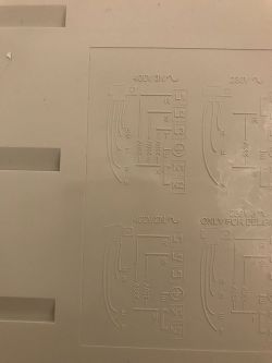

    Picture of the connection diagram on the hob casing (right under the terminal box).
    Connecting Whirlpool SMC 654 F / BT / IXL Induction Hob to a Three-Phase Installation
    Screen of the connection diagram in the user manual.

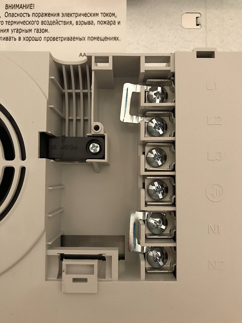

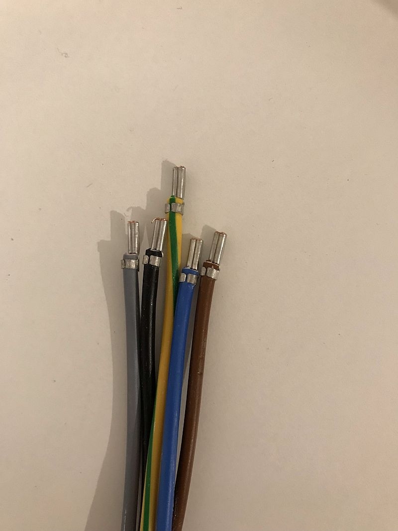

    The set also includes a connecting cable

    A standard 5-core cable (black, brown, gray, blue, yellow-green) comes out of the wall. I checked with a voltage meter:
    blue - black - 230V
    blue - brown - 230V
    blue - gray - 230V
    black - brown - 400V
    black - gray - 400V
    brown - gray - 400V
    blue - yellow-green - 0V
    My guess is that in the terminal box on the board I remove the jumper between L1 and L2.
    I connect the black wire to the L1 terminal on the board
    I connect the brown wire to the L2 terminal on the board
    I connect the yellow-green wire to the protective terminal on the board
    But I have a dilemma further, because I have the impression that the diagrams on the housing and the manual differ a bit. I would be very grateful for your help.
    Indicate the differences in the diagram and in the drawing from the housing. Look at the sign, not where it is. The different order in the schematic may be because you have an instruction not exactly from that model. You have the order of the points on the casing and the physical ones correctly.
  • Wiring diagram discrepancy between manual and hob label
    #6 17612042
    Mastahkilla
    popek76 wrote:
    I have a question, did you manage to connect this disc?
    This is how I connected according to the diagram on the housing and it works OK.
    In the figure on the housing, all three phases are connected, in the figure in the manual, the third phase connector is unconnected, while the gray wire (3rd phase) is connected to the blue wire (neutral). Besides, in the paper manual it looks as if the connected wires are already coming out of the induction.

    I have the same problem with this album :) I connected it according to the first diagram from the disc, but when I looked at the manual, I was crazy :) that is, you connected according to the first diagram from the board for 3 phases? Three phases for three terminals, neutral to bridged N and protection?
  • #8 17986255
    mqsak
    Rate: 10
    The third phase is not used anyway. The hob works on 2 phases. The third is bridged with the neutral to "increase" the diameter of the conductor. At least that's what a Whirlpool service technician explained to me. I have it so connected and it works. Only the board and the box have to be bridged :)

    So when it is connected according to the 1st diagram from the board, it will also work because the 3rd phase is simply not used inside the board? Is the gray wire connected to L3 in the board and to N, i.e. blue in the box?
  • #10 17987119
    mqsak
    Rate: 10
    I have connected by 1 diagram from the paper manual.

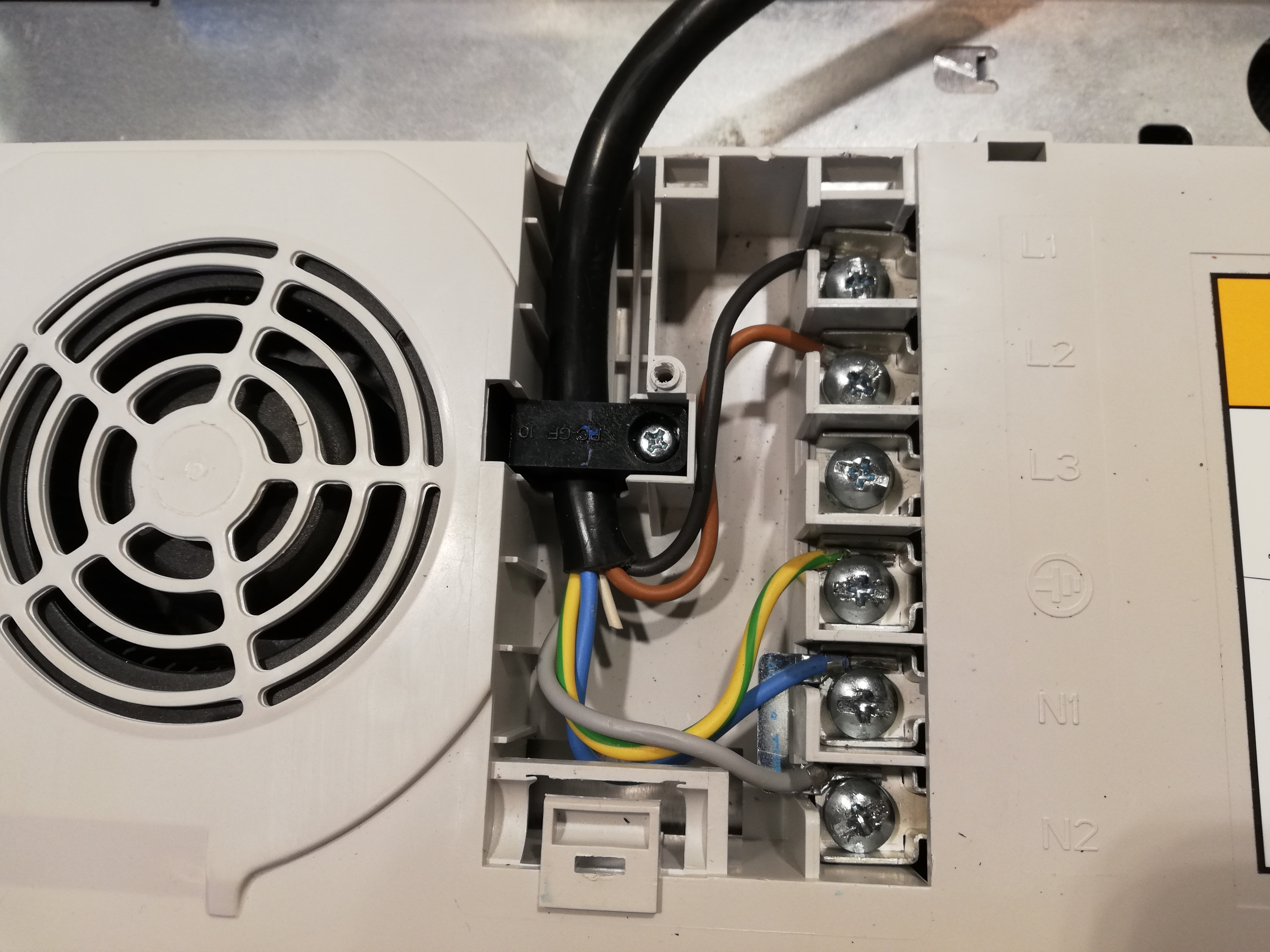

    Connecting Whirlpool SMC 654 F / BT / IXL Induction Hob to a Three-Phase Installation20200201_2..907.jpg (861.69 kB)You must be logged in to download this attachment.
    However, I did it as in the photo. Connection directly from the B16 three-phase protection to the board connector. The N wire must be connected to both N1 and N2 otherwise it will not flicker. I made it with the attached jumper.
