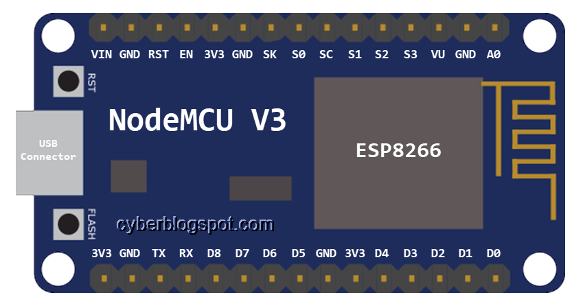

    >>21133802 Specifically, the ESP8266 NodeMCU V3

    Ok, so you have two possibilities, either you apply 7-12V to the VIN pin or you apply 5V to the VU pin.
    NodeMCU V3 board schematic with labeled pins. .
