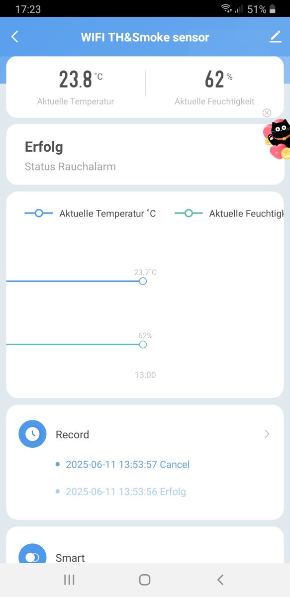

    Experience with ONENUO 228WTH Smoke-Detector with temperature and humidity function (this one: Link)?
    Did anyone already flash it to OBK? Which chip is inside, does power save still function well, as this a battery based device?
    I thought it might be useful to use it to observe a solar battery. If that has a problem, it might result in over-temperature first, before it produces smoke. So it might be possible to switch it off before it burns. And if it burns, there should be still alarm. Don't know if it's a good idea, honestly ;-)

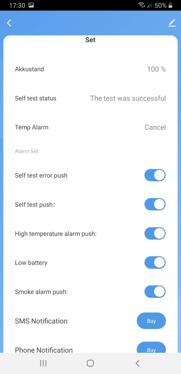

    It arrived now. Thes is what we get from Tuya Developer page:

    and also

    The sensitivity of the smoke sensor should be adjustable at least in two grades. But there is no configuration button for that. Maybe it was intended to be implemented, but wasn't finally.
    Isn't it possible to keep the WiFi-module running by letting the smoke alarm sound? Or will it go to sleep again, anyway, after transmitting the alarm?

    There is no reset button, but Values (like temperature) are actualized every 60 seconds.
    Baud rate is 9600. I did some tracking on the UARTs TX line. Normal operation on MCUs TX and RX, and triggering smoke alarm as well as triggering overtemperature alarm.
