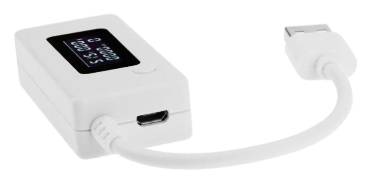

    In such dilemmas it helps to have a simple USB DOCTOR tester/meter:
    NodeMCU v3 - What is the maximum supply voltage via microUSB? .
    There are probably different types, so it's worth reading in the description what the allowable input voltage is.
