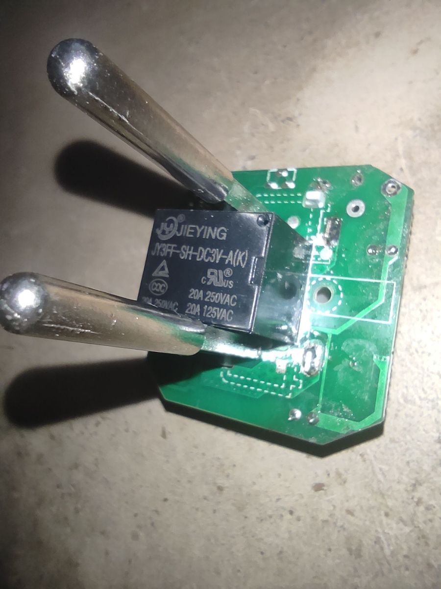

    I bought my first Zigbee socket, taking advantage of the fact that there were promotions on Ali, it came out to about 10,50zł.
    Exactly at this seller: https://pl.aliexpress.com/item/1005007256414108.html
    Today it came to me with the rest of the shpeju and I would not be myself if I did not start by taking it apart and see what is inside. And it is well... judge for yourself:

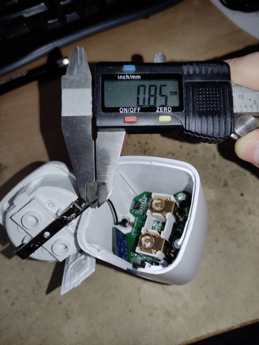

    - a protective cable from the "pin":
    A caliper measures the thickness of a metal component inside a disassembled Zigbee socket, showing 0.85 mm. .

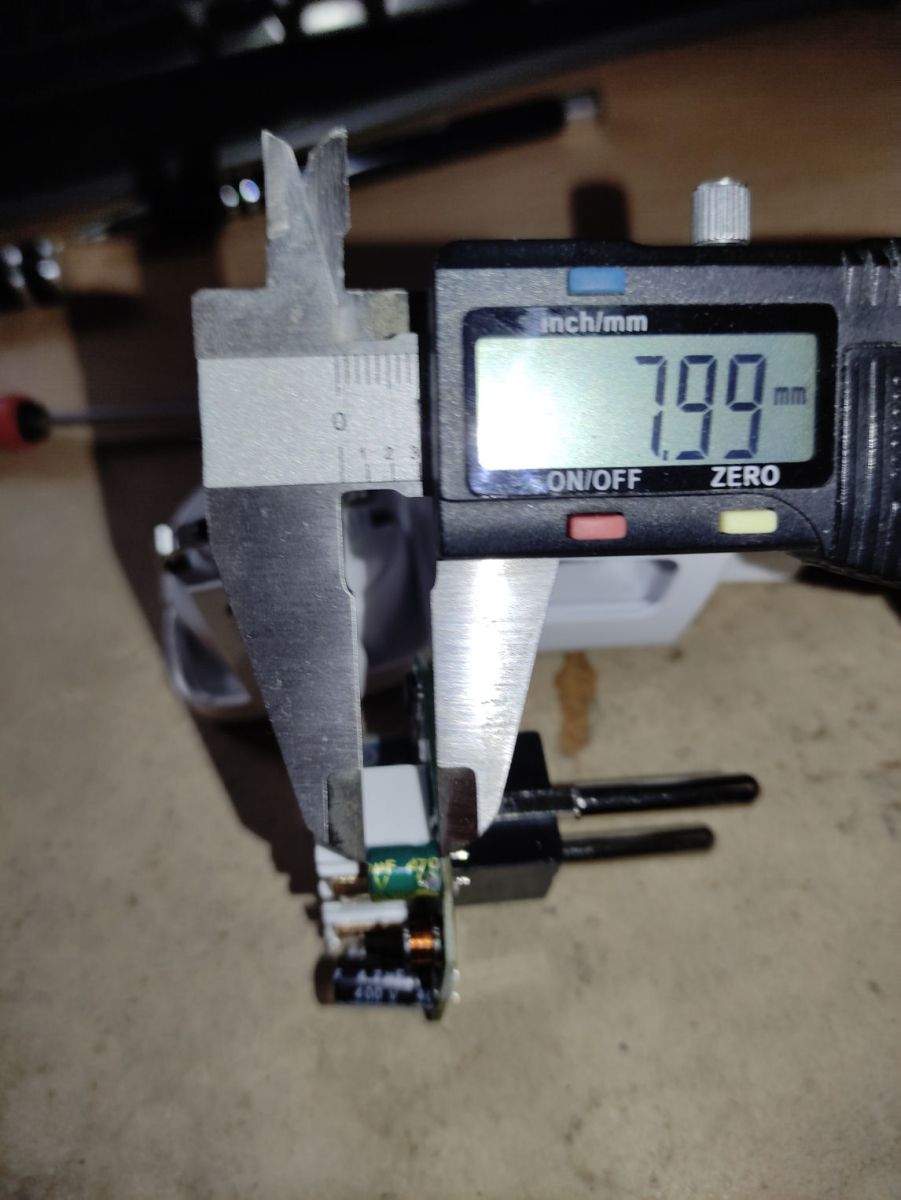

    - capacitor(s) on the low voltage side 470uF/10V:
    A digital caliper measures an electronic component on a circuit board, displaying 7.99 mm. .

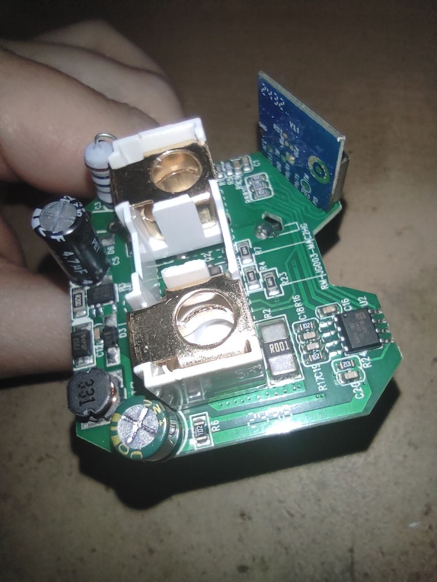

    - where is the stabiliser from 5V to 3.3V?
    A Zigbee socket’s circuit board with visible capacitors, ICs, and power terminals. JIEYING 3V relay mounted on a Zigbee socket PCB, with visible metal prongs. .
    And it doesn't. It is likely that the BP2525 inverter chip is set to 3.3V mode. And the relay itself is on 3V instead of 5V.

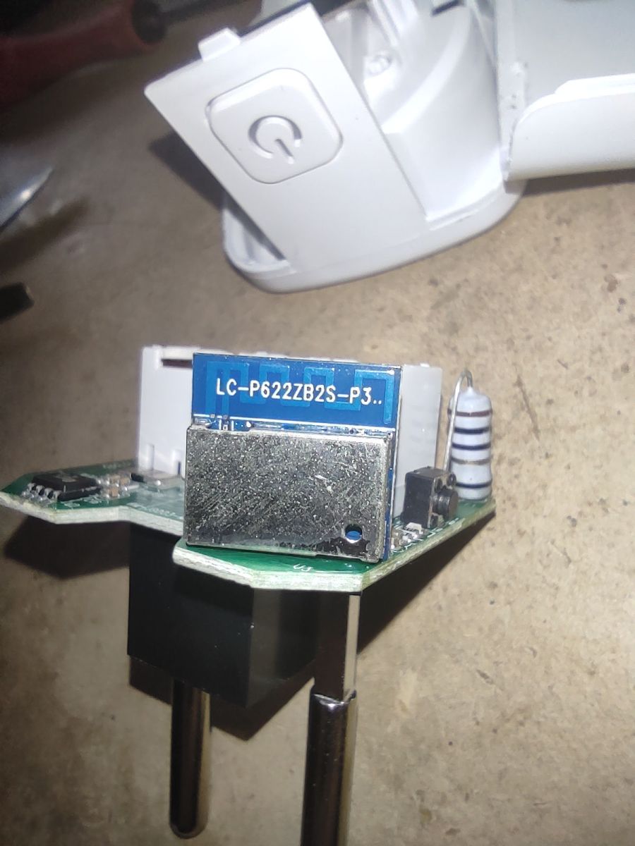

    - The Zigbee module itself is also quite mysterious:
    Close-up of the disassembled interior of a Zigbee smart socket, showing the relay module and electronics. .

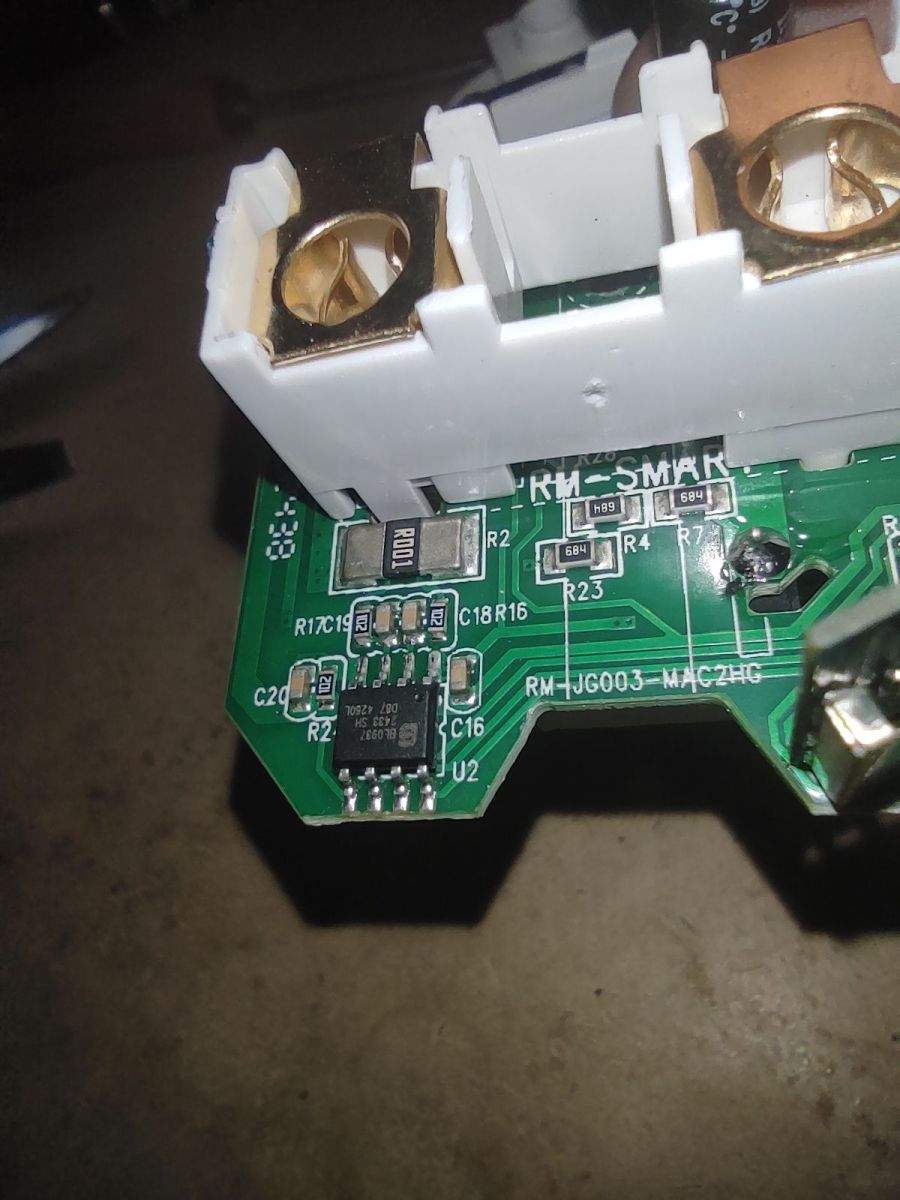

    - Only the BL0937 chip from energy measurement standard:
    Close-up of the Zigbee socket PCB showing the BL0937 chip. .
    When I saw this my first thought was, this cannot work well and.... I was right. After adding it to Zigbee2Mqtt and displaying the model description, it turned out:

    I took a quick measurement with a wattmeter, the switched off socket draws about 0.1W, while the switched on one draws 0.7W. Something a lot this 3V relay draws.
    I'll now leave the socket on for a couple of days and see if it switches itself off. I think these switch-off problems, if they occur, are from an unstable power supply.

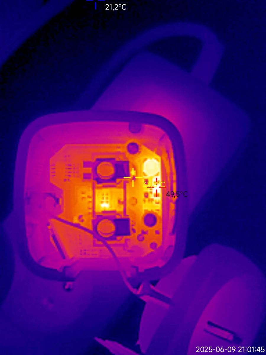

    EDIT:
    I'm also throwing in a photo of the thermal imaging about 40min after switching it on. There is no tragedy.
    Thermal image of the interior of a Zigbee smart plug showing hot spots up to 49.5°C after 40 minutes of use. .

    All powered from 3.3V? I don't think I've seen that before. I wonder how much they saved by removing those LDOs.

    Well, for the thickness of the PE wire, this deserves a denunciation to the OCC because this wire will not carry 16 A long term, which is what it is obliged to do.
    That is to say, dangerous electrical junk. A bit of a shame because it looks interesting.

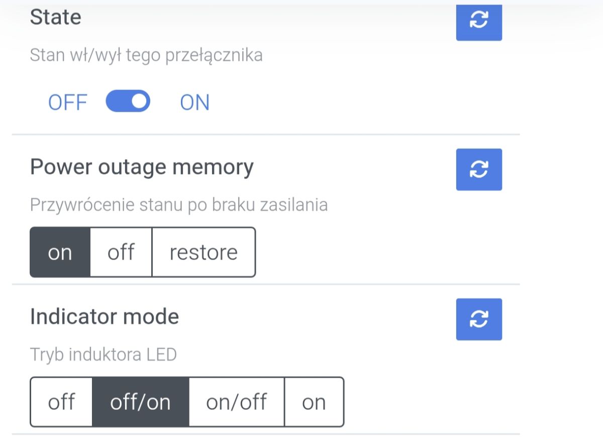

    How does the LED colour change on the button? I bought 1pc on trial from one dealer then wanted to buy more, he didn't have it so I bought from another. The first socket lights up blue when off and when I turn it on it still lights up red and looks like a pink colour. The other ones don't light up when switched off and when switched on the blue LED lights up. Same model and yet they are different. There are some LED indicator settings in the settings but changing this setting does not change the LED behaviour.
    Settings screen showing switch state, power memory, and LED indicator modes .

    The behaviour is that there is only a blue led, which by default lights up when the socket is plugged in, but with this indicator option you can change these settings and it works.

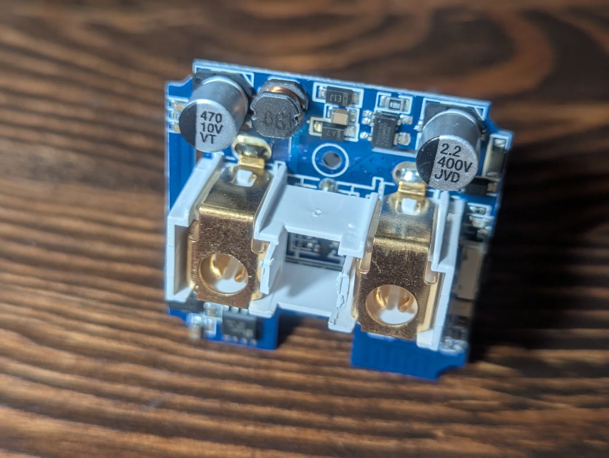

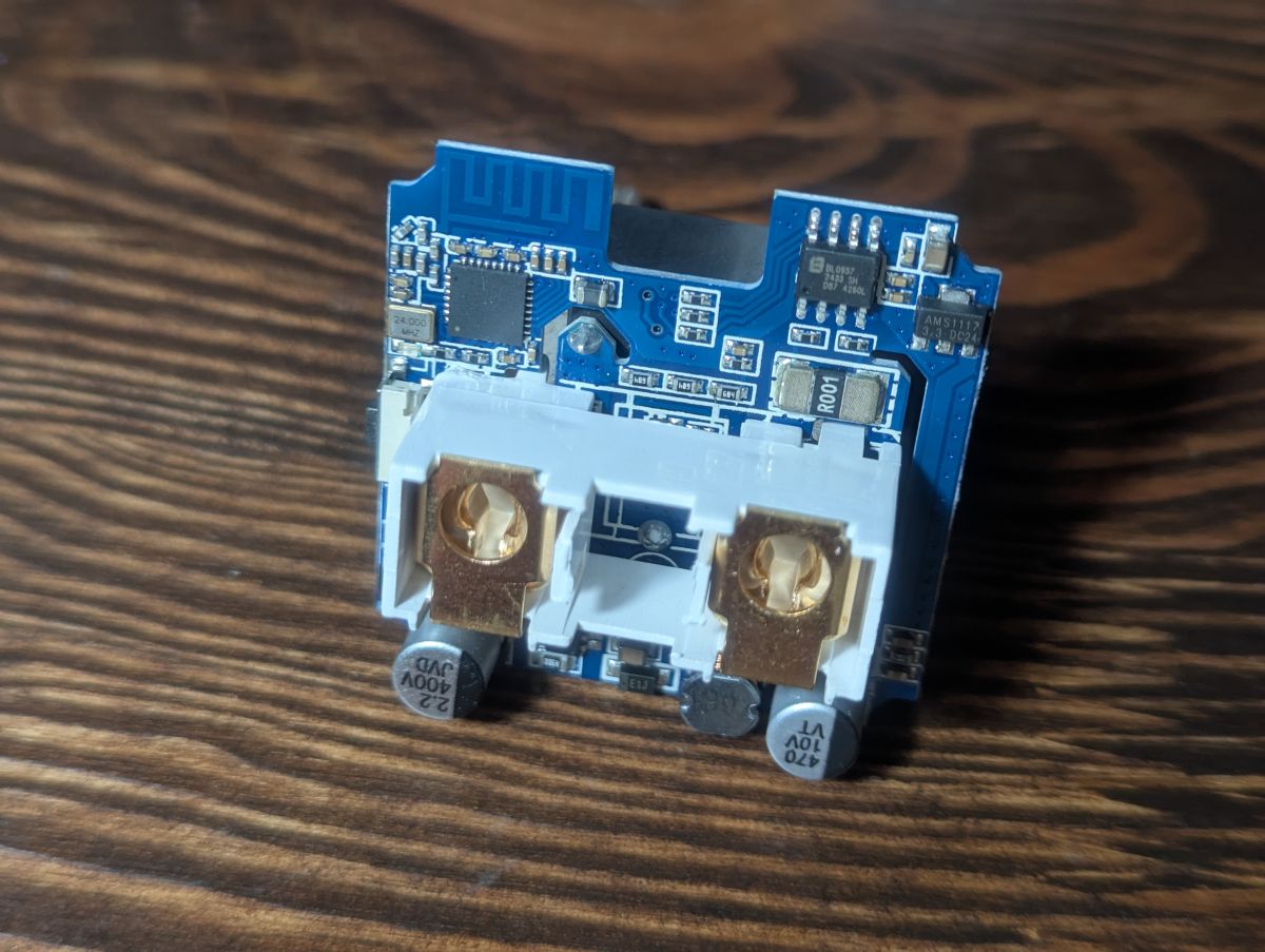

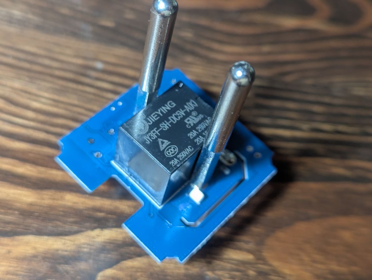

    My version is a bit different, the zigbee chip (no markings) is embedded on the basic board and not as a module. 5V relay. I will take pics in my spare time.
    Added after 11 [minutes]: .
    Close-up of a PCB with integrated Zigbee chip and 5V relay socket .
    Close-up of a PCB with electronic components and relay terminals .
    JIEYING JQF-SH-DC5V-1NO relay on blue PCB with two metal pins .
