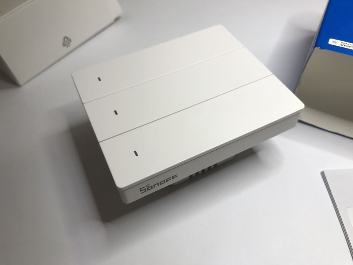

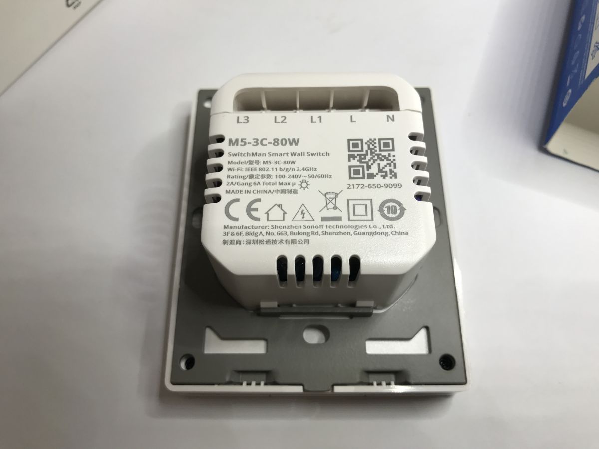

    Matter's M5-3C-80W three-channel wall switch allows direct or remote (via WiFi) control of three receivers and works with the eWeLink app, in addition to offering Matter protocol support. It is distinguished by three "clicking" buttons, which is a nice change from the ubiquitous touch solutions. The whole thing is available to buy for PLN80 and is built on ESP32. Here I will show its interior and see if it is possible to upload Tasmota to it?

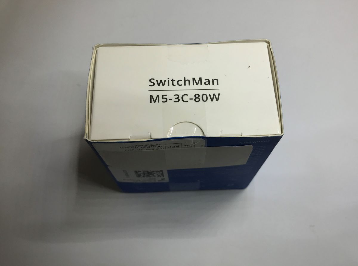

    Let's start with the packaging - the markings make it clear about Matter:
    Sonoff M5-3C-80W light switch from Matter to ESP32 - is it possible to change the firmware? Sonoff M5-3C-80W light switch from Matter to ESP32 - is it possible to change the firmware? .

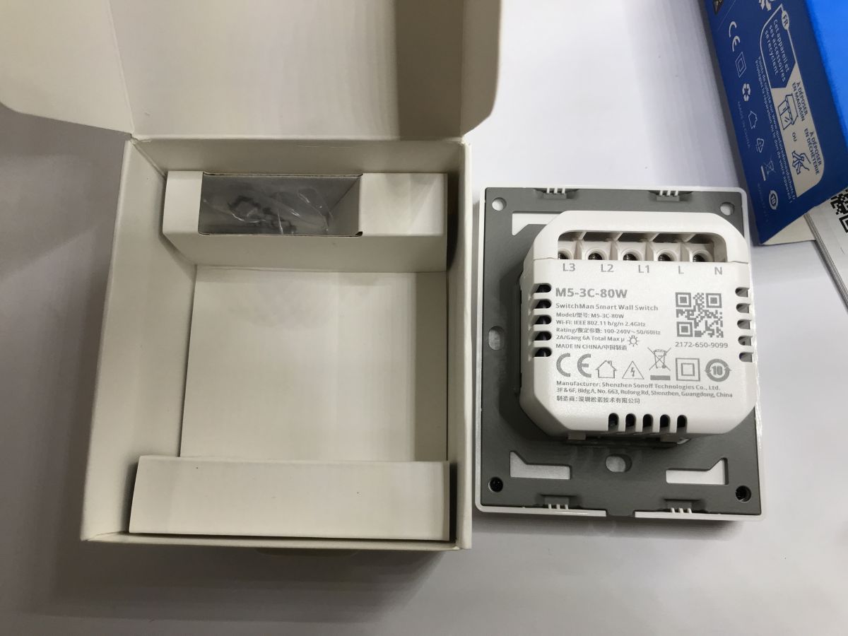

    Now the contents of the kit:

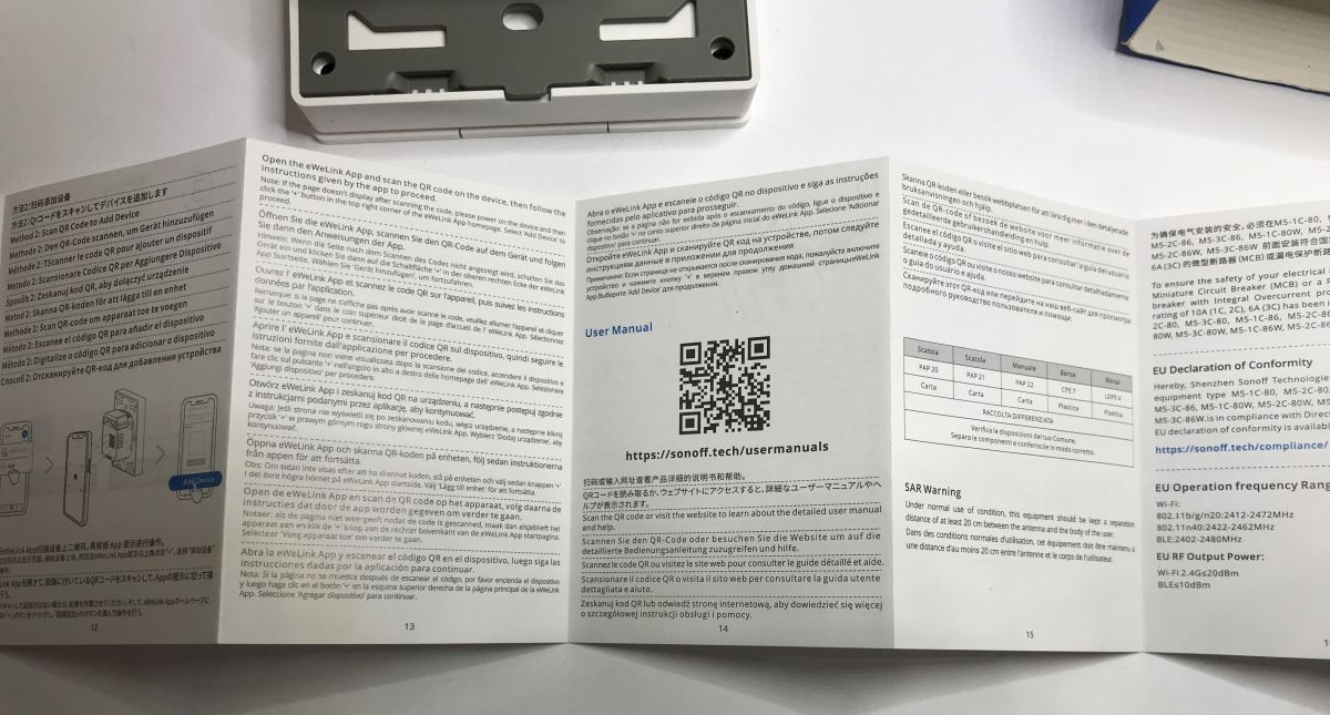

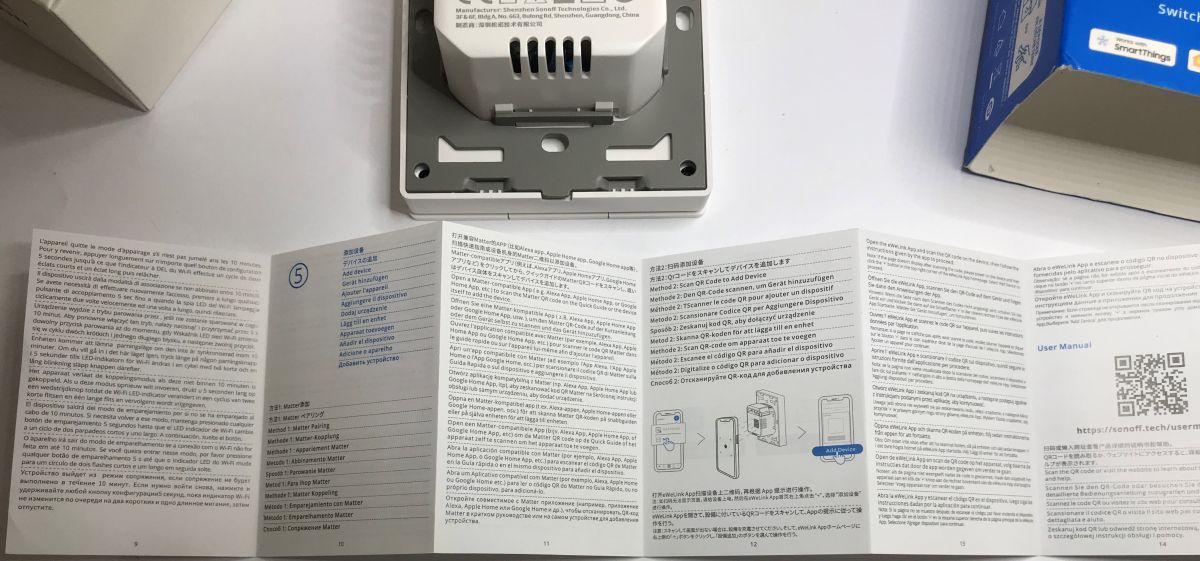

    Immediately striking is the unique QR code from Matter. Instructions:
    Sonoff M5-3C-80W light switch from Matter to ESP32 - is it possible to change the firmware? Sonoff M5-3C-80W light switch from Matter to ESP32 - is it possible to change the firmware? Sonoff M5-3C-80W light switch from Matter to ESP32 - is it possible to change the firmware? .
    I've already presented the eWeLink application, and I plan to cover Matter separately, so now it's time to present the interior.

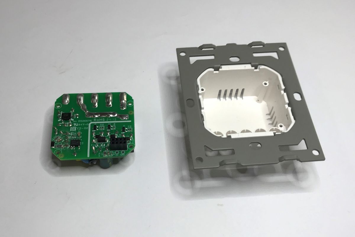

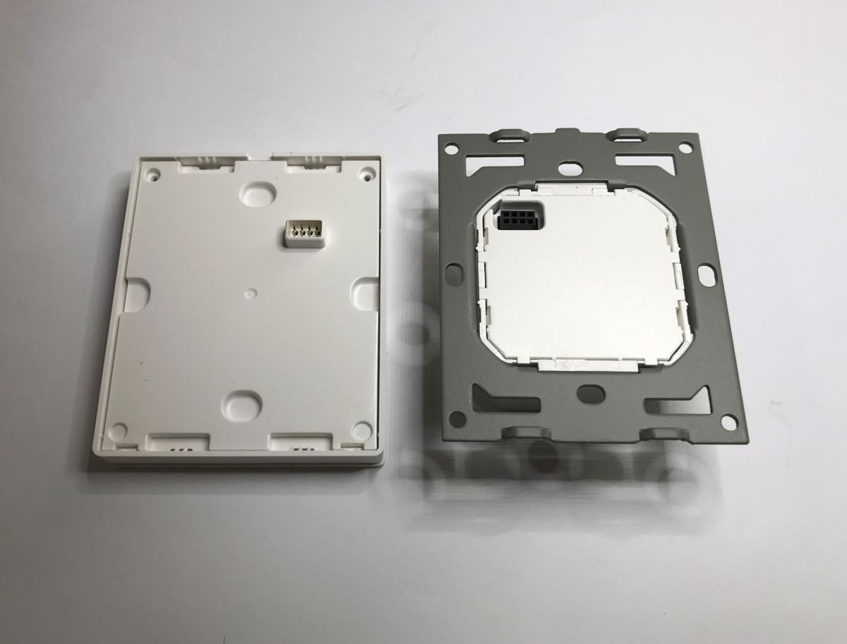

    We remove the top cover:

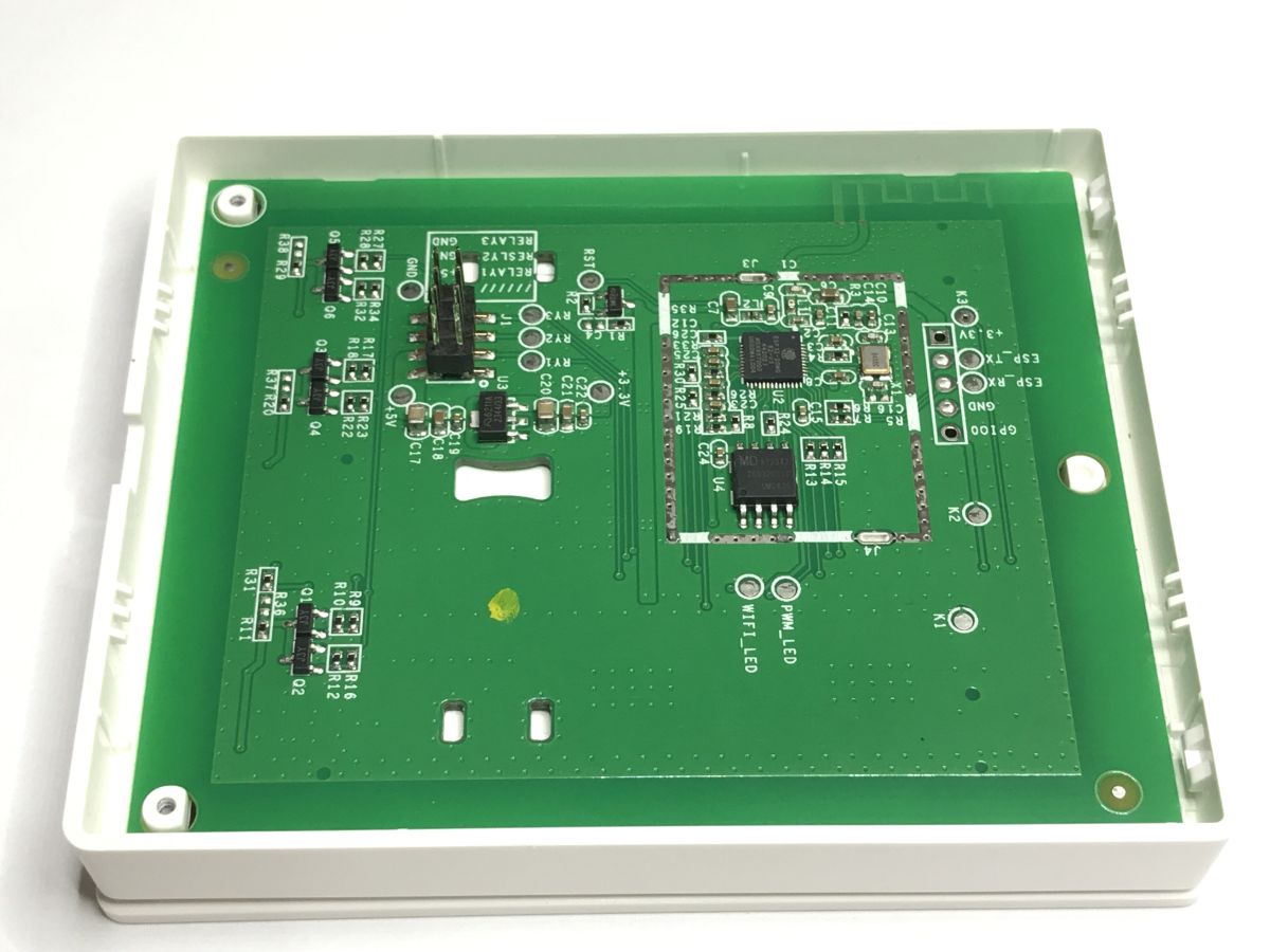

    Here it is slightly different to the Tuya products. The front panel is also removable, but here it is separately completely enclosed in a plastic housing.

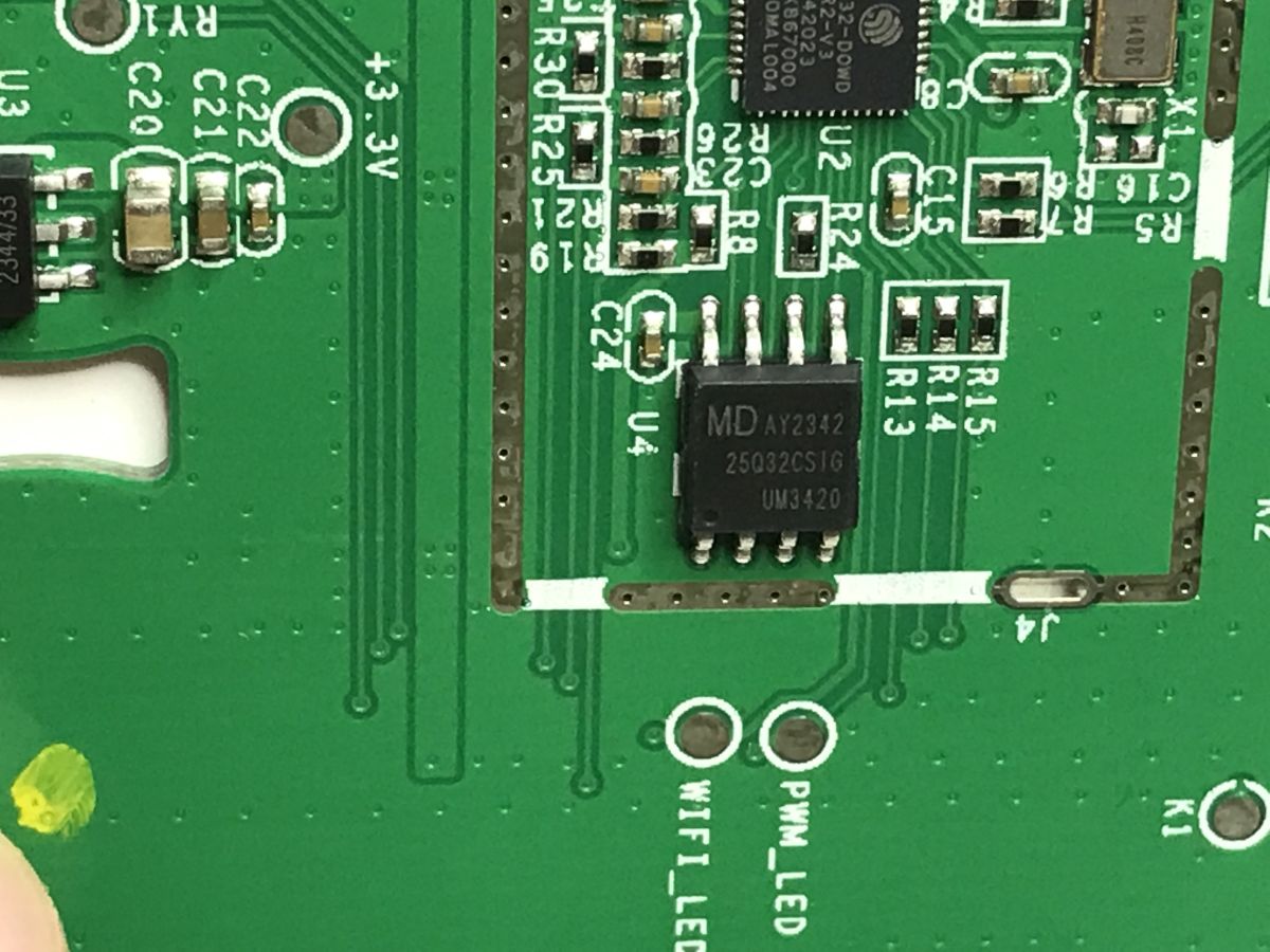

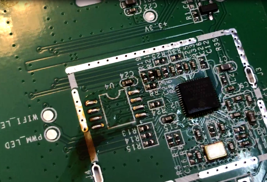

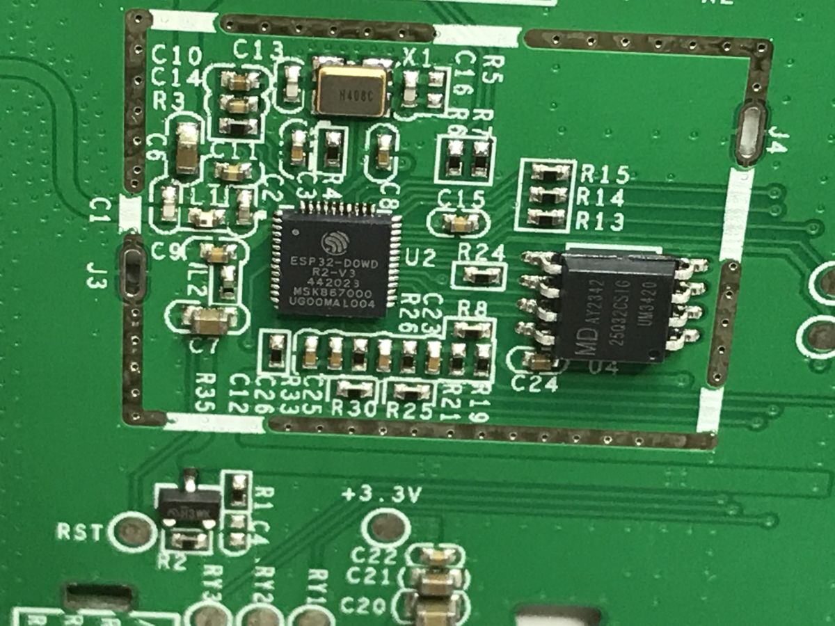

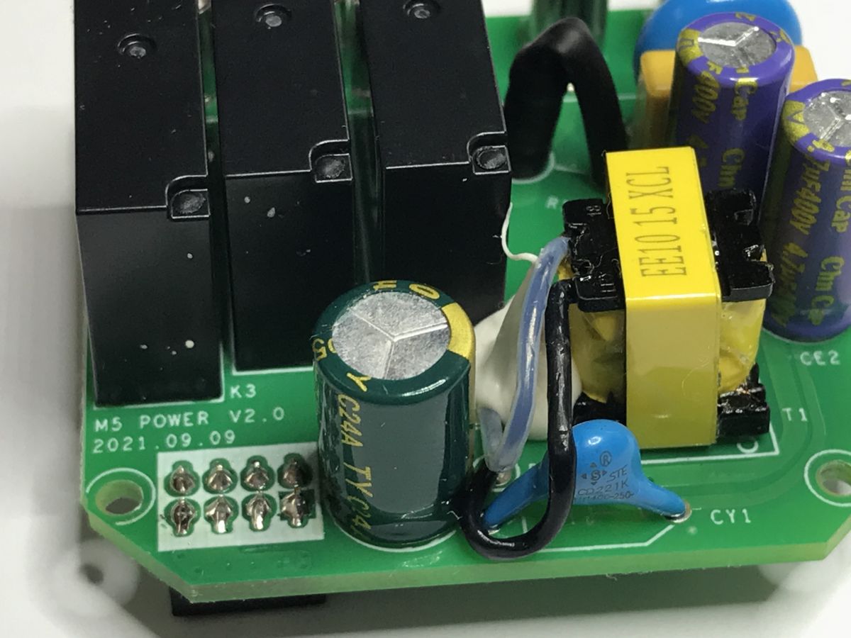

    The ESP32-DOWD-R2-V3 is directly on the PCB, right next to it is the Flash memory with its program. We also have a programming connector here and a 3.3V LDO providing power. I also see additional transistors - I wonder if they are from controlling the relays on the other PCB, or something else? Let's check.

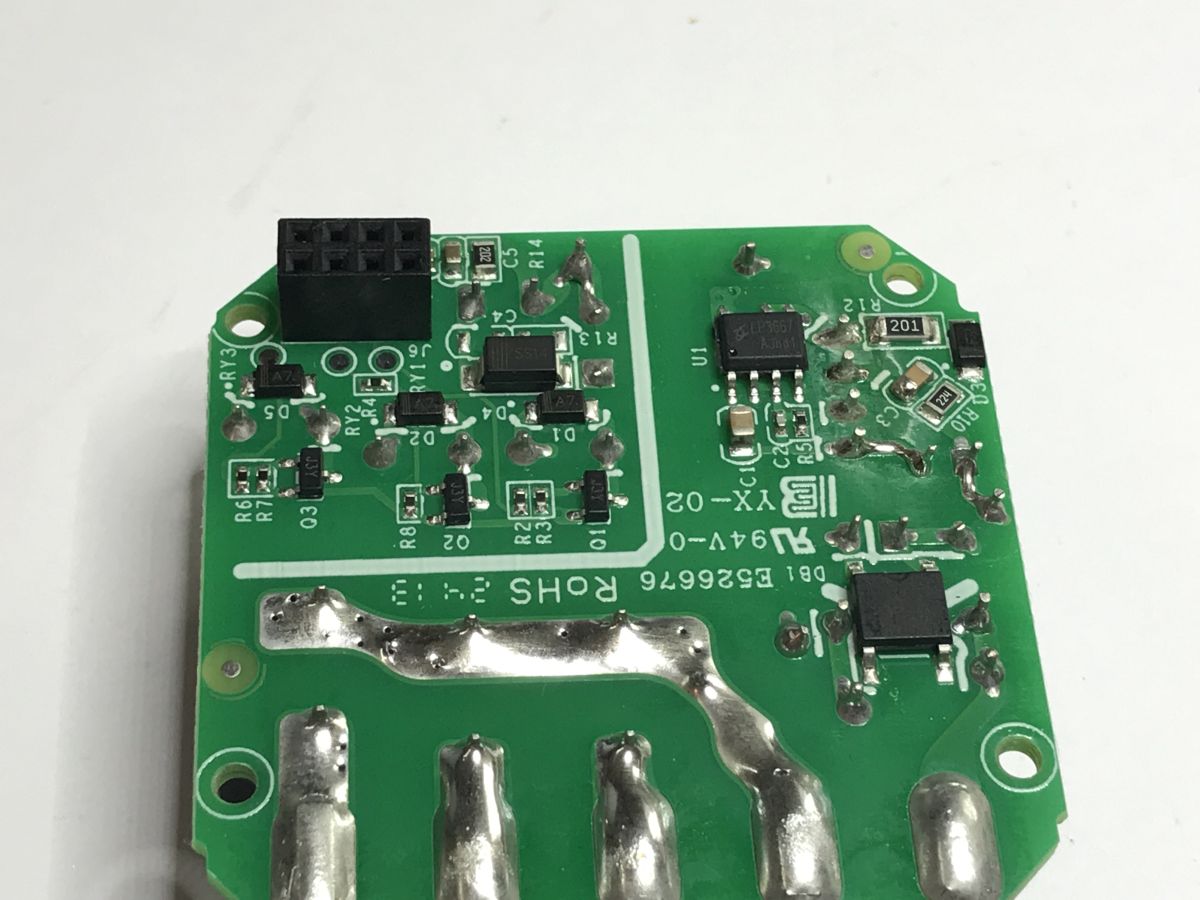

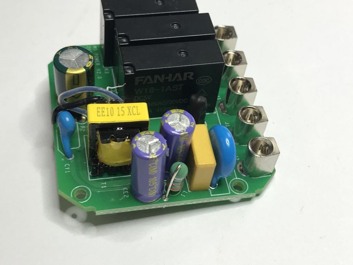

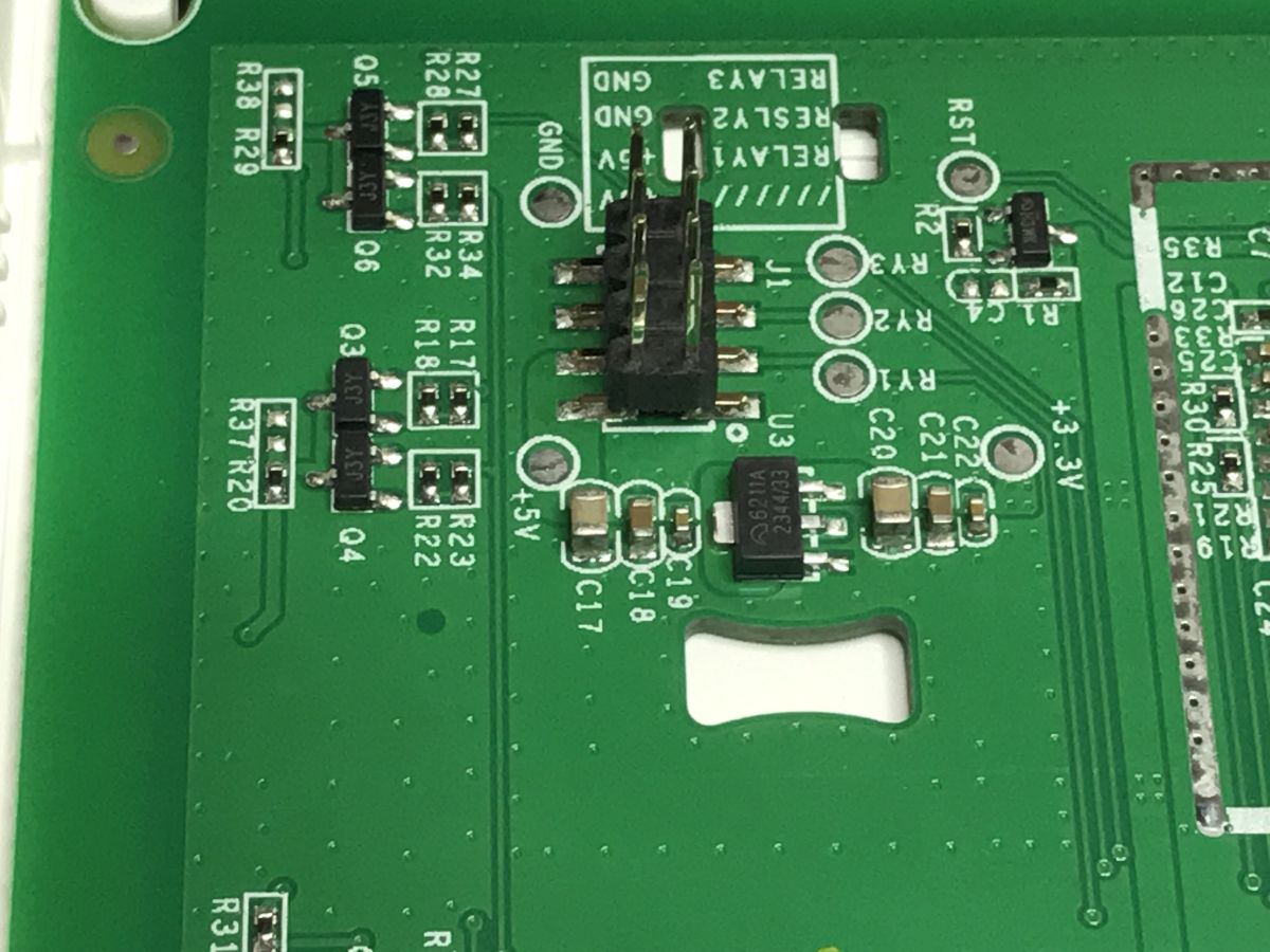

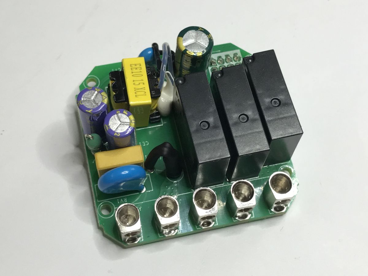

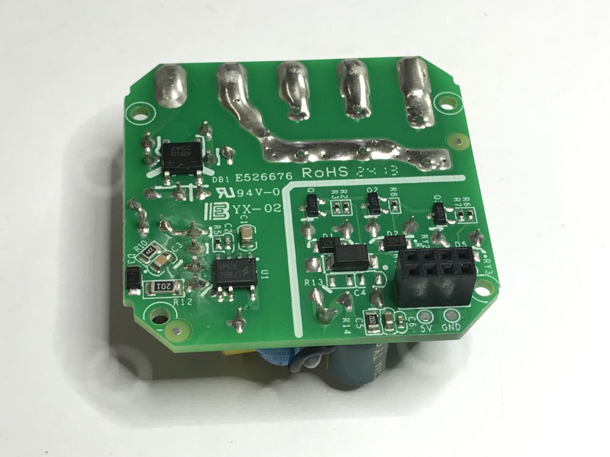

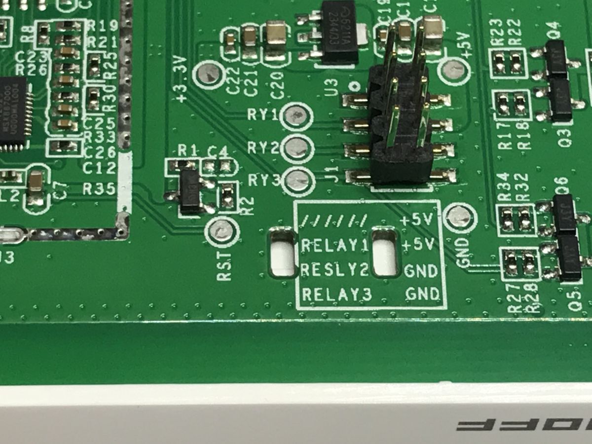

    The executive board can still be viewed:
    Here, however, I see transistors from the relay control (J3Y as usual), so those must have been from something else. Apart from that, I see the main inverter controller here - LP3667.

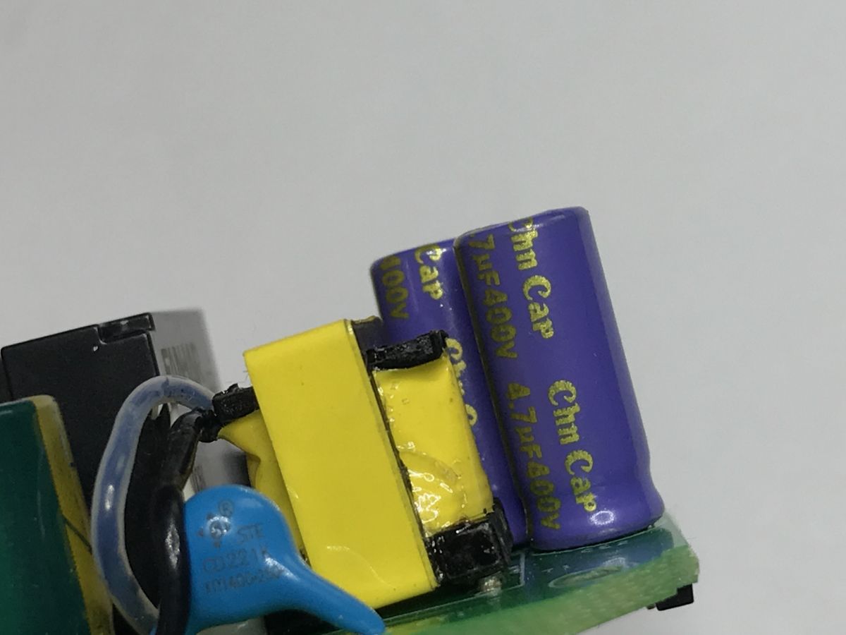

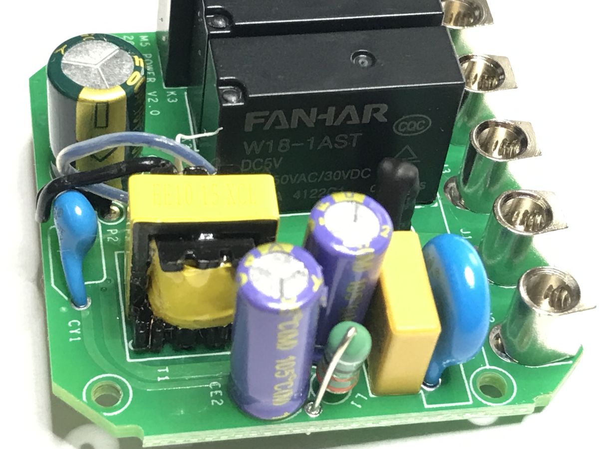

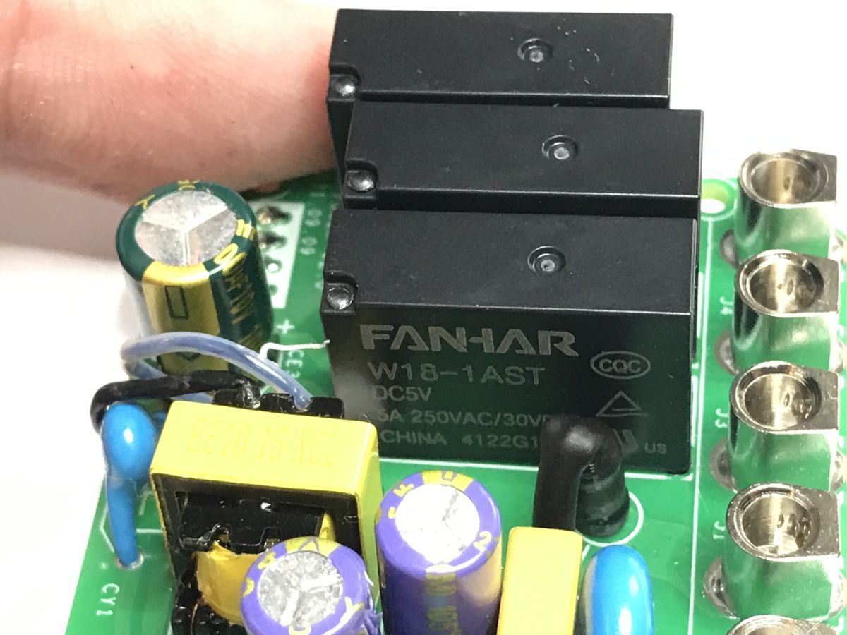

    The rest of the circuit is fairly standard. The relays are on 5V (FANHAR W18-1AST), so the power supply must give 5V. Then only the LDO provides 3.3V for the ESP. In addition, I was positively surprised by the presence of a CY capacitor (so it's a flyback topology, not a non-isolated inverter) and a varistor and filter capacitor at the input. Sonoff does not save as much as Tuya.

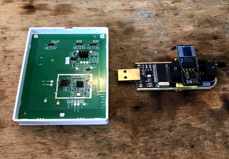

    Time to try changing the firmware.
    I started with the esptool approach. I connected the RX, TX, power supply and GPIO0 as standard. Unfortunately - the ESP is locked:

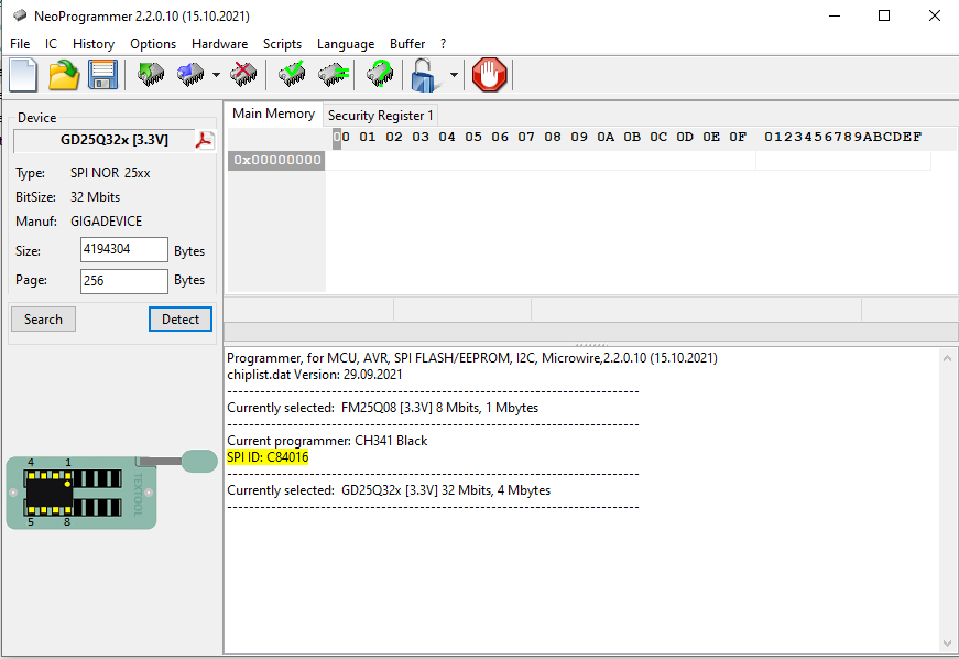

    In the end I gave up and only did a memory dump on the CH341 programmer. It won't do much, as the ESP verifies this program anyway and won't run a "foreign" batch, but maybe someone will find it useful for analysis.
    Sonoff M5-3C-80W light switch from Matter to ESP32 - is it possible to change the firmware? M5-3C-80W wall switch PCB and USB CH341 programmer on a wooden workbench. .
    A copy of the batch is available on my repository: https://github.com/openshwprojects/FlashDumps/tree/main/IoT/ESP32
    In summary , it looks like here we have an ESP32 protected from uploading new software. This is not new, there have been other Matter products presented on the forum and there was a similar problem. Fellow @divadiow also presented them in several topics. It seems that here the only option to change the batch is to swap the whole ESP. You simply have to solder out the ESP and solder a non-blocked chip in place, and that would already be QFN soldering.... well, I don't know if it's worth playing around with that much? What do you guys think? Or is it enough to use the manufacturer's cloud?

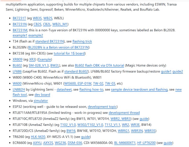

    Might even try to demonstrate uploading Supla to some device with ESP soon. Maybe on some Sonoff. You could also consider swapping a module with a different chip to a module with ESP and upload Supla there.
    You could also consider our "electrode" project, as the inside is something from this list and doesn't need missing drivers:
    Spoiler:
    A list of supported chipsets with links to guides and examples for firmware flashing, including BK7231T, BL602, LF686, W600, ESP32, and RTL8195A. .
    For now though, I'm thinking about this Supli. As I tested it there were positive impressions: Pairing and configuration of Supla devices without using a mobile phone .

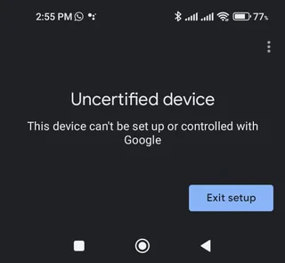

    gulson wrote:
    You know why they block if there is Matter?
    I heard from a friendly importer that Matter requires top-down certification and this may be one of the requirements. I have not yet confirmed this information.
    There may be something to it, they write something about certification on Reddit too:
    https://www.reddit.com/r/MatterProtocol/comme...high_cost_of_matter_certification_a_startups/
    Error message on device screen indicating lack of Google certification.
    Hey Reddit community,
    I'm part of a small startup working on smart home devices using the Matter protocol. We're facing a significant hurdle that I believe many in this space might relate to: the steep cost of certification by the Connectivity Standards Alliance (CSA).
    To get our products certified, we're looking at fees ranging from $9,000 to $13,000 per product, on top of an annual CSA membership fee of at least $7,000. For a startup like ours, these costs are daunting and pose a real barrier to entry. It feels like a classic case of "the rich get richer, while the poor struggle to get a foothold."
    The situation is further complicated by different policies across ecosystems. In the Apple world, we can add Matter devices without needing certification, which is a huge relief during development and testing. However, Google's policy is less forgiving, allowing only uncertified Matter devices during the development phase.
    We're reaching out to this community for advice:
    Are there any strategies or avenues for startups like us to manage these high certification costs? How are others dealing with the economic disparities in this field? Any insights into navigating the differing policies of Apple and Google would be immensely helpful. Appreciate any thoughts or shared experiences. Thanks for the support!

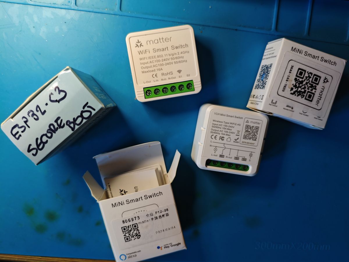

  • Locked ESP Matter device shows secure boot enabled
    #11 21576606
    Posts: 5126
    Help: 442
    Rate: 905

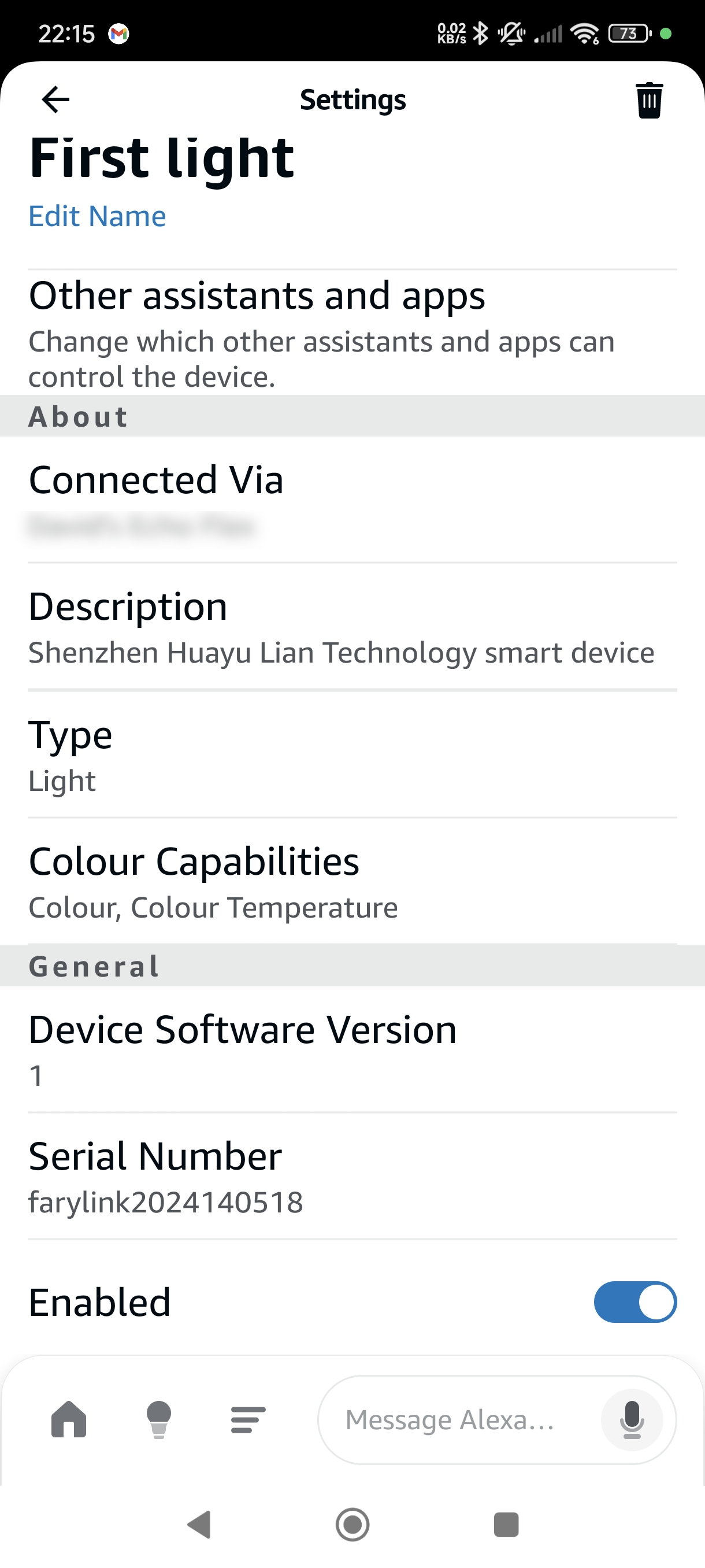

    Yes, it is quite a disappointment when a locked ESP Matter device arrives 😭
    My first post about a locked Matter is here with the SM-028C3 module https://www.elektroda.com/rtvforum/topic4032988.html#20965795
    I don't like seeing those dreaded words in the boot log: "secure boot verification succeeded"
    Thankfully Tuya/MOES can be relied upon for Matter devices that don't appear to be locked. Beken chips, however.
    Converting Moes Tuya Matter Bulb with CBLC5 Module to OpenBeken: Discoveries
    Tuya MOES US Matter MWP-LO-US15M-EN Smart Plug BL0942 BK7231N - Info Dump
    I have an untouched GU10 Matter bulb that I think has CBLC5 and I expect to be fully flashable. One assumes these are not certified.

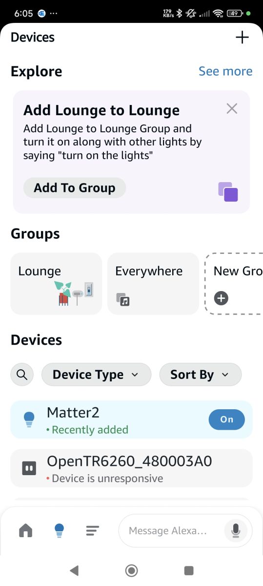

    I don't have any Google Hubs so have never paired with Google, but Alexa never seems to have an issue with these types of non-ESP Matter.
    GU10:
  • #14 21576810
    Posts: 14683
    Help: 656
    Rate: 12711
    It would be interesting to see if you can take a matter device backup, flash it to two other BK7231 dev boards, and then connect it to the app as two separate devices. Probably not, because of the duplicated unique device key.
  • #15 21576893
    Posts: 5126
    Help: 442
    Rate: 905
    Doing this with Alexa just now and the second Matter device just seems to knock off the first, so I guess it sees it as the device having been reset and you're re-pairing it.
    Added after 9 [minutes]:
    behaviour is the same in the Tuya app, which doesn't require a QR code. But then you'd expect that for any identical-firmware pairing.

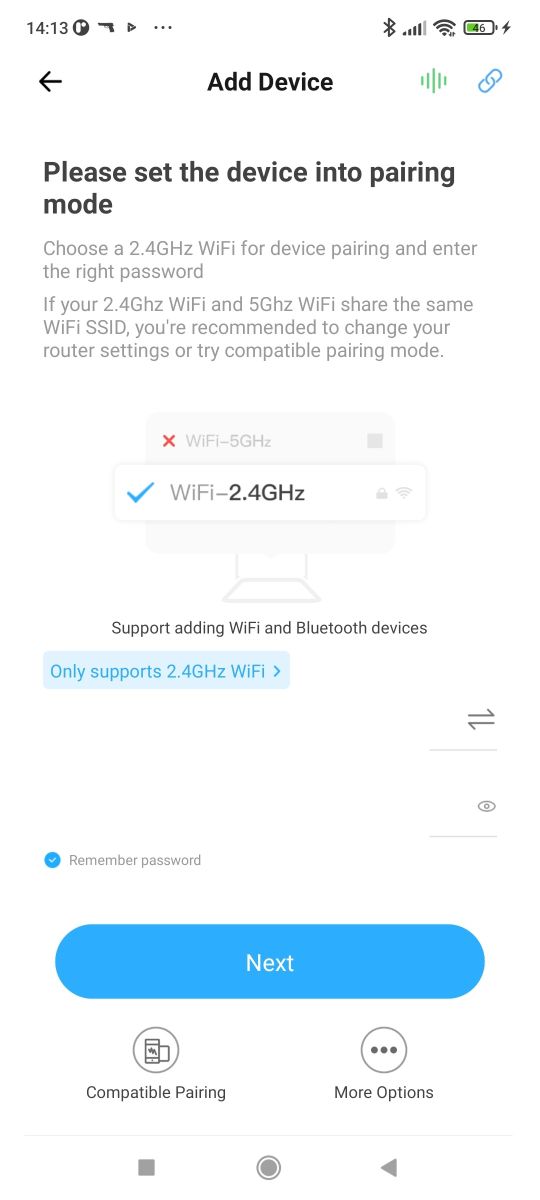

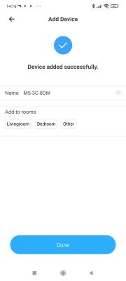

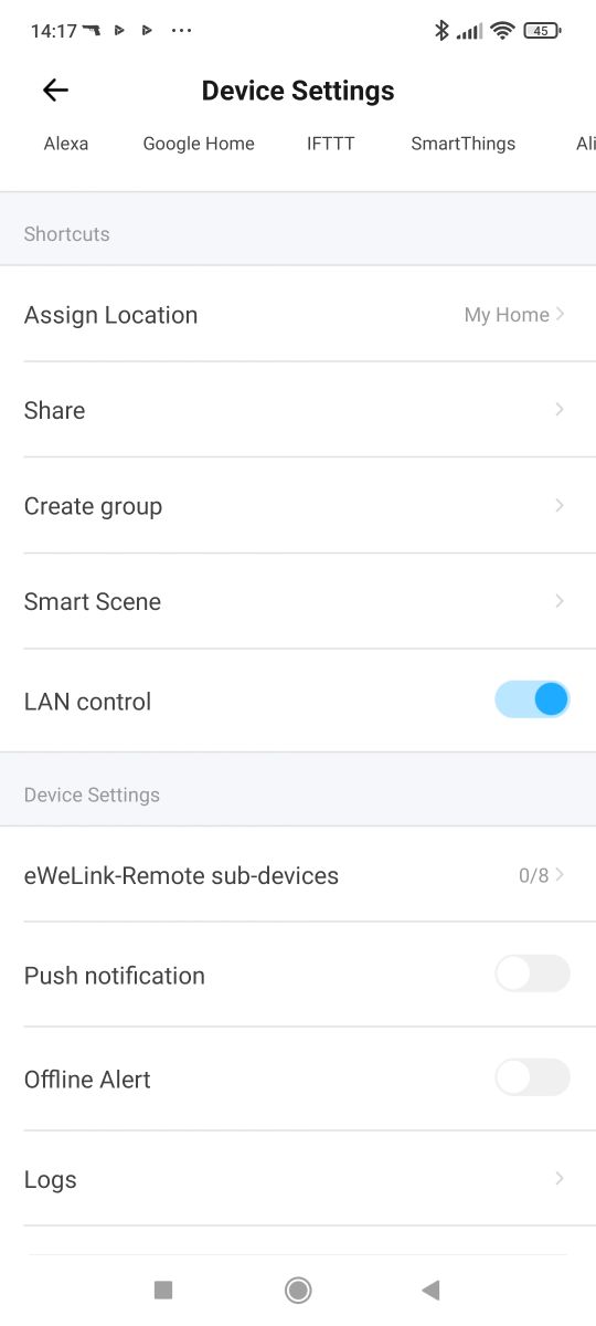

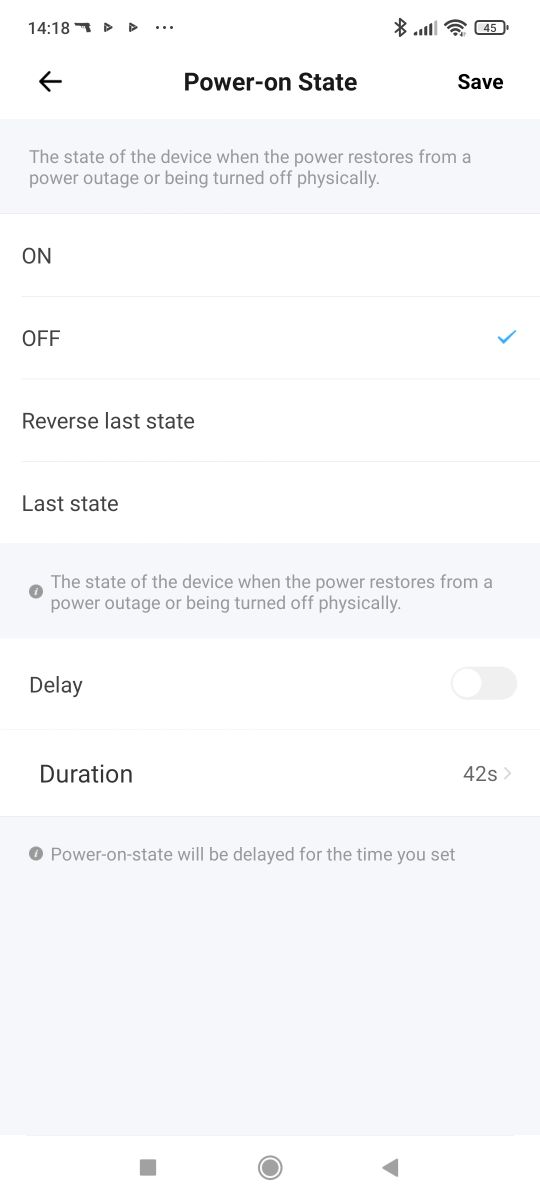

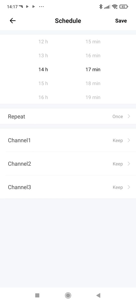

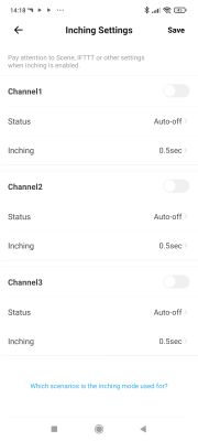

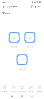

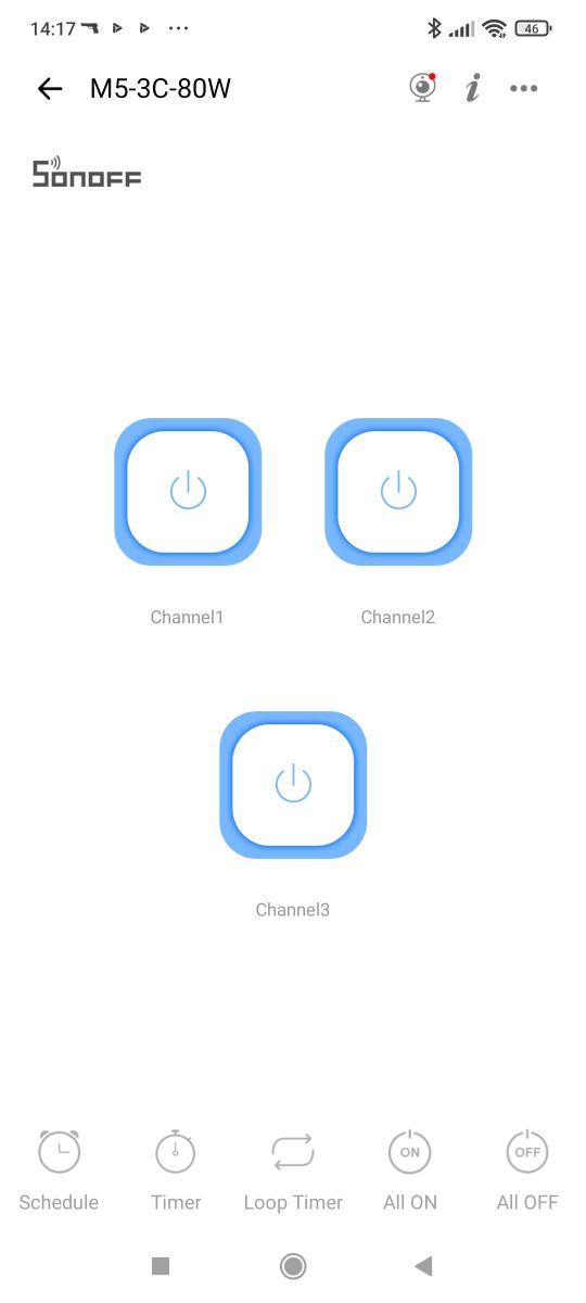

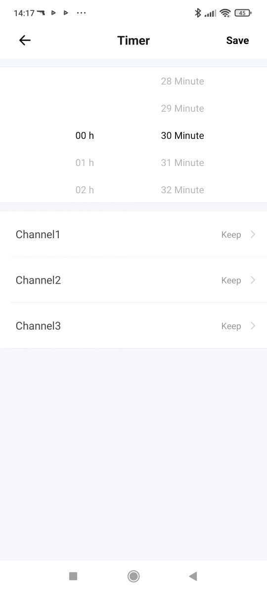

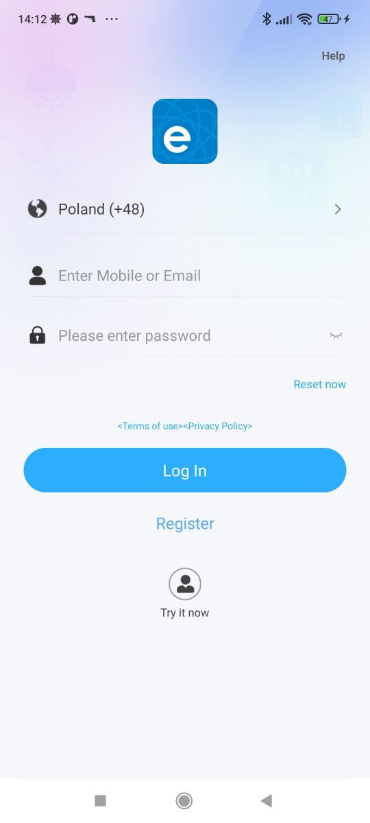

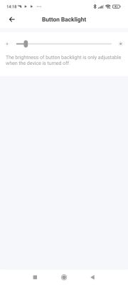

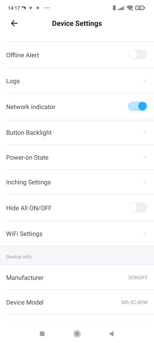

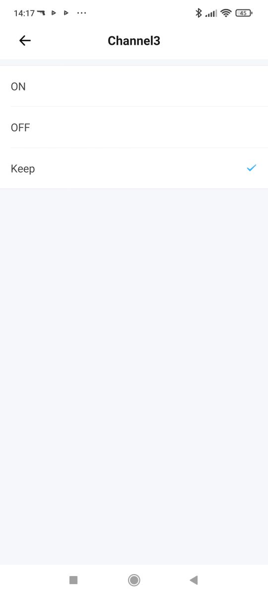

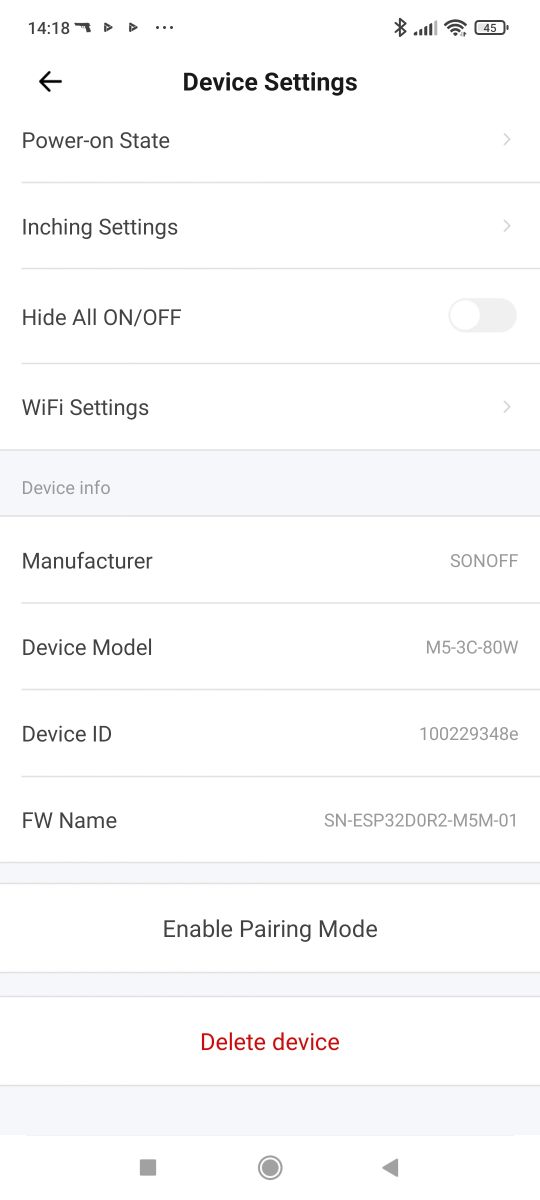

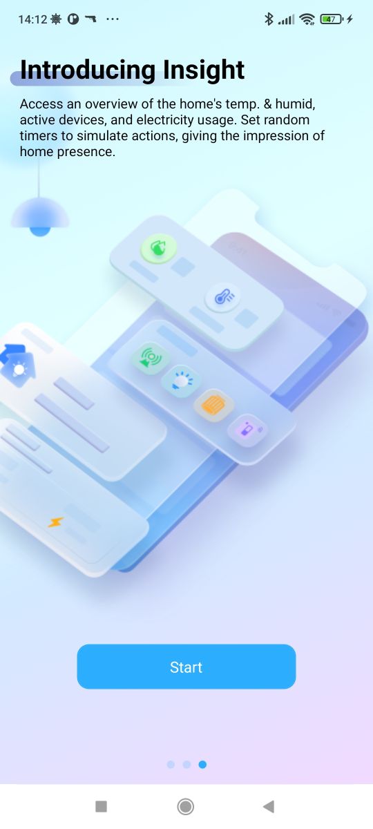

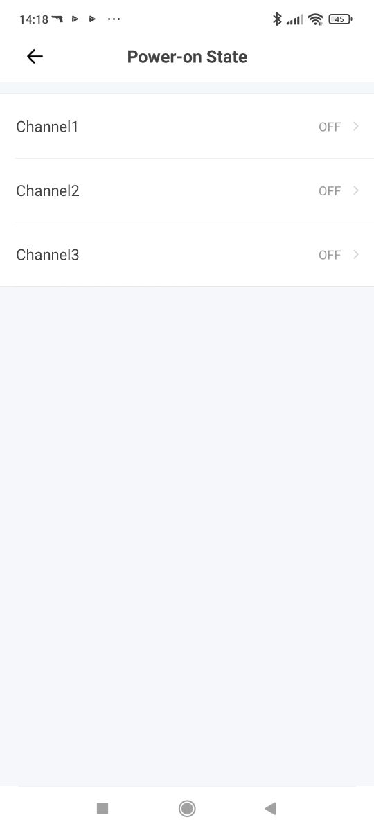

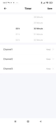

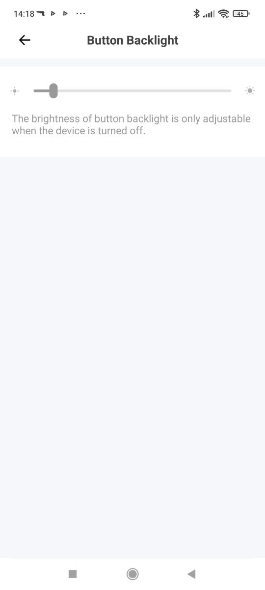

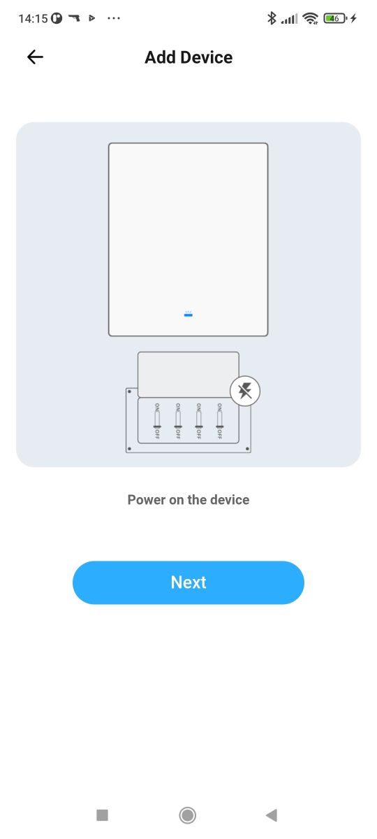

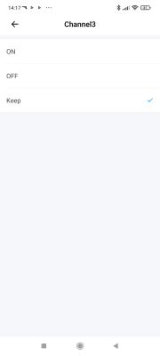

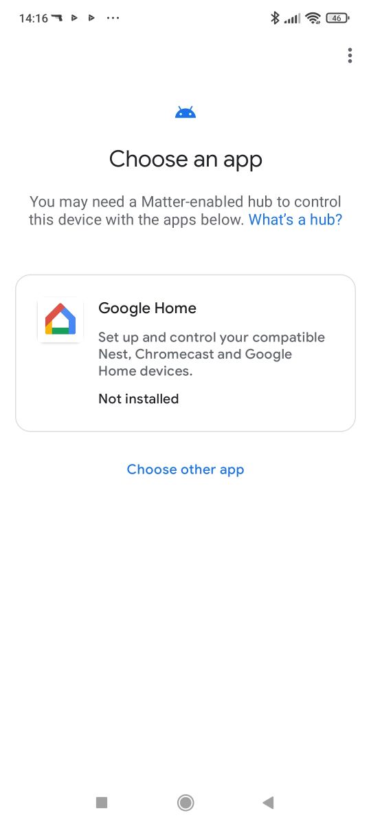

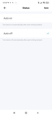

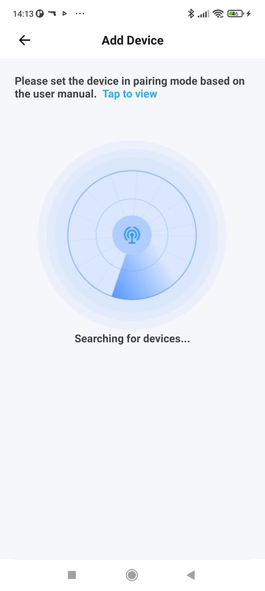

  • Flash reading and eWeLink app screenshots
    #16 21577232
    Posts: 14683
    Help: 656
    Rate: 12711

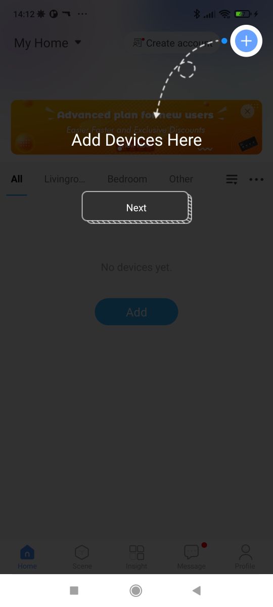

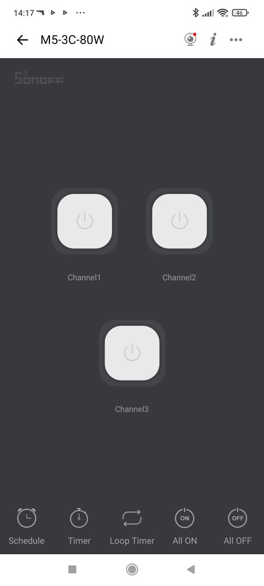

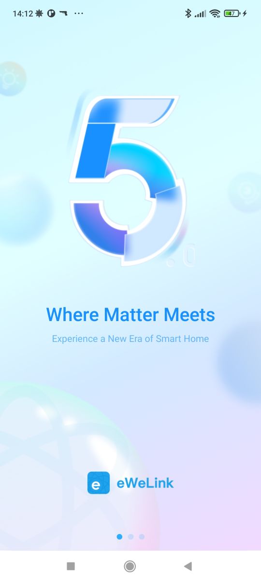

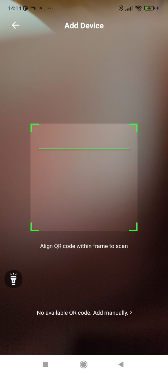

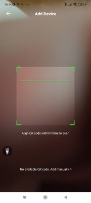

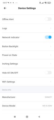

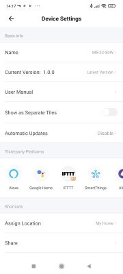

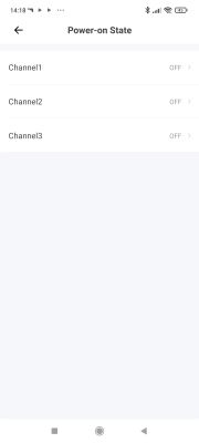

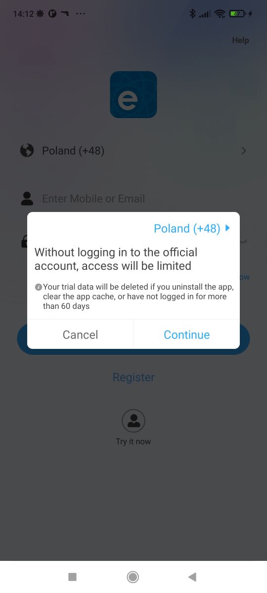

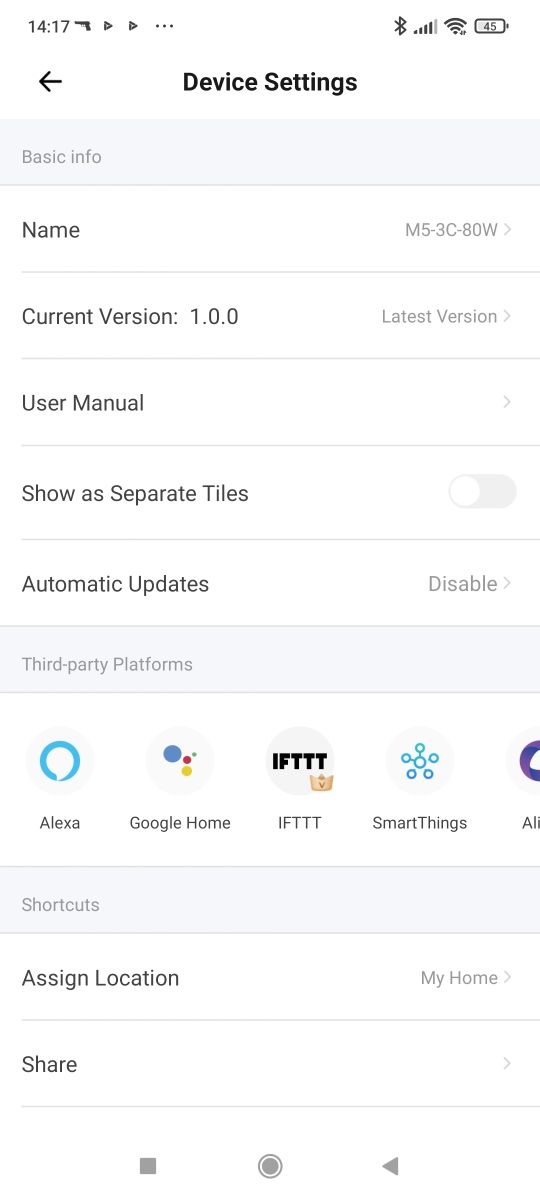

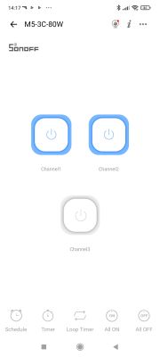

    I am adding a screenshot of the flash reading and the eWeLink app:

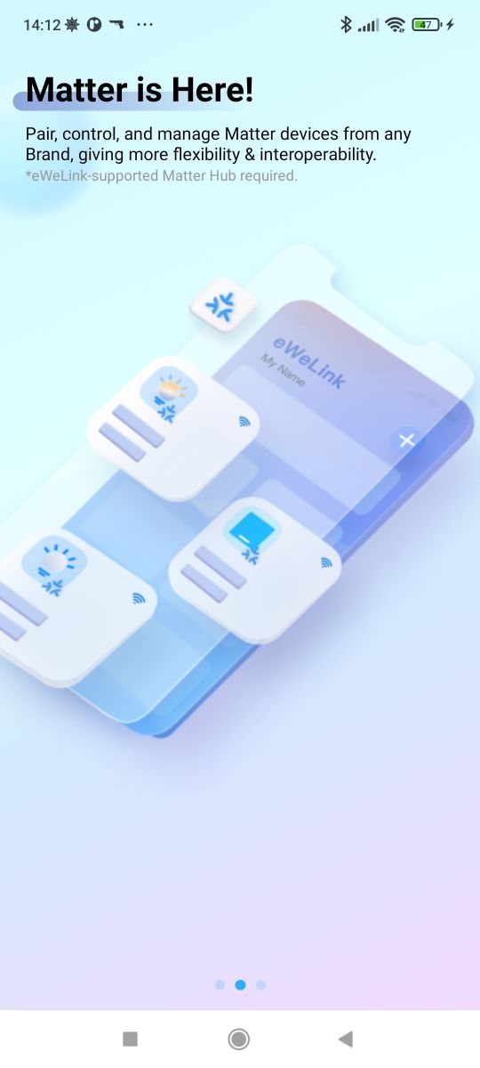

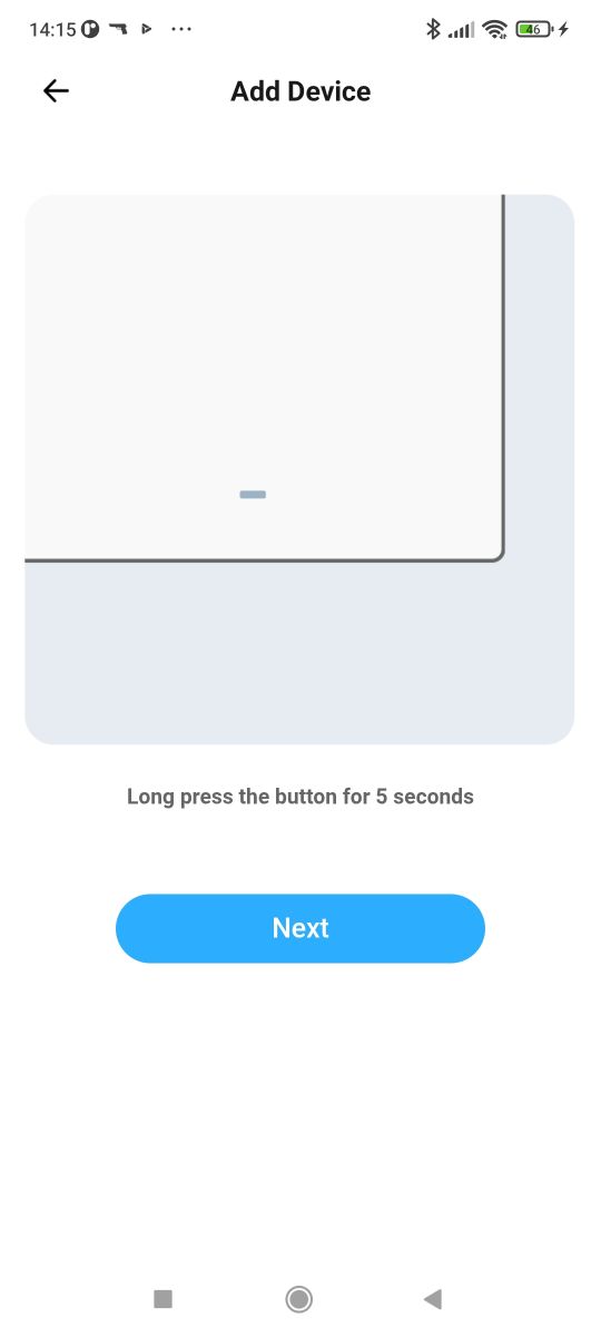

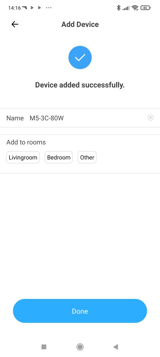

    Application:
    Sonoff M5-3C-80W light switch from Matter to ESP32 - is it possible to change the firmware? Sonoff M5-3C-80W light switch from Matter to ESP32 - is it possible to change the firmware? Sonoff M5-3C-80W light switch from Matter to ESP32 - is it possible to change the firmware? Sonoff M5-3C-80W light switch from Matter to ESP32 - is it possible to change the firmware? Sonoff M5-3C-80W light switch from Matter to ESP32 - is it possible to change the firmware? .

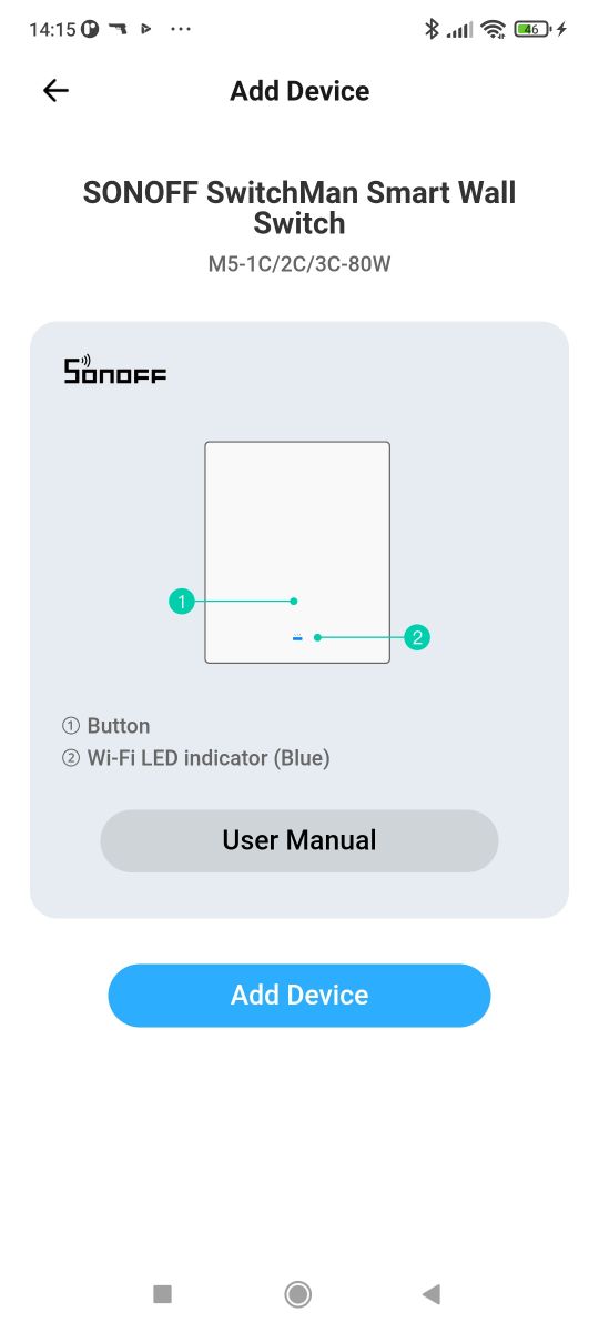

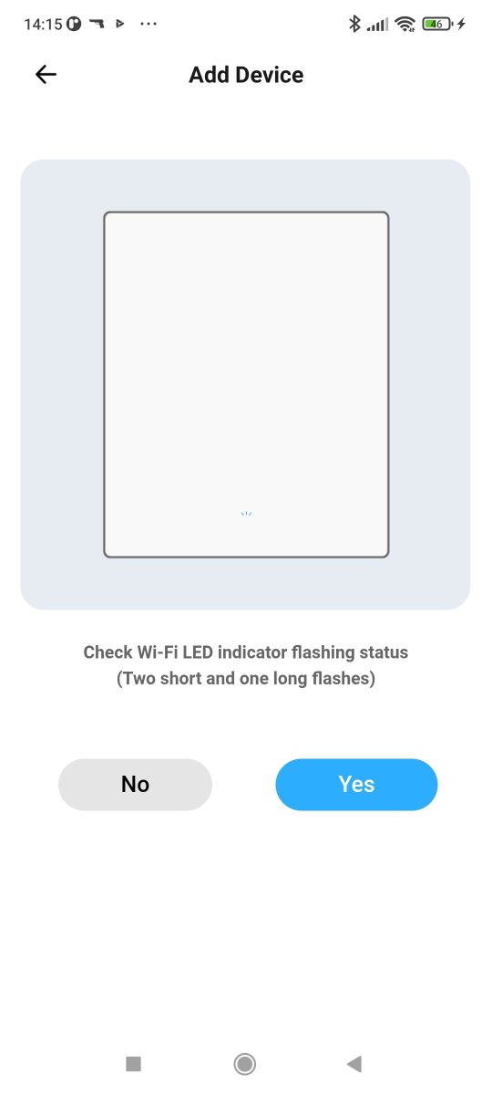

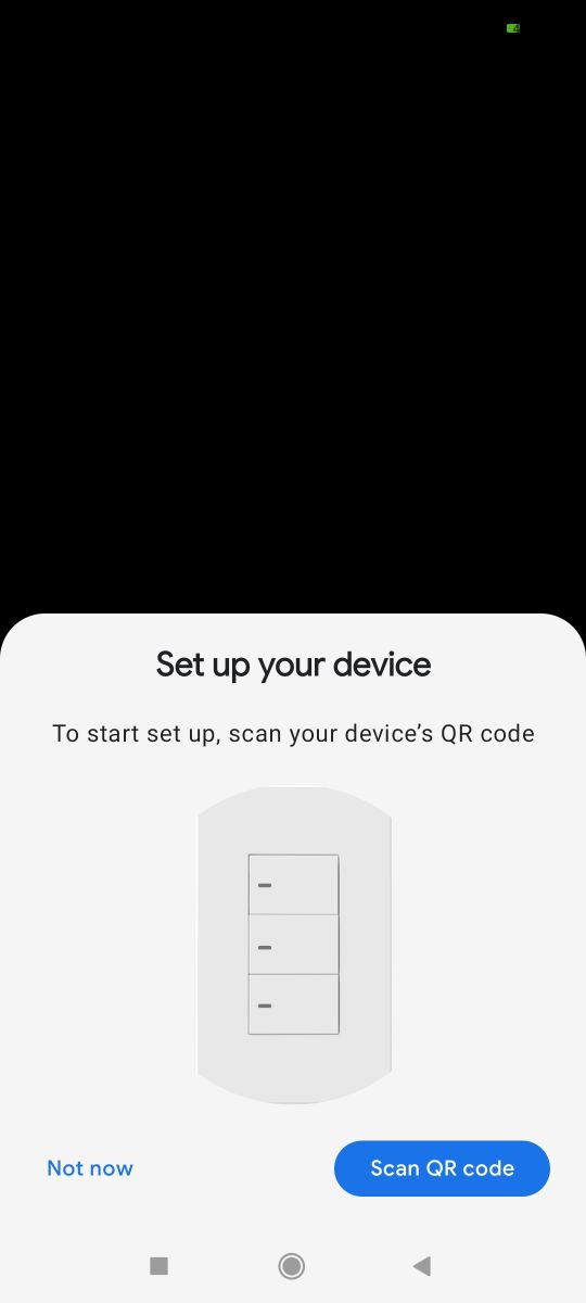

    Pairing:

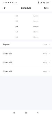

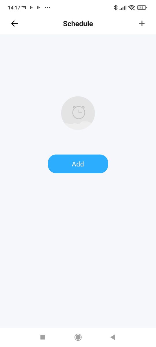

    Panel:
    Options:

    There is even backlight level control (via PWM).
    Boot log:
    ets Jul 29 2019 12:21:46
    rst:0x1 (POWERON_RESET),boot:0x17 (SPI_FAST_FLASH_BOOT)
    configsip: 153911750, SPIWP:0xee
    clk_drv:0x00,q_drv:0x00,d_drv:0x00,cs0_drv:0x00,hd_drv:0x00,wp_drv:0x00
    mode:2, clock div:1
    secure boot v2 enabled
    load:0x3fff00b8 len:0x38b8
    load:0x40078000 len:0x5ffc
    load:0x40080400 len:0xed0
    entry 0x40080694
    I (52) boot: ESP-IDF v4.4.3-dirty 2nd stage bootloader
    I (52) boot: compile time 10:22:51
    I (52) boot: chip revision: 3
    I (55) boot.esp32: SPI Speed      : 80MHz
    I (60) boot.esp32: SPI Mode       : DIO
    I (64) boot.esp32: SPI Flash Size : 4MB
    I (69) boot: Enabling RNG early entropy source...
    I (74) boot: Partition Table:
    I (78) boot: ## Label            Usage          Type ST Offset   Length
    I (85) boot:  0 esp_secure_cert  unknown          3f 06 0000f000 00002000
    I (93) boot:  1 nvs_matter       WiFi data        01 02 00011000 00006000
    I (100) boot:  2 nvs_matter_bkp   WiFi data        01 02 00017000 00006000
    I (108) boot:  3 nvs              WiFi data        01 02 0001d000 0000f000
    I (115) boot:  4 otadata          OTA data         01 00 0002c000 00002000
    I (123) boot:  5 phy_init         RF data          01 01 0002e000 00001000
    I (130) boot:  6 ota_0            OTA app          00 10 00030000 001e0000
    I (138) boot:  7 ota_1            OTA app          00 11 00210000 001e0000
    I (145) boot:  8 fctry            WiFi data        01 02 003f0000 00006000
    I (153) boot: End of partition table
    I (157) esp_image: segment 0: paddr=00030020 vaddr=3f400020 size=21648h (136776) map
    I (209) esp_image: segment 1: paddr=00051670 vaddr=3ffbdb60 size=05a1ch ( 23068) load
    I (217) esp_image: segment 2: paddr=00057094 vaddr=40080000 size=08f84h ( 36740) load
    I (230) esp_image: segment 3: paddr=00060020 vaddr=400d0020 size=1170d4h (1142996) map
    I (590) esp_image: segment 4: paddr=001770fc vaddr=40088f84 size=15660h ( 87648) load
    I (622) esp_image: segment 5: paddr=0018c764 vaddr=50000000 size=00010h (    16) load
    I (622) esp_image: segment 6: paddr=0018c77c vaddr=00000000 size=03854h ( 14420)
    I (632) esp_image: Verifying image signature...
    I (633) secure_boot_v2: Verifying with RSA-PSS...
    I (642) secure_boot_v2: Signature verified successfully!
    I (659) boot: Loaded app from partition at offset 0x30000
    I (659) secure_boot_v2: enabling secure boot v2...
    I (659) secure_boot_v2: secure boot v2 is already enabled, continuing..
    I (666) boot: Checking flash encryption...
    I (671) flash_encrypt: flash encryption is enabled (0 plaintext flashes left)
    I (679) boot: Disabling RNG early entropy source...
    śţě˙śţ„üŻ„ücommission_status = 1, flag = 0 matter_ble_complete = 1
    mode:2, clock div:1
    entry 0x40080694
    śţśţśţŻ„üŻcommission_status = 1, flag = 0 matter_ble_complete = 1

    I repeat the question,
    having a Matter-supporting adapter e.g. SLZB-06 with modified software, will such devices work locally on the original software without the need for the internet and the manufacturer's cloud?
    Home Assistant has an integration that supports this standard https://www.home-assistant.io/integrations/matter/
