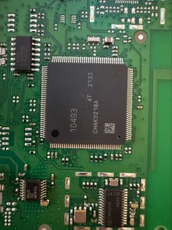

    Hello everyone,
    I have a problem with the adml module for c4 2022. The old adml module had a problem and now I need a new one, the new one cannot be delivered from the factory for 8 long months. I took a used one, but I don't have the option to change the vin number with the original program. Is there any way to make the change? OE 1685540880

    Hello on is the module? processor? memory? Once it's read, it's probably possible to change the VIN in the .bin file.

    The image shows a close-up of a printed circuit board with visible integrated circuits and electronic components.
    Close-up of a green circuit board with various electronic components. Image of a printed circuit board with a Valeo chip and several capacitors.
    does this help?
  • #4 21197058
    ProboY
    Hello everyone, just to let you know the solution to my problem. I moved the processor under the code 10493 and solved the chassis rewrite. Later programmed with the original to my own settings. Solved it works.

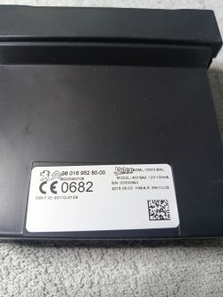

    Give me a photo of the sticker on the case if you can
  • #6 21197174
    ProboY
    Black electronic box with a white label showing markings and a QR code.
    Only in this way. I no longer have the box, it is installed in the vehicle

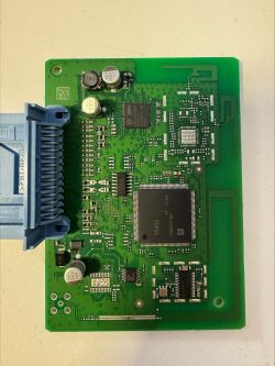

    Black electronic component with a label containing identification and technical information. .
    Added after 47 [seconds]:
    I have a new clean one but unfortunately this is version I
    Added after 1 [hours] 4 [minutes]:
