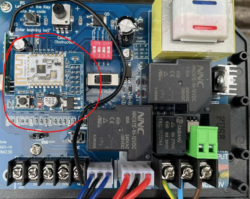

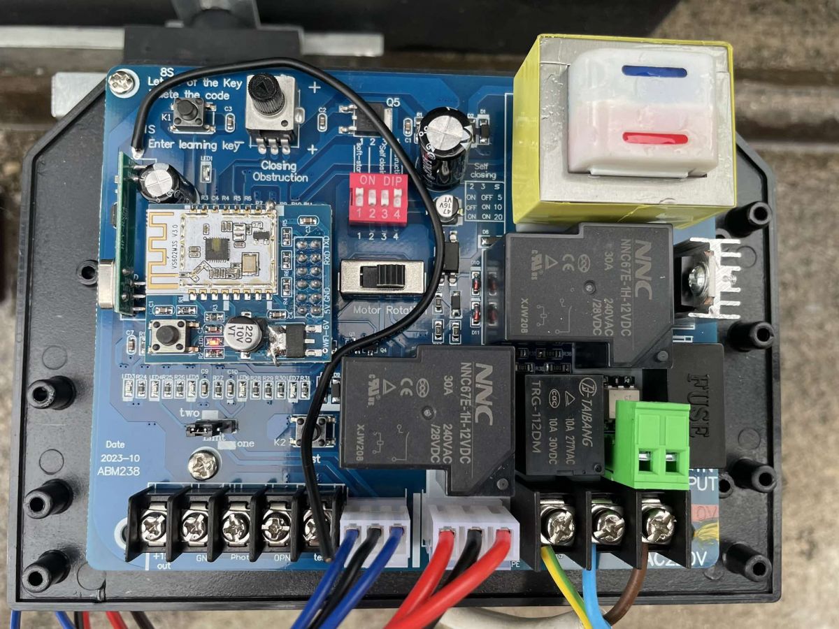

    Hello there,
    I have a sliding gate operator from a Chinese manufacturer, bought it very cheap. It actually works very well, I only have a problem that sometimes it will randomly open or close the gate.
    Here is the switchboard of the controller. Does anyone have any documentation on it, or do you know where I can find it?
    Control unit of the sliding gate motor by a Chinese manufacturer.

    Does this fault not occur as a result of interference coming through the power supply?
    Before starting repairs, I would suggest trying to connect the power supply to a different phase or getting an idea of the possibility of other devices switching on when these openings and closings or similar events occur.

    You need to look for inputs that can control opening / closing. You can see that the wired control contacts are not connected to anything so either radio or - you can see the ESP module on the control panel:
    Close-up of an ESP module on a central board with unused wired control contacts. .
    Have you configured the module for your own Wi-Fi network ? Maybe there are some auto-close opening scenes stored on it.

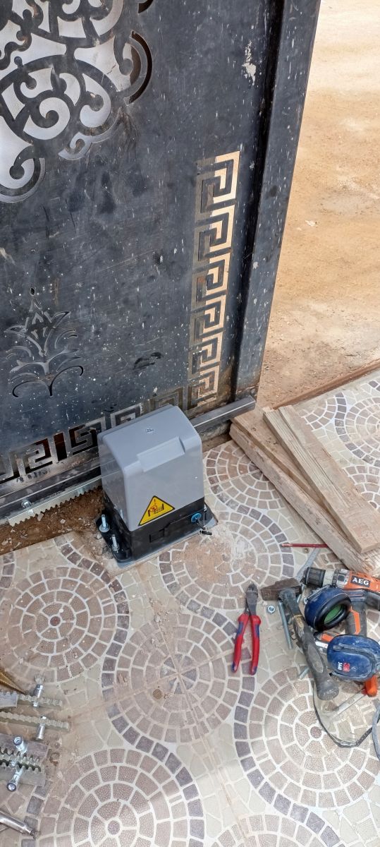

    #4 21165093
    labiadhchokri

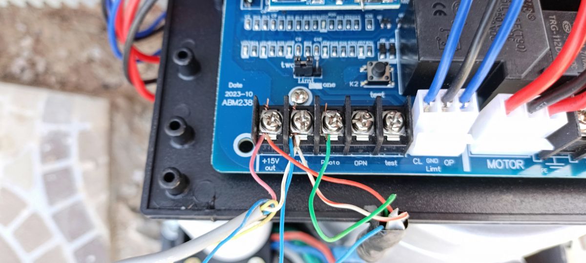

    Hi I just installed one yesterday I will send you some photos of the Manuel, try to unplug the wifi module maybe its fau A sheet with instructions in French, placed on tiles with part of a metal element visible. Instruction manual of an electronic module on a table with tools and accessories. User manual for an electronic module with a circuit diagram. Close-up of an electronic circuit board with connected wires. A photo of a sheet of paper with instructions and images of electronic components on a tiled floor. Installation instructions for an electronic circuit on tiles. Image of a user manual with an electrical schematic and circuit diagram, lying on a blue-and-white tiled surface. Sheet with technical instructions on a tiled surface with a metal element next to it. Instruction sheet on a tiled table. Installation guide with instructions and photos of electronic components. Photo of module installation instructions with several device images, laying on a tiled background. Automatic gate mechanism with tools on the floor. lty.

    It's more likely that the wi-fi module will introduce some confusion. If it can be unplugged then unplug it first and check.

    >>21161904 I have the same problem. Did you manage to solve it? Two systems with the same problem. Manufacturing date of board 2024-01. The gates are random opening only when the remote controls are paired!! Without the remote controls paired, with all other devices connected - IR sensor, light and wi-fi module - gate is operating normally. No random opening. The single problem is that I have to use the phone to open and close the gate.
