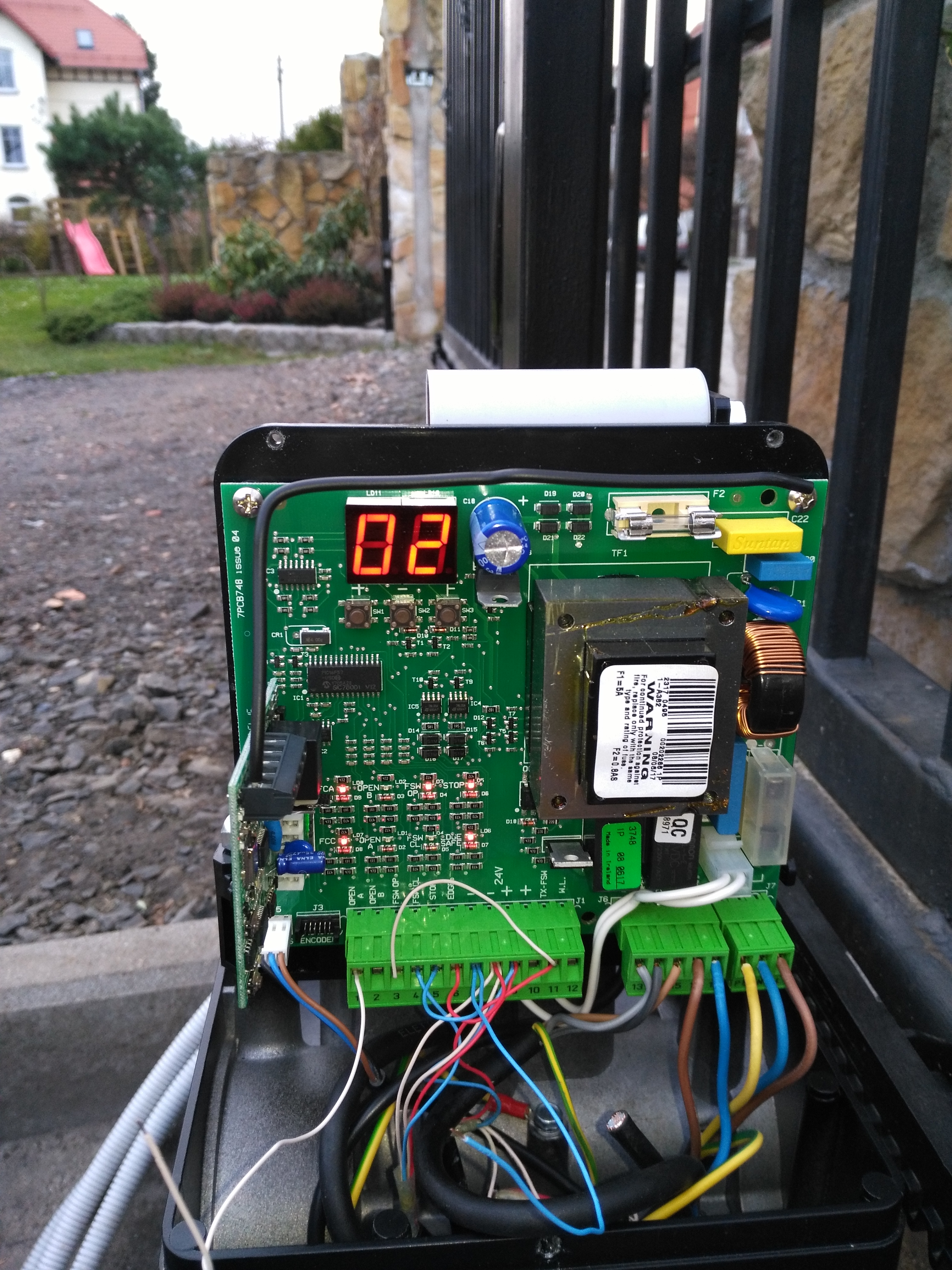

    At the beginning, I am not a specialist. Yesterday I completed the installation of the sliding gate with the faac 740 actuator. I connected the photo on the closing and bridged 5 out of 7 on the control panel. Unfortunately, the gate only opens. The pilot also programmed somehow strangely. The fsw cl diode is not on at all. I already read so much on the forum that my head hurts but I do not know how to solve this problem. I have a photo of xp20d and magnetic terminals. I also had an additional button in the garage connected to the open button and I disconnected the stop on the control panel for now, I thought that there was a problem here, but it's not that. Can anyone help.

    You probably have a problem with the photocells. They detect an obstacle and therefore cannot close. Either you have NO turned on instead of NC, or the photos do not see each other (incorrectly aimed), or the sending photo has no power. As for the pilot, try without him for now. Short-circuit terminal 1 with 7 (open A), i.e. take out two cables and make a short circuit. Hope you bridged between 6 and 8 too.
    You can also always bypass the photocells by shorting 3 and 4 out of 11. Then the gate must close when you give the command.

    1st bridge between 6 and 8 is
    2. What is it: Well, Nc
    3. I did as you said, I closed 1 of 7 and the gate opened like a remote control, but after another short circuit, no reaction, only the open A LED flashed, the gate did not move, the same effect as after clicking the remote control. I don't know what's going on, in the dark I already messed up something with cables that it didn't even open for me, but it can be recreated I think
    I have not taken 4 photos anymore. Too dark

    For you, FSW CL is off, which means that the protection has worked. You are to have a normally closed contact connected, as shown in the diagram. In addition, it's worth checking if the photos can be seen. After the optical barrier is broken, we need to hear the relay in the receiving photo.
    My wife passed the transmitter and something snapped. I checked the pics for the cables, cut them and then nothing. I got pissed off with the cables from the photos and I did according to fig. 5. And the gate works, although I won't say no, I have photos to hang on the posts, so that I will annoy this topic.
    Question from another fairy tale, I read on the forums that in order to have, for example, a switch to open in the garage, it is enough to have a simple bell and some write to connect open 1 with stop, others write open 1 with -. For me neither one nor the other works? I also set the E logic, but something with slowdowns is wrong.
    How, how can I check myself without taking photos, are they functional?
    Here I would only add that they can be damaged, badly connected, damaged cable etc ...
    It results from the photo, where you can see that fsw cl is off (and it should make the automatic start the closing cycle), and in the "light" of the photocells between the posts there is no obstacle.

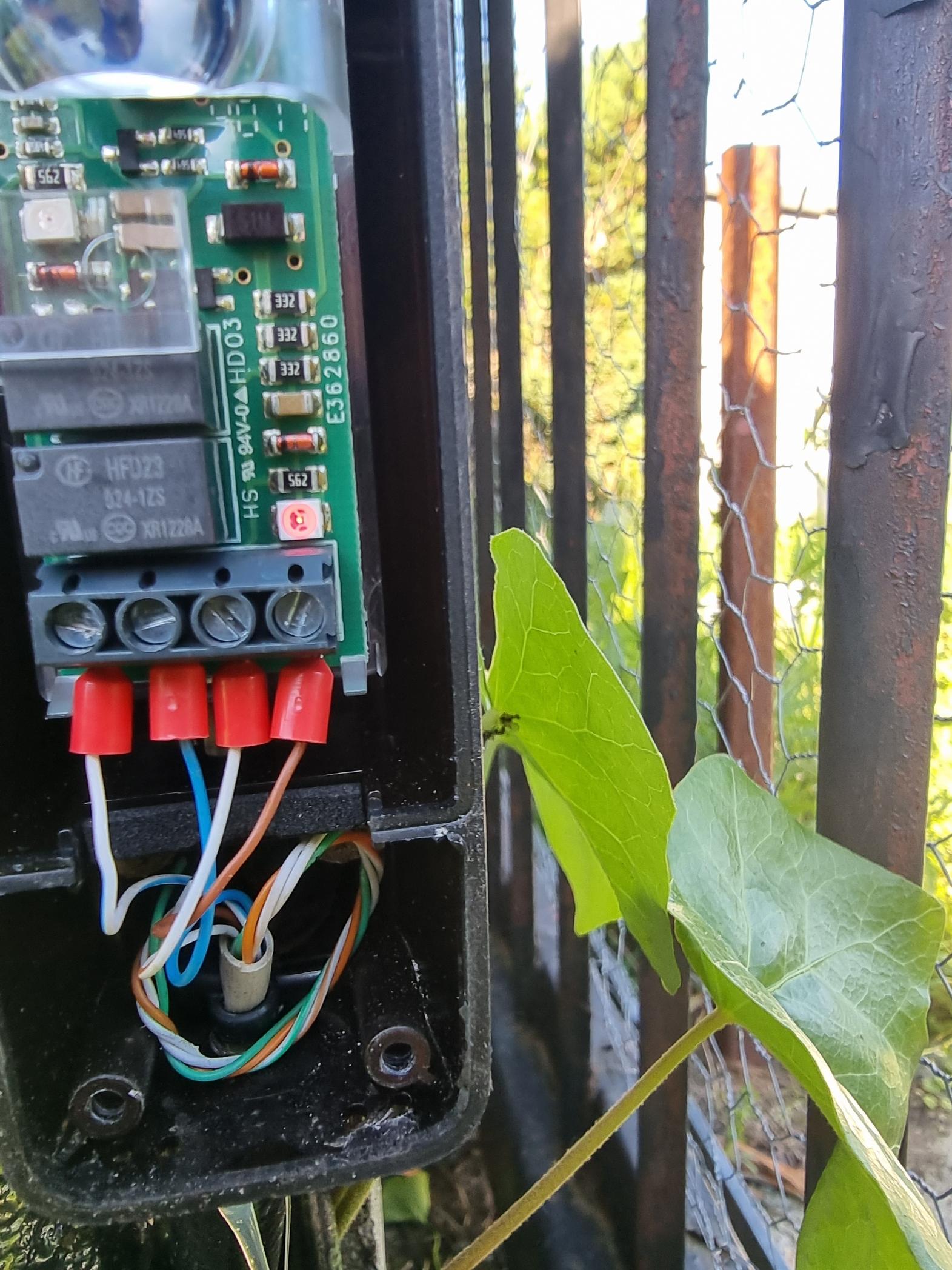

    I have a similar problem, the gate worked with photocells, suddenly it can only be opened and not closed. Off FSW CL transmitting photocells on receiving photocells are on, two LEDs are on when there is a break, the beam one goes out and you hear the contactor, but nothing changes on the control unit.
    Where exactly are NC and NO in the photocell? or on the switchboard.

    @ gabi126 in this topic Link you have a sample photo of a photocell.
    If the FSW CL is off, there is an open circuit somewhere or the relay in the photocell is not working properly.
    For the test, connect the terminal No. 4 to the terminal No. 7 or 8. The FSW CL LED should light up.
    The second test can be performed at the photocell, short-circuiting the wires going to the COM and NC or NO terminals, depending on how the given photocell performs this function.
    If the FSW CL LED is on, there is no interruption in the installation and the photocell is damaged.

    Thanks for the info. As soon as I get home, I'll do some tests. only my photocell has 4 connections
    • Faac 740 Sliding Gate Actuator Issue: Gate Only Opens, Wiring and FSW CL Diode Problems 20220605_185054.jpg (375.45 KB) You must be logged in to download this attachment.
  • #19 20050374
    gabi126
    4 out of 7 lit up
    Added after 1 [hour] 2 [minutes]:
    The cable for 2 photos to 4 in the switchboard was bad. Works Thanks for your help
