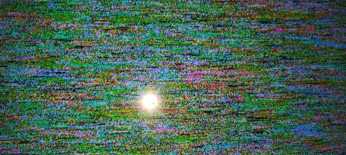

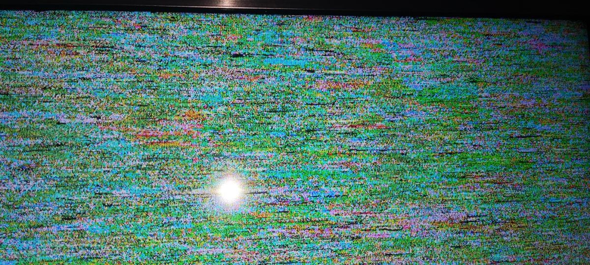

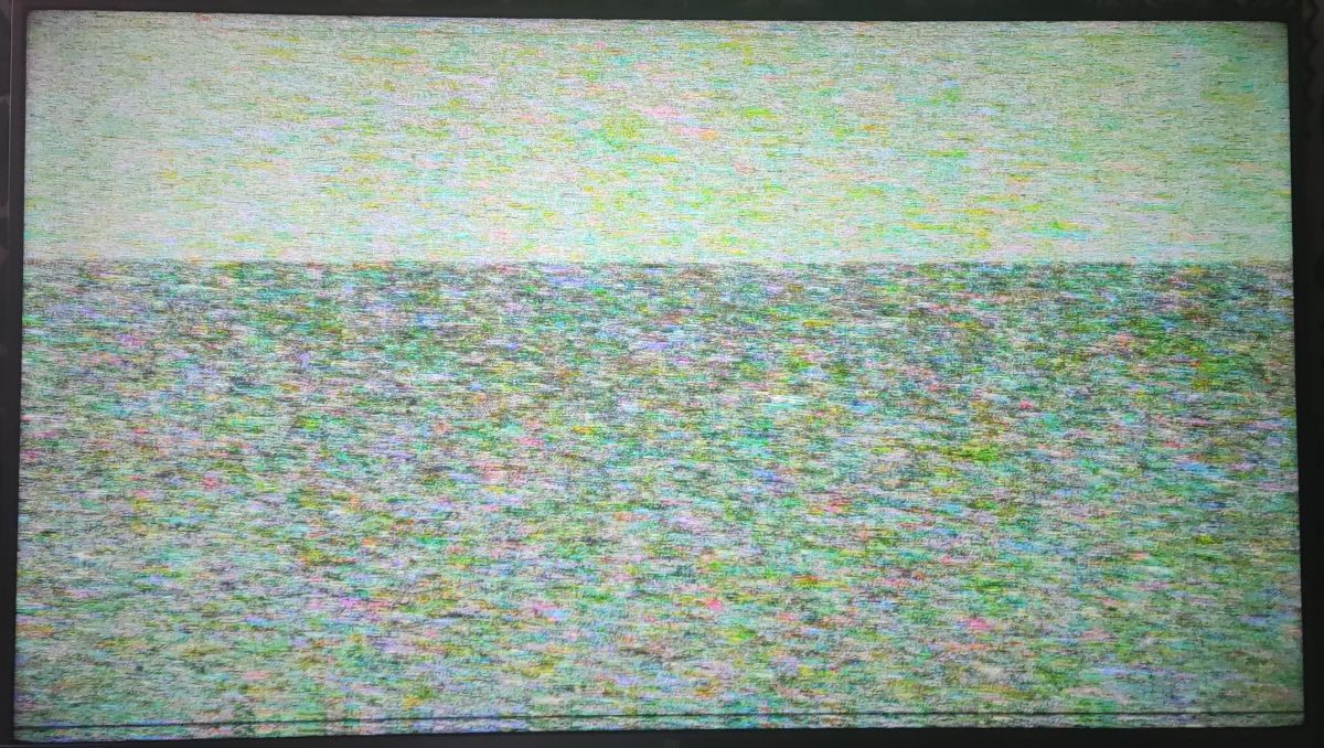

    This TV turns on, but instead of an image, colored dots appear, as you can see in the photos. Does anyone have any idea what it could be?

    It looks as if it has been switched to analogue reception with no signal.

    Does it display graphics? Menus, volume, etc.?

    Unfortunately it is a more serious problem.
    It doesn't display any graphics, the TV responds to the remote control, but I haven't even been able to select one of the HDMI sources to test the sound.
