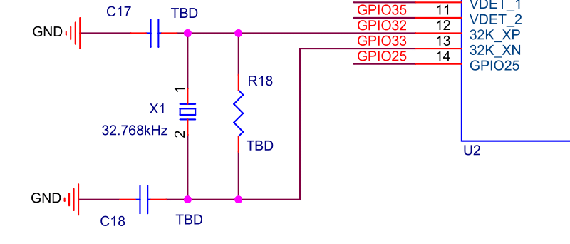

    Hi. Have any of you guys used the RTC on ESP chips? I've recently played around a bit with writing code in micropython for this chip and from my observations it appears that it is very inaccurate the clock can speed up by tens of seconds in 10 minutes of operation. If you have any experience with RTC on these chips then please let me know your findings. I also take into account that I wrote something wrong in the code.

  • ESP RTC needs external 32.768 kHz crystal

    >>21201054 RTC its internal ESP. I have no way of connecting the 32.768kHz quartz to those pins on the board. Unless I am mistaken.

    As it is in the documentation I will not be able to connect the quartz because I have such a circuit https://i0.wp.com/randomnerdtutorials.com/wp-...o-pin.png?quality=100&strip=all&ssl=1
    Unless there is something I don't know about.
    How accurate are the DS3231 chips? When I was playing around a bit with the DS1307 I can't remember exactly anymore but I think it wasn't very accurate.
    I pulled the DS1307 chip the one I used to try to do something with on an atmega8. Either I am doing something wrong or this chip is mega not accurate. After 5 minutes of operation it sped up by 8 seconds :) . Poor.

    I have also come across this problem, in a device that sleeps 24 hours, does a short activity, and sleeps 24 hours again. In addition, it has no internet access, and cannot download time.
    In my case, during light sleep, there was an acceleration of about 11 minutes per day. Not wanting to bury a soldering iron in a ready-made development board, I simply made a software adjustment to the sleep time. This is a stopgap admittedly, as a different module may have a different spread of RTC oscillator parameters, but it reduced the inaccuracy to 1 minute per day - not a bad result.

    A colleague has an ESP8266 and this does not have a hardware RTC.
