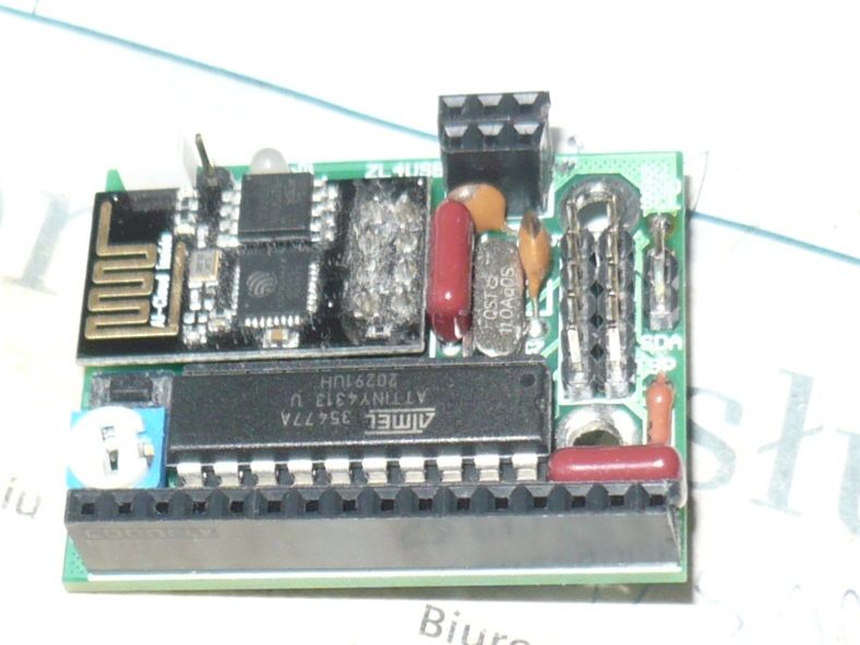

    Hello everyone.

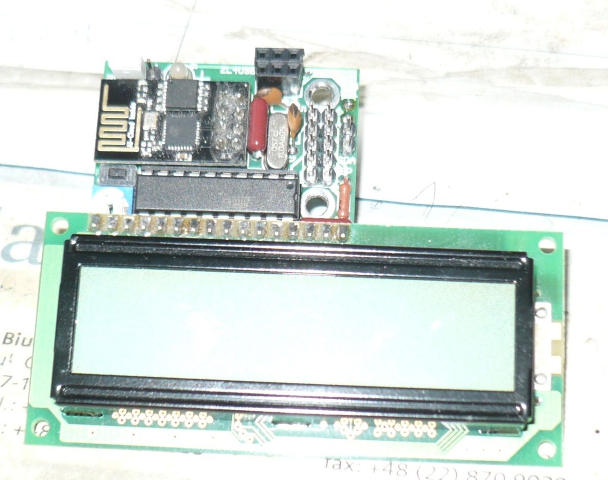

    This time I would like to present the I2C clock synchronizer with time downloaded from the Internet. Using the previously presented clock on the Z8, I thought it would be worth extending it with this possibility, hence the presented circuit was created.
    The system itself is based on the ESP8266-01 module, which obtains the time from the NTP server after logging into the WiFi network. The module cooperates with the ATtiny4313 microcontroller, whose task is generally to be seen as an I2C slave with address 0x0A by the clock cooperating with this system, which is an I2C master. In addition to serving as an I2C slave device, the microcontroller also operates the ESP8266 module via UART and supports an optional LCD display as a monitor of data exchanged via I2C with the master. You may ask why I didn't implement the I2C slave function in the ESP itself? Well, I didn't succeed. Multiple attempts (also using external interrupts to which ESP can respond) did not bring the expected effect. Here: https://github.com/esp8266/Arduino/issues/5762
    there is even a discussion about it. So, in order to continue with this project, I decided to use an additional microcontroller. The microcontroller periodically sends data received from the I2C master to the WiFi module to log in to the WiFi network. Cyclic, because after turning on the power, the I2C master sends the SSID and password (both ending with CR and LF) needed to log in to the described synchronizer system once, and at that moment the WiFi network may not be available. After the ESP8266 module successfully establishes a connection to WiFi, the module periodically sends the received RSSI, time and date data to the microcontroller in the form of an 8-element int16 array. The ATtiny4313 microcontroller receives this data from the module, makes sure that the data is in the right order, and then transfers the ordered data to a buffer intended for reading by the I2C master. The optional display presents the SSID on the first line and the password received from the I2C master on the second line, and after establishing an Internet connection, displays the contents of the buffer for reading by the I2C master.
    The representation of data placed in the correct order in the buffer and ready to be read by the I2C master is as follows:
    I2C clock synchronizer circuit with LCD display and other components.

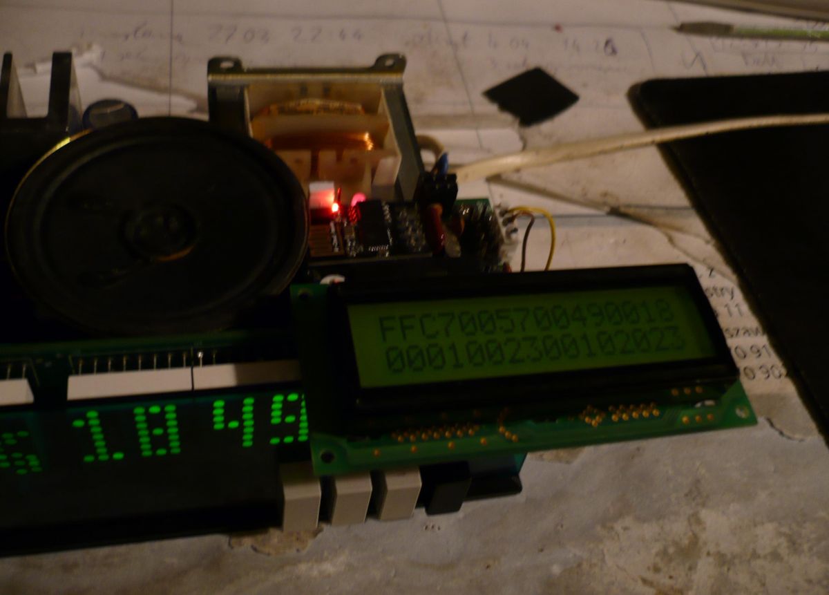

    Where:
    first element of this buffer: RSSI; a value less than 0 (0xFFC7 from LCD) means establishing an Internet connection; the lack of this connection is signaled by the value 0x001F
    second element of this buffer: seconds in BCD (0057 from LCD)
    third element of this buffer: minutes in BCD (0049 from LCD)
    fourth element of this buffer: hours in BCD (0018 from LCD)
    the fifth element of this buffer: day of the week; 1 - Monday, ..., 7 - Sunday (0001 from LCD)
    sixth element of this buffer: day of the month in BCD (0023 from LCD)
    seventh element of this buffer: month in BCD (0010 from LCD)
    eighth element of this buffer: year in BCD (2023 from LCD).
    The video on YT shows the synchronization of the clock, deliberately set to January 1, 2001, with the time downloaded from the Internet by the described module.
    Now a little about the preparations for this project. When I was thinking about this project, I first came across the website: https://randomnerdtutorials.com/esp8266-nodemcu-date-time-ntp-client-server-arduino/
    This is almost the finished product on which I based my sketch in the Arduino environment. Even this worked, but the inconvenience was the lack of automatic change of summer/winter time (despite the presence of the tm_isdst component in the tm structure, however, the value of this component did not change when switching from winter to summer time in spring). Moreover, the author asked us to add/subtract the number of hours expressed in seconds to the UTC time received by the module programmed with this example sketch, depending on the expected time zone. While looking for how to solve the above problems, I finally found the website: https://werner.rothschopf.net/202011_arduino_esp8266_ntp_en.htm
    and after matching this sketch to our time zone using #define MY_TZ, the program began to correctly display the time in Poland on the terminal. After that, it remained only to adapt the sketch to the needs of cooperation with the described system.
    A few more words about preparing the ESP8266 module itself to work with this system. Apart from adjusting the voltage levels on UART (module powered by 3.3V, ATTiny powered by 5V), which I implemented as described at http://mirekk36.blogspot.com/2015/05/konwerter-levelow-33v-ttl.html, the module itself must be programmed with the NTP_time_date.ino sketch. To do this you need:

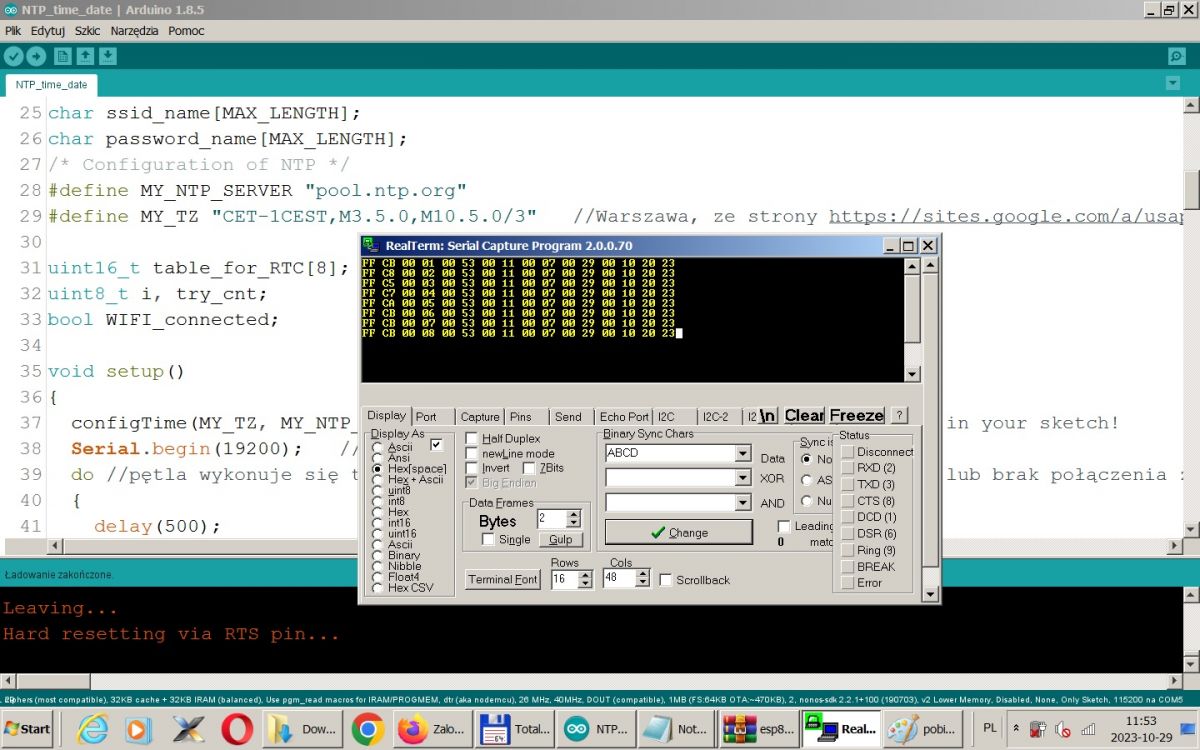

    7. In the Arduino 1.8.5 environment (this is what I use), compile and upload the NTP_time_date.ino sketch to the module
    8. After uploading the sketch, disconnect and connect the power supply to the module again
    9. Open e.g. RealTerm and connect to the module, connection parameters 19200.8N1.
    10. Send the module the SSID name and password (both strings ending with CR LF, max. 14 characters in the string) for the WiFi network to which we want to connect. The characters of the sent SSID and password should be displayed in the appropriate lines on the connected LCD.
    11. After successful connection, the module should periodically send data to RealTerm, as in the screenshot. This data will also be presented on the connected LCD.
    Screenshot of Arduino IDE with NTP sketch code and RealTerm window displaying data.

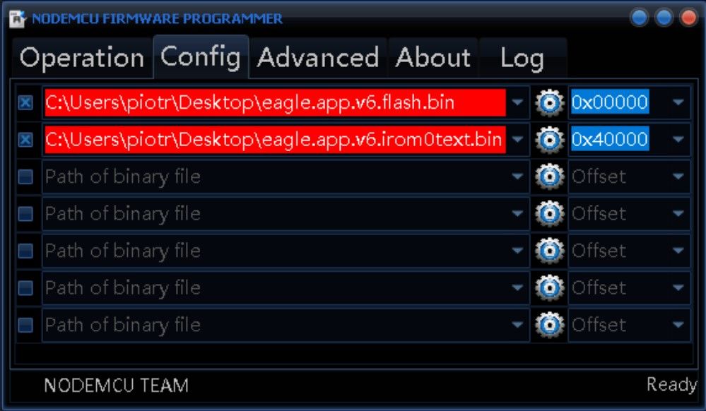

    If you are unable to complete the above points 7...11 (the firmware in the module may be inappropriate), you should update the firmware (which works for it). For this purpose:
    1. Download the firmware with flasher from https://www.elektroda.pl/rtvforum/topic3844441.html.
    2. Follow steps 1...6 above to enter firmware update mode.
    3. Run the ESP8266Flasher.exe file
    4. In this program, in the Config tab, indicate the files eagle.app.v6.flash.bin and eagle.app.v6.irom0text.bin as in the screenshot:
    NodeMCU Firmware Programmer interface with two binary files to load.
    5. Then, in the Operation tab of this program, select the appropriate COM Port and press the Flash button.
    6. After successfully uploading the firmware, try again to upload the NTP_time_date.ino sketch according to the above points 1...11

    To sum up: the clock with this synchronizer works well, at least I have a reference time according to which I can set other clocks in the house. I also had to equip the described system with:a 220uF capacitor connected to the 5V side (visible in one of the photos), because during startup it turned out that when the WiFi network was lost (e.g. when the router was turned off), the Z8681 clock microcontroller could hang. The reason was a drop in the 5V voltage supplying the clock. An example of the cooperation of the described system with the Z8681 clock is here:

    I2C time synchronizer module with ESP8266-01 and LCD

    I think it would be possible to get rid of the attina. ESP01 can support I2C.

    The title is a bit awkwardly written. This is not an I2C clock synchronizer because you do not synchronize the bus, but it is a clock synchronizer WITH an I2C INTERFACE :D
    At first I thought your clock based its time on the CLK line frequency..

    @tos18, I didn't manage to do it, as I already mentioned. If you could present a working sketch or at least a concept of how to do it, that would be great :) And it would definitely be used.

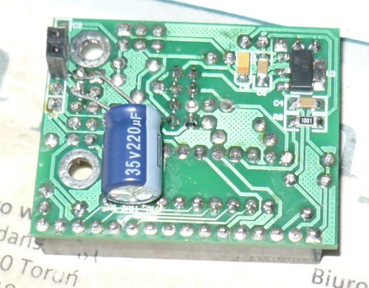

  • 220uF capacitor and BOD/WD prevent MCU hangs

    I had to equip the described system with a 220uF capacitor connected to the 5V side (visible in one of the photos), because during startup it turned out that when the WiFi network was lost (e.g. when the router was turned off), the clock microcontroller could hang. The reason was a drop in the 5V voltage supplying the clock.
    That's why you also have BOD and WD in the MCU. It's worth using.

    I know it's worth using, but Z8 doesn't have such inventions ;) These are not the times yet ;)

    I confirm problems with the operation of the I2C bus on the ESP 8266.
    I once tried to connect two ESP8266 via I2C.
    Only when setting Wire.setClock(20000); somehow it worked...

    You wrote that you use ATtiny4313, which has these inventions.... BOD is especially important, because when the voltage increases slowly, the MCU may enter some undefined state from which it cannot recover on its own.

    Generally, I believe that such gateway solutions are easier to implement using ESP32-C3, which has two I2C hardware controllers
    ABOUT! And that's great news. It is worth knowing about the existence of such a module. Then indeed, ATtiny would no longer be needed.

    Yes, in the presented synchronizer system. And it works perfectly.
    The synchronizer system works with a clock based on the Z8 microcontroller. And this Z8 had a problem with freezing.

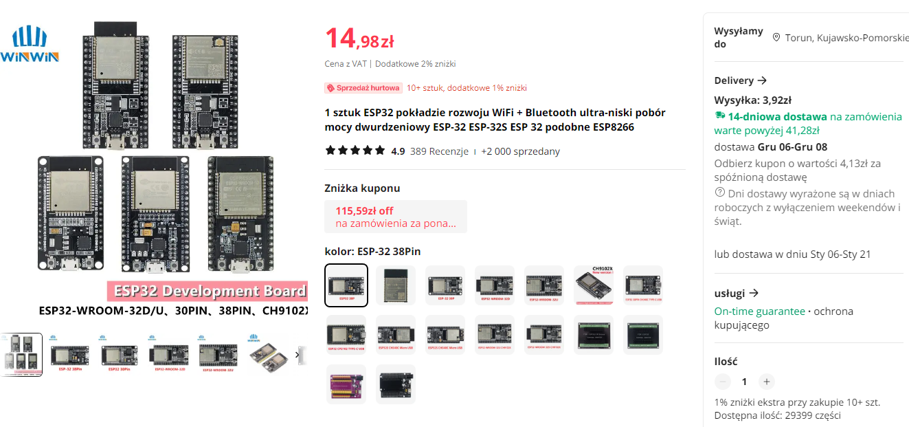

    jacek24642
    Posts: 41
    They are available on Ali, but delivery is expensive.
    PLN 4 for shipping, isn't that expensive?

    ESP32 development board with WiFi and Bluetooth, priced at 14.98 PLN.
    PLN 43 applies to purchases that will be shipped within 14 days. And this is the minimum purchase amount to deliver them within 14 days.

  • The working interface uses ESP8266-01 + ATtiny4313, with the AVR acting as an I2C slave at address 0x0A and also handling UART plus an optional LCD monitor. [#20821650]
  • The I2C read buffer has 8 elements of int16, carrying RSSI, BCD seconds, minutes, hours, weekday, BCD day, BCD month, and year; example values shown include 0xFFC7, 0x001F, and year 2023. [#20821650]
  • The ESP test link runs at 19200 8N1, and both SSID and password must end with CR LF; each string is limited to 14 characters max. [#20821650]
  • The author added a 220 uF capacitor on the 5 V rail because Wi‑Fi loss could cause a supply dip and freeze the Z8-based clock during startup or reconnect events. [#20821650]
  • One user reported ESP8266 I2C became usable only after lowering Wire.setClock to 20000, while another suggested ESP32-C3 as a cleaner replacement because it has two I2C hardware controllers. [#20822598]

What is the structure of the 8-element int16 buffer sent to the I2C master, and how are RSSI, time, date, and weekday encoded in it?
The buffer has 8 signed 16-bit elements in a fixed order. Element 1 is RSSI; a value below 0 such as 0xFFC7 means Internet connection, while 0x001F signals no connection. Elements 2–4 are seconds, minutes, and hours in BCD. Element 5 is weekday, where 1 = Monday and 7 = Sunday. Elements 6–7 are day and month in BCD, and element 8 is the year, shown as 2023 in the example. [#20821650]
How do I program an ESP8266-01 with the NTP_time_date.ino sketch and put it into firmware update mode using GPIO0 and JP1?
You enter programming mode by forcing GPIO0 low during power-up, then upload the sketch. 1. Remove power, short JP1 pins 2–1, connect the adapter, and hold GPIO0/Flash to ground. 2. Power the module, release GPIO0, and upload NTP_time_date.ino in Arduino 1.8.5. 3. Power-cycle the ESP8266-01 after upload. Those steps place the module in firmware update mode and then return it to normal boot after flashing. [#20821650]
What steps are needed to test the ESP8266-01 with RealTerm at 19200 8N1 and send the SSID and password with CR LF endings?
Use a serial terminal after flashing to confirm Wi‑Fi login and time output. 1. Open RealTerm and connect at 19200 8N1. 2. Send the SSID and password as two strings, each terminated with CR LF and limited to 14 characters. 3. Check that the LCD echoes both strings and that the module later sends periodic time data. If this fails, the thread says the ESP firmware may need updating before retrying the sketch upload. [#20821650]

What makes ESP32-C3 a better replacement than ESP8266 plus ATtiny4313 for an Internet time to I2C gateway, especially regarding hardware I2C controllers?
ESP32-C3 was presented as a cleaner replacement because it has two I2C hardware controllers. That matters because it can combine Internet access and robust I2C without the extra UART hop and second microcontroller. A reply also estimated the module cost at roughly a dozen or so złotys, making it attractive as a simpler gateway platform. In this thread, the strongest argument for ESP32-C3 is reduced complexity: fewer chips, fewer links, and less dependence on software-emulated I2C. [#20822709]
