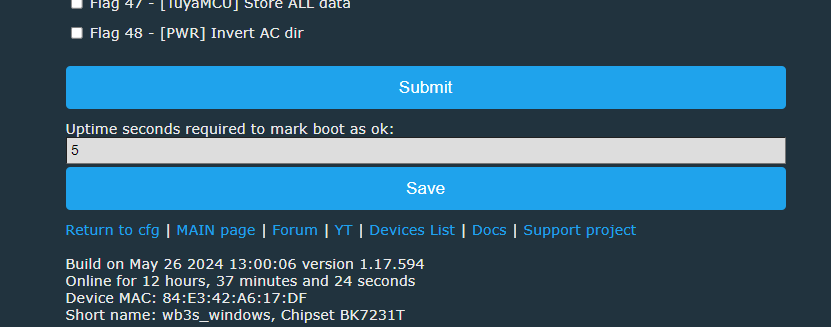

    On open becken - How do I turn off the default option to reset firmware defaults after so many failed boot events?
    An equivalent to SetOption65 = 0 on tasmota...
    Thanks!

    There is no "reset to default" in OBK in such manner, but OBK will open access point after 5 "failed" boots. A boot is failed when it does not reach the required uptime in seconds, which is 5 by default in configure generic/flags tab:
    Screenshot of the device configuration interface with boot settings and save options.
    I guess you could set it to a lower number, like 1 or maybe even 0, to just disable this mechanism, but that would also have a drawback - if you break your device with invalid config, it will be hard to recover it. UART may be required.

    I can try with zero and see if that works.
    There were a lot of summer storms here this year with power flickering multiple times for a fraction of a second. This is not good news if I can't recover the device without physically being there.
