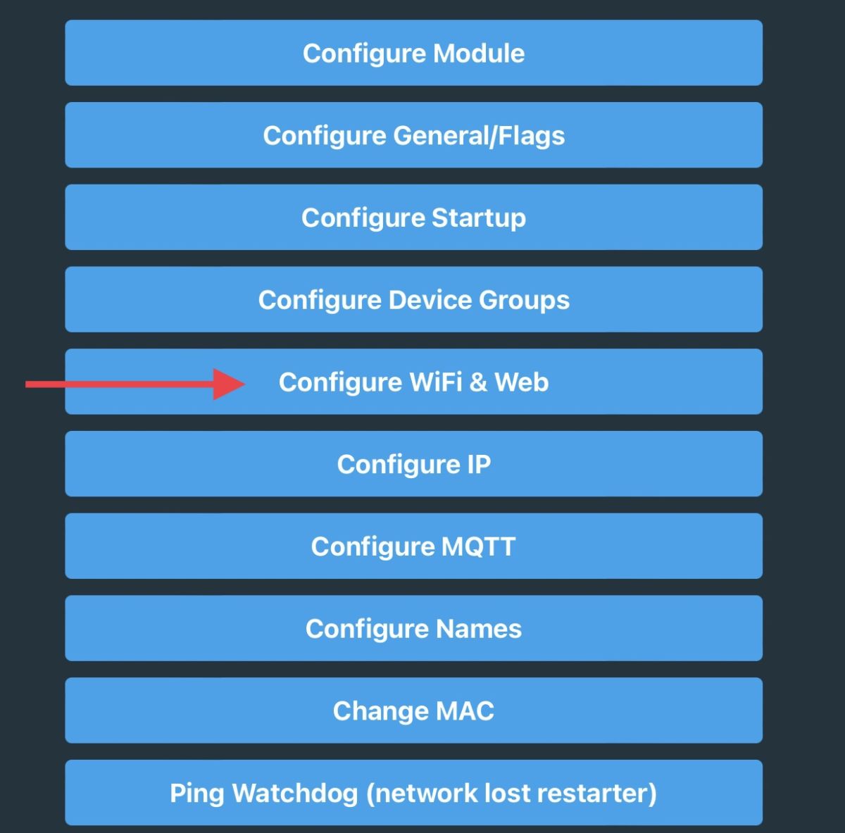

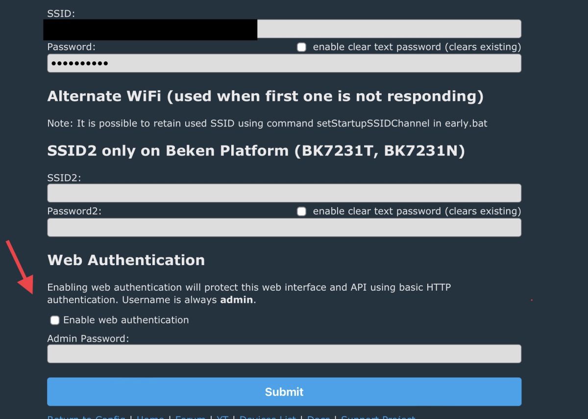

  • #14 21598012
    max4elektroda
    Posts: 758
    Help: 49
    Rate: 189
    It's on the WiFi config page in the button.
