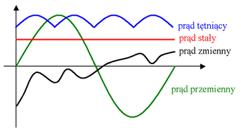

    Hmm....
    Is it alternating current or alternating current? An alternating current is one that changes its intensity as a function of time, and everyone describes a solution to "straighten" an alternating current.
    Since these concepts are often confused, could you describe exactly what it means, my friend?
    Maybe the solutions are good and the question is confusing :)
    Regards :P
    PS: maybe I`m just nitpicking? ;p

    Well, in principle, yes, but in colloquial speech the term "alternating current" is used and the term "alternating current" is thought of. I use this term (colloquially) and define "variable" as one-way (like a street). A constant is, of course, also unidirectional, but without a variable component or this component has a very small amplitude. Similarly, the term "heaven" is used to refer to clouds or a cloud-free space above our heads in an open space, and "heaven" in the sense of "paradise" where good Catholics will go (well, not after death, but...) after the "Last Judgment" " :D . There are many terms that are used more or less incorrectly and additional terms are needed to avoid mistakes.

    Heheh, yes, I know that`s what they say colloquially :) I use this phrase myself. However, I think that with such basic questions as about the rectifier bridge, the questioner can be misled. :)
    My friend kamilek, as my "previous speakers" wrote, 4 rectifier diodes and a capacitor (if, of course, it is about "rectifying an alternating current (such as the one in the 230V network)) :D

    Your alternating current is alternating :P . You wrote well, but you drew badly. For it to be truly variable, it should flow in one direction all the time, changing only the voltage/current if you prefer.

    I disagree with the statement above. The fact that the current is alternating does not mean that it must flow in one direction. Alternating current is also an alternating current (periodic), and it has both positive and negative values.
