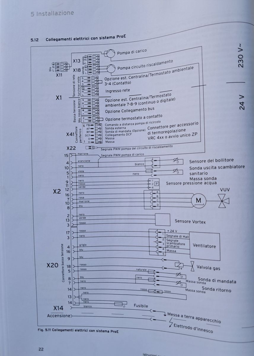

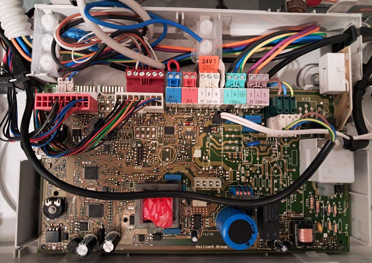

    The Central Heating system (CH) is managed by relé using the RT 230 V - AC connector (violet and orange conductors in the attached picture) and I would be great to do the same for DHW, setting a fixed value of the hot water by knob and managing the ON/OFF DHW production without the use of eBUS.

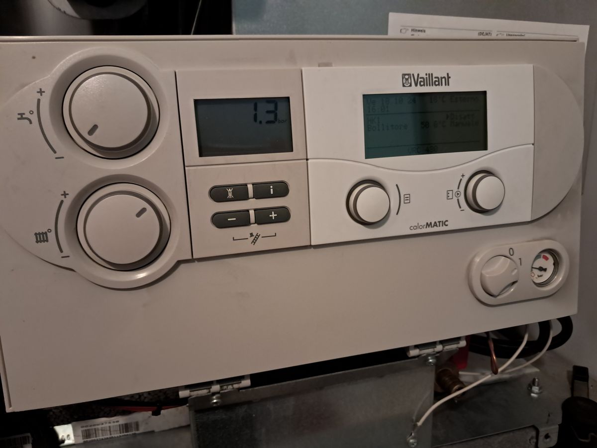

    Wiring diagram of the Vaillant ecoCOMPACT VSC IT 246/2-C 170 system. Image of the interior control panel of a Vaillant ecoCOMPACT combi boiler with visible wiring and connectors. Control panel of Vaillant ecoCOMPACT boiler with display and knobs.
    I have also attached some pictures for a more clear idea of the current configuration and reference wiring diagram.

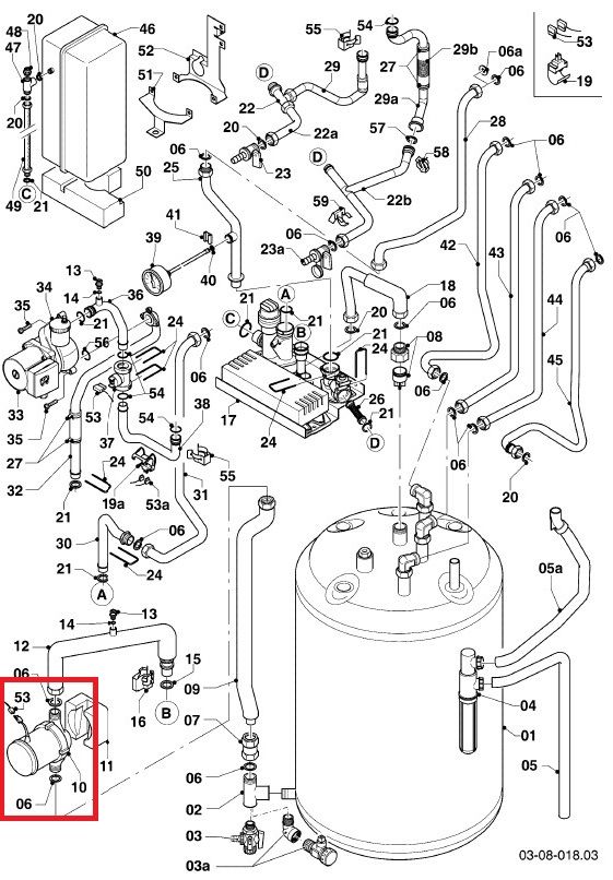

    Schematic of the installation with the charging pump highlighted. The disconnection of the DHW temperature sensor causes the error F.3 (sensor interruption) and no DHW is produced.
    Do you think that some action on the loading pump highlighted in the attached picture would be useful for the purpose?
    Thank you.
