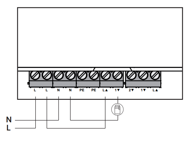

    According to the diagram in the HmIP-WHS2 manual:
    Connecting Vaillant VC 194/3-C to Homematic IP HmIP-WHS2 for Room Control .
    So here, as I see it, you need to connect the 230V supply from the outside to the L and N on the left, then you take the "section 1" (the first block of 2 sockets on the right from the PE ground):
    - L with the up arrow goes to the second L in the block quite on the left
    - 1 with the down arrow to input 4 on the cooker (Control)
    - output 5 on the furnace goes to the second N on the left
    - output 3 on the cooker remains vacant
    That is, when the HmIP-WHS2 gives the "Heat" signal, it closes the circuit and current flows from the outside, via L with arrow up, 1 with arrow down, to the furnace on port 4 and from the furnace port 5 to Neutral on the "outside" (roughly speaking, but you know what I mean, I know it's variable)

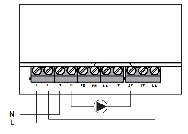

    Up to this point understandable, the doubts start however if I want to connect a pump to the second channel:
    We already have L2 and N2 draped (to the left of the Earthing) and would now need in "Section 2" quite to the right:
    - from L2 to L with an upward arrow
    - 2 with down arrow to L from Pump
    - N from pump to N2
    In this case, won't there be a conflict/short-circuit somewhere if, for example, only the Pump or only the Stove is switched on ?
    Generally, if the cooker is on and the heating is to go to underfloor heating, the pump must be on, but it does not have to be on if it is going to "normal" radiators (because then the internal pump from the cooker works), at the same time there is a possibility that only the floor pump will be on (because the cooker has finished heating, but we want the circuit to continue, or even in a situation where we want the cold water circuit to work).

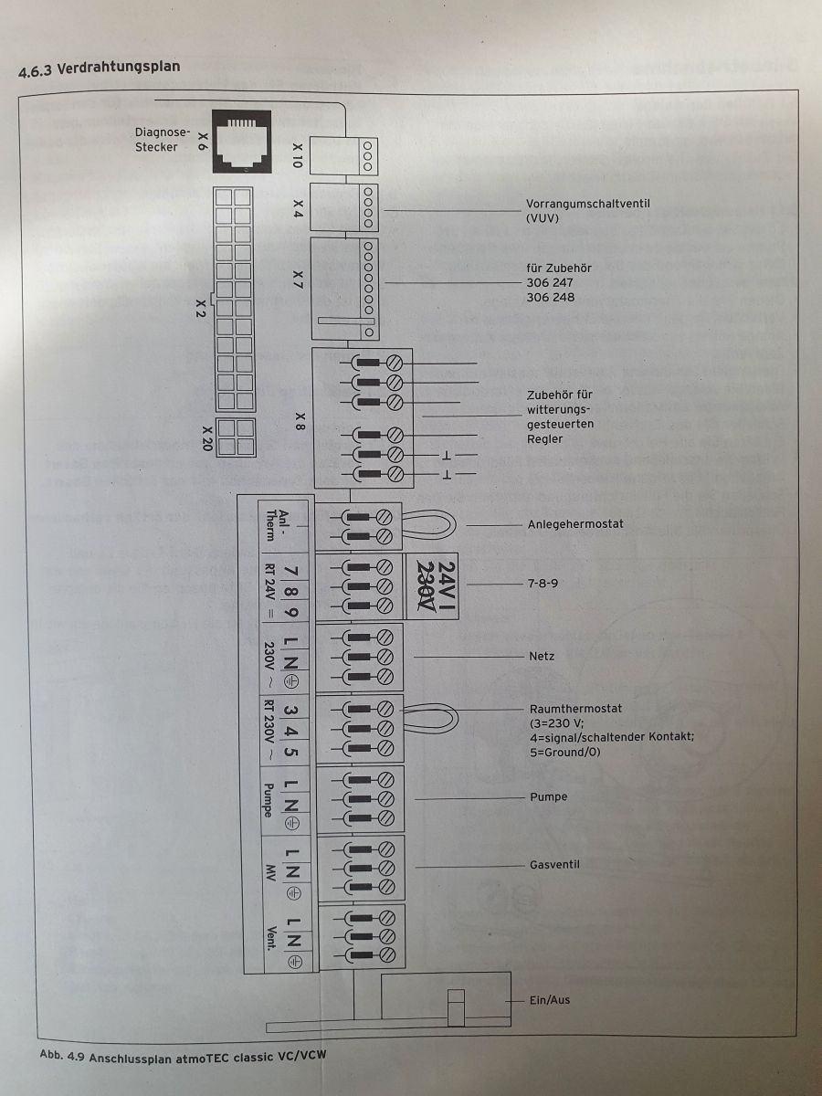

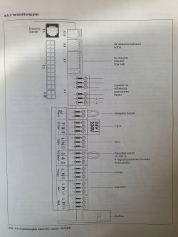

    Show this schematic because, according to me, neither pin 4 nor pin 3 have 230V.
    Sorry, I didn't specify, you mean the diagram of the gas cooker:
    Contact 3 is described as 230v, 4 as signal and both are bridged currently.
    I thought something else in general - WHS2 just has an interrupter there, so maybe just without so many connections:
    - L external to 1st L left
    - N external to 1st N left
    This would embrace the power supply to the WHS2 controller.
    Then Section 1 (1st block from contacts to the right of earth) simply as an interrupter between pins 3 and 4 from the boiler
    - L "Input" from furnace contact 3 (230V)
    - 1 "Output" to furnace contact no. 4 (Signal)
    Pump then normally according to the drawing.

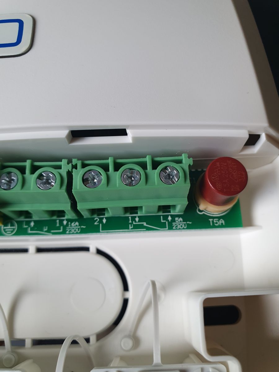

    Pin L of the second relay WHS2 (first from the right) should be connected to the L output of the circulating pump from the boiler (find it and connect there via a WAGO connector, for example). Connect the second pump to pin 1 and connect the second wire of this pump via a WAGO connector to the N wire of the output of the first circulating pump.
    But I have this pump from the underfloor completely on external power currently, I would prefer not to take power from the furnace if not needed.
    contact 1 in the right block is not by any chance NC ?
