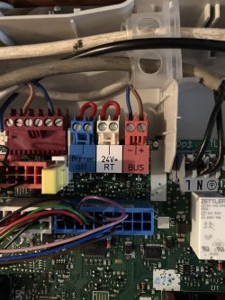

    I have installed a whole Danfoss Link thermostatic system in the house, the question concerns the Danfoss Link BR relay, which will start my furnace.
    If anyone has a diagram where I should connect it and turn it on in the furnace settings, I would be grateful.

    Connecting the relay itself is not a problem, the question is where to plug it in the Vaillant boiler and how to activate it in the boiler menu ...

    I mean the boiler, where to plug it in the boiler and in which boiler menu to activate it ;)

    In the boiler on the board there is an RT24 cube with a factory jumper. In place of this jumper, devices to block boiler operation are plugged in. Opening the jumper stops the operation of the central heating boiler. Short circuit return work on CO.
    Of course, this is a voltage-free contact, so you can't supply ~230V there

    Connecting Danfoss Link BR Relay to Vaillant ecoTec Plus Boiler: Diagram and Settings Needed
    We are talking about the white one, plug the relay in this place?

    Yes "24V=RT" - just do not enter ~230V here - this is a voltage-free contact :idea:
    The blue "Burner off" cube turns off the entire boiler: for central heating and hot water - used, for example, to connect the condensate pump - if something falls in it and it does not pump, it blocks the entire burner (for central heating and hot water).

    I connected it and everything works great, I had to disconnect the room control panel and the external temperature sensor.
    Thank you very much for your help.

• Connection point: white “24 V = RT” plug on ecoTEC PCB [Elektroda, Wojtasinskiw, post #17510512] • Factory jumper must be removed before thermostat wires are inserted [Elektroda, ls_77, post #17500798] • RT24 contact is volt-free; inserting 230 V will destroy the board in <1 s [Elektroda, ls_77, post #17510888] • Typical under-floor heating curve: k = 0.3 – 0.6 [Elektroda, ls_77, post #17528235] • Reported usage: 165 m² house consumes 11-12 m³ gas/day at −4 °C after Link optimisation [Elektroda, Joseph_85, post #17681687]
Where exactly do I connect the Danfoss Link BR relay in a Vaillant ecoTEC Plus?
Remove the factory jumper and push the two thermostat wires into the white “24 V = RT” two-pin block on the main PCB; this replaces the RT24 jumper [Elektroda, Wojtasinskiw, post #17510512]
Is the RT24 contact live?
No. It is a dry (volt-free) contact that must never see mains; maximum safe sensing voltage is 24 V DC at ≈5 mA [Elektroda, ls_77, post #17510888]
Do I need to change boiler menu settings after wiring?
For most ecoTEC models nothing must be activated; an open RT24 means ‘heat’, closed means ‘stop’. Keep weather regulator influence set to “none” if an external controller handles room temps [Elektroda, ls_77, post #17528235]
