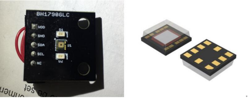

    Some time ago, I acquired a very interesting sensor, the BH1790GLC (Link) heart rate sensor. This sensor is manufactured by ROHM, a Japanese company.
    BH1790GLC heart rate sensor module by ROHM with visible connections and integrated circuit
    As a hardware dev designer, the first thing I do when I get this module is to go to the official website and download its datasheet. Looking at the datasheet helps me figure out what this sensor is like.

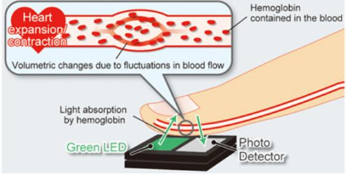

    Illustration of the BH1790GLC heart rate sensor operation with a finger illuminated by green LED light.
    When a pulse signal is sent out, it makes the volume of the blood vessels change, like what's shown in the picture above. The sensor picks up the pulse by catching these changes in the blood vessels.

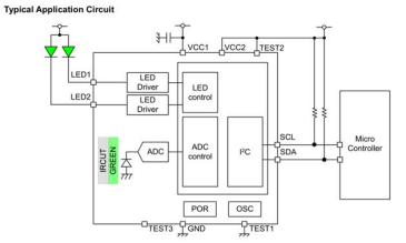

    The full sensor block diagram is like this:
    Circuit diagram for BH1790GLC heart rate sensor
    The sensor requires the connection of two green LED beads. Ordinary LEDs won't suffice; the module uses the SML-M13MT (Link) model. The special thing about this LED compared to normal ones is that it can get an even spread of light intensity in a certain range by using reflection.
    For high - quality LED components like the SML-M13MT and a wide range of electronic parts, check out Unikeyic (Link) component platform, available for purchase online.
    Inside the chip, there's a driving circuit for the green LED. What's more, outside the sensor, there's a set of IRCUT filters. These filters block out external and infrared light, making sure that only green light can pass through the IRCUT and get to the ADC for collection. In the end, the data is sent out via IIC.

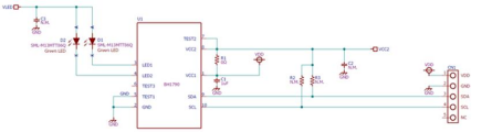

    The circuit diagram of the module is like this:
    Circuit diagram of the BH1790GLC heart rate sensor with green LEDs.

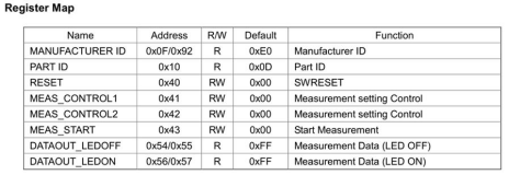

    There are only a handful of registers in the whole sensor. Besides the ID register, there are just control registers. The data that's collected is stored in two groups of data registers: DATOUT_LEDON and DATOUT_OFF.
    The manual also has measurement control instructions. These instructions keep me from getting all mixed up.
    Register map of the BH1790GLC sensor.
    According to this timing sequence, I configured the 0x41 – 0x43 registers as follows.

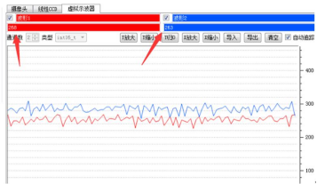

    The figure below shows the data waveform when my finger is not placed on it: Heartbeat sensor BH1790GLC data charts without finger pressure
    The values of DATAOUT_LEDOFF (red) and DATAOUT_LEDON (blue) remain almost stable, with indoor data hovering around 260.

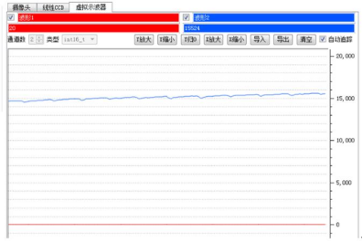

    When a finger is placed on the sensor, the waveform changes immediately.
    Graph of heart rate sensor data BH1790GLC with DATAOUT_LEDOFF and DATAOUT_LEDON values.

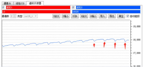

    DATAOUT_LEDOFF (red) immediately goes down to around 20, while DATAOUT_LEDON (in blue) has an obvious fluctuation. The range of this fluctuation is really small, and the value of DATAOUT_LEDON (blue) keeps rising steadily.
    Graph showing DATAOUT_LEDON values in blue with marked dip points.
    To extract pulse data from such a waveform, an appropriate algorithm is indeed needed.

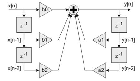

    Let’s first discuss the IIR filter. Here, I have chosen a Direct Form I IIR filter, implemented through a cascade of second-order biquads. Each biquad consists of a second-order filter:
    [ y[n] = b_0 \cdot x[n] + b_1 \cdot x[n-1] + b_2 \cdot x[n-2] + a_1 \cdot y[n-1] + a_2 \cdot y[n-2] ]
    The Direct Form I algorithm requires 5 coefficients and 4 state variables for each stage, as illustrated below.
    Block diagram of IIR Direct Form I filter for input and output signals
    x[n] represents the input variable, while y[n] is the output value after applying the IIR filter.
    According to this formula, a first-order IIR filter can be realized. By cascading several such filters, you can achieve a higher-order IIR filter.
    Block diagram of Direct Form I IIR filter.

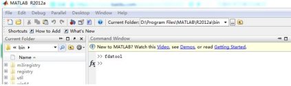

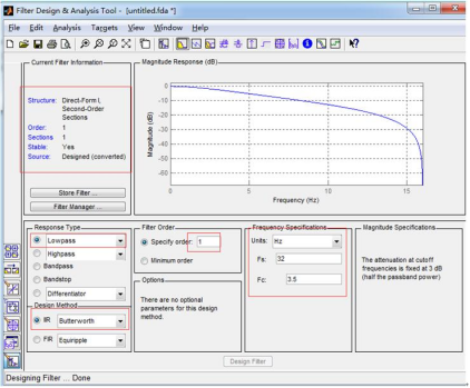

    Open the filter design toolbox with fdatool.
    Screenshot showing MATLAB window with fdatool running.
    Set the filter parameters:
    Screenshot of the MATLAB Filter Design Toolbox showing filter parameters.

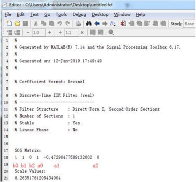

    Please note that the BH1790GLC (Link) heart rate sensor we have configured outputs data at 32Hz, hence the sampling frequency of the filter is 32Hz with a cutoff frequency of 3.5Hz.
    The filter parameters as output by MATLAB are as follows:
    Screenshot of MATLAB editor showing code related to the SOS matrix for an IIR filter.

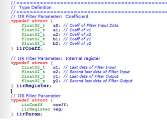

    Having obtained the parameters for the filter, let's commence coding.

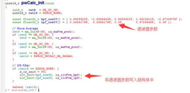

    Define the structure for IIR filter parameters:
    C code for IIR filter parameters for BH1790GLC heart rate sensor
    Initialization of IIR Filter
    Snippet of code for IIR filter and moving average initialization.

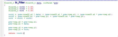

    The code implementation for calculating the IIR filter is as follows:
    C code snippet showing the implementation of an IIR filter.

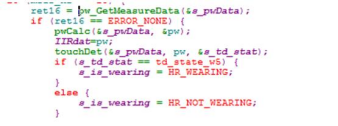

    The program reads the sensor data at a frequency of 32Hz.
    Program code calculating heart rate sensor data.

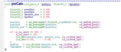

    pw_GetMeasureData(&s_pwData); retrieves the sensor data and stores it in s_pwData.
    pwCalc(&s_pwData, &pw); The data undergoes IIR filtering to obtain PW data.
    The filtering method is as follows:
    Code for pwCalc function for heart rate sensor data
    First of all, the raw data goes through a moving average smoothing process. After that, it passes through a high-pass filter and then a low-pass filter. In the end, it gives us the output dataOut.

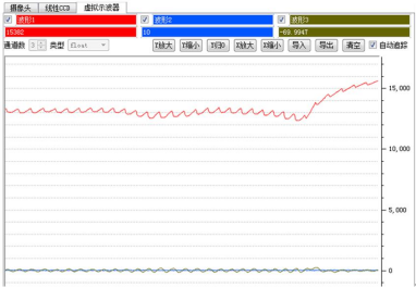

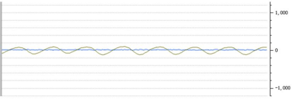

    Now, I'll send both the raw data and the filtered data through the serial port. The waveform will be shown like this:
    Graph showing data from the BH1790GLC heart rate sensor
    Red for DATAOUT_LEDON, blue for DATAOUT_LEDOFF, and green for data after IIR filtering
    After magnifying the PW waveform:
    Waveform of signal after IIR filtering shows almost regular sinusoidal waves.
    After the IIR filtering process, it can be noticed that pw nearly shows a regular sinusoidal wave. This makes it extremely convenient to precisely measure the pulse heartbeat that the sensor has detected.

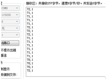

    The final heartbeat statistics are presented through the serial port in the following way:
    Serial port interface displaying heart data values.

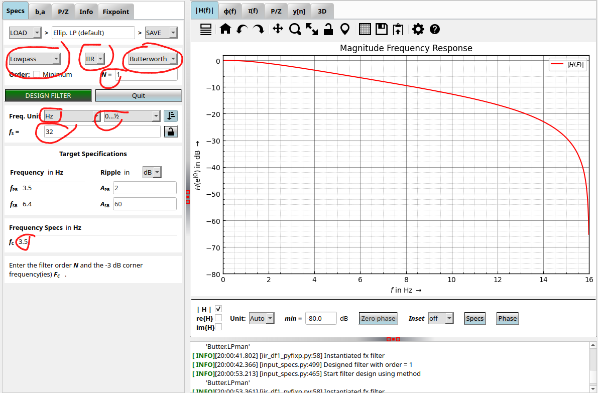

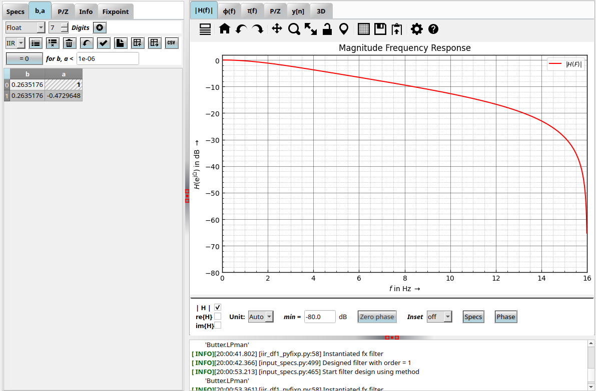

    Don't have MATLAB, but found a tool that designs IIR filters:
    pyfda
    Pyfda tool interface for designing IIR filters with a frequency response graph.
    pyfda tool interface with frequency response plot of a filter
