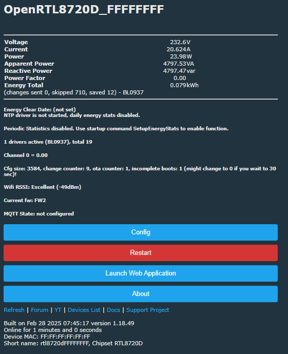

    Here's something GPT and I have been working on to create a BL0937 simulator for OpenBeken testing across different platforms. It's an Arduino sketch that runs on an ESP-WROOM-32 and is currently connected to an RTL8720DN/BW16E NiceMCU_RTL8720_V1 running OpenRTL. The sketch uses PWM to simulate CF, CF1, and SEL, allowing OpenBeken to interpret the signals as if a real BL0937 power monitoring chip were present.
    The readings aren't exactly realistic yet, but this is the closest I've gotten so far.
    Screenshot of the interface showing data for the OpenRTL8720D_FFFFFFFF device.
    Pin assignments and setup details can be found in the comments of the sketch.
    Feel free to use, improve, or modify it as needed—any feedback is welcome!

    Interesting, is this on default OBK BL0937 calibration?
    It should be possible to even hand-tune it to give better results, but you'd also need to test different simulated powers/voltages/currents.
    Btw, what happened to your device MAC?
    yes. nothing tweaked but the Arduino code.
    this was put down to no mac in efuse https://www.elektroda.com/rtvforum/topic4093142-210.html#21449647
    is your BW16E not the same?
