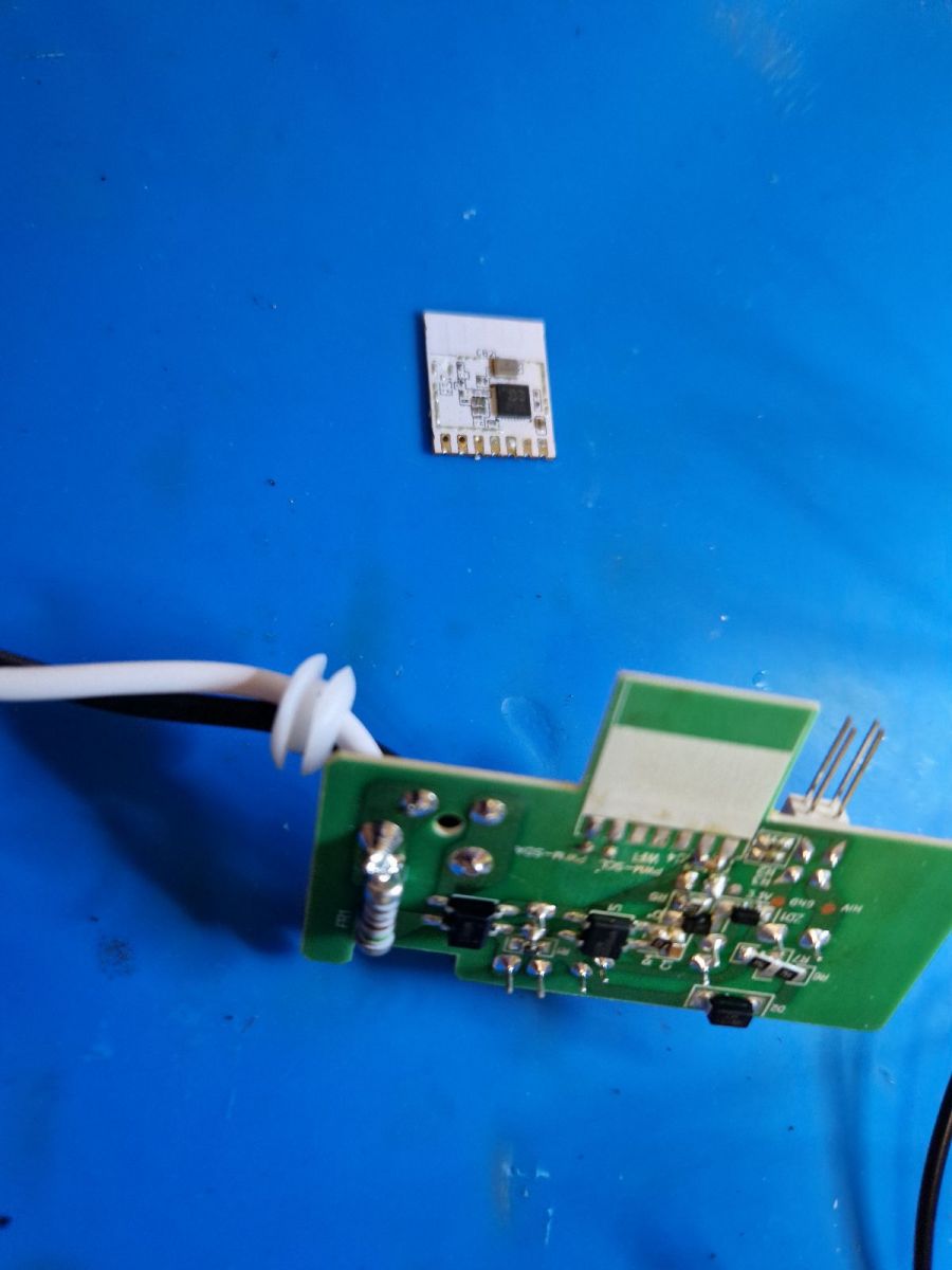

    We started by ripping the WiFi module batch:

    The batch, more precisely the JSON configuration from Tuya, already suggested that the LED controller is not known:
    Of course, we ripped and decoded the batch with my tool:
    These keys are probably the leads for the I2C GPIO:
    The keys below are RGBCW channel indexes (not always in order):
    In turn, the keys below are for setting the current for different modes of the controller, as well as some other parameters that are not very familiar to me:

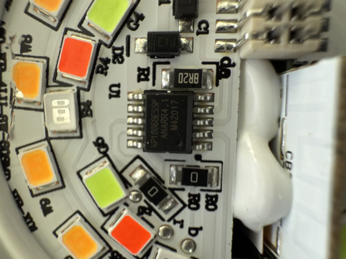

    There seems to be some kind of KP58 chip inside.
    This is also true:
    swpharis wrote:
    It's a KP18058esp.
    Reverse engineering of an unknown I2C protocol with Sigrok analyzer
    The presence of only two lines of communication with the simultaneous knowledge that the lamp is RGBCW (as many as five channels) already suggests that there is no PWM control here, but I2C or a similar protocol is used.

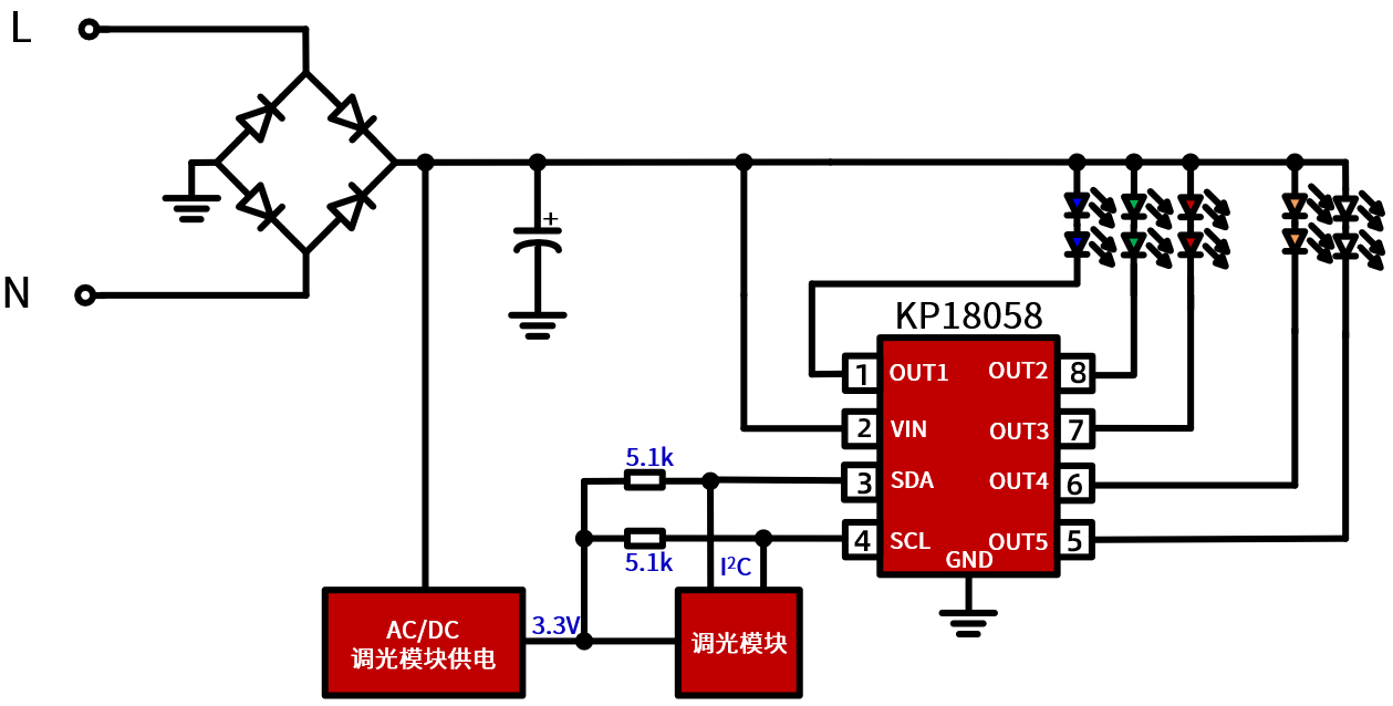

    KP18058, I managed to find residual documentation of this system. Here is an example of a schematic diagram of such a lamp:
    AC/DC here is a non-isolated step down converter. The "mysterious" block is the WiFi module.

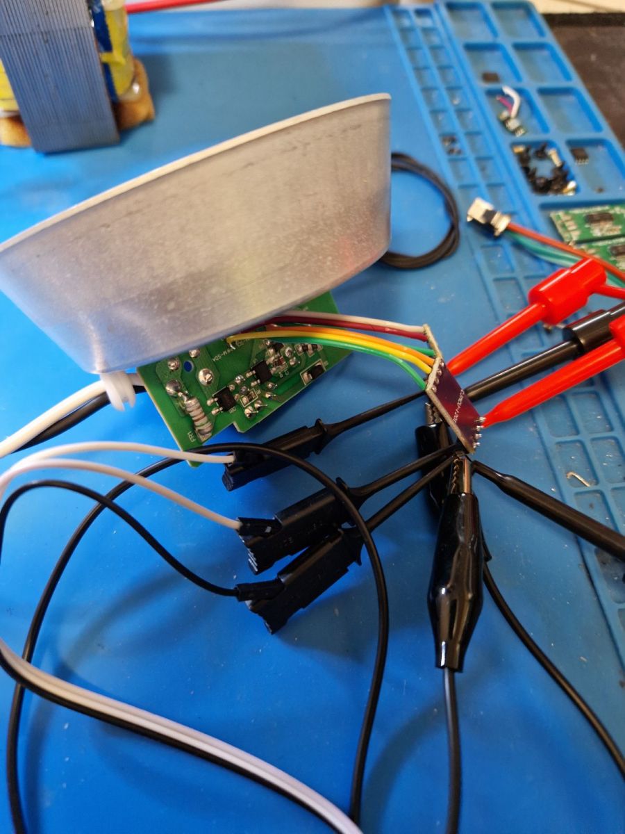

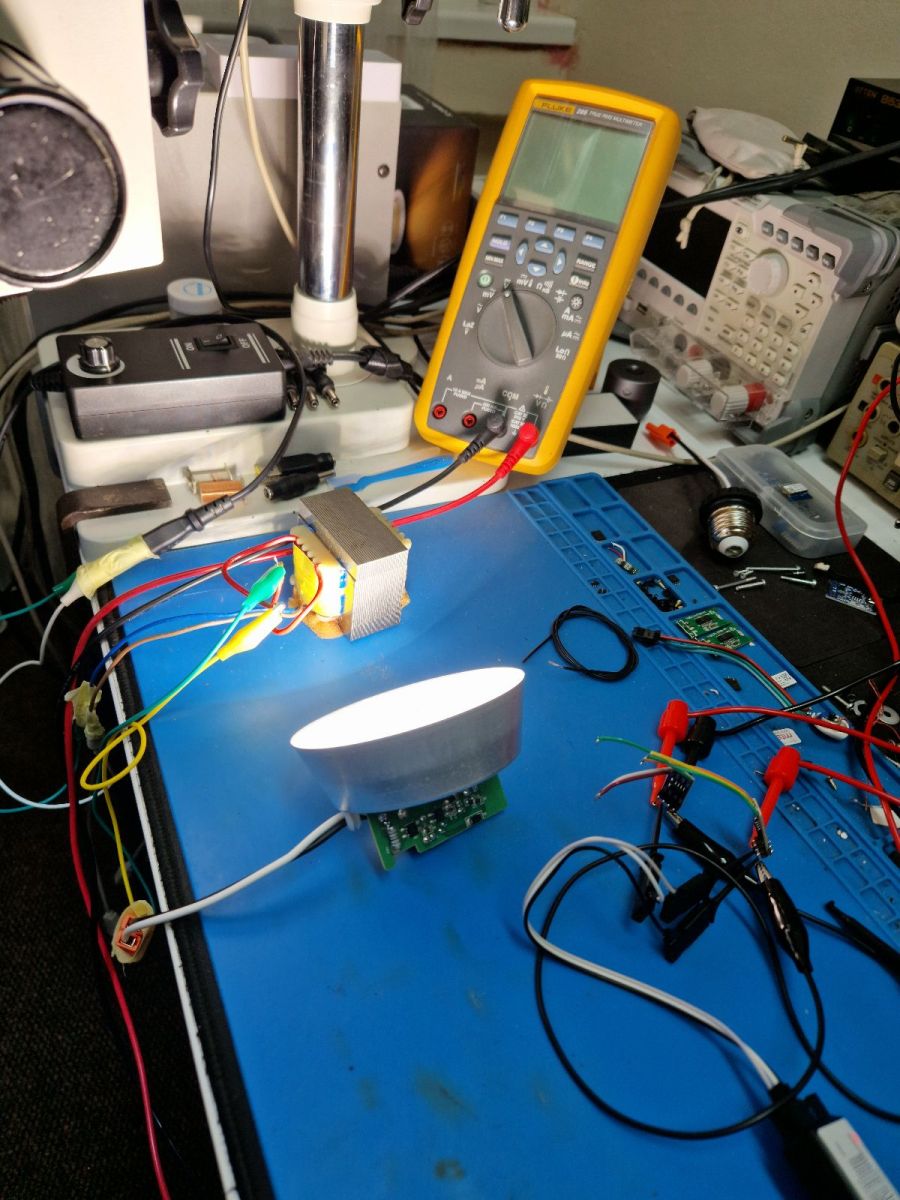

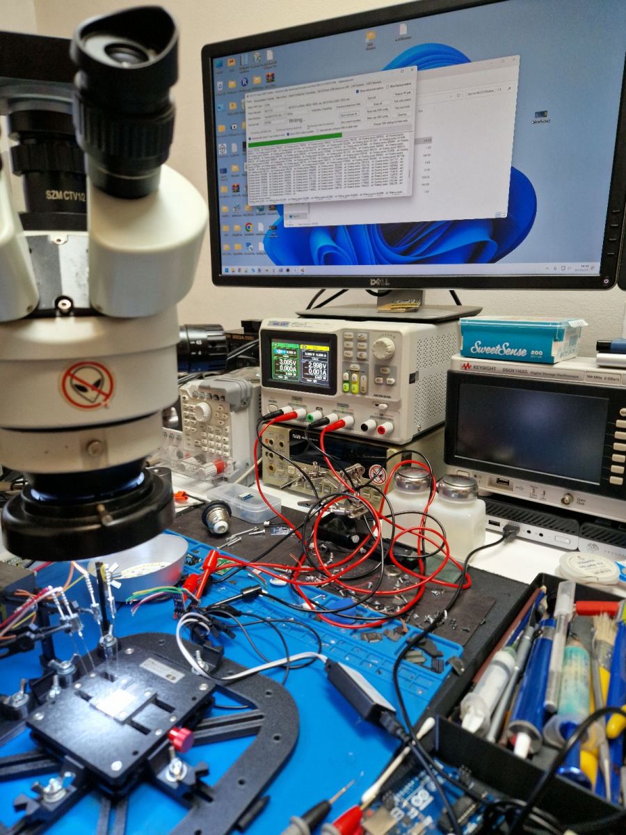

    Workplace and data capture
    As you have probably already seen from the general scheme of the device, this lamp does not have any galvanic isolation. The WiFi module is powered by a small non-isolated step down converter and the LED controller itself is powered directly from the mains.

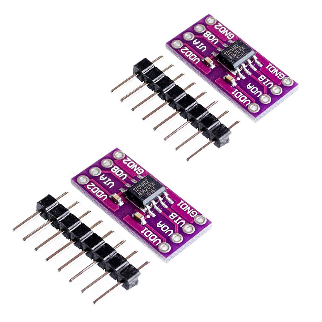

    An additional problem here is that the product from the topic works on 120V and my friend's is 230V ... so we started with a step-down transformer:
    This already provides isolation, but also the isolators from Analog Devices, ADuM1201:
    You have to connect Sigrok somehow.
    They are very cheap, only about $2 (including shipping):
    Connection:
    And only after them was the Sigrok analyzer connected:

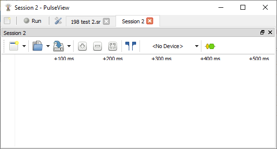

    Data analysis in Pulseview

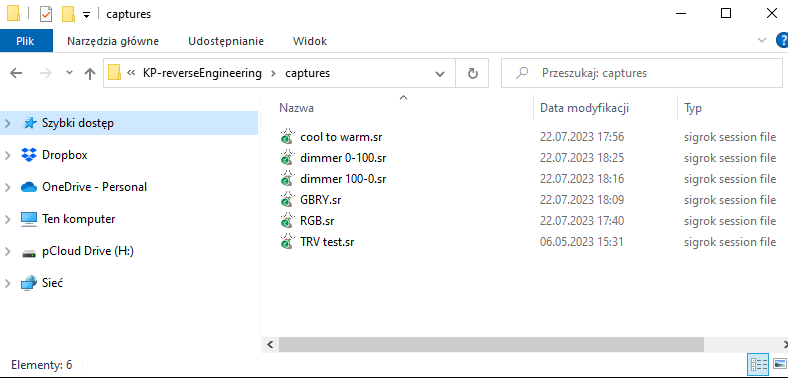

    A friend performed various operations on the lamp (via a mobile application) and collected packets sent at that time. I got SR files from him with data from SCL and SDA lines:

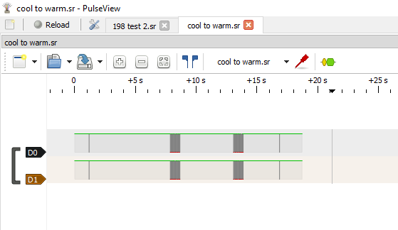

    SR files can be opened with the free PulseView:
    After opening, we only have the digital view of the data, which can be enlarged:

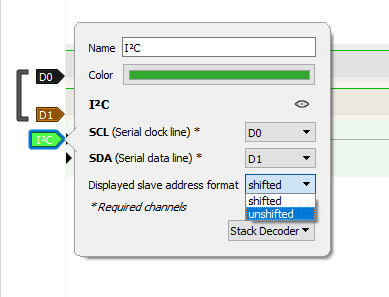

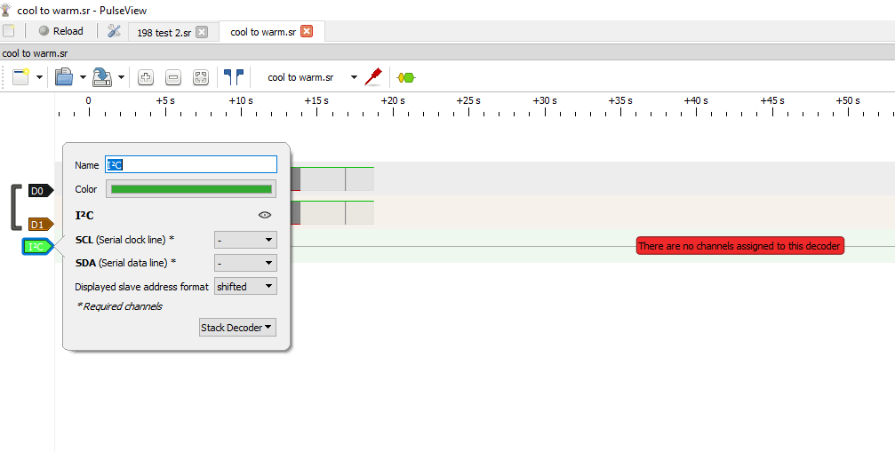

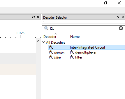

    PulseView doesn't know it's I2C. You need to add the appropriate decoder:
    Then you have to click into its settings and select which line is SCL and which is SDA:

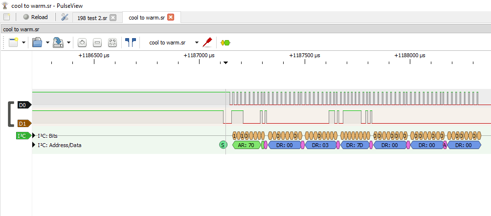

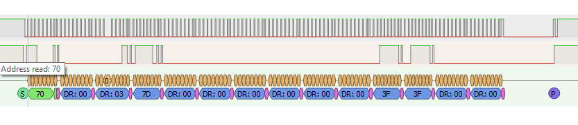

    Then we will see the byte values:
    And here is the first little inconvenience - it turns out that basically it is not an I2C protocol , because here there is no address byte at the beginning, more precisely, 7 bits of the address with the R or W bit, specifying whether we are reading or writing...
    The analyzer expects it and gives us "DR" that supposedly Data Read, but it's not true.
    Here everything is sent by the WiFi module, the KP system only receives.
    For convenience, you can disable the display of the alleged device address with the offset (because the R/W bit is the youngest) in the capture settings:

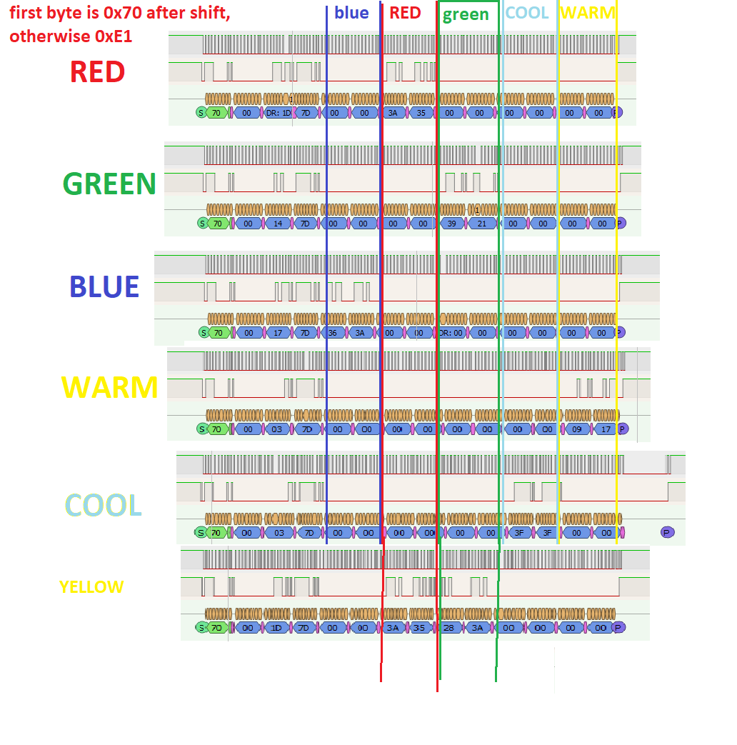

    I have looked at these packages and determined that there is only one type of package which is always 14 bytes long. Some examples:
    Then, in the graphics program, I compared packets from individual colors, so as to determine which bytes are responsible for them:
    It looks like there are two bytes per color. With 5 colors (RGBCW), this is 10 bytes. There are 4 bytes left, where two are probably RGB and CW mode current limits (but I'm just guessing) and the first may be a command or operating mode.
    Additionally, I saw that the first byte changes depending on whether the light is on. It seems that when the lamp is on it is 0xE1 (but not always?), and when it is off it is 0x81.
    However, the very analysis of these two color bytes initially shows that their values change from 0x00 to 0x3F , implying that only the lower 6 bits of the byte are used. The values light up sequentially, suggesting that the value of one color is 12 bits. Do we have a resolution that supports 4096 different values per channel? SM2135 only has 256 values per channel and SM2235 only 1024...

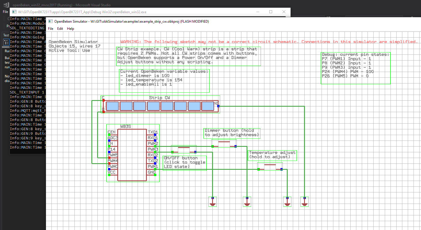

    My environment can also be run on Windows, I even have a built-in IoT device simulator:
    This allows me to conveniently test some things and eliminate simple errors before throwing the batch onto the device.
    I decided, for verification, to write a simple for loop that will write the created bytes to a file, representing the color dimming process from 0 to 255.0 (the 255 looks quite unfortunate, because initially I had the colors as bytes, because the SM2135 only supports 8-bit values, but then it appeared SM2235 with 10-bit colors and changed the type to float and the range 0-255 remained):
    Code: C / C++
    And just handling one package:
    Code: C / C++
    Here is the result - does it look correct?

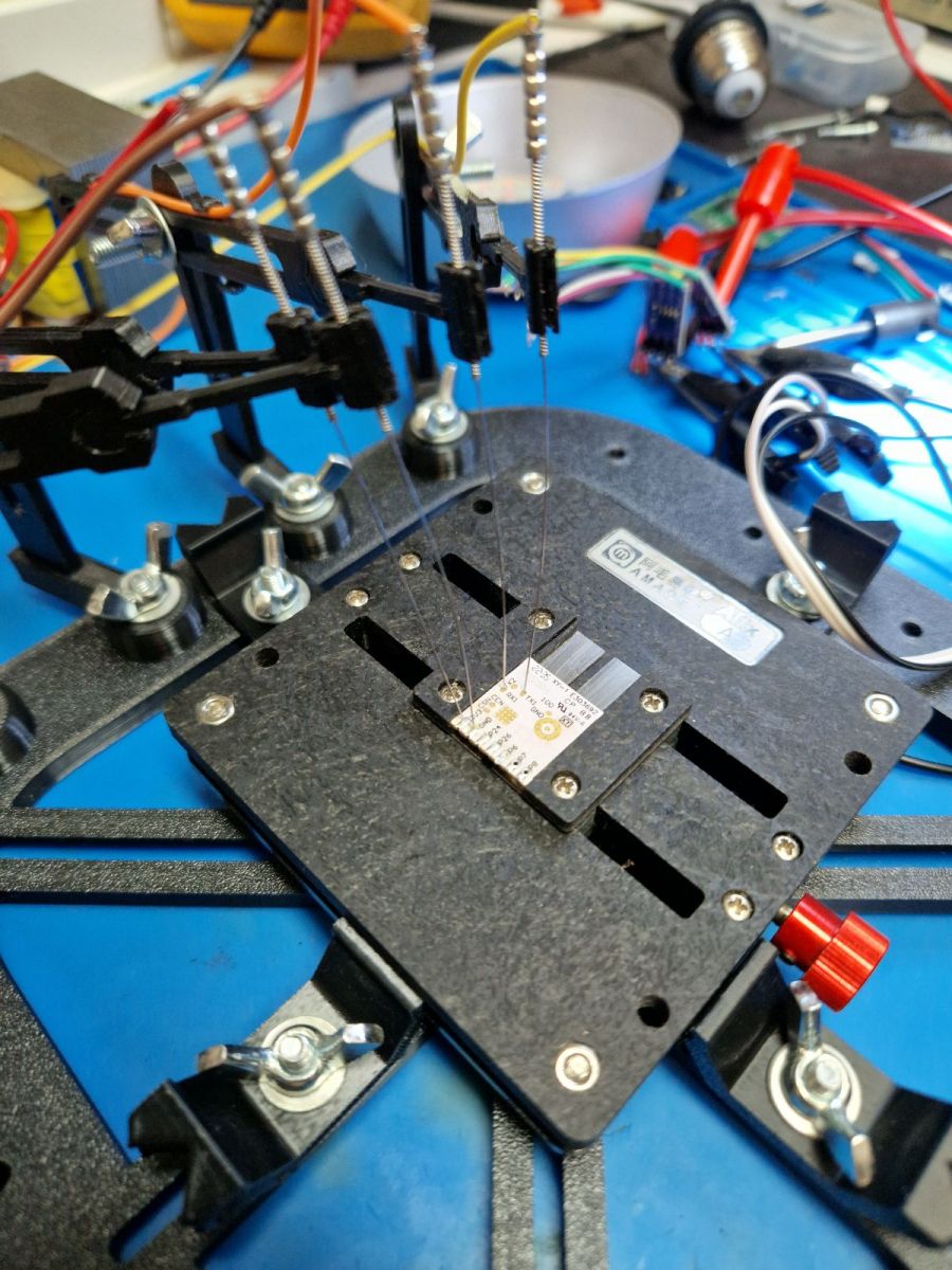

    Changing the batch of the WiFi module
    At this point, I thought we had enough data to complete the capture and change the batch on the WiFi module to OpenBeken. Then it will be easy to update the firmware remotely via OTA. You only need to upload it wired once. The module has been desoldered:
    Then it hit the pin station - we connect to RX, TX, 3.3V and GND as standard:
    Everything according to my flasher's instructions:
    During programming:

    By the way, in this video below you can see live capture of I2C packets (on one of the monitors):

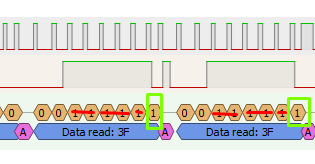

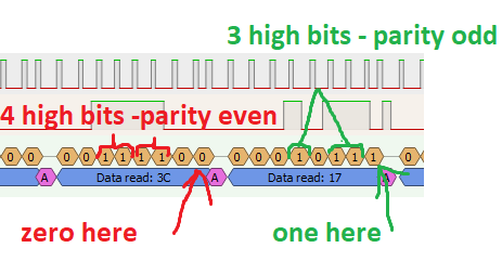

    After a short analysis of the collected packets, it turned out that it is not 6 bits per byte, nor is it 12 bits per color. Some bit combinations are omitted. Now the only question is why...
    After comparing multiple packets, you can see that the lowest bit is always one when the sum of the other bits is odd, unlike zero.
    This is the so-called parity bit.
    It can be said that this is the simplest, one-bit, checksum.
    This bit detects upload errors and must be correctly set when uploading.
    I corrected the code to count it:
    Code: C / C++
    Everything is working.

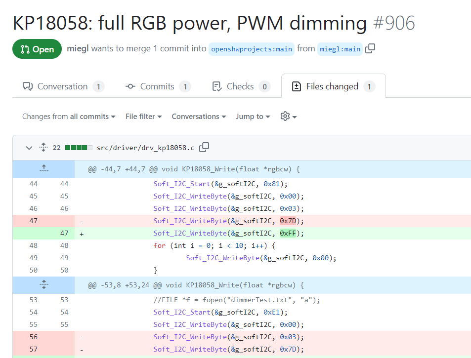

    Someone from Github recently contributed to this driver:
    https://github.com/openshwprojects/OpenBK7231T_App/pull/906/files
    Part of a GitHub pull request showing code changes in the drv_kp18058.c file.
    Changes in source code file introduced in a Github repository.
    I haven't analyzed these changes yet, but I put them here for information.

    And the Tuya section starts at UNCOMMON POSITION 0
    When I set the Light to 100% cool white the light emits a very low glow (as if it is at 2% brightness). If I power off the lamp and then power it back on, it returns to full cool white brightness. So it seems perhaps there is something I am missing.
    Any ideas?
  • Check KP18058_Write and channel mapping
    #5 21434392
    Posts: 14755
    Rate: 12881
    I haven't seen this behaviour, but you can try editing code here:
    https://github.com/openshwprojects/OpenBK7231T_App/blob/main/src/driver/drv_kp18058.c
    Especially KP18058_Write function. Binary can be compiled online, you don't need any toolchain, etc:
    https://www.elektroda.com/rtvforum/topic4033833.html
    By the way, do you have a correct channels map? Is color selection correct, is green really green, blue really blue, etc?
  • Cool white channel behaves differently from warm white
    #6 21434403
    WingmanNZ
    >>21434392
    Thanks for your reply. This is the color map that works to give red= red etc.
    backlog startdriver KP18058; KP18058_Map 2 0 1 4 3
    If I reorder it so the cool white (3) is first (assigned to red)
    (eg KP18058_Map 3 2 0 1 4)
    then it exhibits the same dull blue (~5% brightness) behaviour. The warm white (4) behaves correctly regardless of being assigned to red or the correct map as in my startup code.
    As for editing the code, is there anything there that handles cool white different from warm white?
  • KP18058_RGBCW command for direct chip debugging
    #7 21434408
    Posts: 14755
    Rate: 12881
    I haven't seen anything like that, but maybe you can try using KP18058_Current to set the same current value for RGB and CW so we can tell whether it's the setting problem.
    Also, is your device using the same remap as the devices we have been working with and confirmed to work correctly?
    Also this:
    There is nothing like that in the code?
    Also it seems you are saying that problem is remap-agnostic, no matter how you remap, the true cool white has problem?
    Maybe try assigning a lower currents limit in general (with KP18058_Current ), maybe overcurrent protection kicks in?
    Have you seen KP18058_RGBCW command? It allows for a direct access to KP18058. Can you try to use it to debug the issue, if you use KP18058_RGBCW command, is the brightness problem still present?
  • KP18068 chip identified; cool white issue persists
    #8 21434411
    WingmanNZ
    >>21434408
    the correct remap for this is `2 0 1 4 3` based on trial and error. I opened the device and it appears to be a KP18068 chip (photo attached)
    Close-up of a circuit board with a KP18068 chip and colorful LEDs.
    I have tried setting KP18058_Current to "KP18058_Current 1 1" and that has no effect.
    Also using KP18058_RGBWC 00 00 00 00 80 and KP18058_RGBWC 00 00 00 80 00 do not produce the same 50% brightness between warm and cool LEDS
    So to confirm, yes the problem is remap-agnostic, no matter how I remap, the true cool white has problem
  • #9 21434412
    Posts: 14755
    Rate: 12881
    Isn't W8 on the picture damaged? But still, it seems to be Warm LED, not Cool..
  • #10 21434413
    WingmanNZ
    Yes it is. This is because I cracked it when opening the unit (whoops!)
    So it seems this flag fixes it! Your comment on the image not having any cool white LEDs was the key!
    Flag 24 - [LED] Emulate Cool White with RGB in device with four PWMS - Red is 0, Green 1, Blue 2, and Warm is 4
  • #11 21434442
    Posts: 14755
    Rate: 12881
    Ah, I can see now... now I just need to make a note myself to ask for a full board photo earlier. It's a basic diagnostic step.
