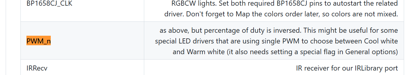

    I think there is already PWM_n role in OpenBeken, exactly for this purpose.

    >>21586648 Well, turns out me and ChatGPT both did not find this - THANKS!!!

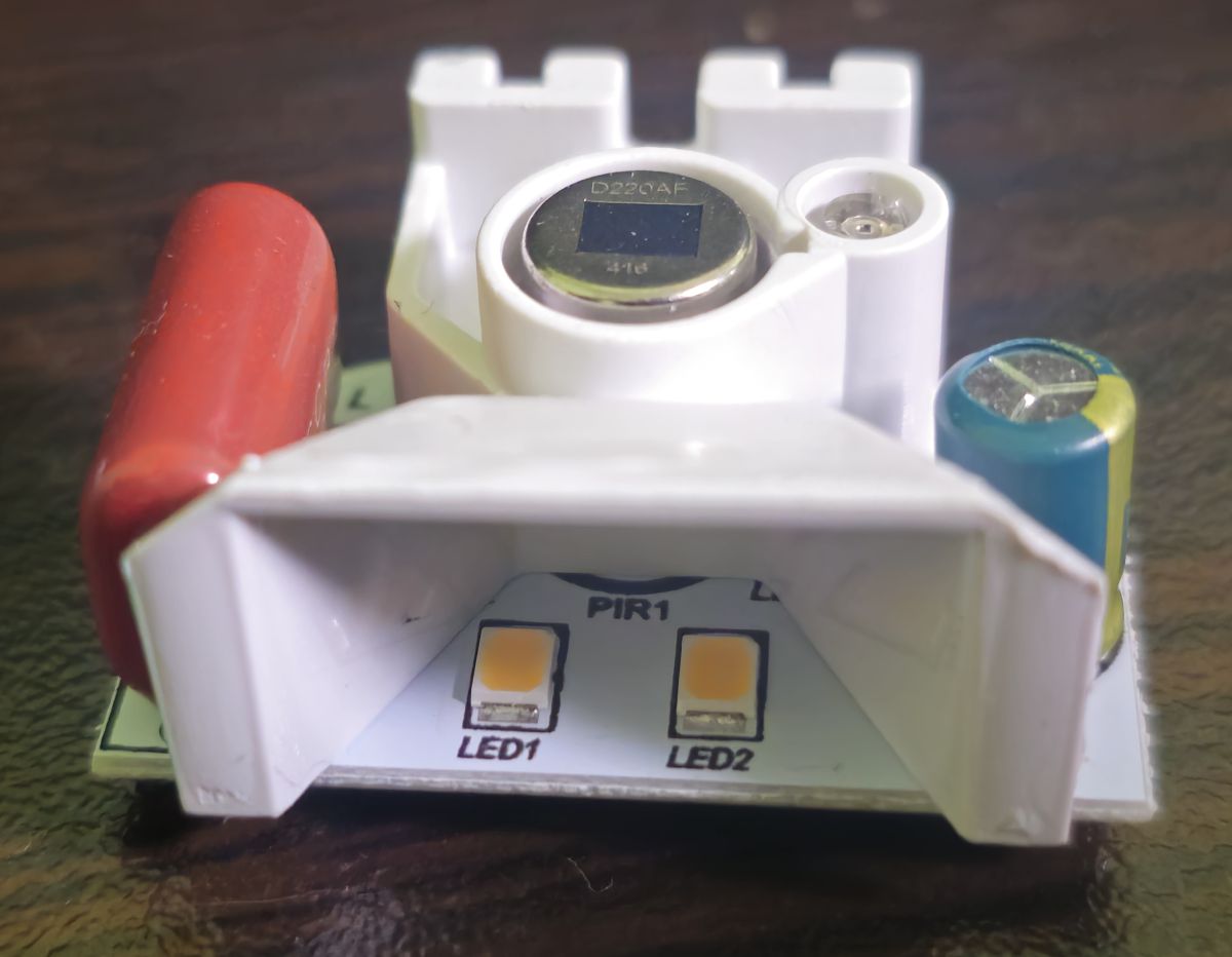

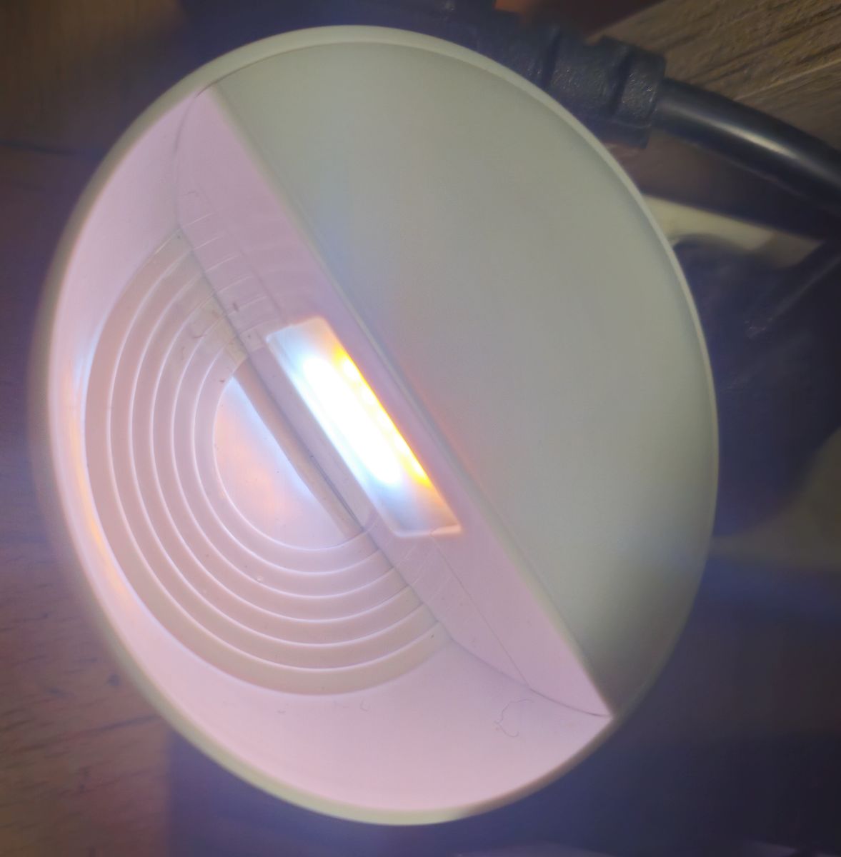

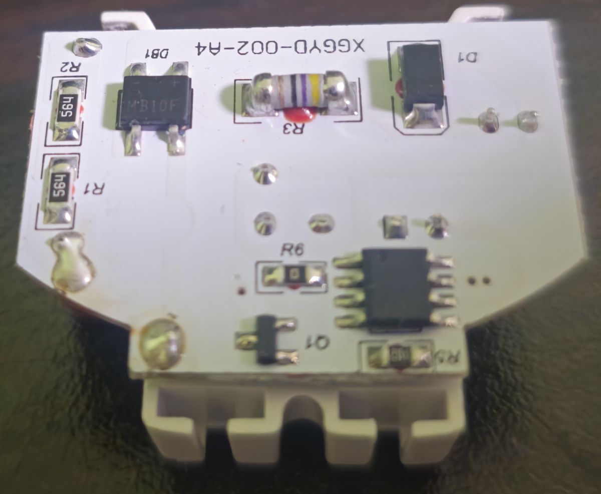

    There is NO board, it's a SMD wire web held up with UV resin.
    I use custom Led arrays (one made from orange car blinker leds (PWM5), and one from cold white solar lamp(PWM1)) with appropriate current limiting (22 ohm resistor for cold white and just diode to drop 0.2v for orange).
    Do not worry they run well under 50% rated current, yellow ones are even on ALU PCB even though they are running at 60mA for 5 5730 leds.
    all leds are running off same power as MCU : 3.3v : https://www.aliexpress.com/item/1005006368811....order_list.order_list_main.69.38c61802S4btol
    I use si2301 as led control led with 20k pull up.
    The body is Chinese night lamp.

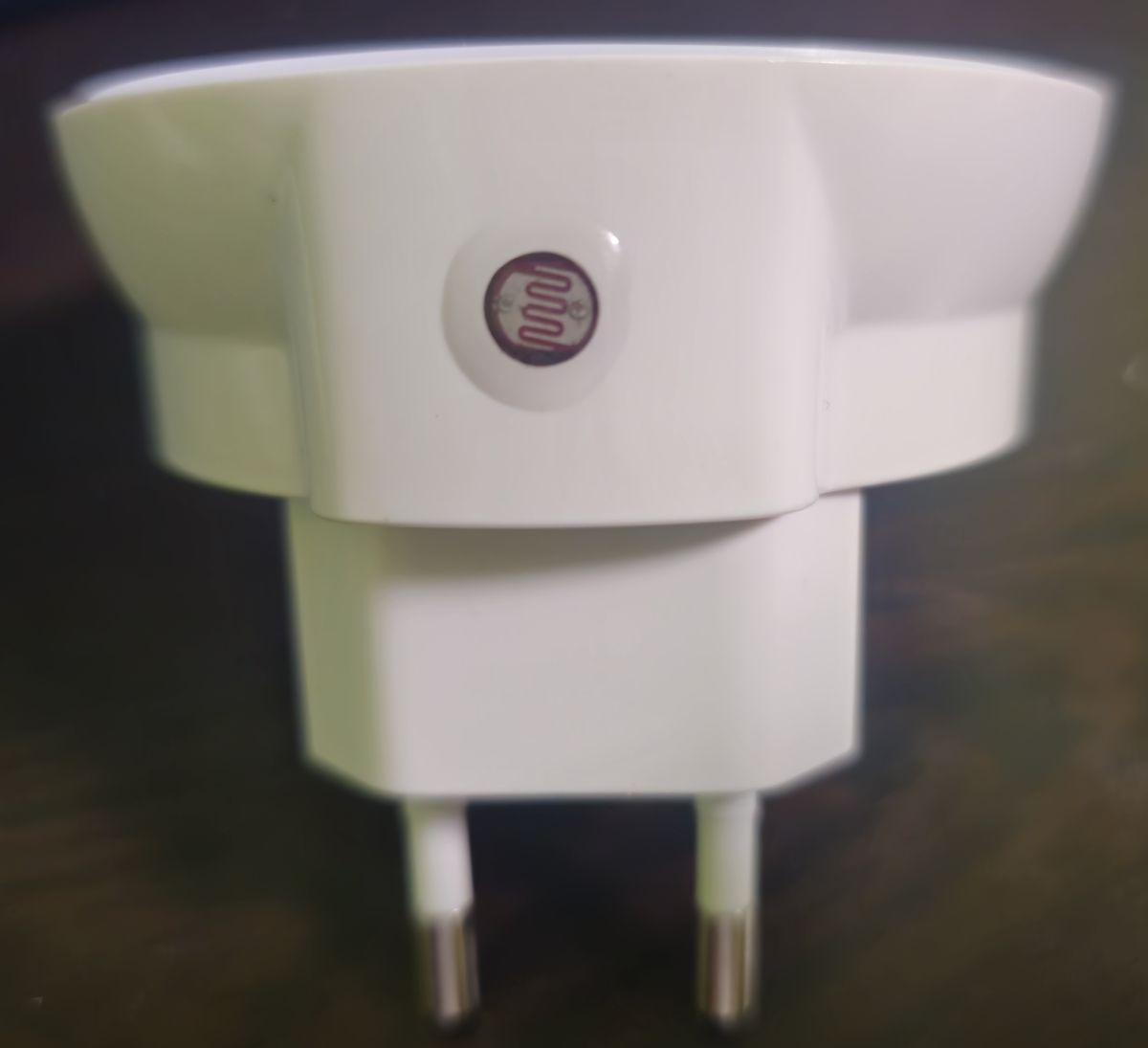

    Light sensor is photo resistor i gt from who knows where...
    seems 1.5Mohm resistor was nice match match for it /or highest i had/ so now i read 3000lux at very dark at 2700 at dark when i configure the ADV as lux sensor.
    Still no idea what script i need
    Added after 23 [minutes]:
    Here are some pictures.
    Last two are original board.
