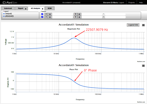

    The AC simulation occurs in the frequency domain, not the time domain. Therefore, on the abscissa axis, the scale is expressed by the frequency in logarithmic format (with the powers of 10 Hz, kHz, MHz, etc.). After pressing the “Run” button, the system displays the simulation results on the screen, in the form of graphs, as shown in Figure 3. We can see two types of graphs:
    Circuit simulation graphs in PartSim showing magnitude and phase characteristics.
    Figure 3: Graphs created by the AC simulation
    • The upper graph shows the amplitude of the output signal, in the frequency domain. Its maximum peak occurs at the resonant frequency.
    • The lower graph shows the phase trend of the output signal, in relation to the input signal. This aspect is better-explained in the next paragraph.

    The graphs in Figure 4 clearly show how the phase of the output signal changes with respect to that of the input signal by varying its frequency in the circuit examined. At the resonant frequency, the output signal is perfectly in phase with the input signal and the amplitude is equal to that of the input signal. At a 10-kHz frequency, the output signal is 68.623° out of phase with respect to the input signal and its amplitude is equal to 36.4% with respect to the maximum peak. At a frequency of 100 kHz, the output signal is out of phase by –80.483° with respect to the input one and its amplitude is equal to 15.53% with respect to the maximum peak. For a better understanding of the graphs, a 1-V offset has been applied to the input signal.
