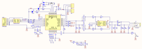

    Overall Schematic Diagram
    The USB sound card adopts the classic PCM2912A(Link)+TPA152 solution, with all circuits designed following the recommended circuit designs in the chip manuals.

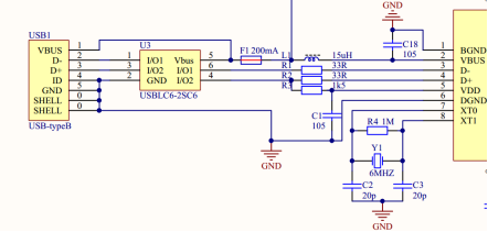

    Interface Design: Protecting and Optimizing Connections
    The USB segment has been fortified with ESD protection and a fuse, serving as a shield against the perils of static electricity during the plugging and unplugging process. Meanwhile, the power input has been treated to a simple yet effective LC filter design. This not only ensures a pristine power input but also works wonders in enhancing the overall sound quality.
    Crystal Selection: Precision in Frequency and Stability
    Our choice of crystal, the NDK NX8045GB-6MHZ-STD-CSF-3, is housed in an 8mm x 4.5mm package. With a frequency of 6MHz and a temperature drift of 30ppm, it provides the stability and accuracy required for optimal audio performance.
    USB connection schematic with electronic components.

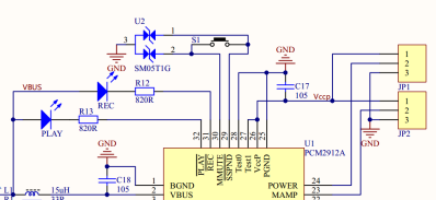

    The microphone mute button, which doesn't see frequent use, has been enhanced with an SM05T1G for added ESD protection. To simplify things, tin-jump wires have been employed for power-saving and microphone gain settings. Since these adjustments aren't made on a regular basis, this approach offers a practical alternative to more complex jumper caps or DIP switches.

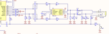

    Power Amplifier Output and Headphone Interface:
    The power amplifier section leans on the standard TPA152 (Link) circuit design. The output capacitors, in the form of tantalum electrolytic capacitors, have been carefully selected to ensure that the high-frequency equivalent series resistance (ESR) remains within an acceptable range.
    The output interface is a stroke of genius, combining the microphone and headphone into a single unit. This design choice not only streamlines the setup but also ensures compatibility with the majority of mobile phone control headphones available in the market. For those seeking single-headphone use with microphone functionality, a dedicated microphone position has been reserved on the board, allowing for easy soldering of a microphone.
    Electronic schematic showing the design of a USB sound card using PCM2912A.

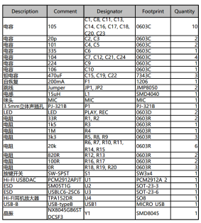

    Bill of Materials
    The components used are all relatively common and practical.
    Bill of Materials for the USB sound card DIY project.

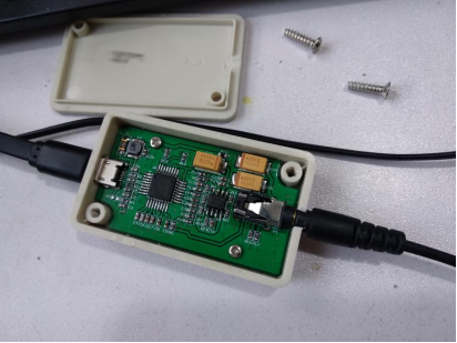

    Photo of the Physical Prototype

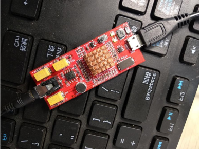

    First Version: Bare PCB
    The main chip generates a little heat during operation
    Prototype USB sound card circuit board placed on a keyboard.

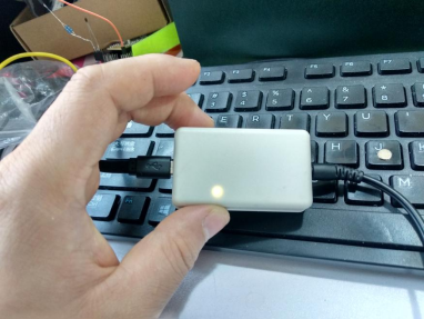

    The appearance after adding the casing: MicroUSB Version
    DIY USB sound card prototype with microUSB enclosure.

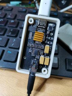

    The appearance after adding the casing: Type-C Version
    Interior of a DIY USB sound card prototype in a white casing on a keyboard.
    Appearance:
    Person holding a rectangular DIY device against a keyboard background.

    The 'generic' scheme is too small.
  • #3 21336804
    _jta_
    Electronics specialist
    Posts: 48808
    Help: 3197
    Rate: 4182
    Board Language: polish
    The others would also require a magnifying glass when reading, but this one is generic and probably won't read through a magnifying glass.
