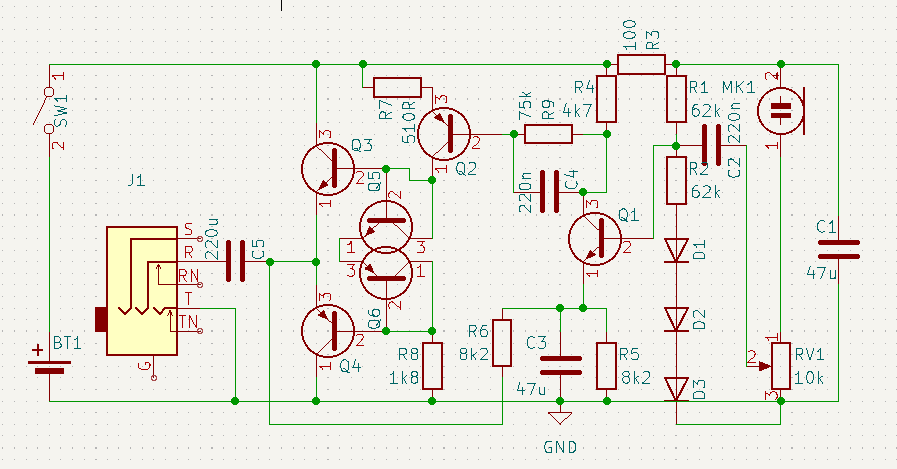

    I'm not an acoustician and I don't do acoustics at work, so professionals versed in the art may find the presented device technically poor, incompatible with the art and Be at all, but it has an undeniable utility value confirmed by the person concerned, with whom I can now communicate freely.
    I know you can buy a fairly decent amplifier on the MAX9814, however, where is the fun and learning here?
    So I borrowed the base schematic from the website : Link .
    I made this device unchanged, but it had some significant drawbacks such as a very high resting current ( battery life ) and a lot of noise.
    So I decided to simulate this circuit under LTSpice, which pointed me in the direction of improvements.
    This resulted in a circuit with relatively low noise, a flat gain characteristic from about 80Hz to the limits of audibility ( probably around 10kHz ) and a negligible resting current of less than 3mA.
    The final shape of the circuit is shown in the diagram below:
    Circuit diagram of an audio amplifier. .

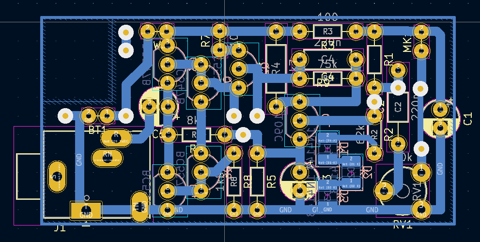

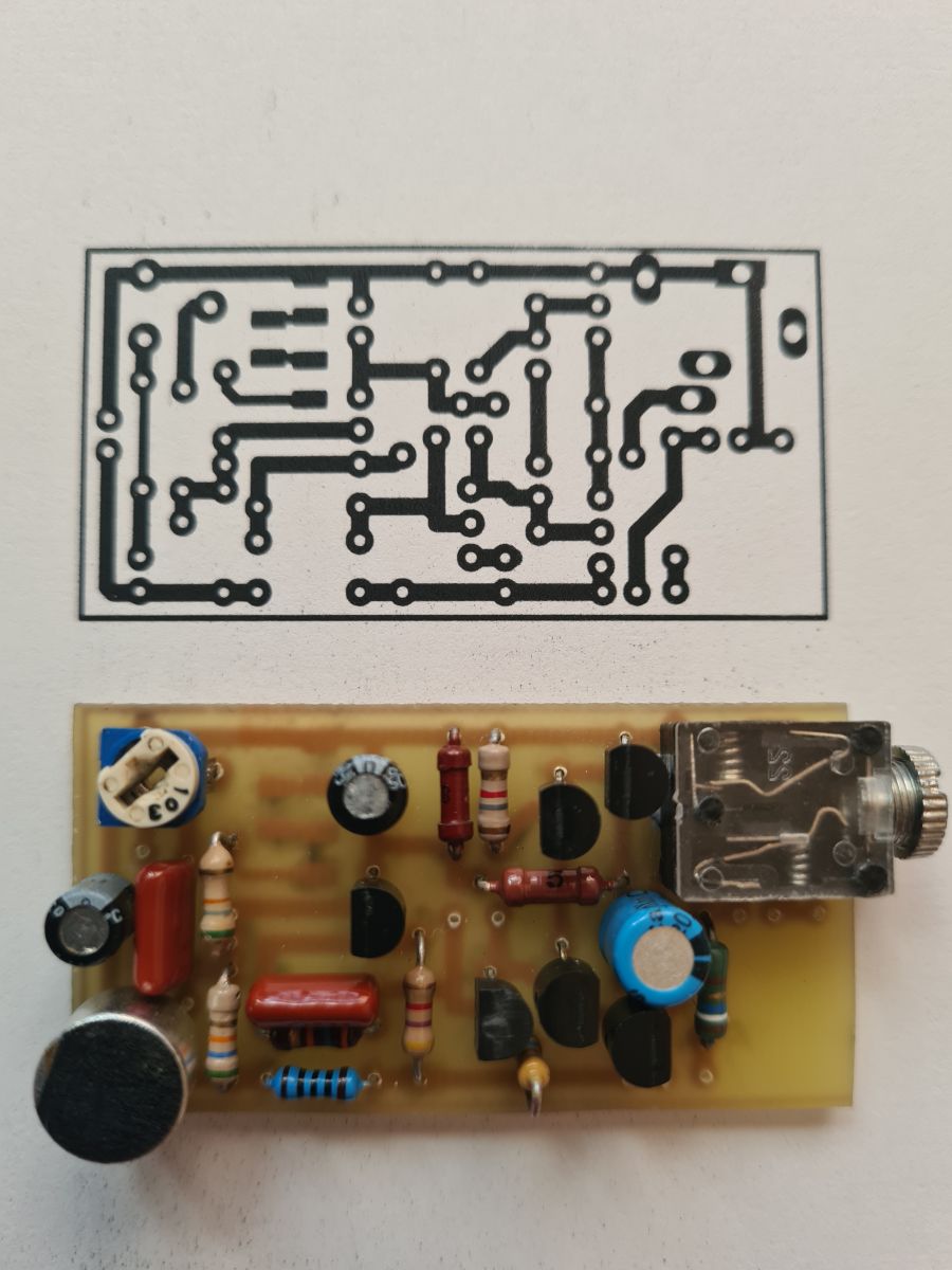

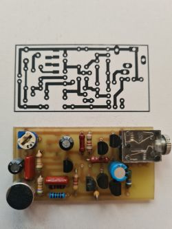

    What the layout is like everyone can see. A board was also created, of course :
    Printed circuit board design with electronic components. .

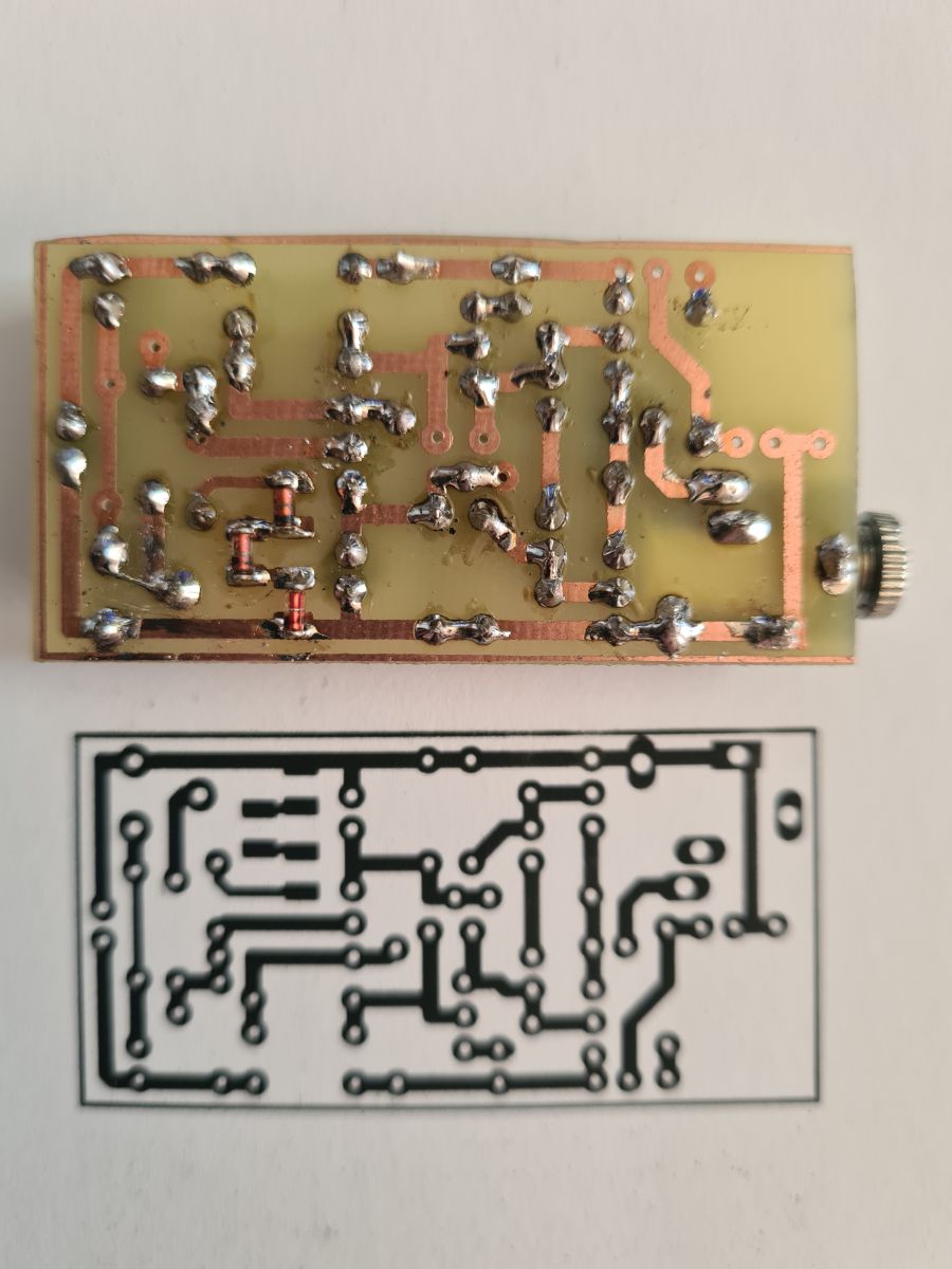

    and then it was enhanced with the relevant electronic components:
    Printed circuit board with soldered components, next to an etched PCB pattern. PCB with mounted electronic components in front of a printed circuit diagram.
    It's not a master craftsmanship, but it works and follows the schematic.
    After attaching the LiIon battery, headphones and switch, I performed tests and basic measurements.
    Actually the resting current is about 3.2mA and the noise is very negligible. The circuit picks up sounds well from about 5 metres and, most importantly, does not distort them in the audible range of sound waves. The goal has therefore been achieved.

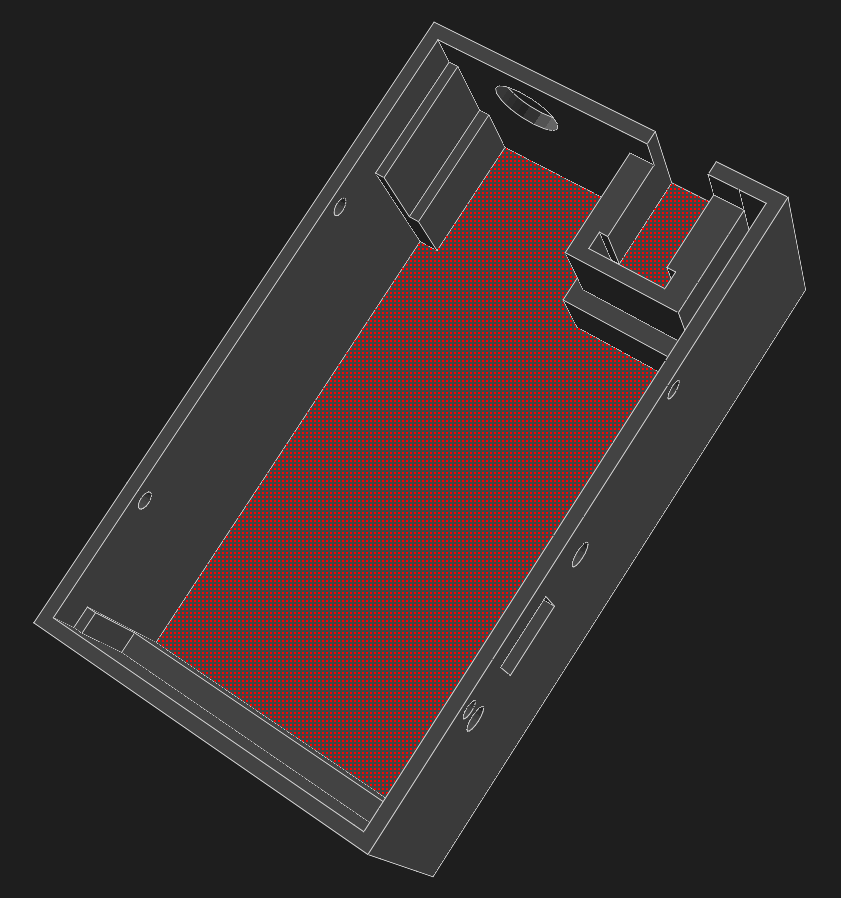

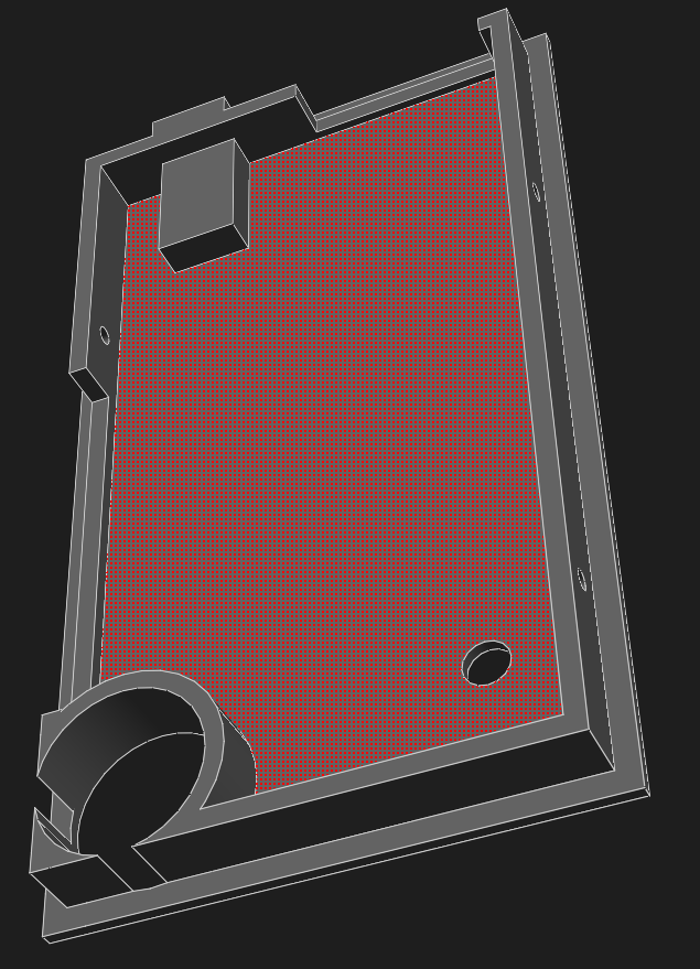

    Now only the casing remained to be made. Since I acquired a 3D printer, this is no longer a problem and instead of adapting the device to the housing I have, I make a housing for the circuit I made. Very convenient and quick, and I don't have to search for the right box.
    The box consists of the bottom and of course the top :
    3D model of a part of an electronic device housing Render of an electronic device enclosure with space for a printed circuit board. .
    And after printing it looks like this:

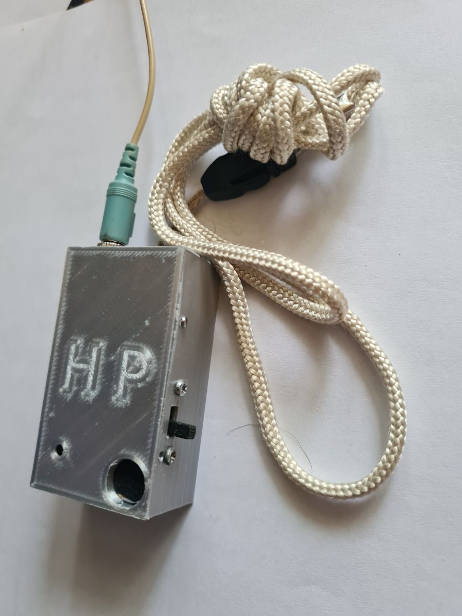

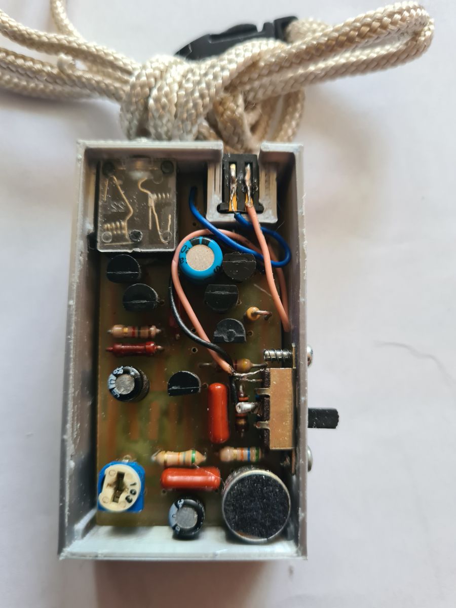

    Now the previously made layout goes into a new box :
    Interior of a prototype sound amplifier in a box with electronic components. Homemade electronic device in a plastic 3D printed case.
    and that's pretty much it.

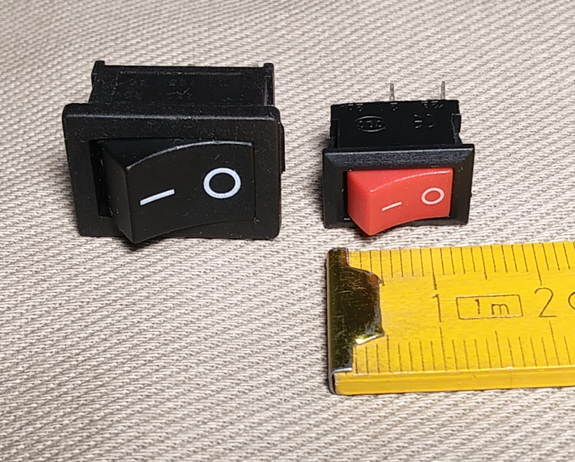

    The type of circuit breaker used by the Fellow has the drawback of a rather flimsy slider design.
    I suggest replacing the switch currently used with one from the photo below.
    This is the type commonly found in small domestic appliances.
    I am particularly mindful of the second one shown, due to its small size and red colour for ease of use.
    Black and red rocker switches and a yellow measuring tape on a light fabric background. .
    For the presentation itself I have the following question: where is the battery located?

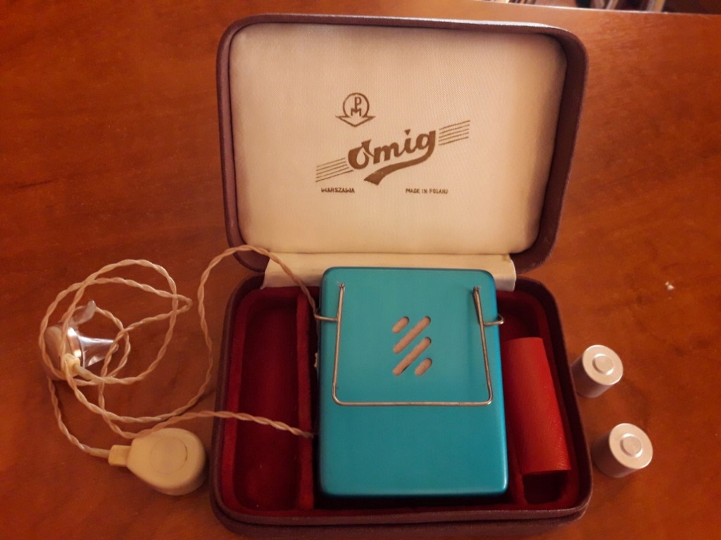

    Very interesting analogue design, hearing aids used to be made like this at Omig, on germanium transistors:

    As for the switch, it is exactly that, because it switches very lightly, and the user has rheumatic problems, so it is of great importance to him.
    The LiIon battery, on the other hand, is located under the PCB.

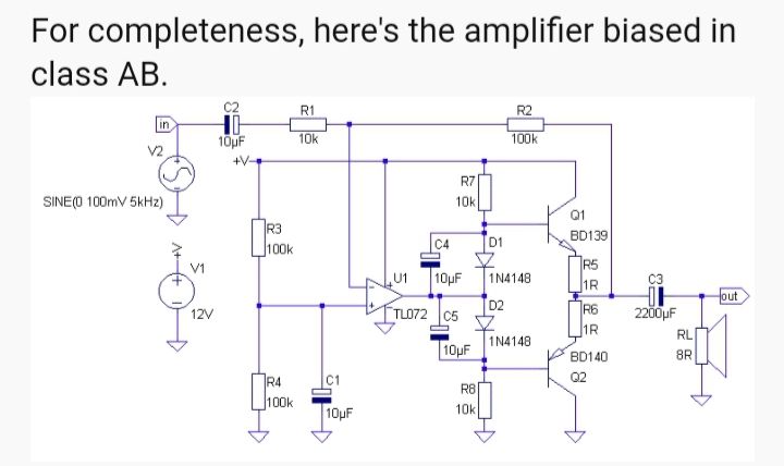

    Why transistors Q5 and Q6 and not ordinary diodes in this location? Does this have any significant effect or influence on anything (on e.g. noise)?
  • #9 21130748
    yego666
    Posts: 2175
    Help: 239
    Rate: 564
    In the first version I used 1N4148 diodes, which is what was recommended, but I noticed on the oscilloscope a waveform skip ( actually it was a saddle) when switching the output transistors.
    After replacing the diodes with transistors, this effect no longer occurs.
    I chose transistors so that they came from the same series, and had identical voltage drops at the B-E and B-C connectors, and since I have a whole bunch of them, I didn't have a problem with that. As a result, the sound is clear and doesn't have that pesky distortion.
    Surely someone proficient in the art could give the correct name for such distortion.
  • #10 21130756
    kris8888
    Posts: 6882
    Help: 532
    Rate: 1880
    yego666 wrote:
    Probably someone proficient in the art could give the correct name for such a distortion
    Yes, this is crossover distortion. It's just that when you used diodes there was too little resting current for the terminal transistors. Apparently transistors Q5 and Q6 as diodes have a minimally higher conduction voltage than normal diodes which results in a slightly higher resting current, already offsetting this cross distortion.
    These transistors Q5 and Q6 do not have to be matched in a pair.
    If you were to replace Q5 and Q6 with a classic circuit with a potentiometer and a regulating transistor, you would be able to precisely set the resting current to the smallest possible value, but in such a way that no crosstalk distortion would occur.
  • #11 21130847
    yego666
    Posts: 2175
    Help: 239
    Rate: 564
    Thanks for the expert explanation and definition. "Cross-cutting" - nice word :) .
    I did not pair transistors Q5 and Q6 but Q3 with Q5 and Q4 with Q6 to match the voltage drops across the connectors in such pairs.
  • #12 21130879
    kris8888
    Posts: 6882
    Help: 532
    Rate: 1880
    This is also unnecessary because all that matters is the sum of the voltage drops on Q5 and Q6. And in what proportions and whether they correspond exactly to the E-B voltage drops of transistors Q3 and Q4 is already irrelevant.
    You simply shot Q5 and Q6 in such a way that the sum of the voltage drops on them results in the rest current of transistors Q3 and Q4 on the borderline of crosstalk distortion.
    You would have achieved the same thing by selecting appropriate diodes in series or combinations of ordinary diodes and, for example, Shottky diodes.

    Have you not thought about the TDA2822M? It will replace 5 transistors.
  • #14 21130894
    kris8888
    Posts: 6882
    Help: 532
    Rate: 1880
    LEDówki wrote:
    TDA2822M
    It draws about 5mA of resting current at 3.7V supply. More than the author managed to wring out in this title project. And this, as I understand it, was also one of the design goals, i.e. to reduce the current consumption to a minimum.
    This is more likely to be something on an OP193. It draws extremely little resting current and can deliver sensible power to the handset.

    The TDA2822 does not do resting current problems. Classical class AB power stages have current regulation and a transistor to maintain the correct voltage between the bases of the power transistors. I made a similar amplifier, but the gain lousy and high tendency to excite. The circuit is ready-made, from a kit. The power stage transistors are not polarised as here, and the gain is eliminated by magic feedback. Not really effective, although simple, as there are only 2 transistors added to the operational amplifier. BC109 is an old transistor. Perhaps a BC414 would be better?
  • #17 21130983

    The amplifier schematic looks logical and is uncomplicated, however, have you tested it?
    Furthermore, it seems to me by the output transistors that these headphones can have even a few watts of power, i.e. the amplifier is intended for the baaaaavery deaf audience :) .
    If the TL071 amplifier were used then we would gain the ability to correct the input offset and the second amplifier present in the TL072 would not be wasted.

    You could also replace the output transistors with some BC547/557 or similar.
    The idea is of course worthy of emulation if one prefers such an arrangement.
    It is worth mentioning, however, that if we would like to go down with power supply to, e.g. 3V, TL07x will not be able to do it, because TI specifies power supply from 4.5V and ST from 6V upwards. So you have to use an amplifier suitable for such a supply.
    In the circuit shown above, the TL07x is OK because we have a 9V supply.

    yego666 wrote:
    The amplifier schematic looks logical and is uncomplicated, however have you tested it?
    I haven't actually tested this schematic, but I've done similar circuits with the amplifier on mosfets and in class A.
    It's nothing complicated, an opamp takes care of a lot of things.
    The TL072 is used in audio because it is less noisy, but you can compromise and use the low power TL062.
    The opamp also lends itself well to a microphone preamp with possible band equalization.
    Certainly the circuit is easier to commission than a transistor-based amplifier

    Staying on topic, I would like to ask my colleagues about how to eliminate a certain unpleasant feature of such an amplifier.
    Like any device, the amplifier is housed in some sort of enclosure.
    In this case, I printed it out for myself on a printer.
    After inserting the device into the enclosure, it turned out that the microphone not only catches the desired sounds, but also those coming from unwanted sources such as knocks and thuds on the enclosure or those coming from rubbing against clothes while moving.
    In order to get rid of these unwanted sounds, I isolated the microphone from the casing using a thin sponge, then rubber, and finally, when it turned out that this did not help, I checked whether connecting a second identical microphone in a counter-phase would get rid of the problem.
    Of course, I isolated the second microphone with a low-density sponge from the source of the desired sounds.
    Unfortunately, the effect of such measures turned out to be very poor or even unnoticeable.
    In the end, I ran out of ideas and didn't want to reach for DSP in such a simple device.
    Do you have any simple patent for getting rid of such unwanted interference?

    Using a differential microphone like in aviation headphones. Except that it's a bit expensive....
  • #30 21133398
    yego666
    Posts: 2175
    Help: 239
    Rate: 564
    The MM217 costs around 60p, so it's still bearable, but the size is no longer acceptable in such a piece of equipment.
    I don't know how much such a microphone weighs, but it doesn't look light.
    Maybe someone has some other suggestions?
