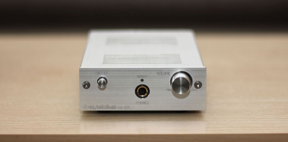

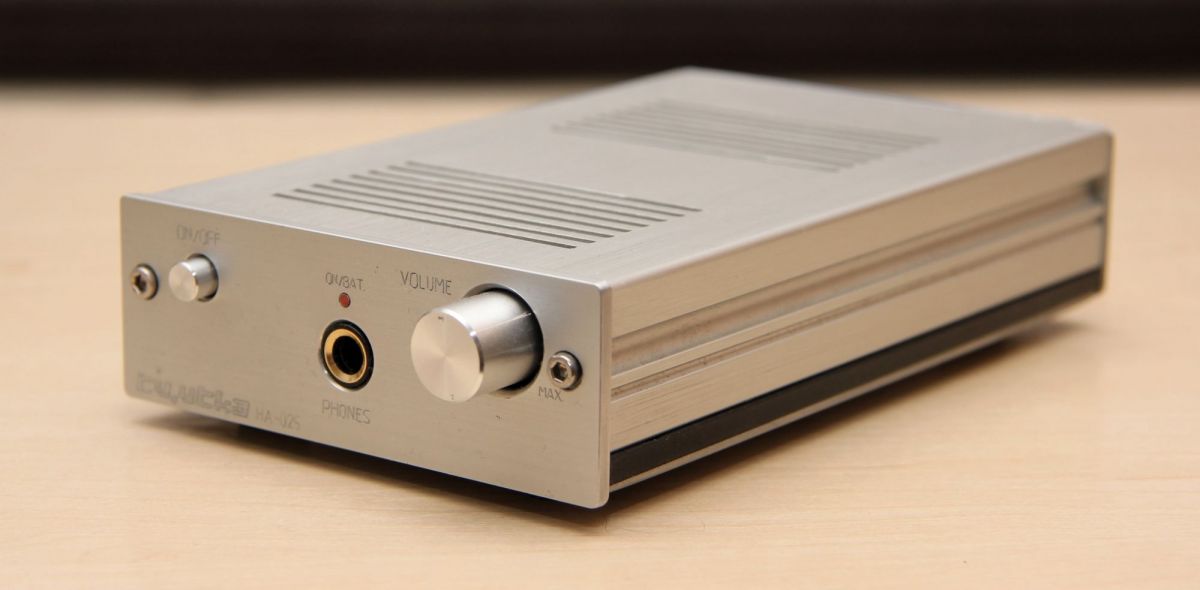

  • Built a portable headphone amplifier for phones and laptops, powered from built-in batteries and using only a USB digital input.
  • The amplifier stage follows the LME49600 datasheet and adds a PCM2705 USB DAC, plus off-the-shelf battery charging and cell-balancing modules.
  • A four-cell 18650 battery pack provides the supply; the circuits can work from two cells in series, but 18650s were chosen for low price and long runtime.
  • The charging-module ground must not be tied to the amplifier ground, so an insulating insert was added to the rear charging connector; tests still showed the PCM2705 block degrades measured parameters.
  • Headphone amplifier in a silver case with control buttons. .

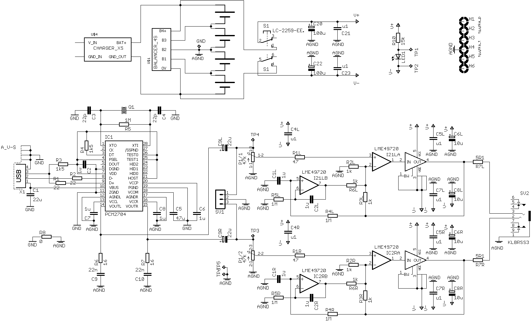

    I hope I don't bore you, with my next headphone amplifier. But somehow it just so happened that I've had the verve for such projects lately.
    This headphone amplifier was created to be used with a phone or laptop. Hence my decision to power it from the built-in batteries (for easier and more versatile use), and to only equip it with a USB digital input.
    The schematic of my amplifier itself is overwhelmingly taken from the datasheet of the LME49600 chip. This chip is a very interesting buffer, ideally suited to the construction of such a device. It has been enhanced here with a USB DAC realised on the PCM2705 chip, which is easy to apply and works with various operating systems without problems. In addition, the amplifier has a battery charging circuit, as well as a cell balancing circuit. The latter two, are in the form of off-the-shelf modules. I made this decision mainly because these modules were already lying in a drawer, waiting to be used.
    Electrical schematic of a headphone amplifier with USB. .
    The circuits used, in terms of supply voltage, can work when powered by two cells connected in series. I, however, chose to power the device from a battery made up of four cells. And why did I choose these cells? Initially, I was thinking of using smaller sized cells, but as 18650 are probably the most popular, their price is more affordable than the smaller ones. Besides, on these, the amplifier can work for a really long time.

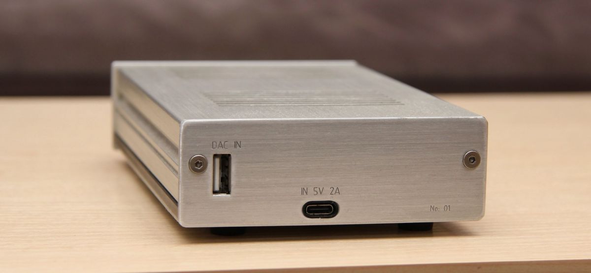

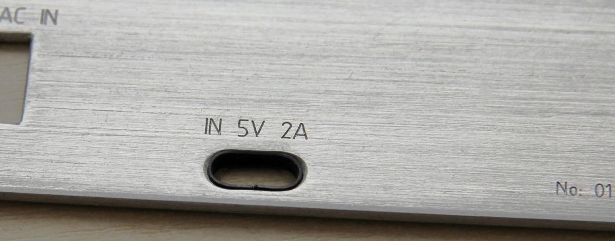

    Before I go any further IMPORTANT NOTE for possible role models! .
    The ground of the charging module, has a different potential than the ground of the amplifier circuit. They cannot be combined!
    For this reason, an insulator has been glued into the charging connector hole located on the rear panel, in order to prevent accidental short-circuiting of the grounds when connecting the charger plug.
    Close-up of a panel with a charging port and the label IN 5V 2A. .

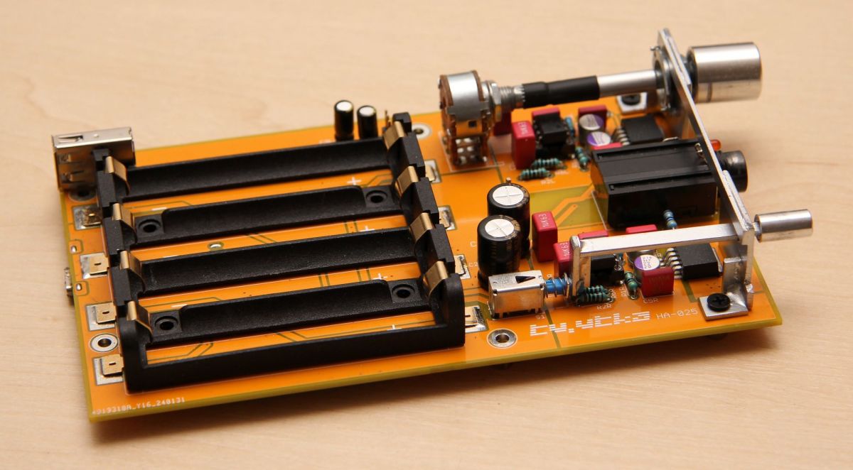

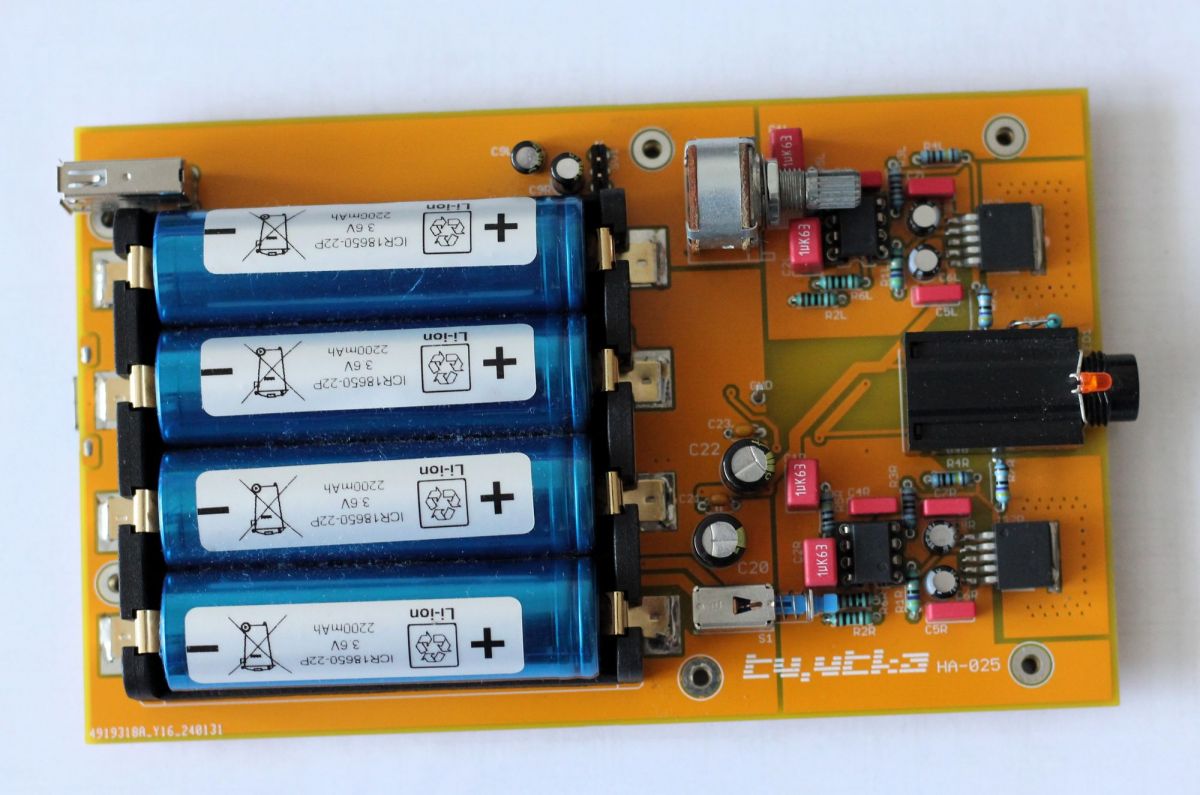

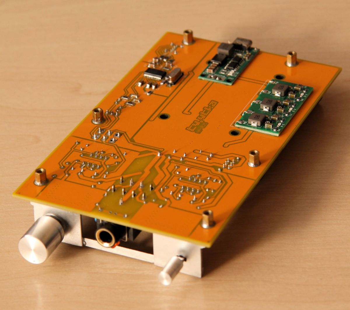

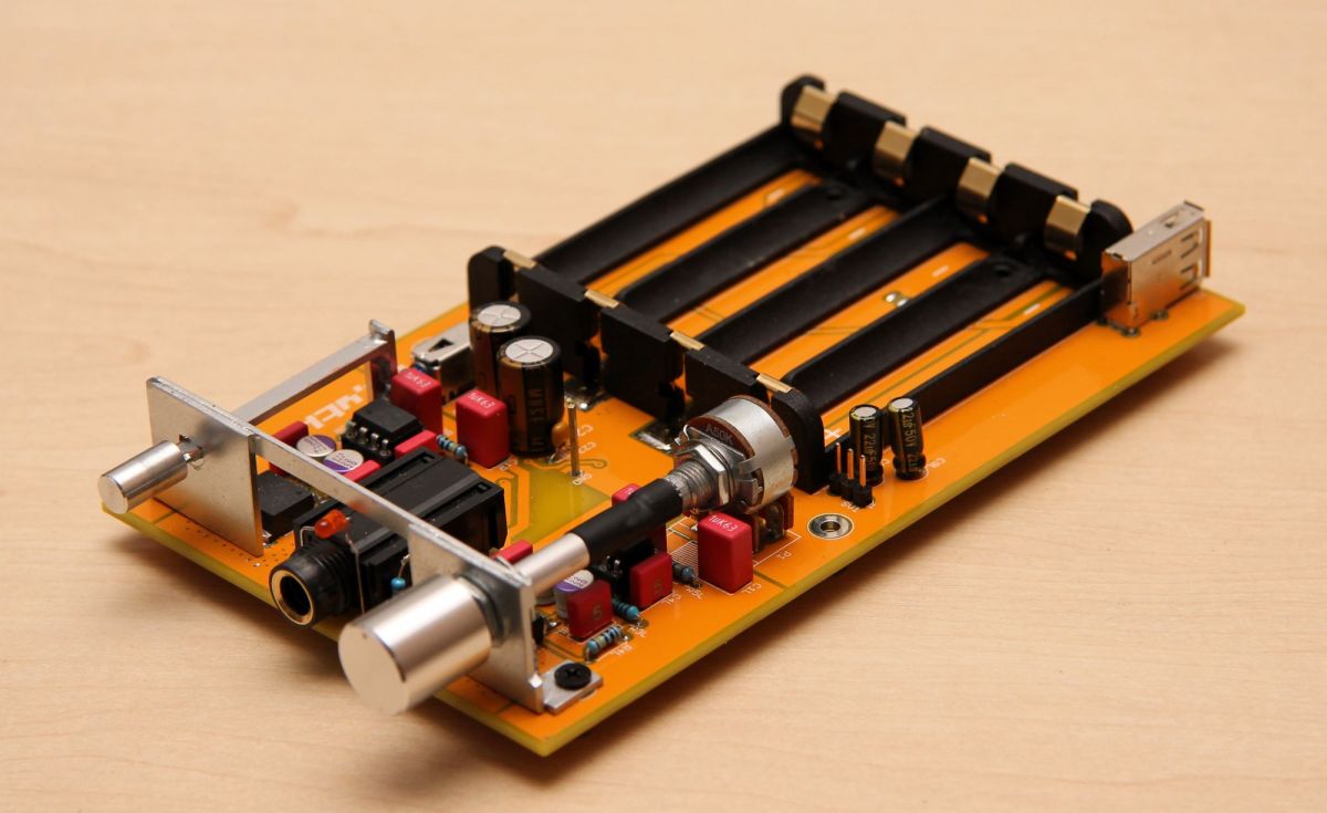

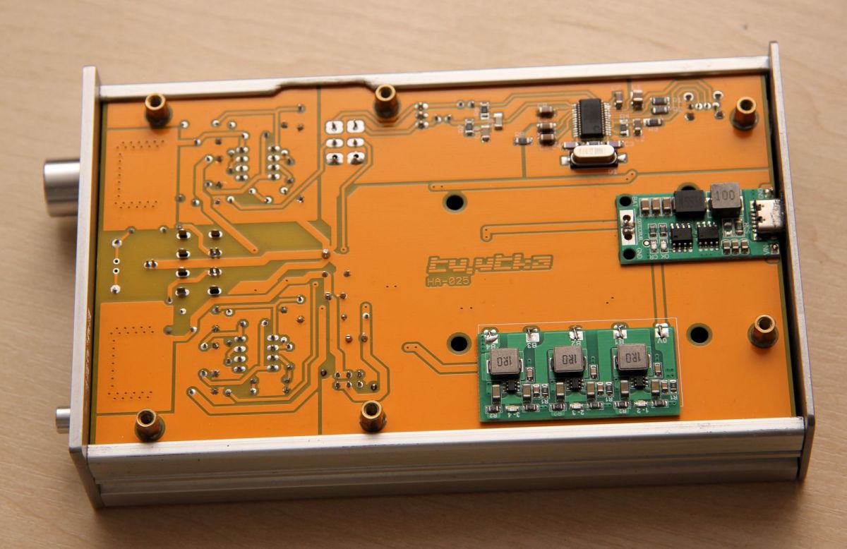

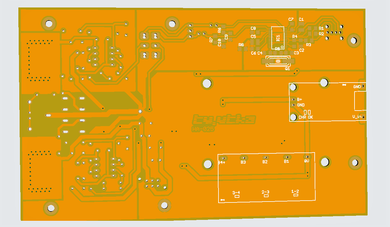

    Back to my design. I have designed the following board:
    PCB design for a battery-powered headphone amplifier. PCB design for a headphone amplifier. .
    Which I commissioned from a company (I think) in a known part of the world.

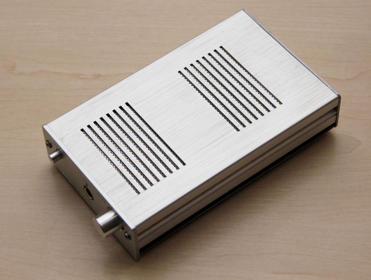

    As for the casing. I think you will already recognise it in part. The main part of it is taken from one of my previous projects, which underwent a metamorphosis some time ago and received a new enclosure. So, these I have used here to make useful.

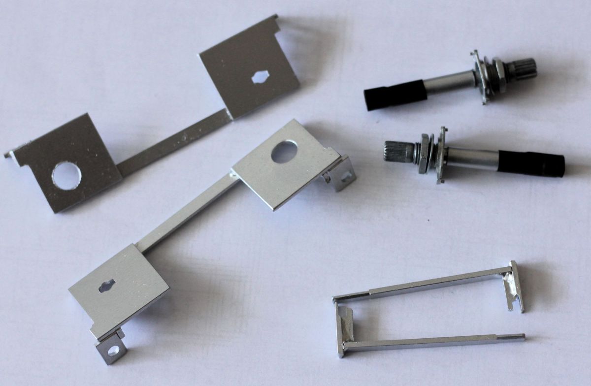

    In completing the project on the mechanical side, a few more small components were needed. These include:

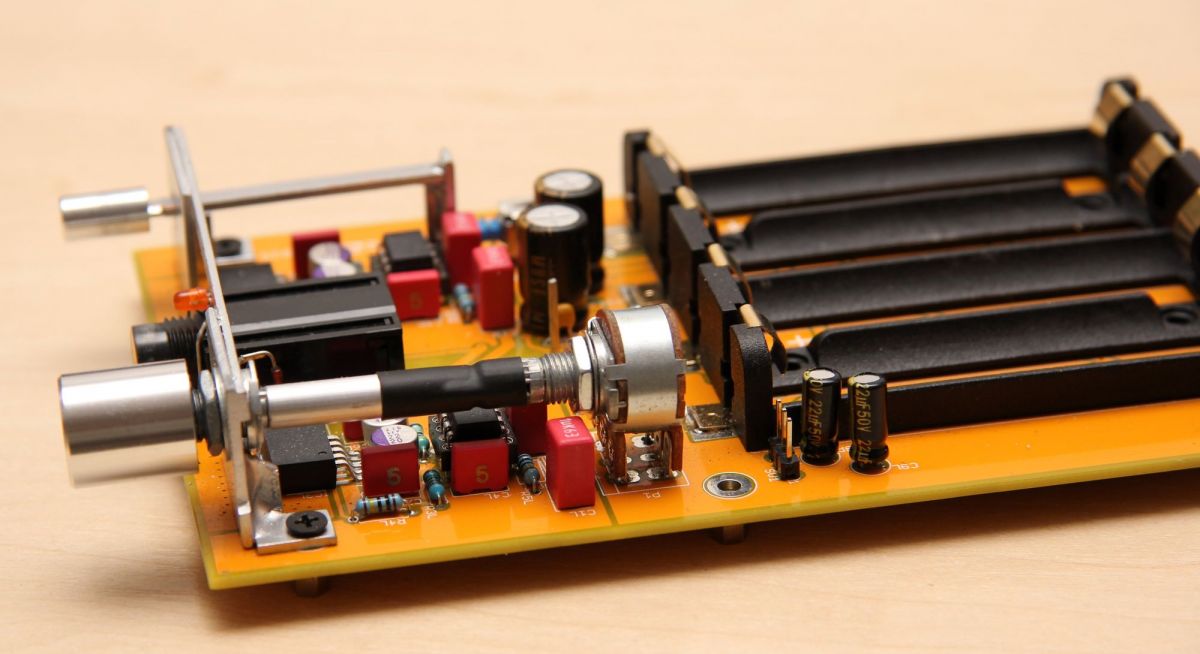

    In order not to bore you with descriptions, hereafter just a few photos taken during the project.
    Prototype headphone amplifier board with built-in batteries. .
    Printed circuit board of a headphone amplifier with electronic components. .
    Electronic headphone amplifier board with components. .
    Headphone amplifier on a yellow circuit board with slots for four cells. .
    Printed circuit board with a headphone amplifier circuit and four 18650 batteries. .
    Headphone amplifier board with built-in modules. .

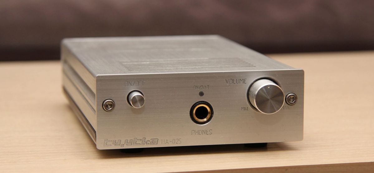

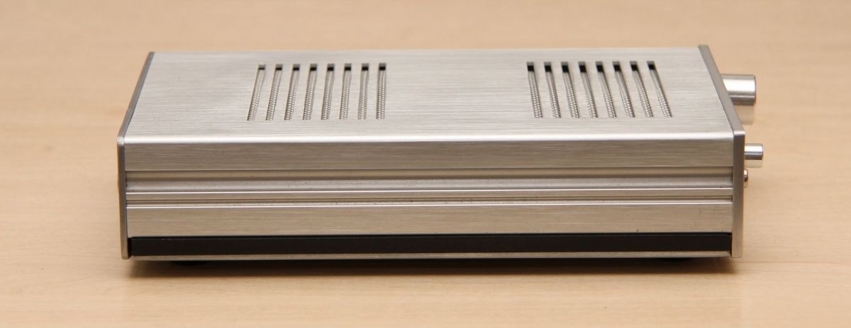

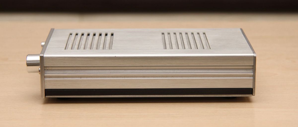

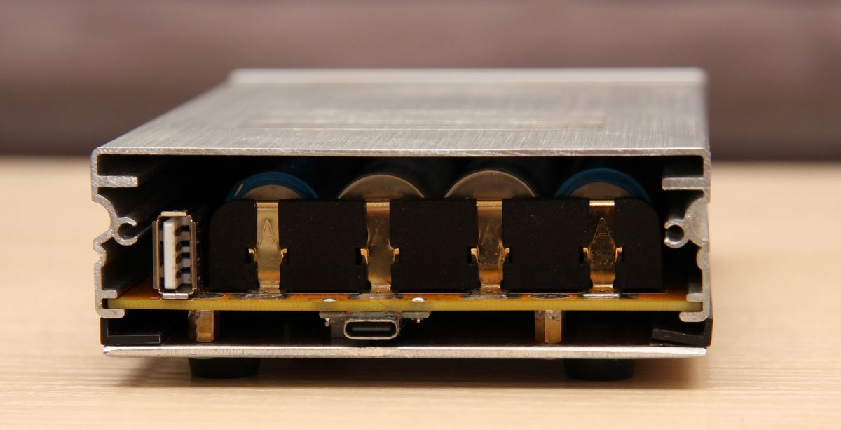

    Rear view of the headphone amplifier case with visible USB socket and battery connectors. .
    Metal casing of a headphone amplifier with volume knob and headphone jack on the front panel. .
    Headphone amplifier in a metal case on a wooden background. .
    Side view of a silver headphone amplifier on a wooden surface.
    Headphone amplifier enclosure with metallic finish. .
    Metal enclosure of a headphone amplifier with visible USB ports and labels. .
    Silver headphone amplifier with volume knob and headphone output. .

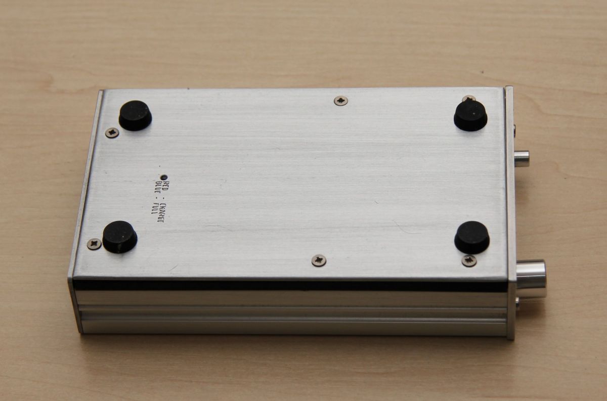

    Headphone amplifier in a metal casing with four rubber feet. .
    Silver headphone amplifier on a wooden surface. .

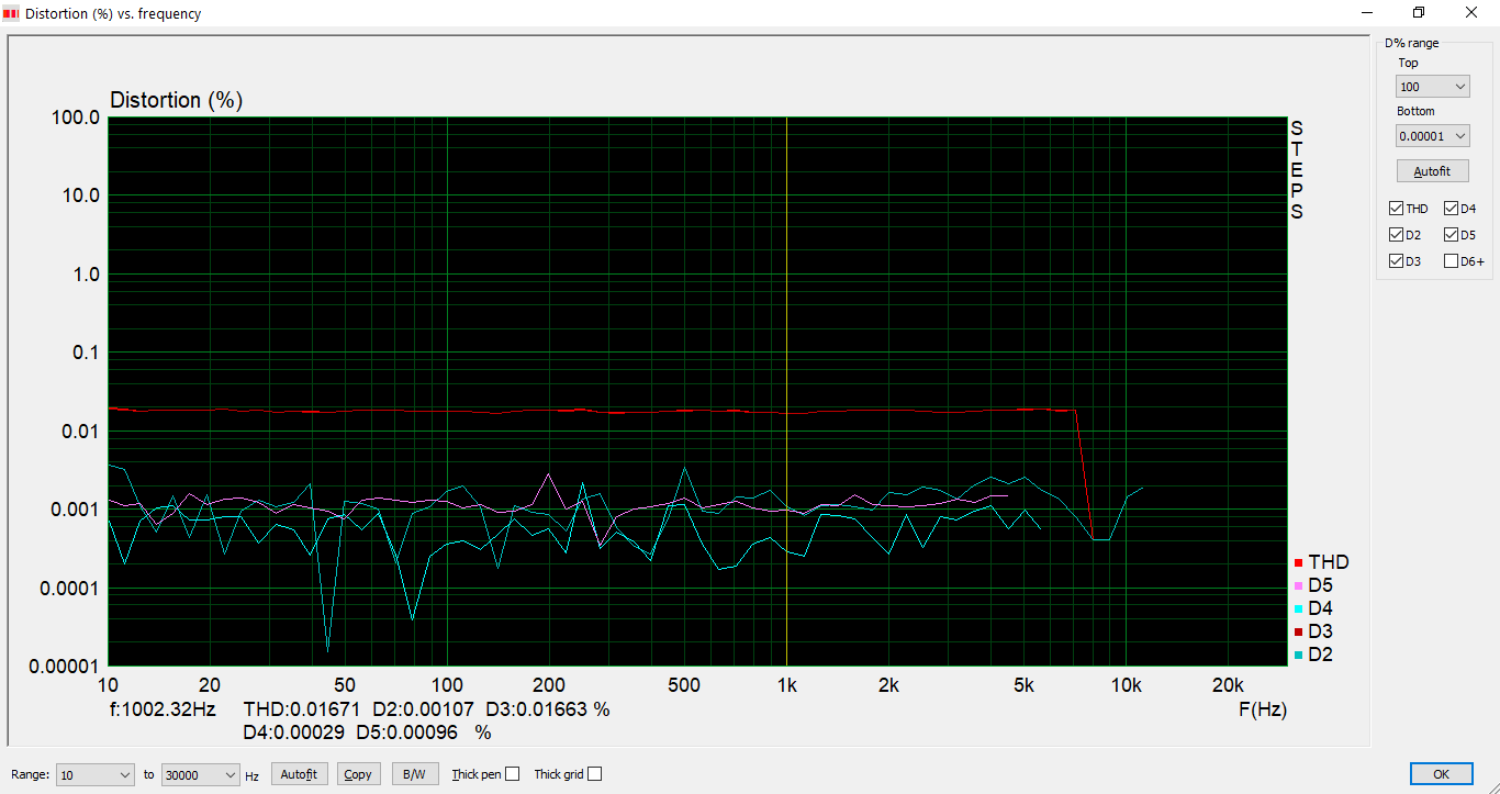

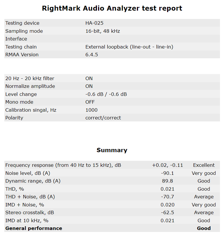

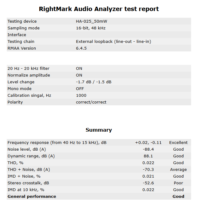

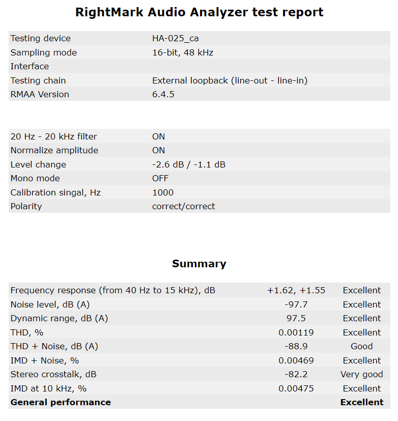

    Below I still include the results of the tests carried out. Looks to the fact that, as in the design of my amplifier in the mains-powered version, the converter block from the PCM2705 affects the measured parameters in a negative way. i will still review this carefully.
    RightMark Audio Analyzer test report for headphone amplifier .
    Graph showing distortion (%) versus frequency (Hz) for a headphone amplifier. .

    I have read the whole description and looked at the schematic and I still don't know what the circuits on the output are :) .
    Why USB type A? I don't think this is their typical use (being an "input") I guess a "printer" type B would fit better here. Or generally putting it on a single USB-C connector.
  • LME49600 output stage and USB-A charging choice
    #3 21303535
    tytka
    Posts: 761
    Help: 8
    Rate: 1837
    Sorry, the symbol for the output circuits will not appear on the schematic, but they are listed in the description, it is LME49600.
    And why USB-A?
    Due to lack of space, I couldn't manage to use a dedicated B-type connector for such purposes (the batteries take up almost the entire width of the case).
    The Type-C connector, on the other hand, I did not want to use for the simple reason of not confusing the input socket with the charging socket.

    I wonder why such poor performance. Over 20 years ago I made a similar circuit, only on a PCM2900 chip. And the parameters were much better, inter-channel transfer -90dB, noise -96dB, which is practically as much as can be achieved with a 16-bit converter. Maybe the later chips are cheaper and worse.

    It is not known how it was measured. I presume some other card of unknown grade.

    More than 20 years ago I did a similar circuit, only on a PCM2900 chip. And the performance was much better
    djfarad02 wrote:
    Not sure how it was measured.

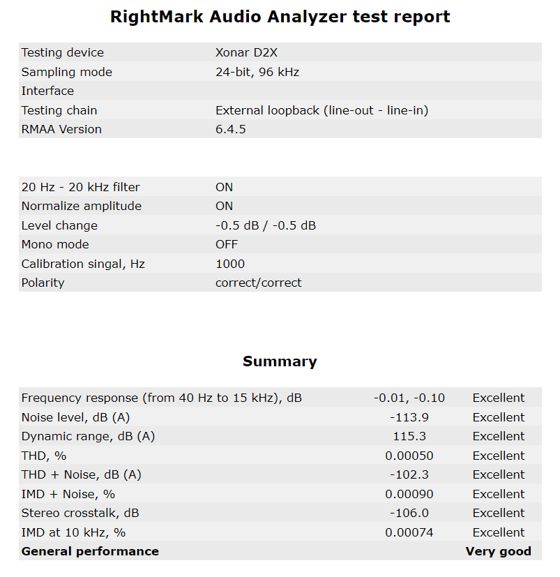

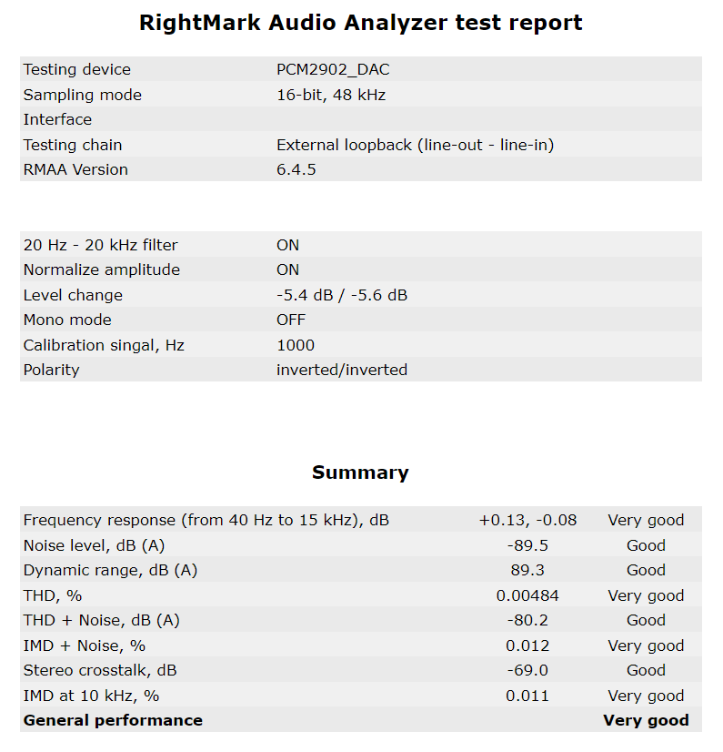

    Just out of curiosity I measured the DAC with the PCM2902. This is what the Behringer UCA222 I own is made on.
    I did this, the USB input from the UCA222 plugged into the computer, and its analogue output connected to the line input on my computer.
    Here the result of this measurement:
    Screenshot of a RightMark Audio Analyzer report for PCM2902 DAC. .
    And here the result of my measurement card, i.e. my reference point:
    RightMark Audio Analyzer test report for Xonar D2X device. .
    I don't know why, but with me the DACs of these PCMs, come out poorly in the tests.
    Today, I slightly improved the power supply condition of the PCM2705 chip in my amplifier, which resulted in some improvement in the performance obtained in tests.
    RightMark Audio Analyzer test report for HA-025 audio device. .
    And here are the test results of my headphone amplifier minus the PCM, i.e. for the analogue part only.
    Screenshot of RightMark Audio Analyzer test report with audio test results. .

    My experience with these circuits was that good PCB design and manufacture was critical.
    A circuit with improperly routed ground was able to exhibit noise levels some 20-30 dB higher.
    And of course good power supply filtering. I was doing the circuit as part of my thesis, so I had plenty of time to test various options. It turned out that moving the 100nF capacitor literally a few millimetres away from the circuit worsened the signal-to-noise ratio by a few dB.
    Nevertheless, the most puzzling thing to me is the poor channel separation. Although utilitarian, in my opinion, this is of relatively minor importance. With vinyl records, for example, we get about 20 dB and this is sufficient for stereo to be heard.

    The amplifier looks very good, and the DAC measurements suspiciously poor. Isn't packing batteries into such a simple design an excess of form over substance...? If it were the headphone amplifier itself then an independent power supply would be most advisable, here we have a DAC that takes data and is powered by USB. This 5V, 500mA can be used to power the DAC + headphone amp - simpler, better, mini.
    As for the measurements, perhaps the ground loop is responsible for the drop in form ;) of the DAC and it doesn't matter how the analogue part is powered, because the DAC itself is powered from usb. Try connecting the DAC via galvanic separation - your tests should improve. It seems that the pcm2702 has better performance and sounds more analogue.

    The PCM2702 chip, has not been in the TI range for some time now. So it is also more difficult to obtain it.
    Yes my amplifier, especially with those rather large batteries, may seem like an overdesigned design. But from my assumptions, it wasn't meant to be a mini, mobile type of design in the sense of walking around. It's meant to provide me with good drive for my headphones at home or when out and about, to be fairly easily portable and independent in terms of power. And that's what I was able to achieve.
    As for the poor performance of the DAC's measurements, I've tracked a few things, have some suspicions and will be correcting/checking this. On the results of my actions, I will keep you informed.
