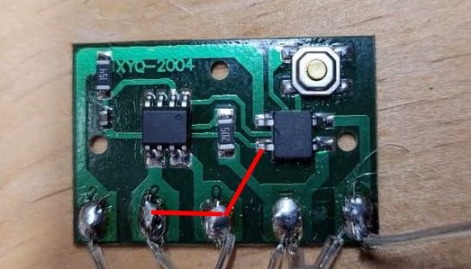

    Is there anybody out there who can help me with this issue....... I bought these LED String Lights and they have 8 Modes. Every time they Turn On it Never remembers the last setting I want which is a Solid Color.... Is there anyway I can modify the circuit board to have them Stay On Constantly......?

    See here: Link .

    Close-up of a small circuit board with several electronic components.

    >>21348804 Thank you so much.....! I just got done with the mod and it's nice to see solidly lit LEDs and not random choosing.....
