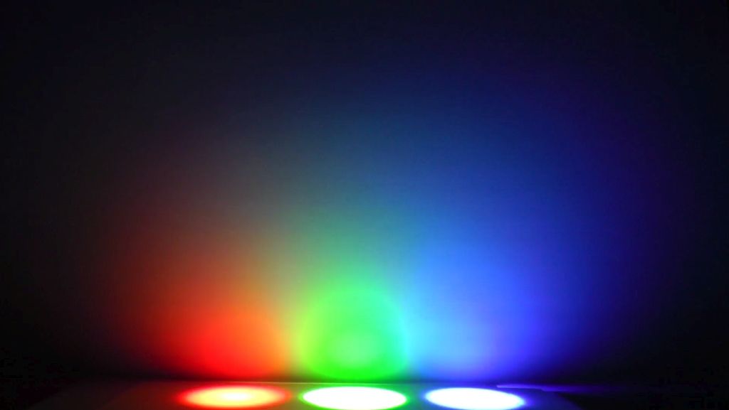

  • Three LED spotlights in red, green, and blue illuminating a wall, blending in the center. .

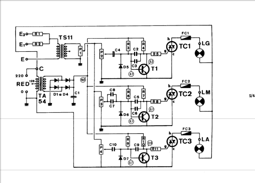

    Illuminophony - a somewhat forgotten topic. The device has, in my opinion, undergone a backward evouluation and at the outset let me quote my colleague @Preskaler who wrote 20 years ago:
    The idea of illuminophony originated in the 18th century and consisted of casting coloured light on a screen depending on the content of particular frequencies in the music. Low tones corresponded to red (also low frequency) medium tones were green and blue tones were high. These were the beginnings of RGB! Listening to music in this way, that during its amplitude changes of individual frequencies, the listeners simultaneously saw colours changing, dimming when the music was quiet and brightening when the music was strong, and in addition with changing colours across the spectrum. This gave an enhanced artistic experience and the listeners were delighted. Of course, this was done by hand. Modern illuminophony has an excellent tool for this purpose but, unfortunately, the whole principle of this illuminophony has been neglected. What has appeared is a colourophone with three mercilessly flashing lights. This does not give the effect of mixing colours and creating resultant colours, thus making the effect negligible. It is no wonder that it is not clear why there is a division of the acoustic frequencies and even of the three spotlight colours?
    another post in that thread confirms @Preskaler's argument :)
    source: https://www.elektroda.pl/rtvforum/topic190754.html#928465

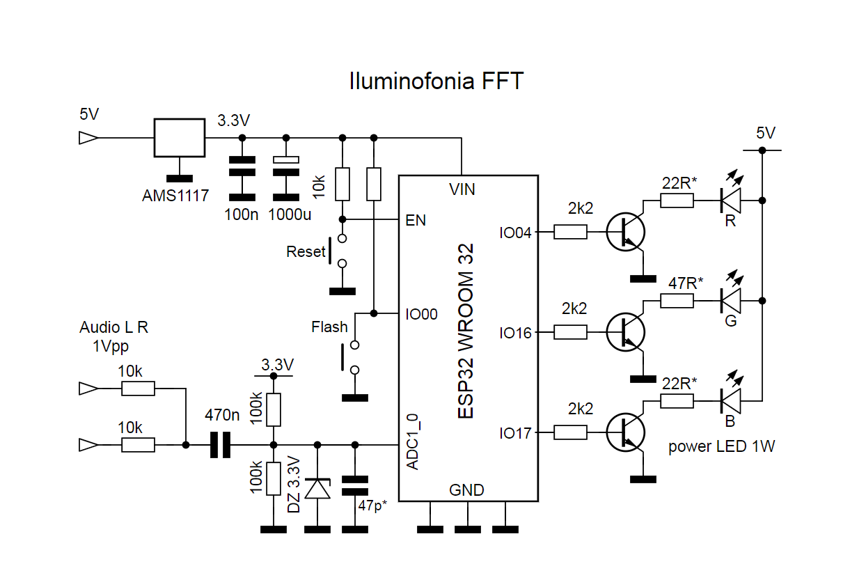

    In the prototype circuit I have used a 1W power LED. Of course, this part can be freely extended.
    I attach a schematic with the development circuit. For the development board, the 3.3V stablizer circuit and the Flash and Reset buttons must be omitted.
    The circuit can be assembled "on your knee" within an hour.

    Diagram:
    Diagram of a photophonic device using ESP32 and FFT. .

    @Prescaler. I increased the inertia of the lights further. I positioned the LEDs close together. I projected the light onto a white background.
    And something like this came out :) . This is difficult to film. The eyes see differently and the camera exposure differently. Such light projection probably needs to be calibrated. With three colours of the same light intensity there should be white light?

    For me "the bomb"! A really great job. White light will be difficult to achieve, because in this way of mixing there will always be unevenness in the individual colour beams and colour spots will appear. However, this is not a problem as it is only a matter of artistic impression.

    In Radioelektronik and Praktyczny Elektronik there were diagrams of such colourophones/colorophones :) . In Młody Technik there was a micro-luminophone - three or four transistors and attached to them each a 20 mA diode. It flashed like this.

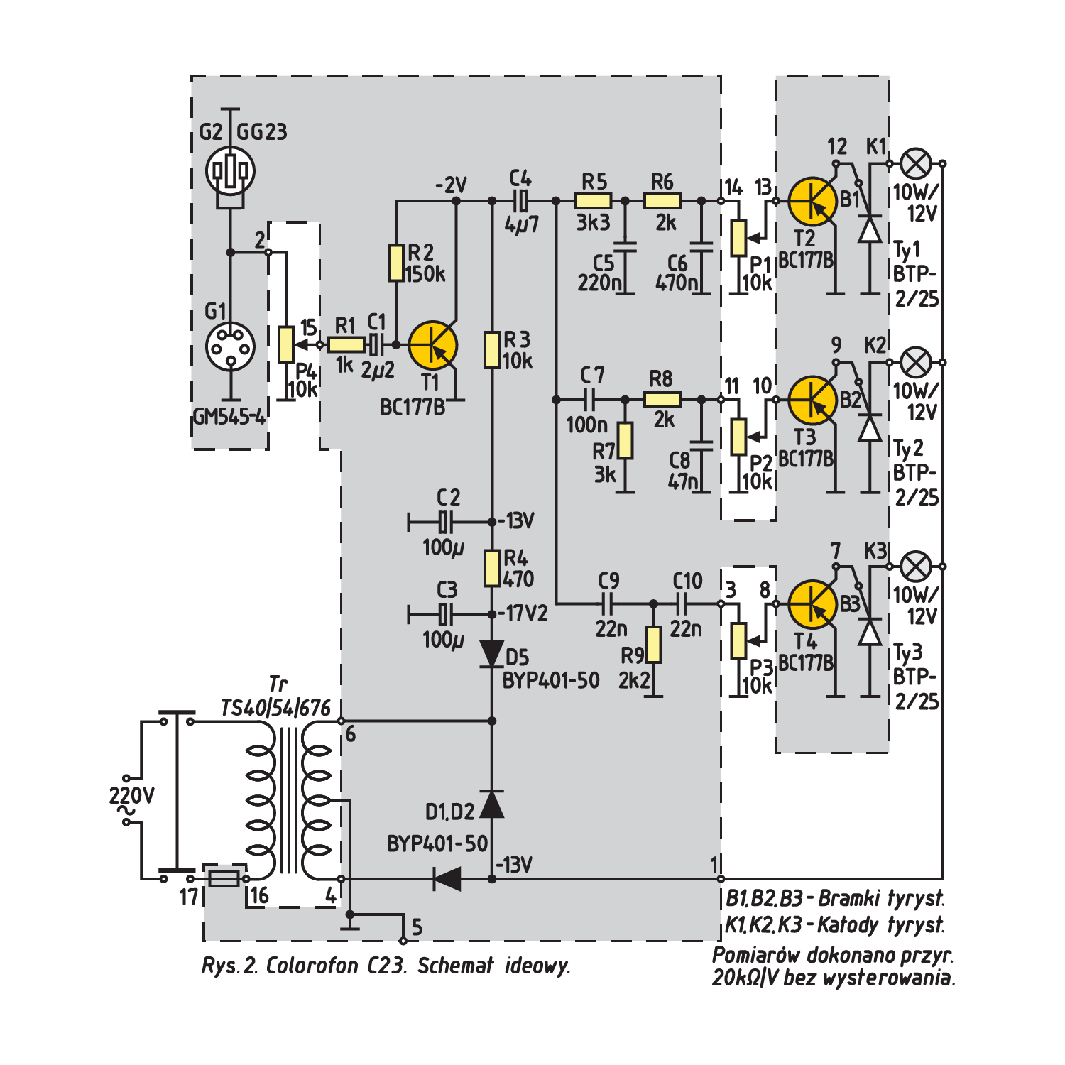

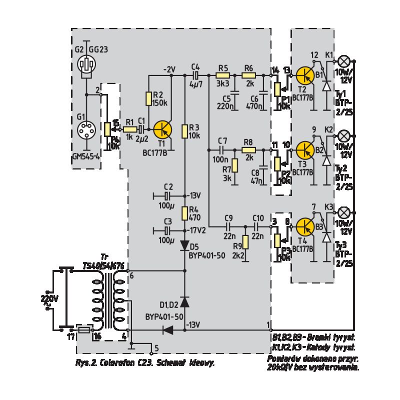

  • Red, green and yellow channels follow bass, mids and treble
    #18 21492493
    LEDówki
    Posts: 9630
    Help: 1320
    Rate: 2597
    But then there were no blue LEDs. So there was red, green and yellow. The Colorofon C23B also had these colours and on the wall the light mixes, but the effects are not like RGB mixing. That's what they did, that's what I bought, I'm not going to rework. Some people find these lights laughable. You have to do a bit of work to get the light pulsations to match the music. Not everyone understood this and disco-goers remembered that the lights should be on all the time.... This has no effect. As you can see, not everyone understands that red is supposed to react to bass, green to midrange, yellow/blue to treble. For them, it's supposed to blink and that's it.

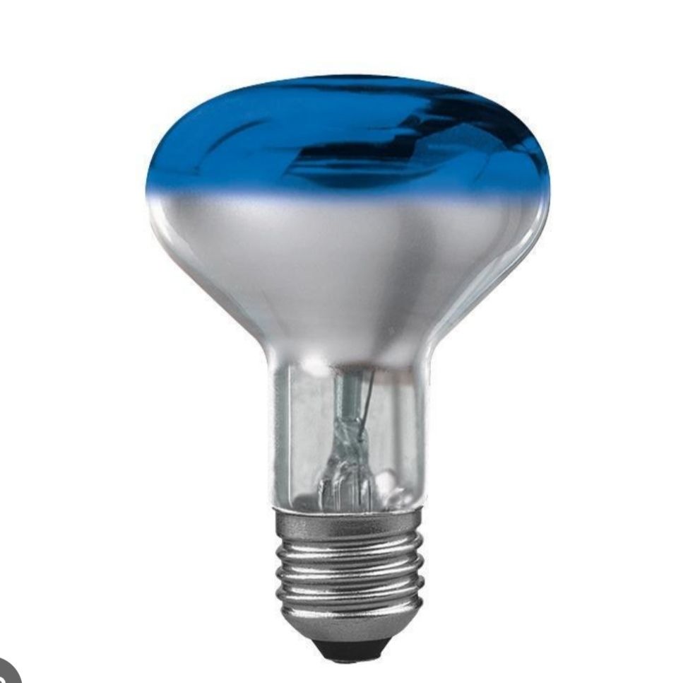

    The first illuminophony I made also had a yellow filter instead of blue. It wasn't until years later that incandescent bulbs with reflectors and coloured filters appeared. Also with blue.
    And whether it should flash sharply or more smoothly and gently is the preference of the viewer.
    Which doesn't change the fact that the original wasn't intended to flash, but to modularise different coloured light.
    Everything flashing that was developed later is unfortunately a prosthesis.
    Light bulb with a blue filter on top. .

    Congratulations. Really. It's just a pity that (as far as the schematic corresponds to reality) you won't be able to connect high power in such a final arrangement....
    Nevertheless - BIG plus for the effect.

    As I wrote earlier, the LED control circuit is an example. In the quoted circuit I have used a power LED of 1W.
    There is nothing stopping you from raising the power and connecting more LEDs in series, or grouping them in series/parallel. Also with more power. The simplest option with series resistors. Only that there will be quite high losses on them. To reduce them, you can use, for example, the popular, cheap PT4115 current source (30V 1.2A) controlled by PWM from the MCU.
    The choice of high-power LEDs is considerable. I don't know if there is any point in using triac-controlled 230V bulbs. For smooth operation of these, phase control with zero crossing detection is required, etc.... Other software and hardware changes. In addition, there is the problem of colour filters. Bulbs with >>21492550 are not likely to be produced anymore.
    I think that at least for domestic applications this circuit does the job.
    For those who are interested, I am uploading the DS PT4115.

    :) Wow , the sentiment returns ;) .
    40 years ago I got the schematic C23
    Colorofon C23 electronic schematic with components like transistors and light bulbs. .
    I made my first working electronic circuit based on it. To increase the power, I gave more powerful bulbs 21W 12V . What was my surprise that the circuit didn't work very well because the delay on the bulbs was too high :( Only by changing the power supply to 24V did it work. I used the coloured glass used on the railway in semaphores as filters. I got them from a friend through acquaintanceship :) Back then everything had to be obtained ;) .

    Electronic circuit diagram with three transistors and diodes.
    It used triacs and 220V lamps, and an isolation transformer for sound input
    I built one of these "psychedelic lights organs" and also single-channel versions.
    Brings me some memories....
